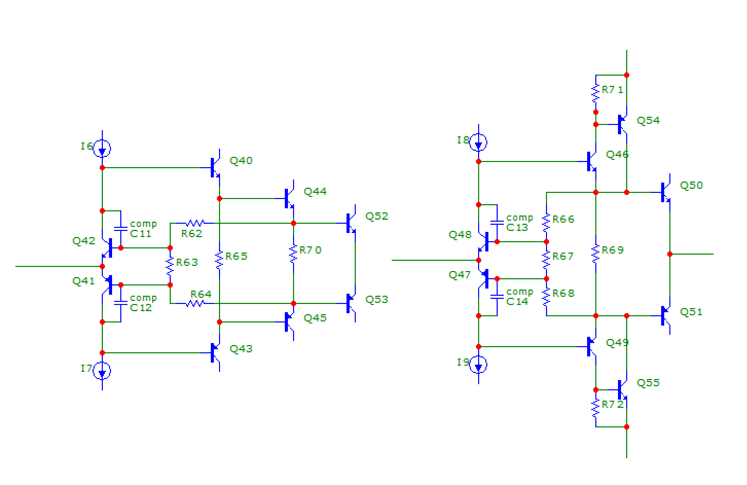

I like the two transistor bias circuit (Q63/Q65 in your schematic) because it ignores Vbe tempco from the drivers, so it makes it possible to use resistor-free class AB BJTs. I was surprised that it was so easy to get it thermally stable.

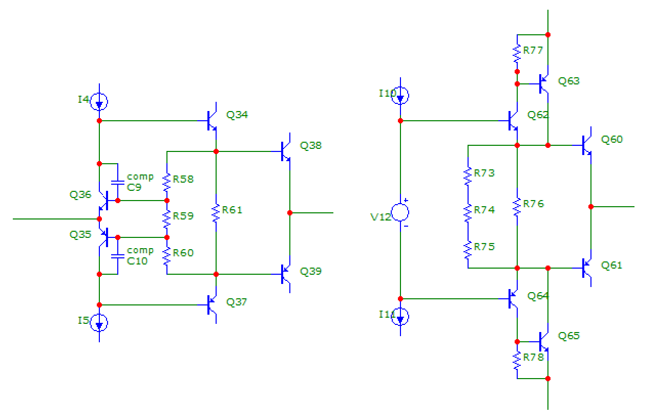

Between these two schematics:
I want drivers with a low output impedance, because that keeps the bias voltage constant between power transistor bases, which widens the range of output currents where the output transistors both conduct, which gives more class A and flatter gm for less bias current. These two schematics should have roughly the same output impedance with regard to that because they're both similar, two transistors, so same current gain and open loop gain... The first is like a CFP except the driver transistor is the other way around and upside down. But the CFP has better current gain from the point of view of the VAS, while the other ignores Vbe of the driver. So it's a compromise.
In my setup it misbehaved a bit, but that's probably because I built it point to point above the pcb, which adds too much inductance. With proper layout, it should not be difficult to compensate by adding a cap between the base and collector of both transistors, if necessary.
Now...
The one on the left has 3 transistors in a loop, which is usually too much gain to be stable, so it'll need the compensation caps as you demonstrated. The one on the right uses "division of labor" to make nested loops, with the CFP drivers having their local feedback loop, and the bias control transistors having their own local compensation. I can't say which one would work better...

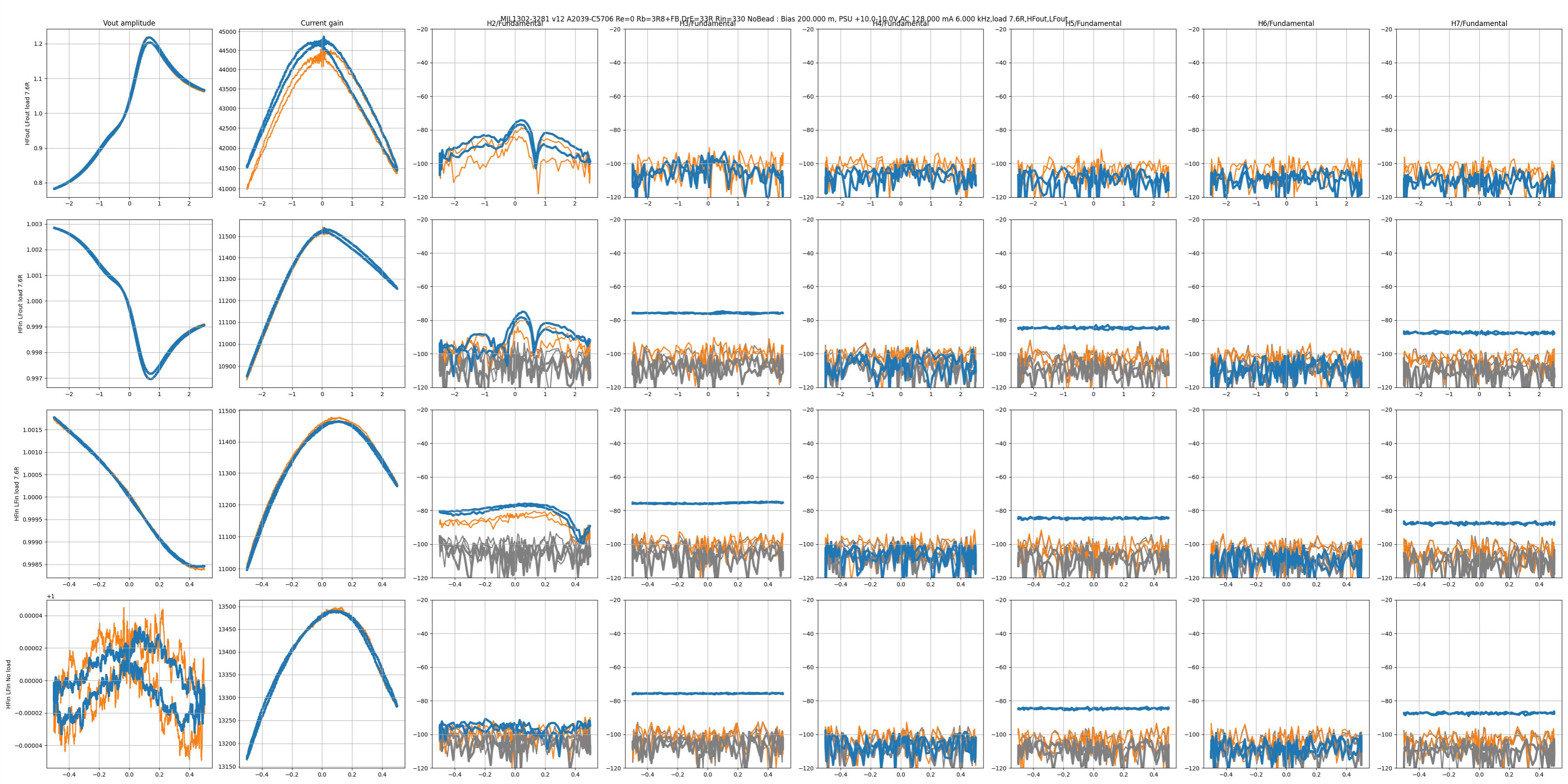

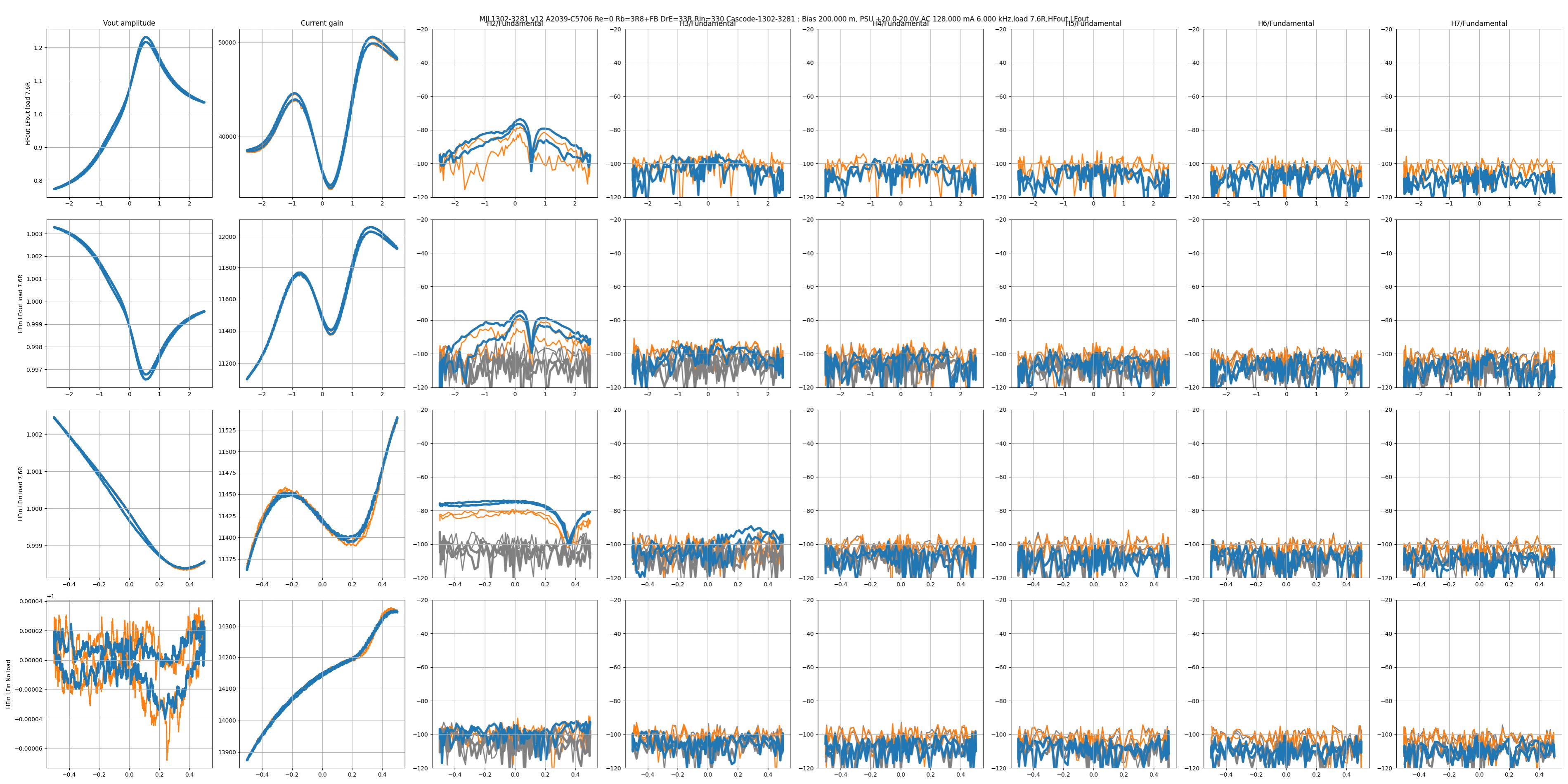

I've set it up to run all combinations with regard to input and output.
1) It injects low frequency current (LF, 40Hz, 2.5A) and high frequency current (HF, 3-6kHz, 128mA) into the output of the OPS, with the input of the OPS grounded.
The voltage that appears at the output corresponds to distortion caused purely by current through the output stage, and it ignores distortion due to voltage like Early effect, nonlinear capacitance, etc. So gm dependent distortion can't hide behind the small amount of H3 and H5 generated by these.
In this mode, current gain is not measured correctly because all the device capacitances provide some helpful base current instead of stealing it from the driving circuit.
2) It still injects LF current into the output, but now the HF goes into the input as a voltage, and that makes the OPS reproduce this HF sinewave at its output, in the presence of a LF current. So the output current is the same as above, the difference being that now transistor Vce is moving.
In this mode, current gain on the HF signal is measured correctly, including drive current lost through capacitance.
Current-dependent distortions measured at the previous step are still present, plus voltage dependent distortions.
As long as there is no clipping, and since there is no LF at the input, and the HF voltage at the input does not change along with the LF current injected at the output, distortion that depends on voltage will manifest as a constant amount of distortion added to the current-dependent distortion.
If both output transistors had mismatched voltage-dependent distortion, that "constant" amount would change depending on LF output current polarity, according to which transistor is on or off.
3) HF and LF voltages are sent into the input. Due to the opamp driving the OPS, plus headroom for the biasing current sources, drivers, etc, this limits output voltage, so current maxes out at 1A into the 8R load, it is lower lower than at the previous steps.
This is mostly to confirm the result would be the same as the previous step, to check if the setup worked:
4) same as step 3, but the load is disconnected, so we get voltage-dependent distortion only.
Each of these steps is a line of plots in the figure below.
X-axis is always the LF output current ; Y-axis is always in dB.
First column is the amplitude of the HF signal at the output, second is current gain, and then the harmonics of the HF signal. I got rid of the THD plots and kept only harmonics because H2 dominates THD anyway.

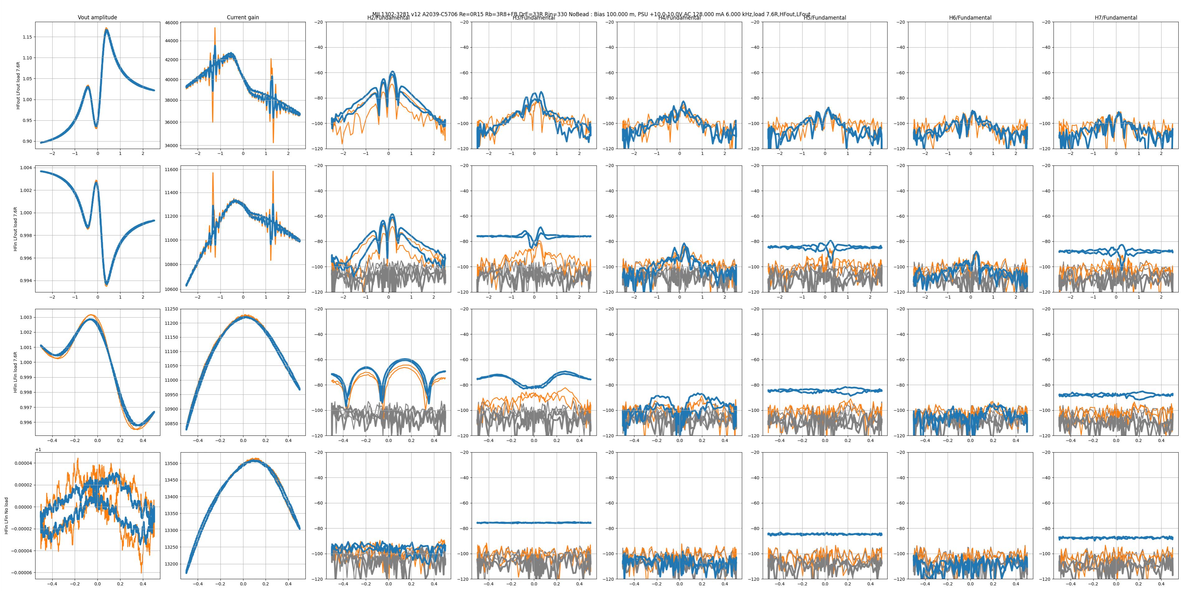

This one is at 100mA bias with 0R15 emitter resistors.
  • thd-Bias 100.000 m, PSU +10.0-10.0V,AC 64.000 mA 6.000 kHz,load 7.6R,HFin,LFout-MJL1302-3281 v12.jpg
An explanation about the wiggly graphs on the first column:
Intermodulation occurs when the amplitude of signal #1 goes up and down depending on another signal. So I just plotted the amplitude of the HF tone according to output current.
btw, they're not in dB, they're just a ratio, it makes it easier to view it as percentage.
On the first line, current is injected into the output, so the output voltage corresponds only to the output impedance, which is tiny. So in comparison its variations looks large. The interesting graph is the same on the second row, which shows the variation in output voltage when the input is driven. They are very low, less than 2%.
Besides that, the current gain graph clearly shows where the turn-off spikes occur. I think that's because this is the instrumentation amplifier channel with the highest gain, so it will also pick up EMI from high di/dt events, like the turn-off spike, which is similar to a diode recovery.
-> Looks like the turn-off spike doesn't just make a mess in the output, maybe it can be picked up and amplified by the preamp too!
-> Got a phono preamp in the same box as an amp that makes turn off spikes? hmm...

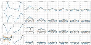

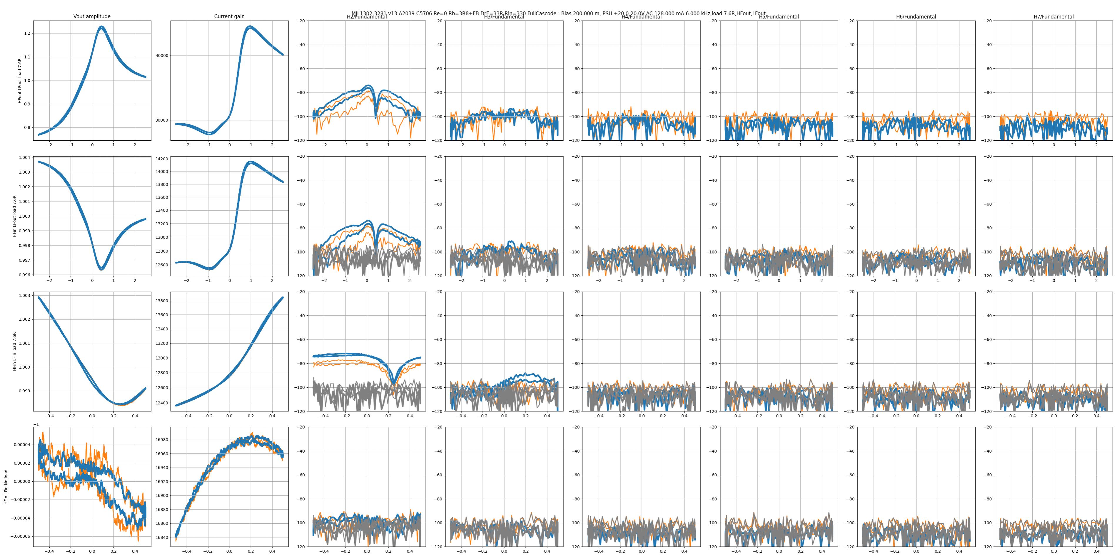

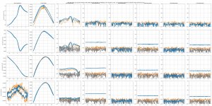

Compare to the plots below, of the exact same output stage without resistors. One at 100mA, the other at 200mA.
- Crossover spikes are gone.
- All the harmonics above 3 disappear in the noise floor.
- At 200mA, H3 also disappears in the noise floor, leaving only a bit of H2.
A little bit of H3 and H5 remain on the tests where the input is driven (all except the top line). It is constant regardless of output current, so it must be voltage related.

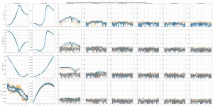

To investigate this, I use IRFP150 and IRFP9140 as bootstrapped cascodes on top of the output transistors. Their gates are 15V away from the output voltage, which gives the output transistors a constant Vce of about 10V. No cascode on the drivers yet.
Amazingly, this flying wire mess did not oscillate.
The constant low level 3rd harmonic is gone, leaving only H2 and a little bit of current dependent H3 at 100mA bias like before. It is very clean.

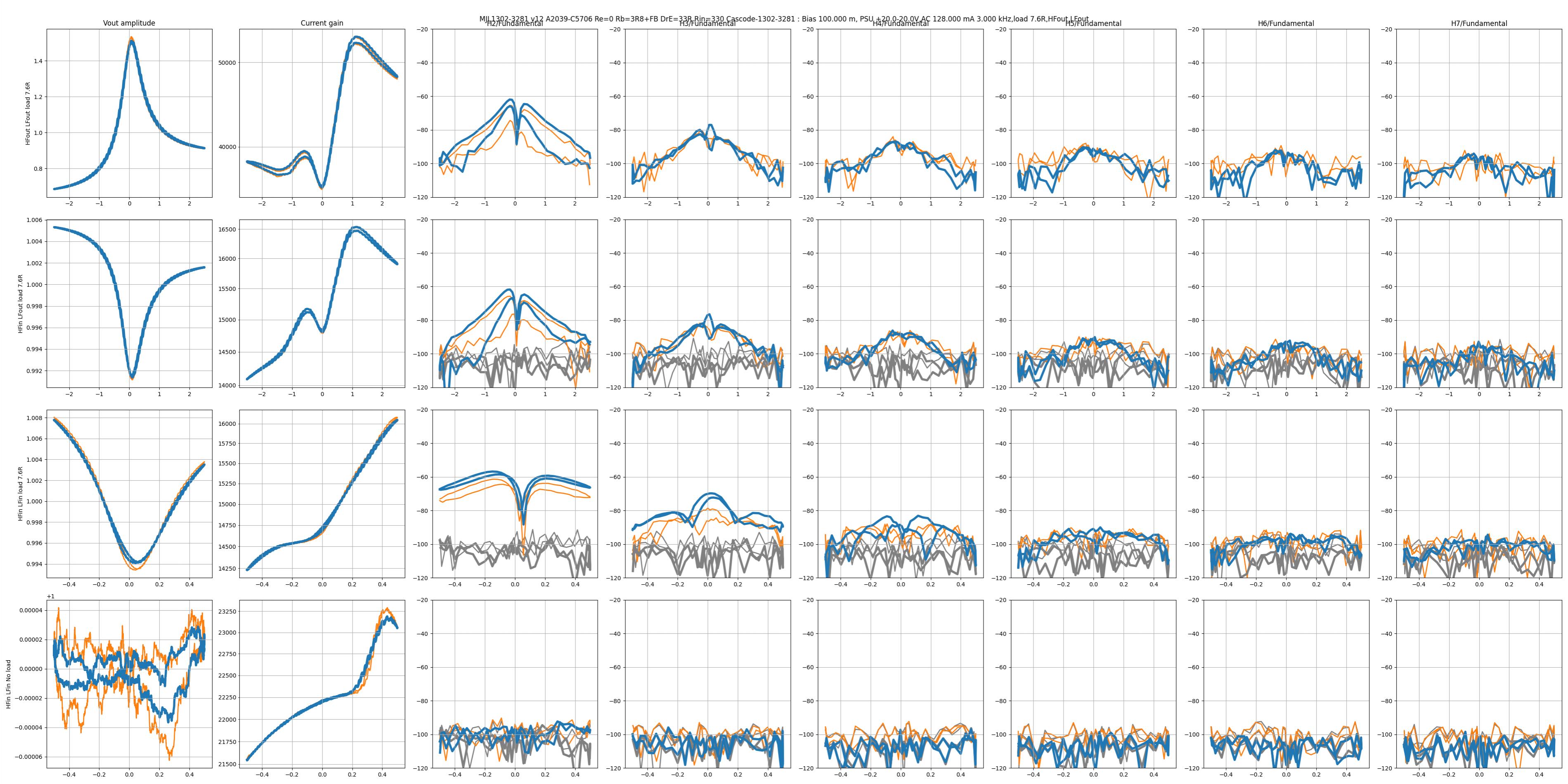

I think I've found the origin of this annoying 3rd harmonic. Probably related to the setup (ie, an instrumentation amplifier that was not used got enough signal to clip and that may have introduced crosstalk into the other channels). Anyway, it's gone. If it was setup related and wasn't there to begin with, then the cascode didn't eliminate it, but I'm still happy that it works: it still brings benefits of improved SOA in the output transistors without paralleling/matching headaches, and lower dissipation which could be useful to keep bias stable without resistors. Cascode FETs are cheaper than MJLs so it's a cheaper way to increase dissipation capability too.
I've set the cascoded transistors Vce to just 6V to see how low it can go. No problems at all.
There's something wrong with the bias, because the software thinks it is 200mA, but it actually ran around 130mA. So the label on the plot is wrong. It's my DIY non-inductive resistor: after soldering and desoldering it too many times, the copper foil cracked, so its value has increased. So the plot below is at 130mA.
Anyway: I got the results I wanted:
1) At low bias currents (<50mA) emitter resistors reduce distortion, but it is a compromise, as they worsen turn-off spikes too.
2) At higher bias currents (100-200mA) no resistors is a much better option. Distortion is extremely low both in amplitude and harmonic order. Turn-off spikes are greatly reduced. Transconductance is huge. There is no gm-doubling, so a variable bias amp can be implemented.
3) Bias sensor on the transistor allows no emitter resistors without trouble (I expect ThermalTrak to work even better)
4) Cascoding the output stage and drivers works and isn't difficult ; even with air wiring and no special precautions besides 120R gate resistors on the FETs, no oscillations occured. Gates are driven through a 47µF bootstrap cap connected to the output, and biased with a 10k resistor.
So... basically this is all I wanted to do with bipolars on this setup ; testing more output stage topologies will require another PCB because I'm fed up with flying wires.

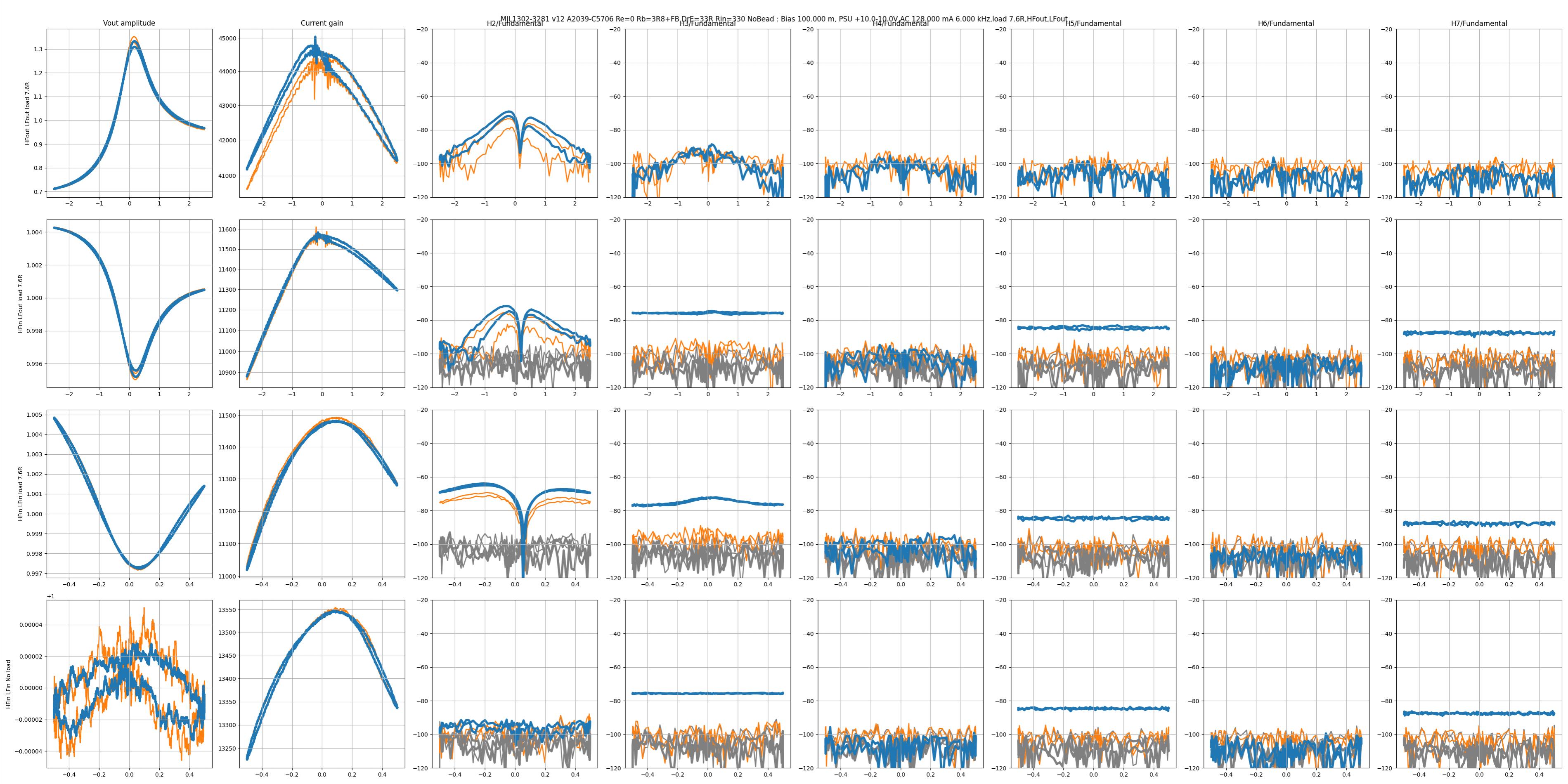

I put in the IRFP240-9240, but I left the cascodes in, at 10V Vds.
Cascodes bootstrap the input capacitance of the FETs somewhat (not completely, because their output impedance is not zero).
But the lower Vds makes input capacitance higher, which somewhat compensates... Current gain is only 20% higher with the cascode. So there is no real gain here.
