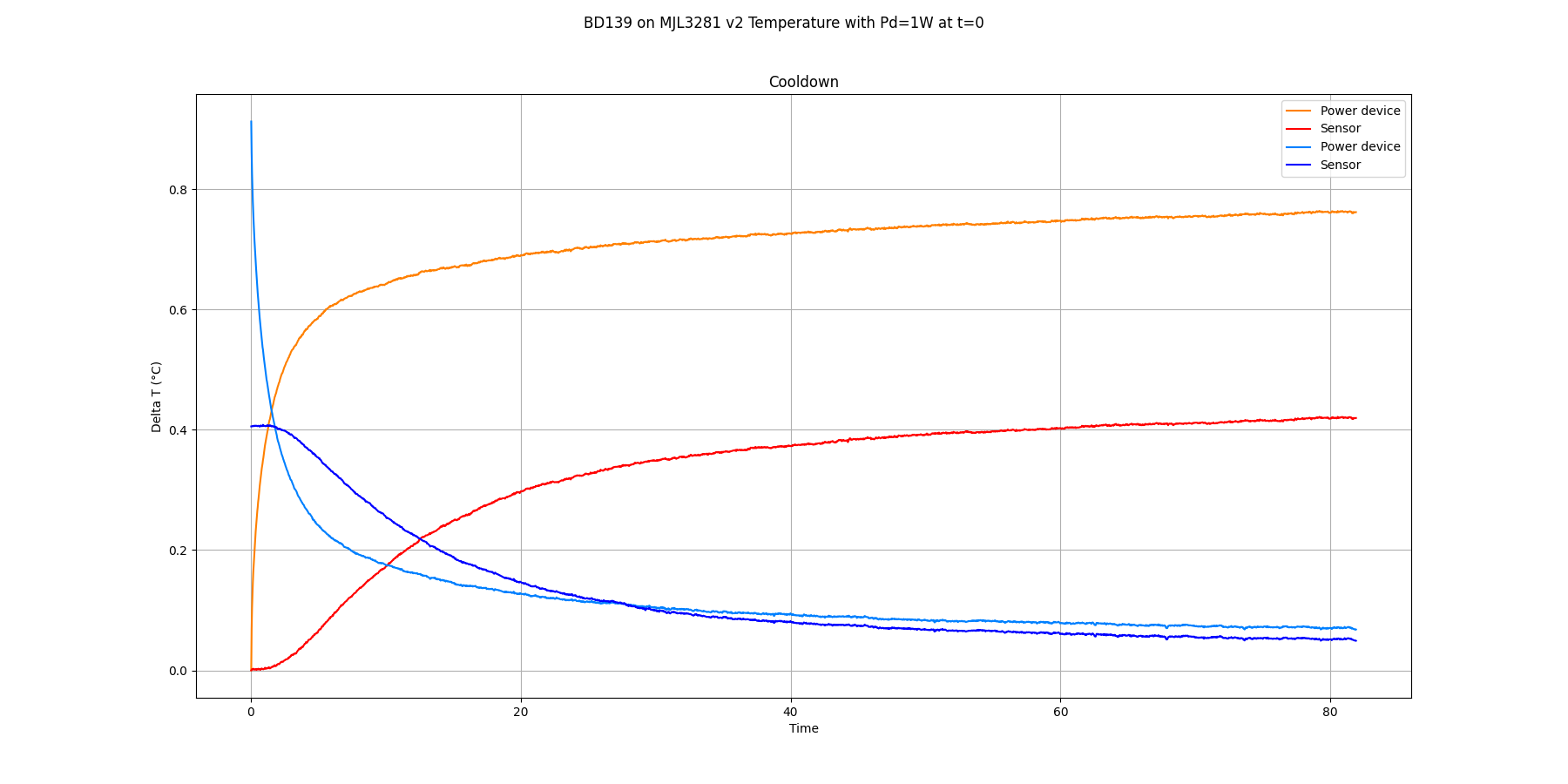

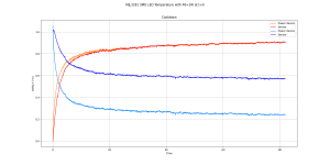

Plot twist: after testing bias sensor performance during heating, this morning I also tested cooling. I should have set it to record that during the previous tests, but I forgot, so here we go again...
If the thermal sensor has delay during heating, then the output stage will overbias. If it has delay during cooling, and the thermal sensor ends up hotter than the transistors, then it will lower the bias too much and the output stage will underbias, which should absolutely be avoided.
First is the sensor attached to the collector leg of MJL3281. It works very well during heating, but not at all during cooling. The MJL3281 silicon is cooled very quickly by the heat sink, but the collector leg stays quite warm for a long time.
Next is BD139 on top of MJL3281 under the metal bar. It has the same problem, it remains hot while MJL3281 cools down.

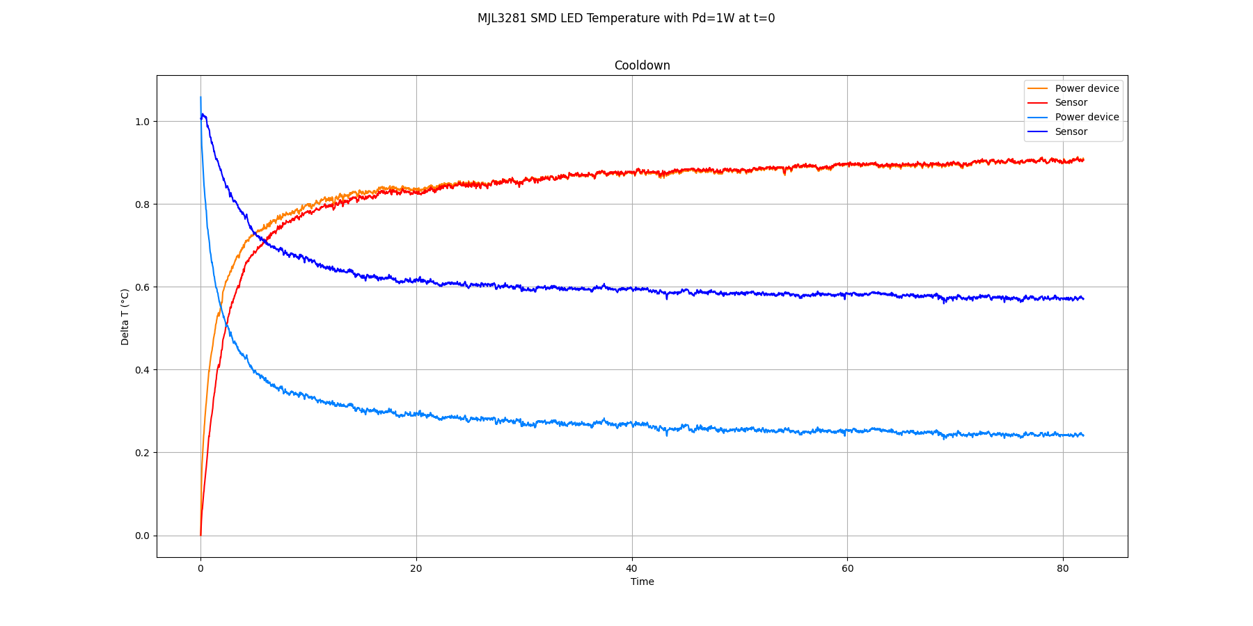

I'm out of 0805 SMD red leds, so I tried a 1206: it doesn't work that well as a temperature sensor.

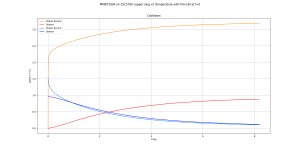

This is a MMBT3904 on the copper slug on which 2SC5706 is mounted. It tracks the cooldown very well.
I should have thought about that before: if the thermal interface is good, which it should, the power transistor will cool down to the temperature of its heat sink very quickly. So the bias sensor should be between heat sink and transistor to avoid lag during cooldown. The only practical solution to do this is to mount both the transistor and the sensor on the same copper slug.
Therefore:
Doing an output stage with large transistors, no emitter resistors at all, and no special snowflake autobias circuit looks pretty much impossible due to not being able to track the temperature.
If thermaltrak diodes are mounted on the leadframe by the side of the transistor, they could work for that, but a lot of people say bad things about them. If they are mounted too far from the transistor itself, the same thing will happen as above with the LED: they won't cool down fast enough, resulting in underbias.
On the other hand, a resistor-free output stage is possible with SMD transistors (with cascode) but since you can't parallel them without emitter resistors, it will be either low power, or way too many parts.
Therefore:

> I guess your top bar pressing on the BD139 also stores heat and delays the cool down of sensing transistor.
It's probably helping it cool down by acting as a heat sink: temperature rise of BD139 was only about half of MJL3281. So in a Vbe multiplier it would cancel half the Vbe change. Still much better than on the heatsink.
I could try putting a rubber washer between the two, I have some pretty hard ones, that'll probably work..

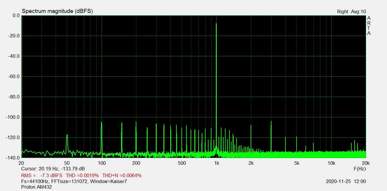

Yes, it was easy to replicate with distortion measurements. I ran high power bursts, and measured the distortion (and Iq) at a lower level while it cooled down. Basically just ARTA and FFT and playing around with the volume control.
It was in these shorter heat transients that the improvement was most significant, the slow heating of the heat sink was pretty well compensated with the sensing transistor on the heat sink.
Iq did still vary a little with the transients, so I had to overbias slightly.
If this amp is stable without emitter resistors that gives me hope. What was the bias, and what is the Vce of the transistors?
I don't have the amp any more, and memory is short.. I think I set Iq around 40-50mA, I wrote it on the inside of the amp, but no other place..
I attached a schematic of the amp from the internet. I think Proton made several amps without emitter resistors. I did burn some transistors before I got it where I wanted it though.. If you make one without emitter resistors, remember to make a jumper or similar on the PCB to measure Iq.
EDIT:I found a dist measurement of it too, so I added that. I think it's 1W 8ohm.

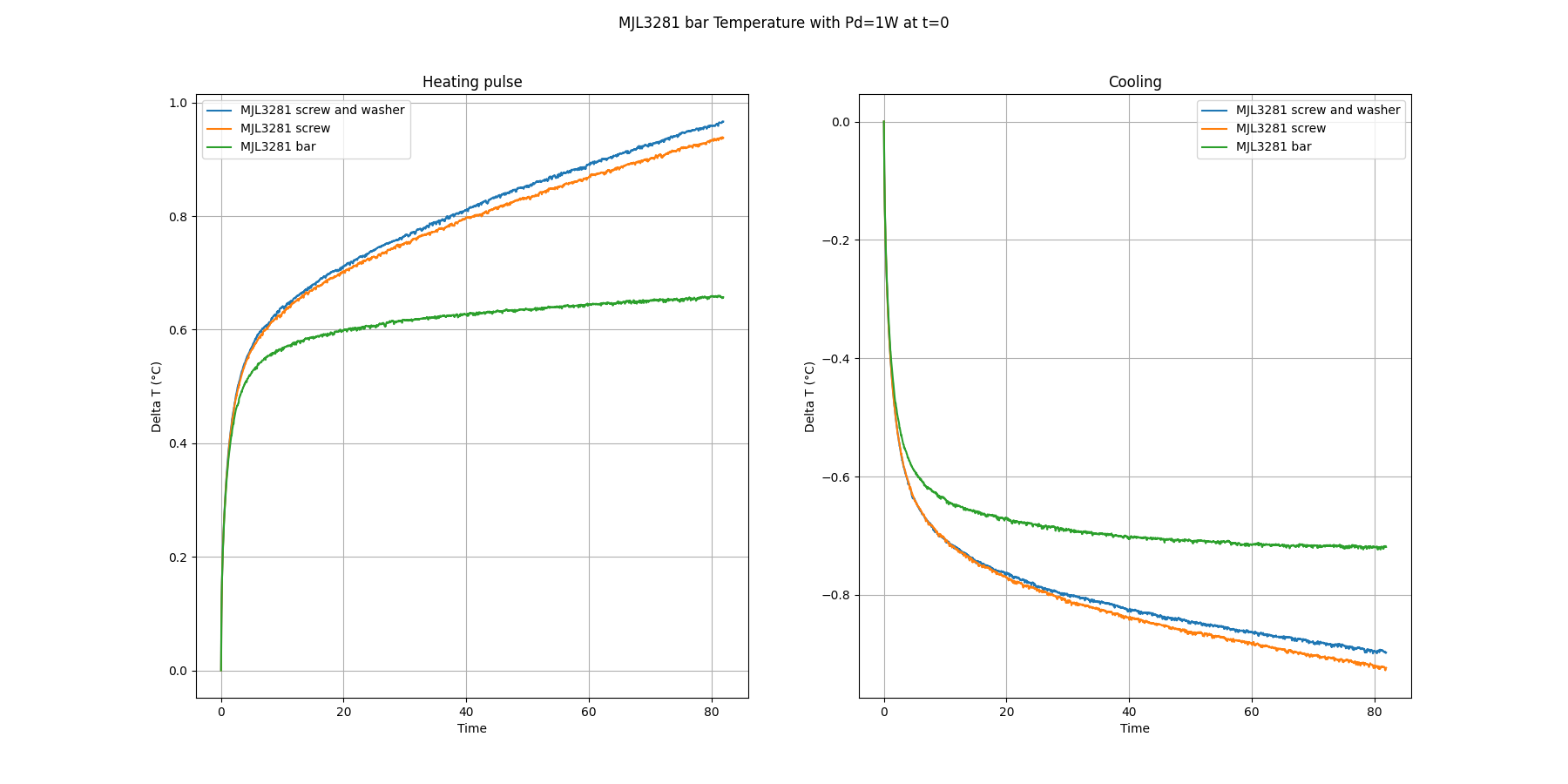

I investigated the mounting technique.
MJL3281 pressed on heat sink by square aluminium hollow tube.
versus
MJL3281 mounted on heatsink with M3 screw and washer (torqued as hard as I can with screwdriver).
In both cases, Keratherm 86/82 is used as interface material. The two heat sinks are different: one has M3 holes for the screw, the other has holes that fit the bar. So, just to look at the left part of the graph, where the heat sink doesn't have time to act, it's only between the device, the silpad, and the thermal mass of aluminium behind it.
What the curve shows is transient thermal impedance, or how much the device heats with 1W power with time. The leftmost bit where it quickly rises is the thermal mass of the chip and leadframe, then it stabilizes to the thermal resistance junction to heat sink, then it slowly rises as the heat sink heats up. So the interesting part is right after the first bend, that's where the thermal resistance of the silpad and mounting technique shows up.
Conclusions:
- With the screw no significant difference between washer and no washer.
- The bar gives 0.1°C/W less thermal resistance than the screw, a gain of about 15%
- The heat sink with the bar is thicker, which is visible in the slope of the curve.
Since thermal resistance is important not just against overheating, but against bias instability too, I will keep the bar.

I will try to compare the screw and the bar using another method: same heat sink, but the "screw" will actually be the bar, but I will place it over the screw hole instead of placing it over the die.

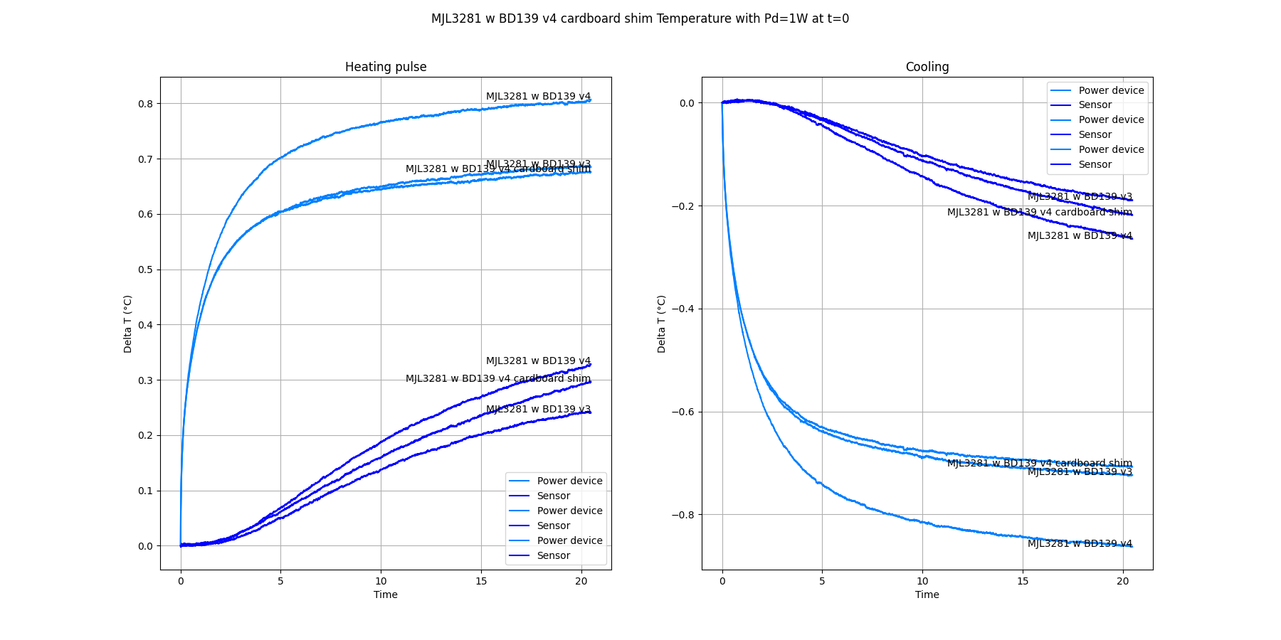

Meanwhile, request from Rallyfinnen:
I mounted the BD139 on top of the MJL3281 and did 2 tests in 2 slightly different positions. The result is that where it is placed matters a lot: without x-ray vision it is very difficult to know where to put it. Both places looked "over the die" to me.
Then I inserted a cardboard shim between the BD139 and the metal bar, to act as an insulator. It didn't result in a significant change. So the cooling or thermal mass effect from the bar is smaller than the effect of positioning the sense transistor exactly in the right spot.
EDIT: In fact thermal resistance of the MJL also changed a lot, I must have torqued it differently, or the BD139 as it moved changed where the pressure is applied... so that's pretty inconclusive.
