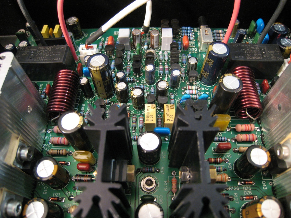

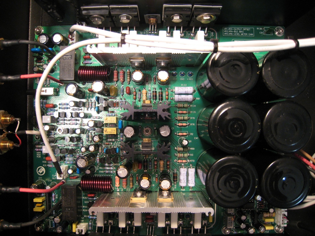

Woah😱😱😱😱 That looks way way way better than most storebought amps i've seen!!!
Awesome job!!!
Awesome job!!!

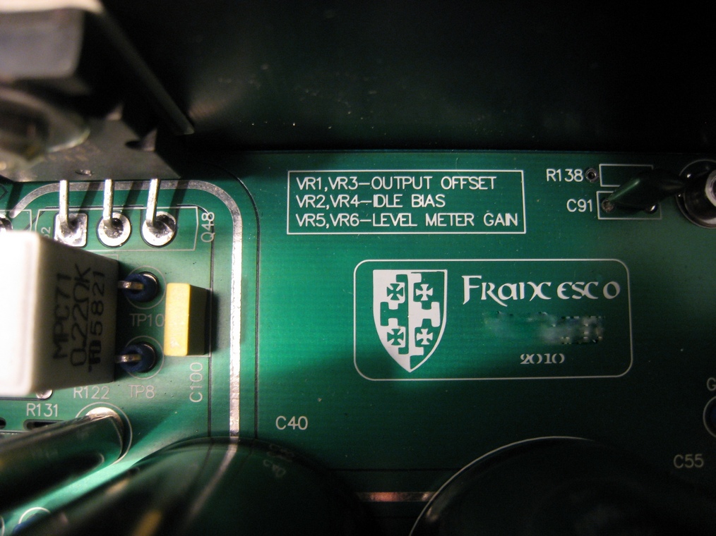

Congratulations Wb9 & Cecco.
Nice work, good pics. Lots of detail to be seen and worth seeing.

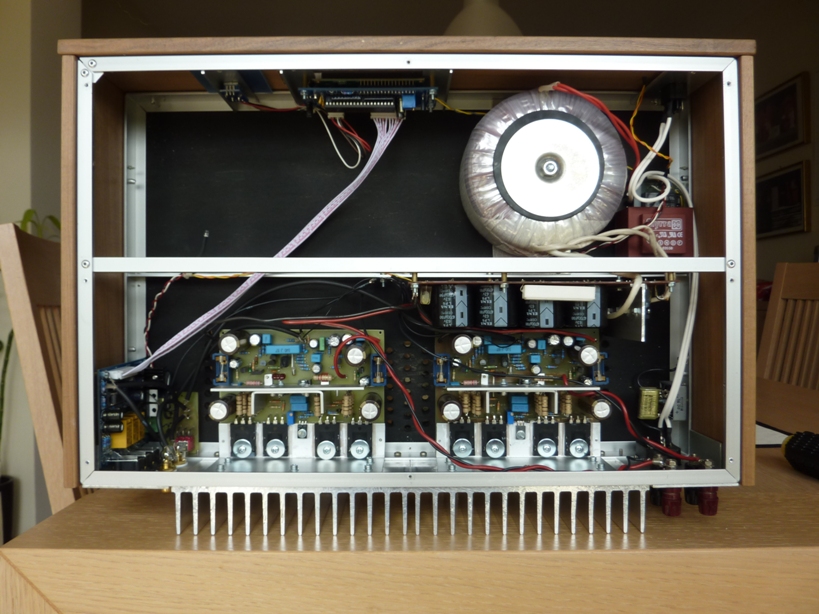

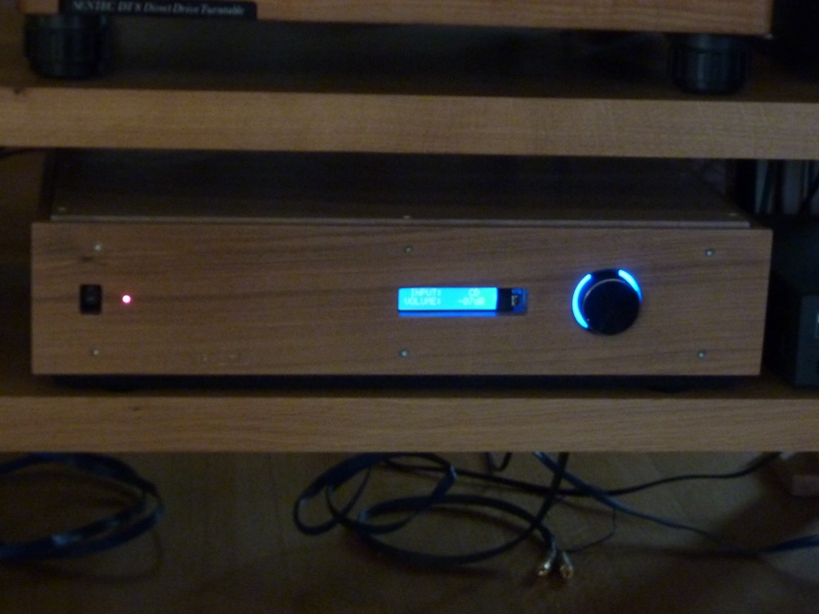

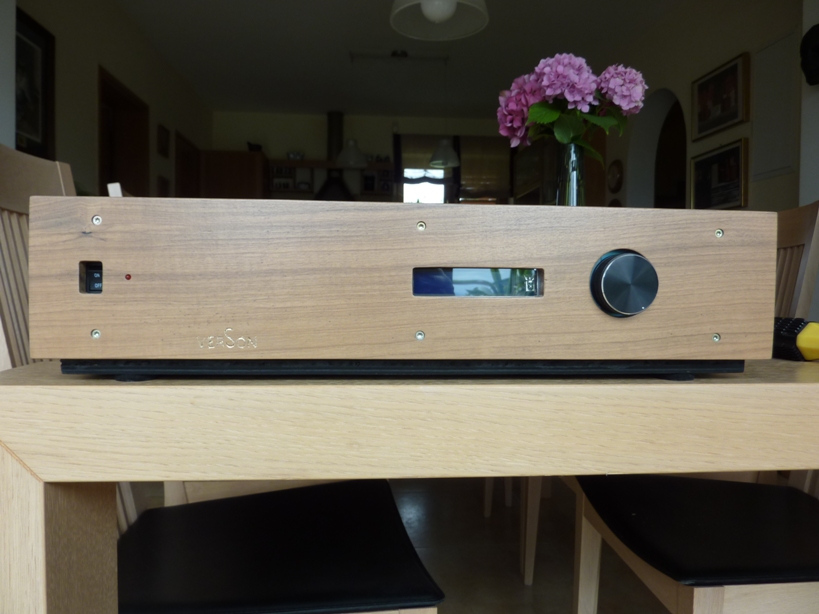

Total DIY

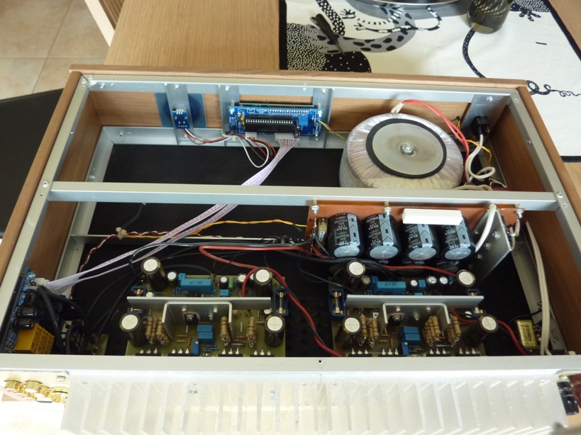

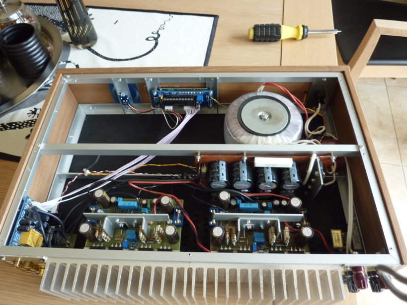

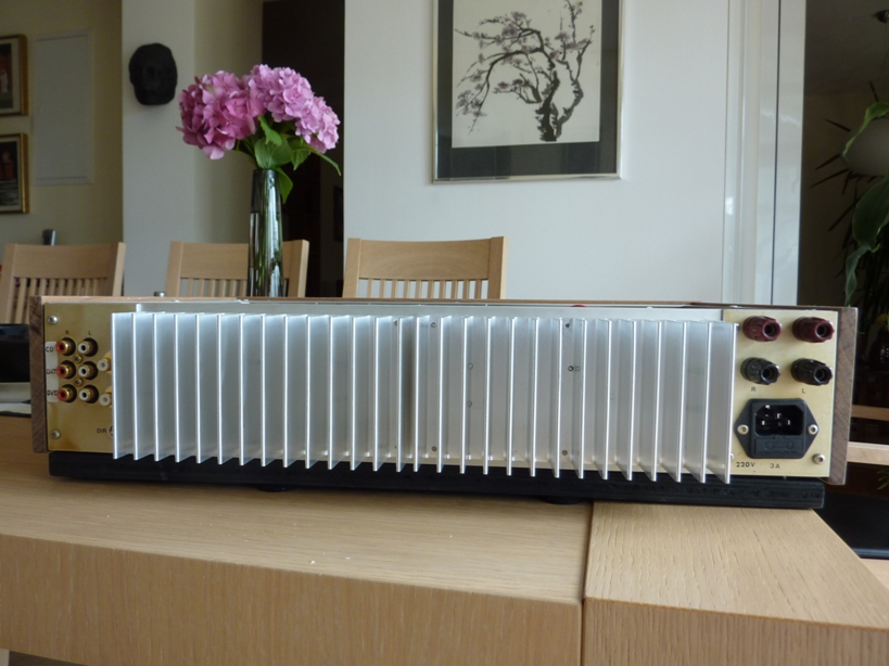

This is DIY amplifier, PCB and the box hand made. To make PCB I used transfer method(Samsung laser printer) and a box was made out of alu L profiles and wood.
Only part that I bought redy made was preamp with remote control.
For more in deep information look at http://www.diyaudio.com/forums/solid-state/186981-bootstrapsccs-t-tmc.html

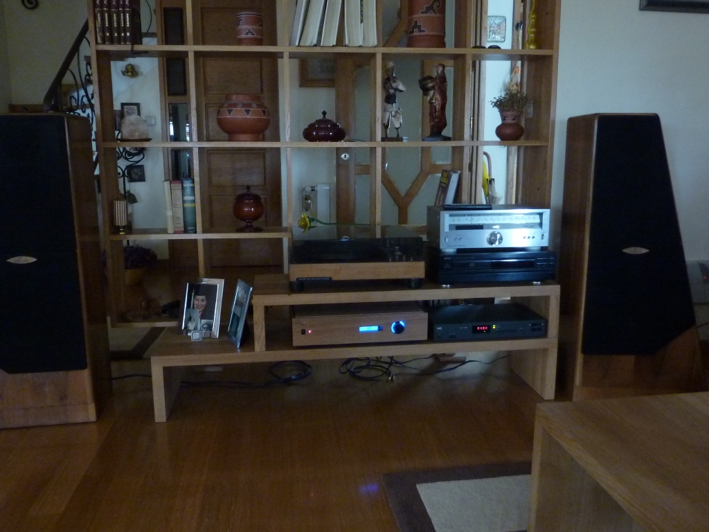

Are those JBL 250 versions/clones ?
Do you mean loudspeakers? That is an old design(over 30 years) with Dynaudio drivers, just the shape is similar to JBL.
I looked closely (your "deep" thread) and this.
Bravo , my man !! 😎
Now , how can this sound so good with "contemporary" layout and the fact that it is a modified LIN amp ? I asked this question in developing just such an amp and how/why the little technical refinements would better the sound.
What you listen to might prove the "purists" wrong ? 95% is the circuit itself , short of any real bad layout decisions. You might get that extra 5% by "pulling out hair" (fussing) over layout/ grounding ... but can you "hear" that 5% ?
Might just be technical refinement just for the sake of technical refinement ?
As the output stage gets larger ... these little "technical" issues might show themselves , but- what works .. works!
PS- you have enough room for a dual mono power supply ...
Good job (even the case) true DIY !

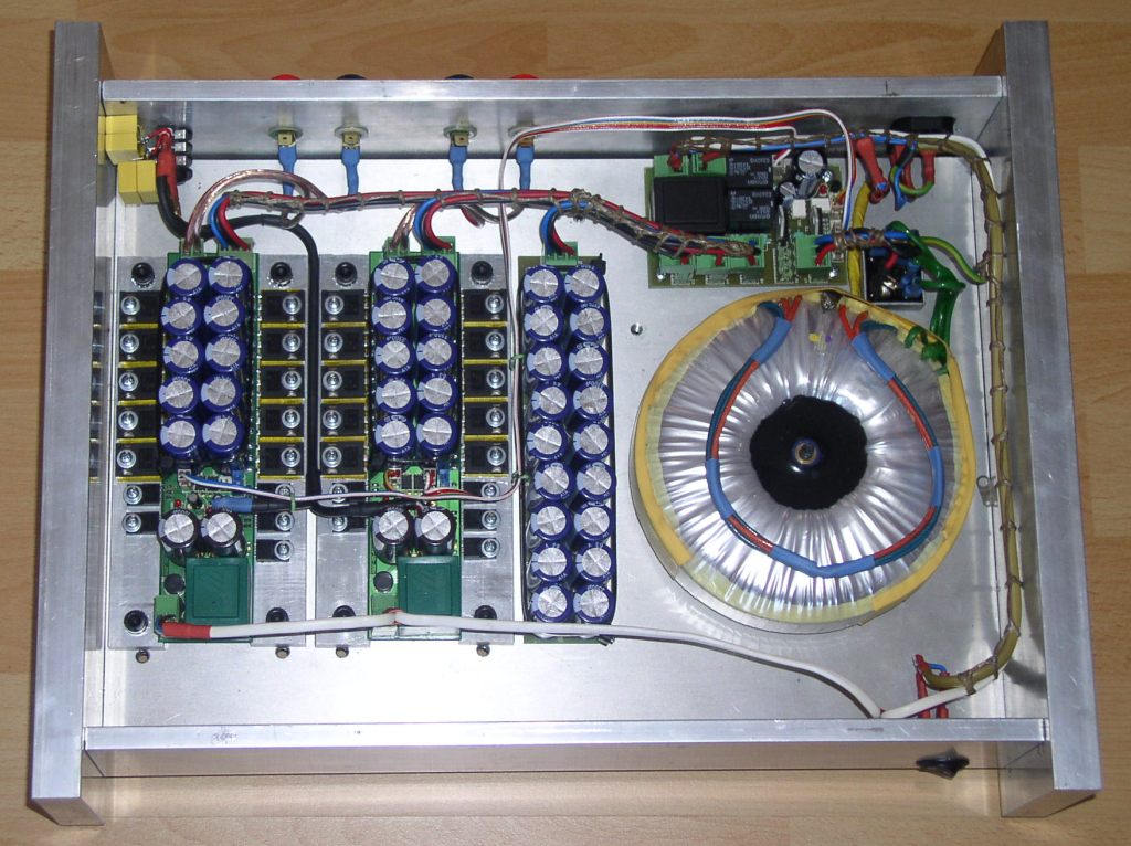

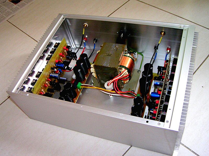

federman even though i have to say that this is a pretty neat and clean job and box is really heavy metal made i wonder if cooling is efficient enough
Efficient enough, Sakis ? Maybe for 2x100W of output power, but Federmann declare much more higher...😎
Ahh, but turned upside down, it's a grill plate with a hot zone and medium heat areas.
LOL
