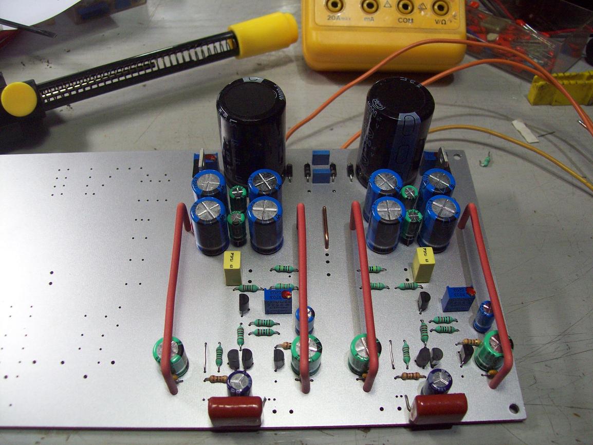

Look up transitional miller compensation here on DIY; it's also well-explained in Bob Cordell's book. The idea is to derive feedback from the final output for as wide a bandwidth as possible, thus reducing HF distortion (I got a factor of 5 improvement at 20 kHz). In my design, R9 and C4 set a "crossover" at 617 kHz, above which feedback comes from the VAS output. That avoids the extra phase shift in the output stage. It does take a bit of fiddling, and there will always be tradeoffs, but I'm very happy with the results.

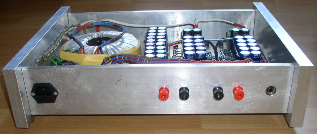

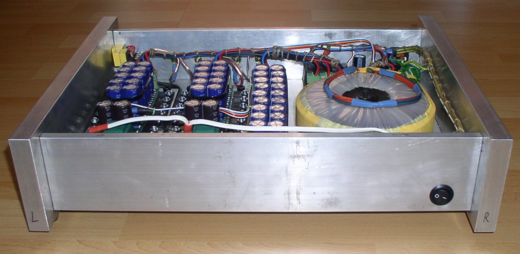

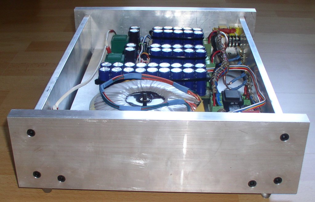

federman even though i have to say that this is a pretty neat and clean job and box is really heavy metal made i wonder if cooling is efficient enough
Material is 10 and 20 mm aluminum. In power 2x300W/4Ω temperature is less than 70 ° C. The Case is black, then the temperature will be lower. In front of the room for preamplifier.
Material is 10 and 20 mm aluminum....

With the transformer, which you declared at your pages ( from DPA 380 ) you can't get the output power 2x300W, Federmann...and norm for the consumer electronic says, that any part touchable by finger, can't have the temperature higher than 60°C... personally I really doubt that this case can cool this output power down...enthusiastic voices of yours, gentlemen, aren't right...
You are right DPA380 is overheated, and turn off, as it is written here http://i.imagefra.me/2e4igrg5.jpg My HQQF but treads perfectly.
But I can read about DPA380, after several minutes of loud traffic overheats and shuts down. Transformer very noisy, etc.
My transformer is not noisy, my amp can withstand continuous operation loud.
Yes Federmann...it was in early ninetieth...and maybe hence this amp have here so much people, probably they likes this overheating... 😀
Know you say to Slovanet that 2x300W amplifier must have a consumption of 850W! My middle current consumption is 0.5 A! (230Volt).
Amazing, Federmann...by output power 2x300W you have consumption only 115VA...run quickly to the patent office...😀
Measure electricity consumption, please! Consumption of electricity (RMS), while listening to music, is always much smaller than the maximum amplifier power (PEAK)!
