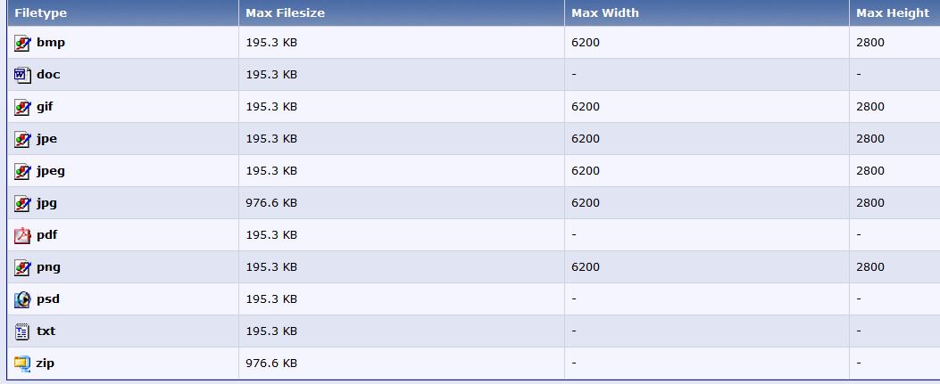

I seems you are withing the forum limits
See the attached image and you will see you are not exceeding.
My computer resize automatically to put image inside the screen.... i do think others can do also.
Do not worry with that...when not allowed, then moderators will inform.... as no moderator have complained you can ignore criticisms..... oh!... i forgot, i do love big images.

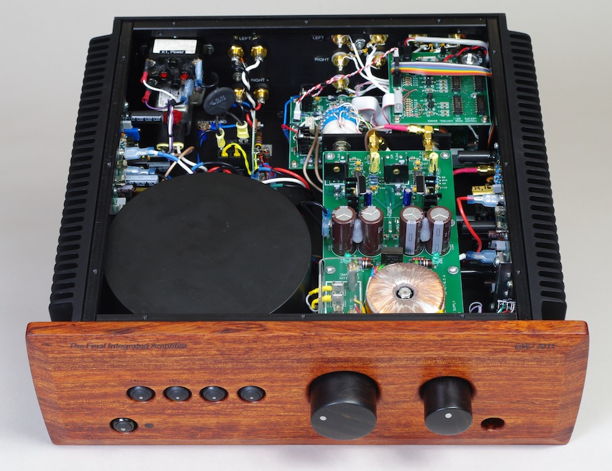

My Final Integrated Amplifier
After lurking silently in DIYAudio for some time, and building audio gear for 35 years, I am pleased to present what it likely my final audio project, an integrated amplifier. I won't post too much here; there are lots of details and downloads on my website My Final Audio Amplifier. I will try to monitor this thread to answer any questions.
Since the power amp is usually of greatest interest, I attach the schematic here. It uses Exicon lateral MOSFETS, and a derivative of transitional Miller compensation. Drives 2 ohms all day long without overheating, NO stability issues or other bizarre behavior, and I'm certainly pleased with the sonics. Maybe the most interesting thing is that I used a homebrew vector network analyzer (VNA) to characterize components and do the compensation. I plan on writing a little article about VNA applications in audio work soon. It's a very powerful tool.
Thanks to all the gurus who hang out at this site, and all the wonderful hackers who make us think and hope we can build something better next time.

Cool ...
WOW ! Fine build, man. I see it is a simple LIN amp driving MOSFETS with MJE340/350's. How does it sound ? I was thinking of a FET version in this topology. Unique lead compensation in the feedback circuit, too .... explain ???
Beautiful craftsmanship , I am shamed to buy my used amps on fleabay (not enough tools).... 😀
I'm more than satisfied with the sound, though my aging ears are now troubled with tinnitus. That's why I "downgraded" from my fancy Rowland gear. But I can say that it has great low-end control over my Thiel CS3.6s (2 ohms!), not a trace of harshness, and a pleasing soundstage.
Look up transitional miller compensation here on DIY; it's also well-explained in Bob Cordell's book. The idea is to derive feedback from the final output for as wide a bandwidth as possible, thus reducing HF distortion (I got a factor of 5 improvement at 20 kHz). In my design, R9 and C4 set a "crossover" at 617 kHz, above which feedback comes from the VAS output. That avoids the extra phase shift in the output stage. It does take a bit of fiddling, and there will always be tradeoffs, but I'm very happy with the results.

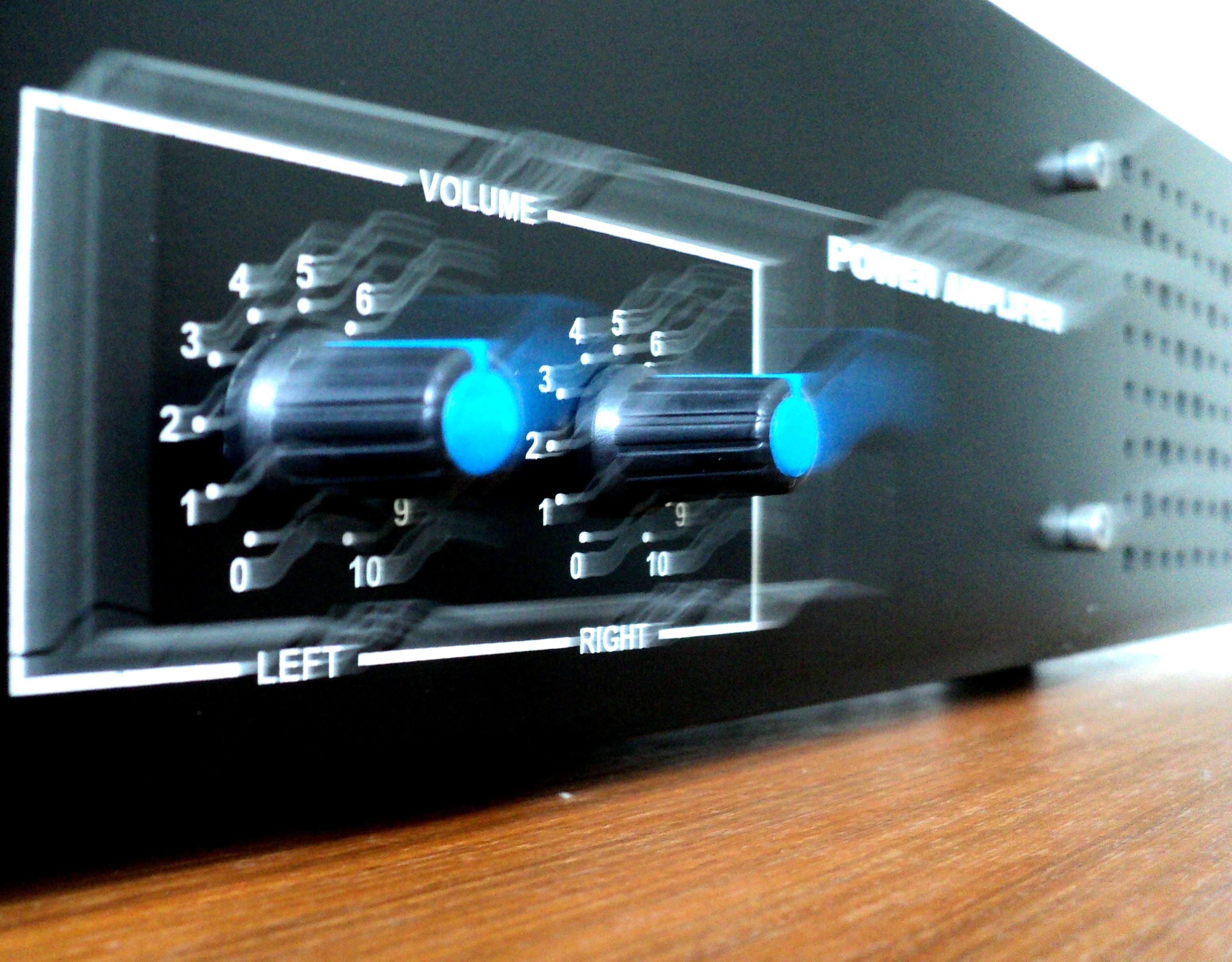

...Somehow labelling the panel with junior's cub scout wood-burning kit would not cut it...
I can send you a better pic... It was a CO2 laser etch. The small font over the buttons was only 1/8" high. Beam waist was 10 mils.

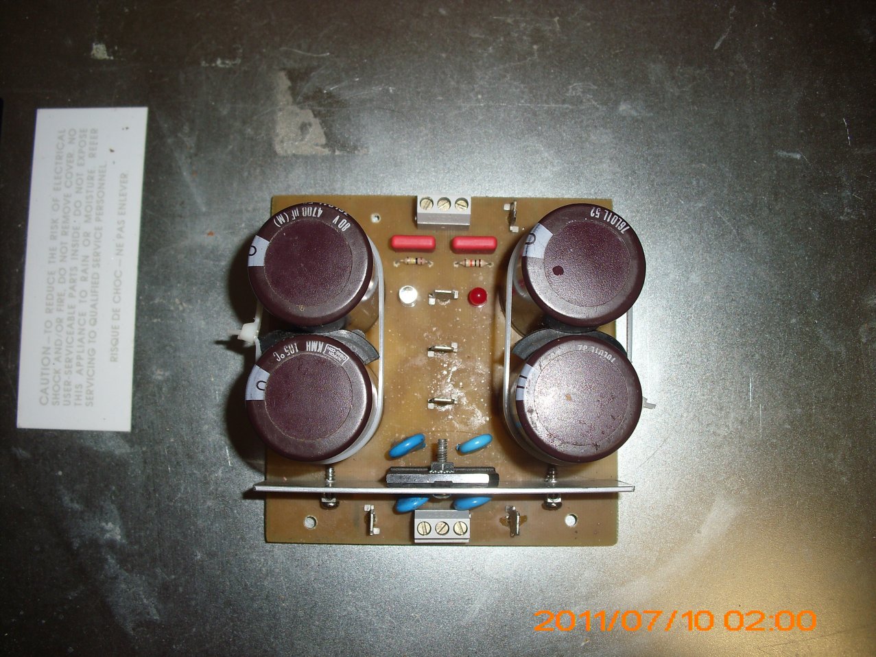

OK Guys, the time for jokes is over. 😀😀😀
After a quick training with my first baby:
http://www.diyaudio.com/forums/chip-amps/79303-chip-amp-photo-gallery-112.html
I would like to present you my last creation.
I just finished it. Need still some more cleaning.
