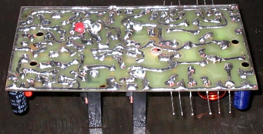

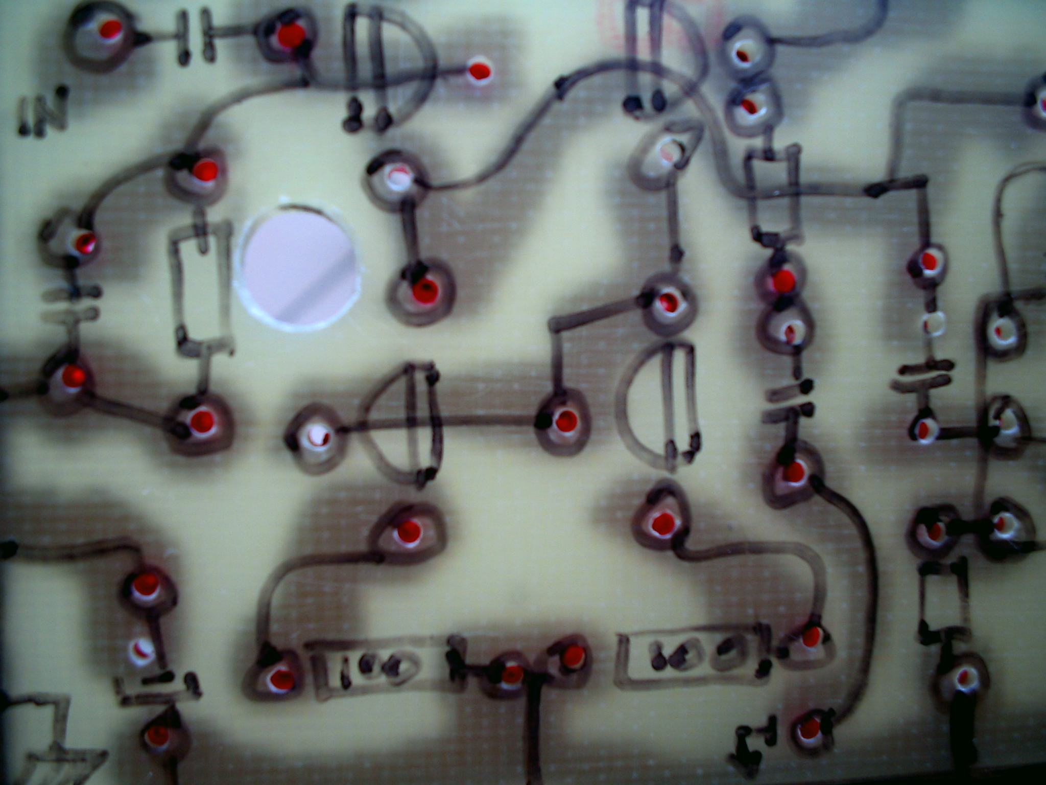

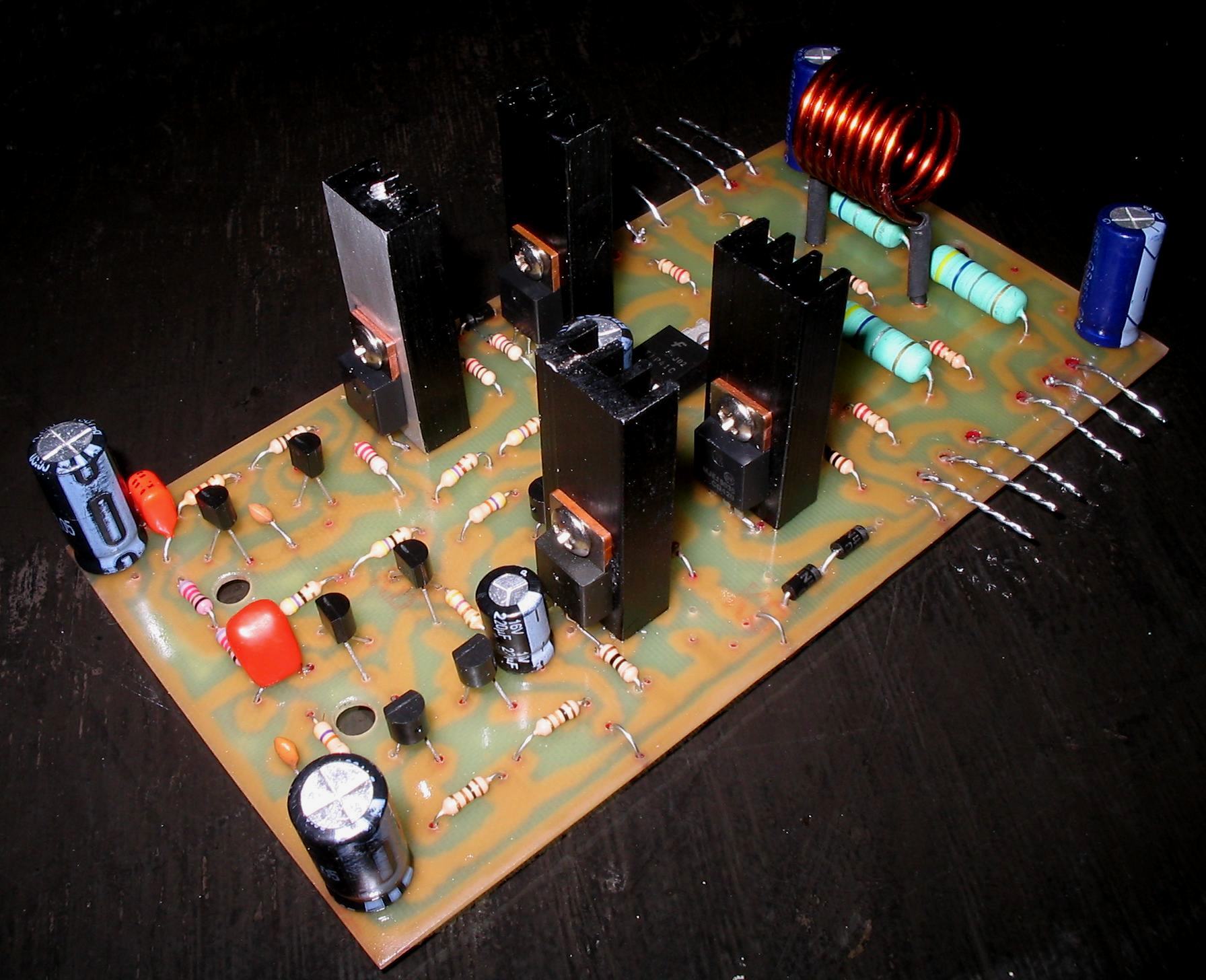

Want to travel to the past in a time machine?
Look the way we used to make amplifiers 40 years ago.... without computers, or software, or scanners or printers... the stuff was not discovered..only thermal printers and some Z80 computers.
The way this was made... with pen, nail polish, drawing and corroding using chemical products available since the fifties constitutes in a free ticket for your to travel to the past.... the ones who lived through that era will remember ... and young people will understand as we did when there were no computers that could help us.
A diy, handmade and homemade board style.

I like it. So, nail polish works well as etch-resist? Permanent marker is not so good for me.
I just started etching PCBs, so I still have a lot to learn. I have been using the laser printer at work and hydrochloric acid/hydrogen peroxide mixture. The printer I think is not good quality because the transfer of the toner to the PCB is never perfect, no matter what I try. That blue stick n peel stuff is expensive so I will not try that. I cover every trace with a layer of solder and clean it well to protect against the possibility of hairline trace cracks.

Nail polish is resistant to acid attack... reason why i am using it
