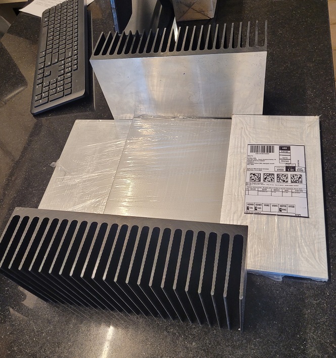

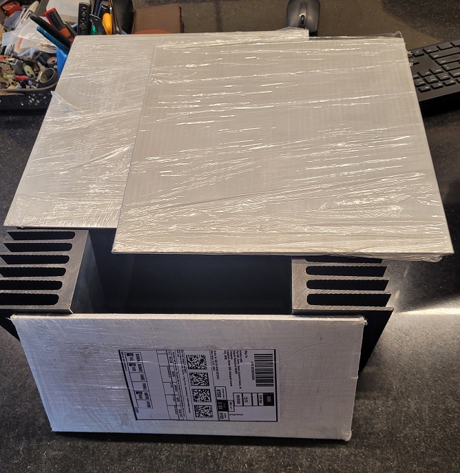

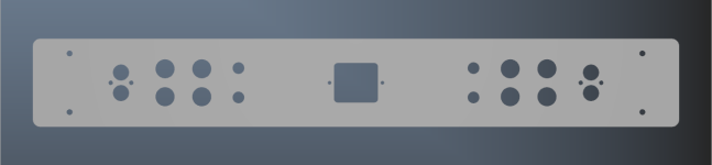

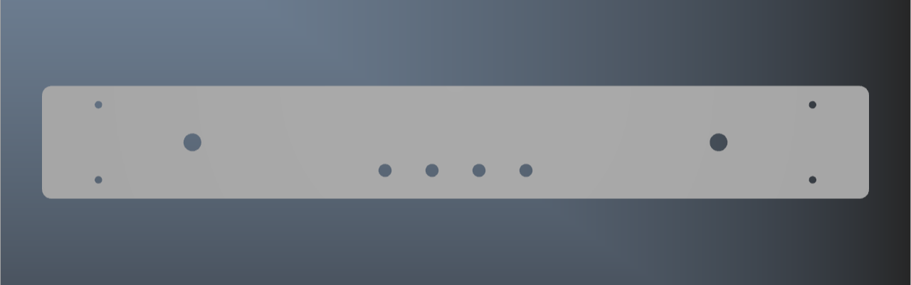

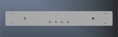

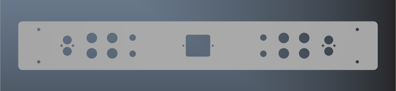

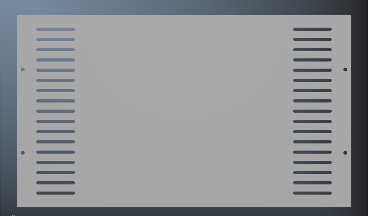

I have checked all options available over there, not helpful or useable size available over thereCheck on Amazon
let me ask again , cut to size as per needs of buyer in brushed finish

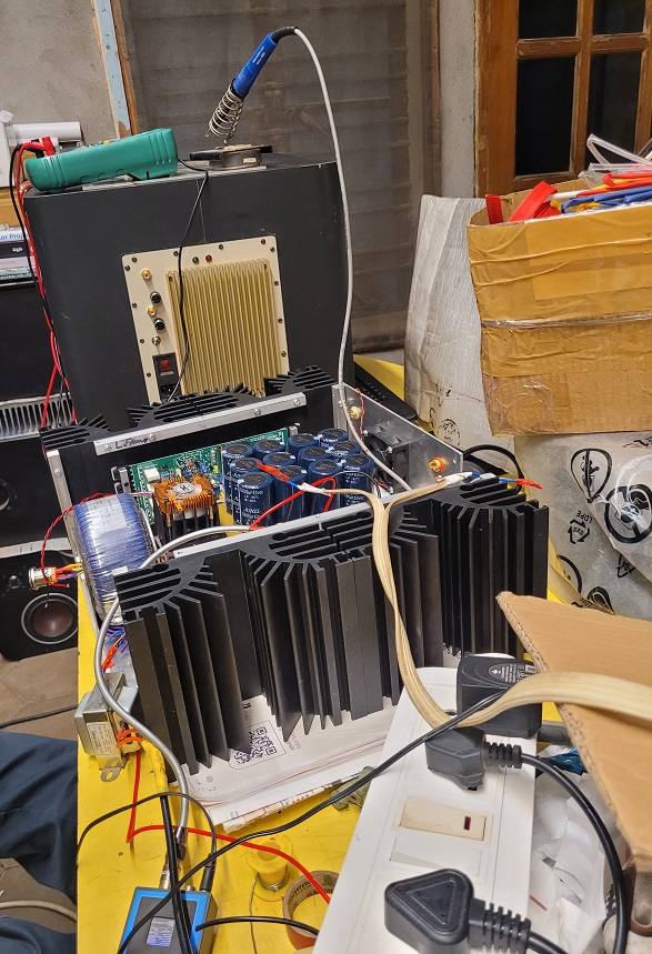

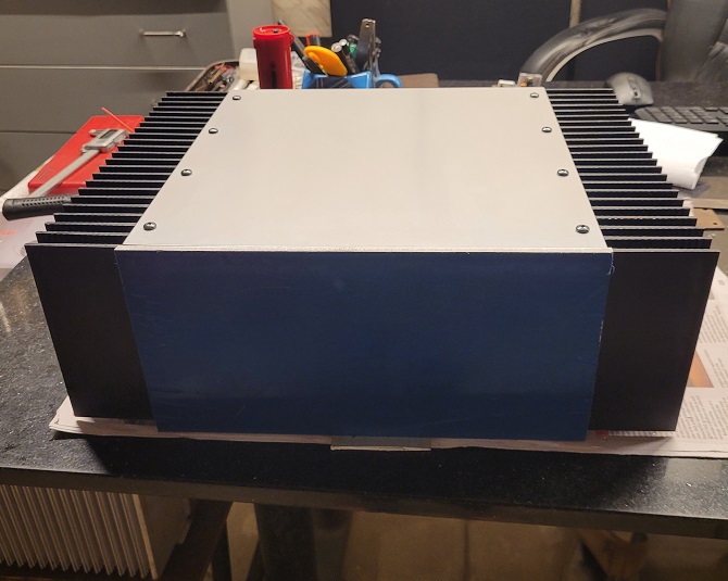

I have used these plates and the same profile heat sink you mentioned, to built couple of chassis.
Further if you want any other sizes, buy bulk sheet and get them laser cut.

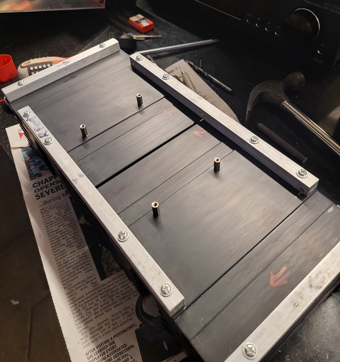

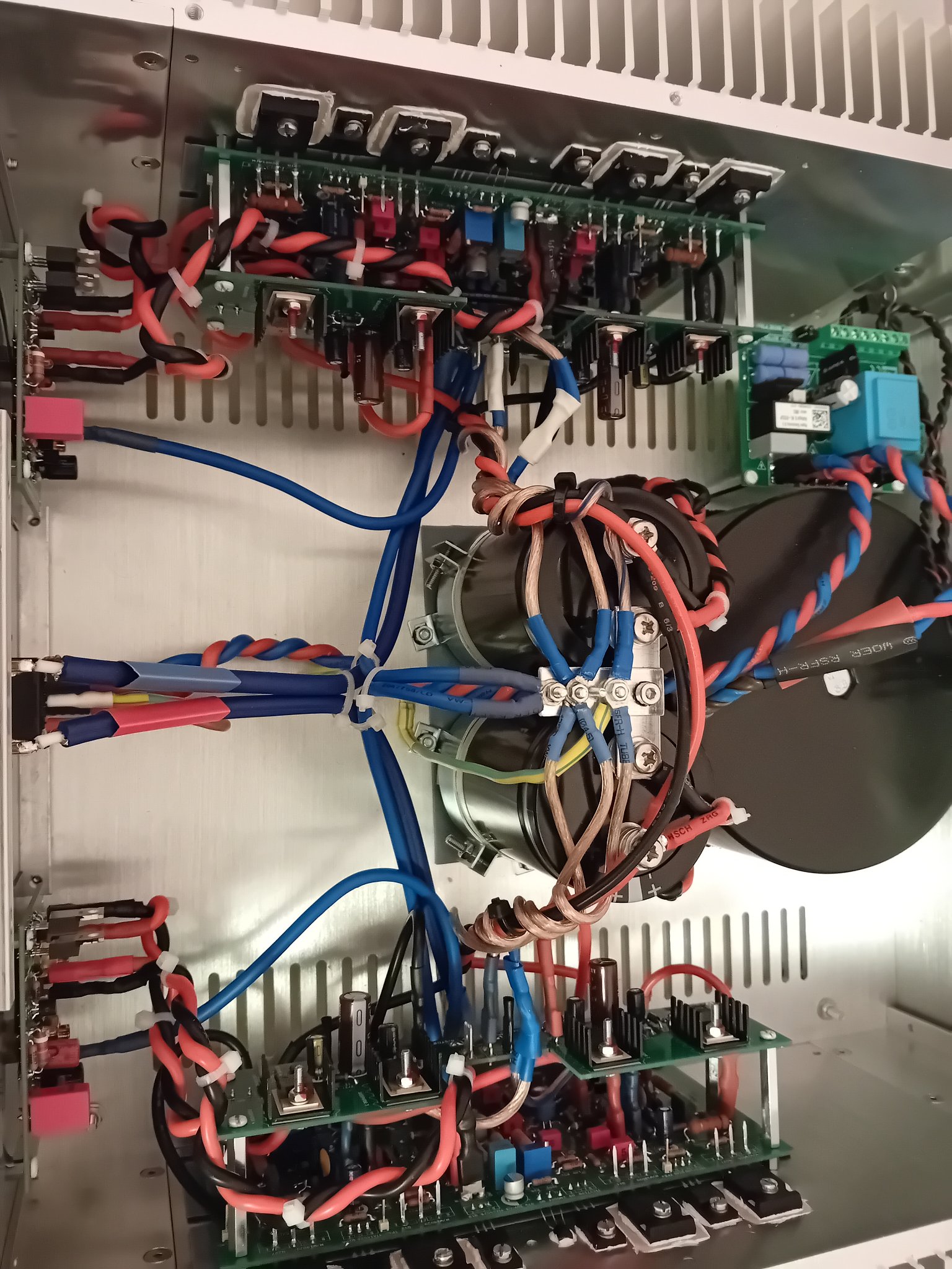

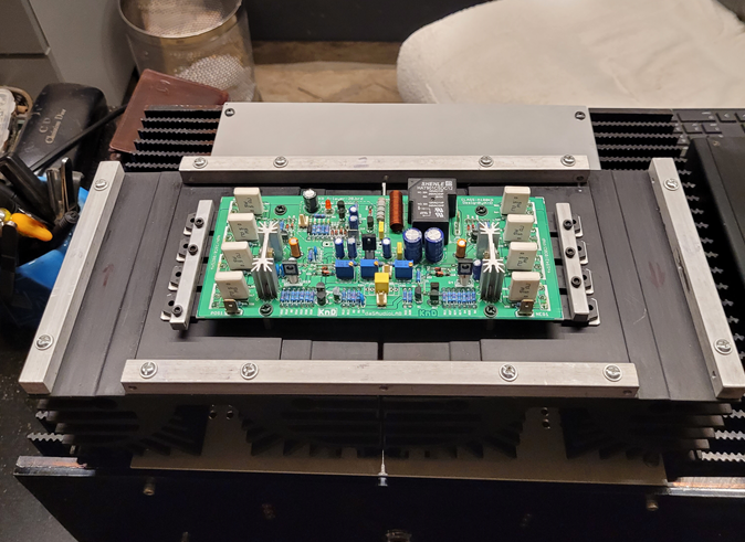

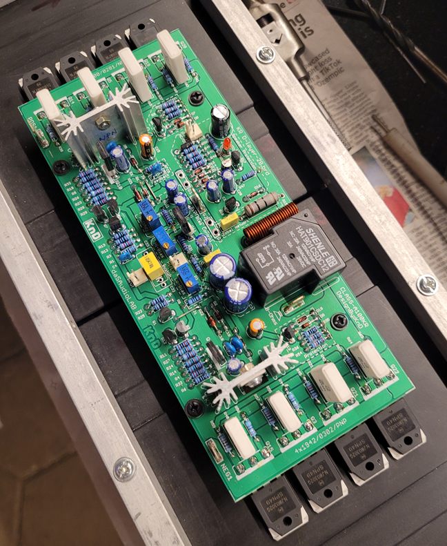

Module mounting process on heat sink... M3x12mm standoff.
Power transistors clamped with 8mm sq aluminum bar....

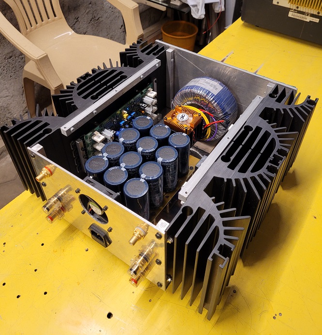

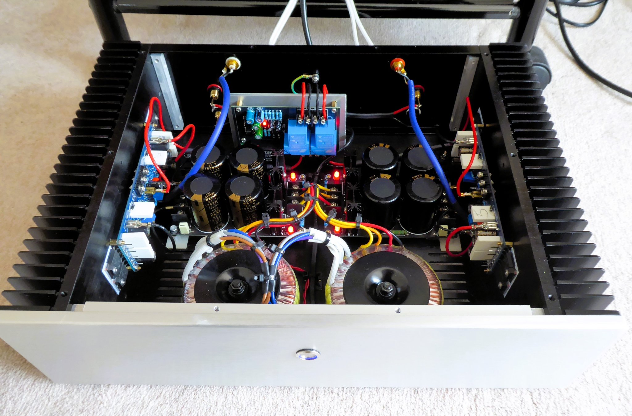

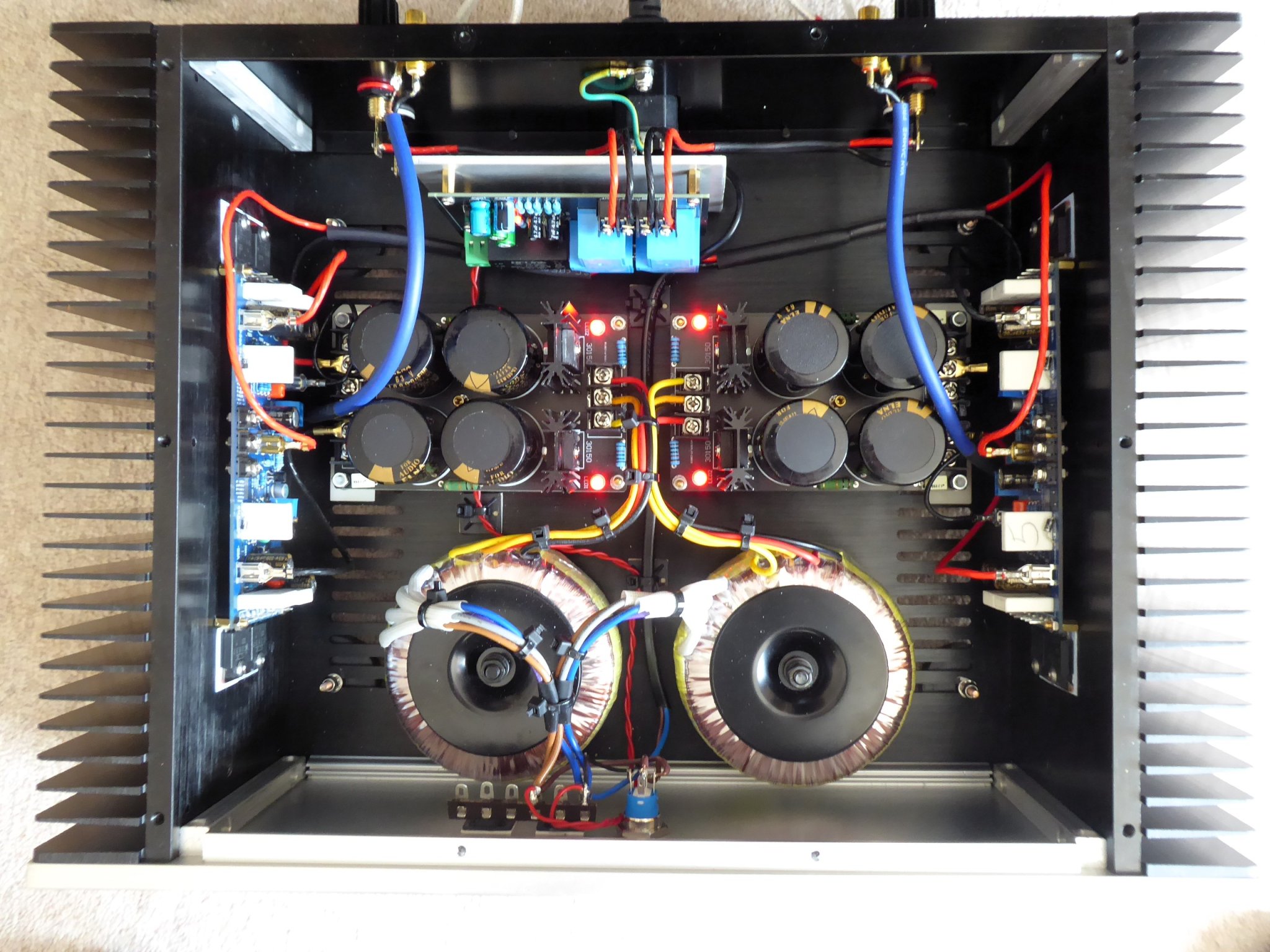

Back panel with input, output, IEC mains socket and a 60mm cooling fan...

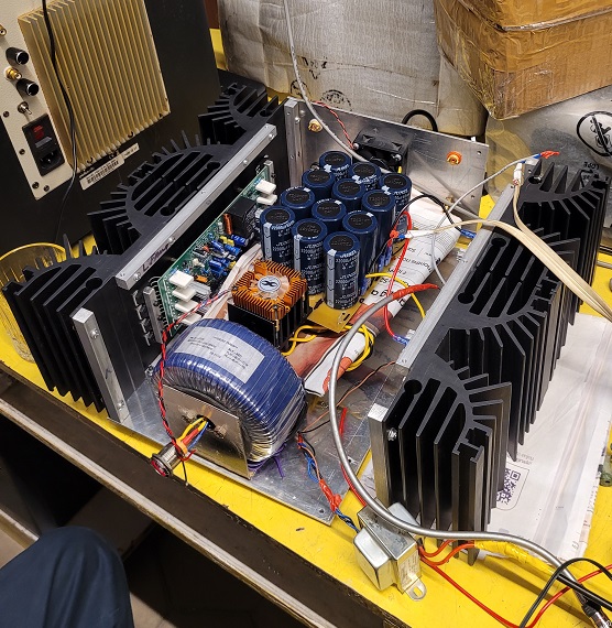

50A Bridge with fan and PSU raised on standoffs... mains filter and soft start, below on the bottom plate.
Ready for hook up wiring...
One module wired... checked all the voltages, mains, DC Rails, dc offset, speaker protection... all good for testing.

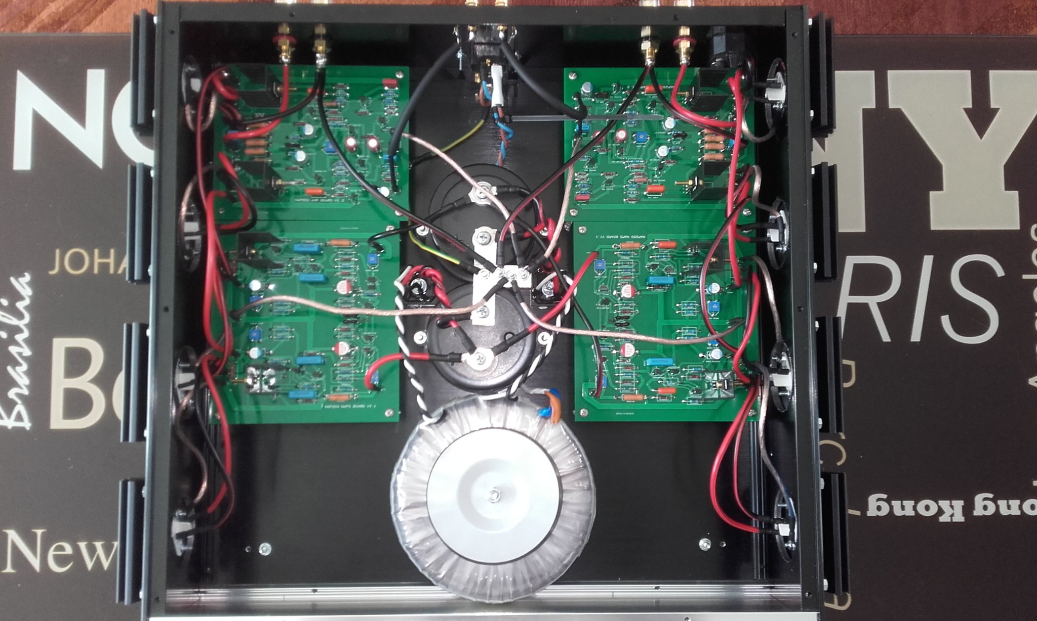

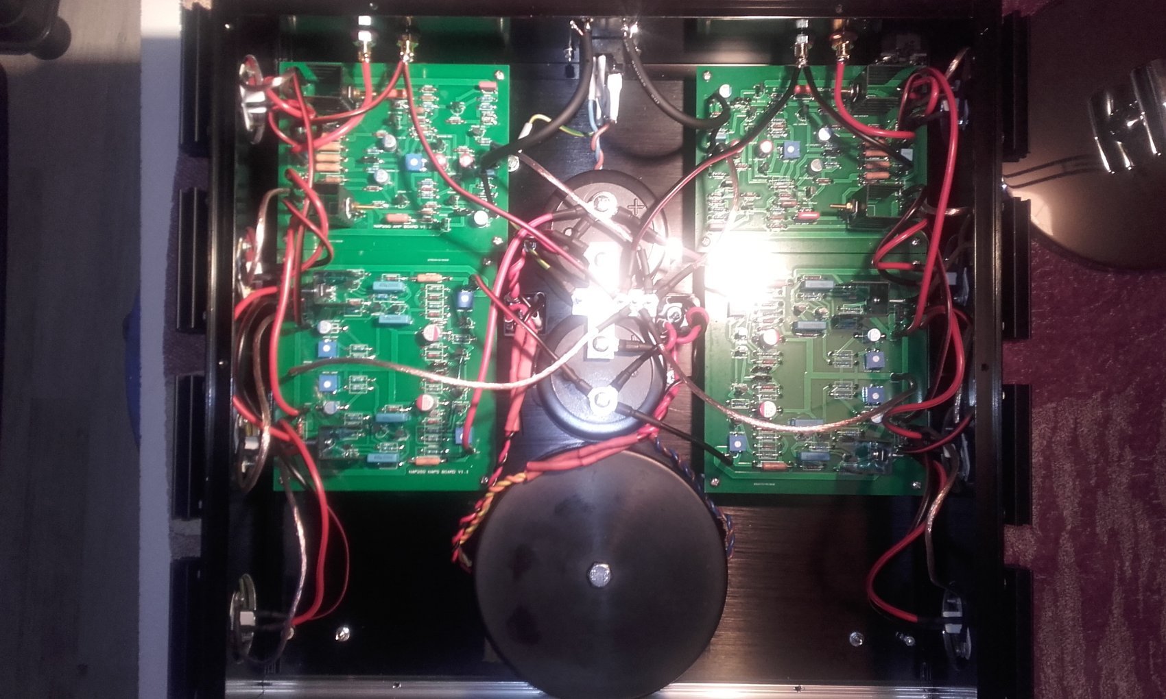

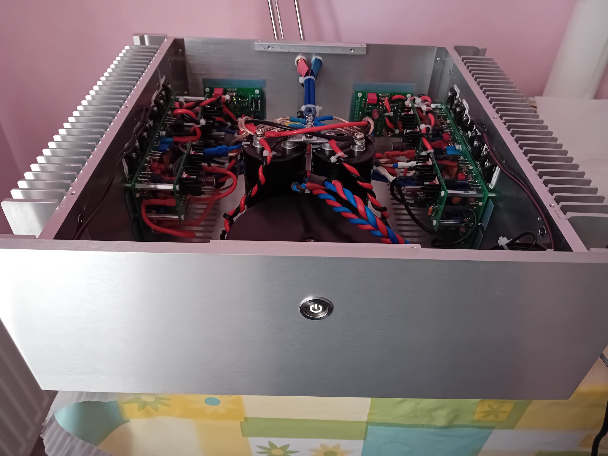

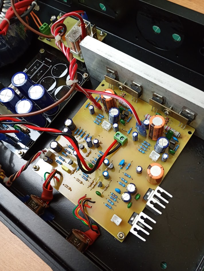

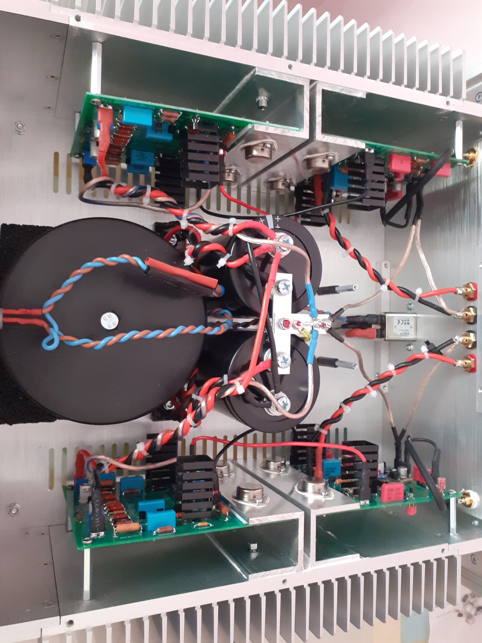

Hi everyone, I just saw the latest amps posted here.
@hydrovac I really like your build; it's very clean, all that's left is to finish it.
@astx I just discovered your work over the past years, with all the versions of your amps you've designed. It's a very impressive amount of work; I'm amazed.
Your latest amplifier must have been very complex to build; you obviously stop at nothing.
