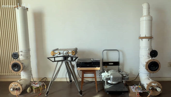

Sure, this photo is one of my current setup, all DIY stuff except the source. Speakers are MLTL, capable of down to 20Hz-6dB for organs. Bottom right is another amp which will be posted later.

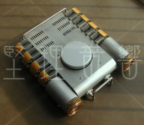

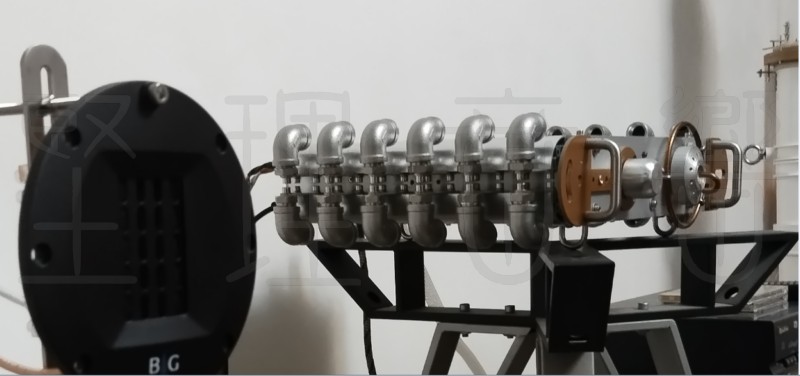

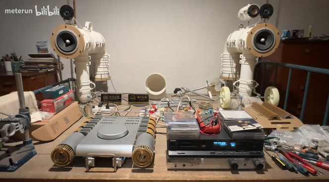

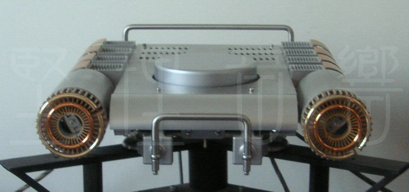

Just when I thought all amplifiers looked boring. . .Meterun Integrated Amplifier
View attachment 1409182View attachment 1409183View attachment 1409184View attachment 1409185
SPECs
Dual mono class AB integrated amplifier
Quasi DC amplifier, here defined as coupling-cap-less and with sufficient tolerance to input signal DC offset, such that the offset is not amplified, while the audible low frequencies are preserved.
Independent power supply for each stage, thereby lowering the interference between stages
front-end topology: Multi-stage differential
power stage: Push-pull MOSFETs
Bandwidth:
MKIII: 4Hz-180KHz-3dB
MKIV: 2Hz-120KHz-3dB
Power per channel: 100W 8 ohms/195W 4 ohms
Input impedance: 47 Kohms
Output impedance:
MKIII: 0.05 ohms
MKIV: 0.03 ohms
Negative feedback: Limited amount
Noise level: Quiet as in deep sea
additional features: Delayed switch-on, instantaneous turn-off, speaker DC protection, electronic channel selection.
Input terminals: 4 x RCA
Output terminals: Banana plugs
Operable parts: Power switch, volume control, input channel selection
No remote control
Chassis: 430x450x130mm
Weight: 15kg
A work of art! 👍

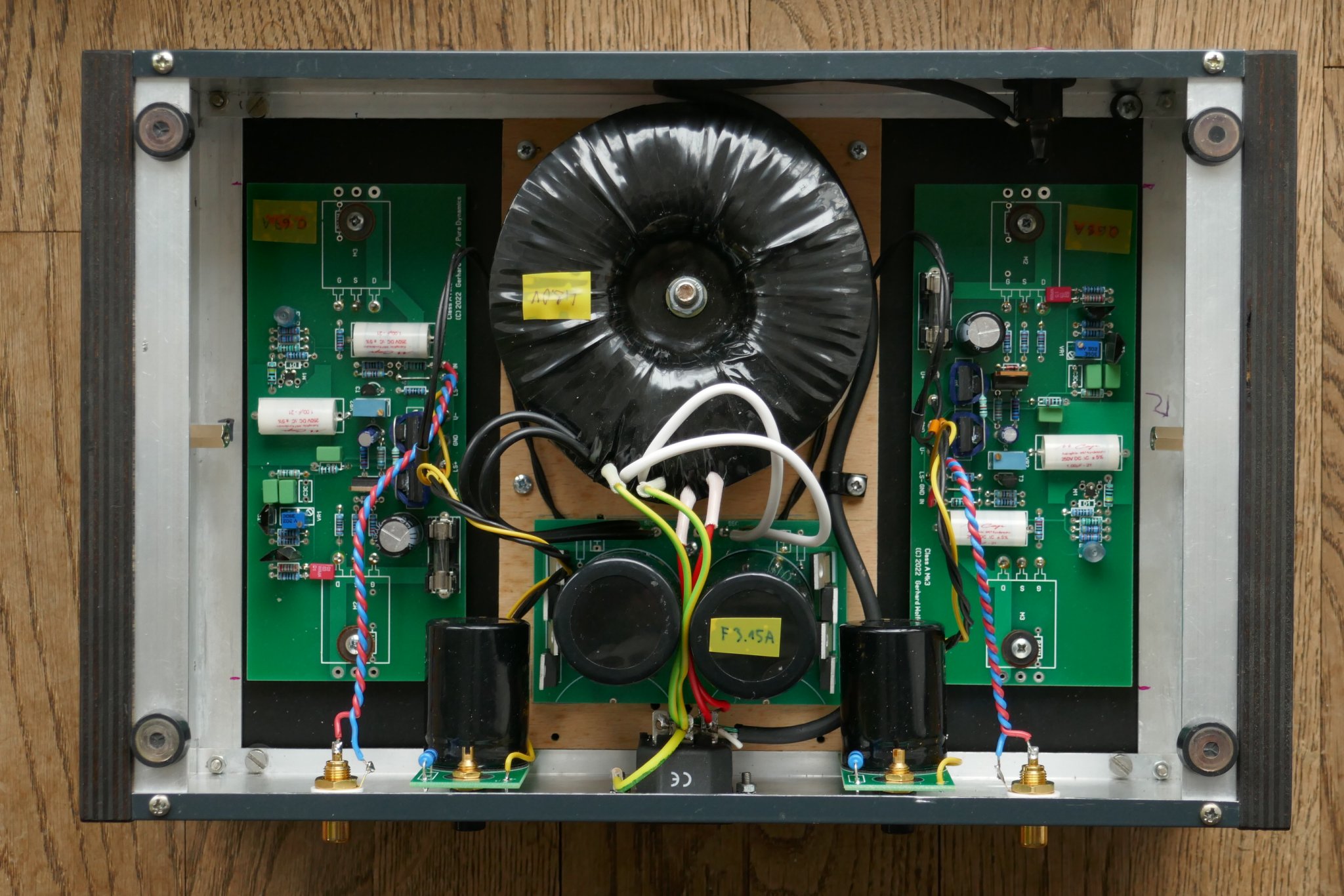

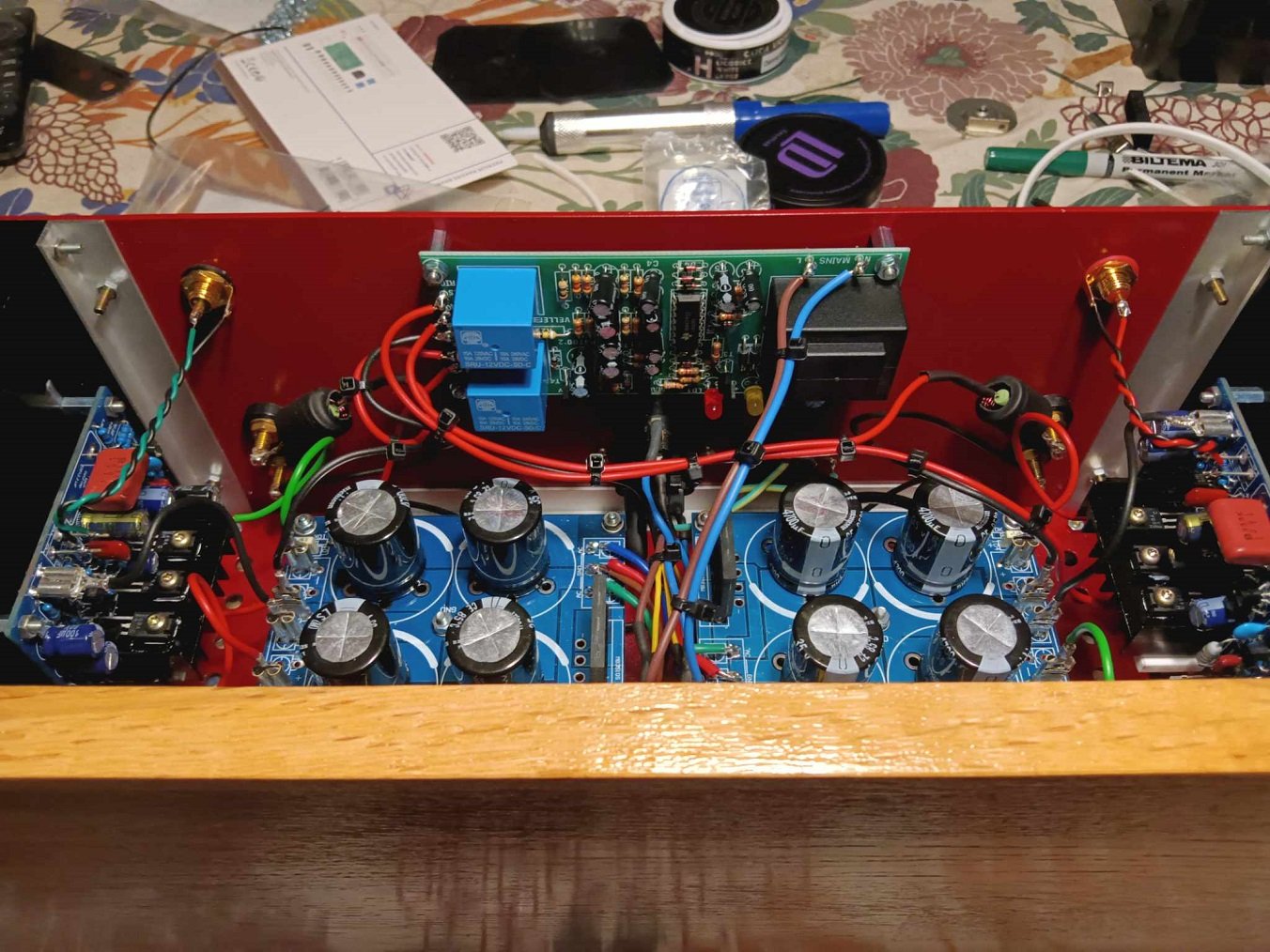

My recently finished dual mono MX50SE build:

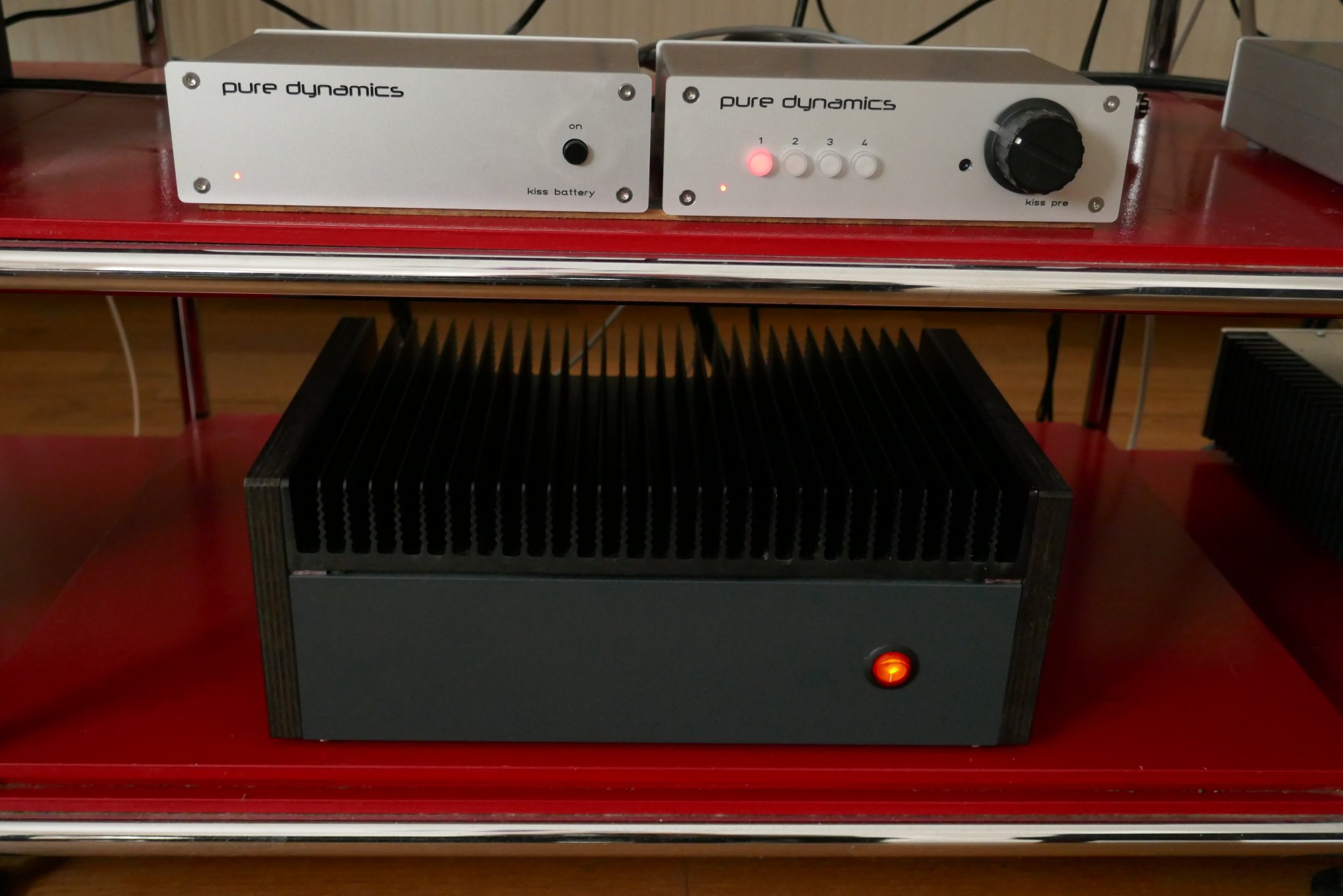

This is my prototype of the latest Mosfet power amp I developed for Pure Dynamics, a small Austrian high end company. For easy access the bottom is open, the final product looks quite different (https://www.puredynamics.com/produkt/class-a/).
The amp features lateral NMOS-Fets in an SRPP configuration.
Biasing is a version of Class A I call CCP ("constant current product", because instead of the sum it is the product of the push and pull currents which is held constant). Distortion and output impedance are minimised by a Haksford style error correction scheme.
You also see two components from the KISS series I developed for Pure Dynamics, a Li-Ion battery power supply and Jfet preamp with remote volume motor control.
Gerhard

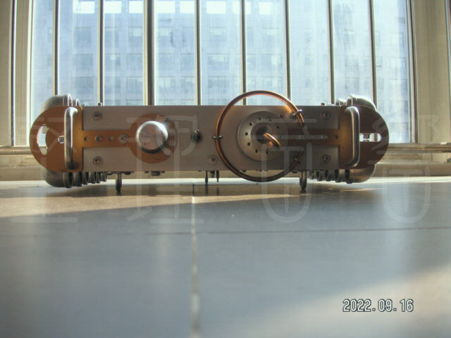

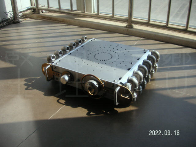

Ionic Integrated Amp
The case design was based on the classic Greek Ionic Order, it looks like a complex integrity, yet grown from a simple cubic box. The prototype costed almost 3 years to complete. There are 2 versions: MKX and MKY. Major difference is that MKX has NO global negative feedback.
Ionic MKX SPECs:
Quasi DC amplifier
uV-level DC supply ripple, no large electrolytic cap (anybody done this before?)
Front-end topology: complimentary differential
Power stage: Push-pull T-circuit BJTs
Bandwidth: 3Hz-100KHz-3dB
Power per channel: 100W/8 ohms, 180W/4 ohms
Input impedance: Mega ohms level
Output impedance: 0.5 ohms
No NFB
Operable parts: Power switch, volume control, input selection
No remote control
Weight: 12kg
Ionic MKY SPECs:
Quasi DC amplifier
Front-end topology: differential cascode
Power stage: push-pull T-circuit BJTs
Bandwidth: 2Hz-100KHz-3dB
NFB: limited amount
No remote control
Weight: 12kg
