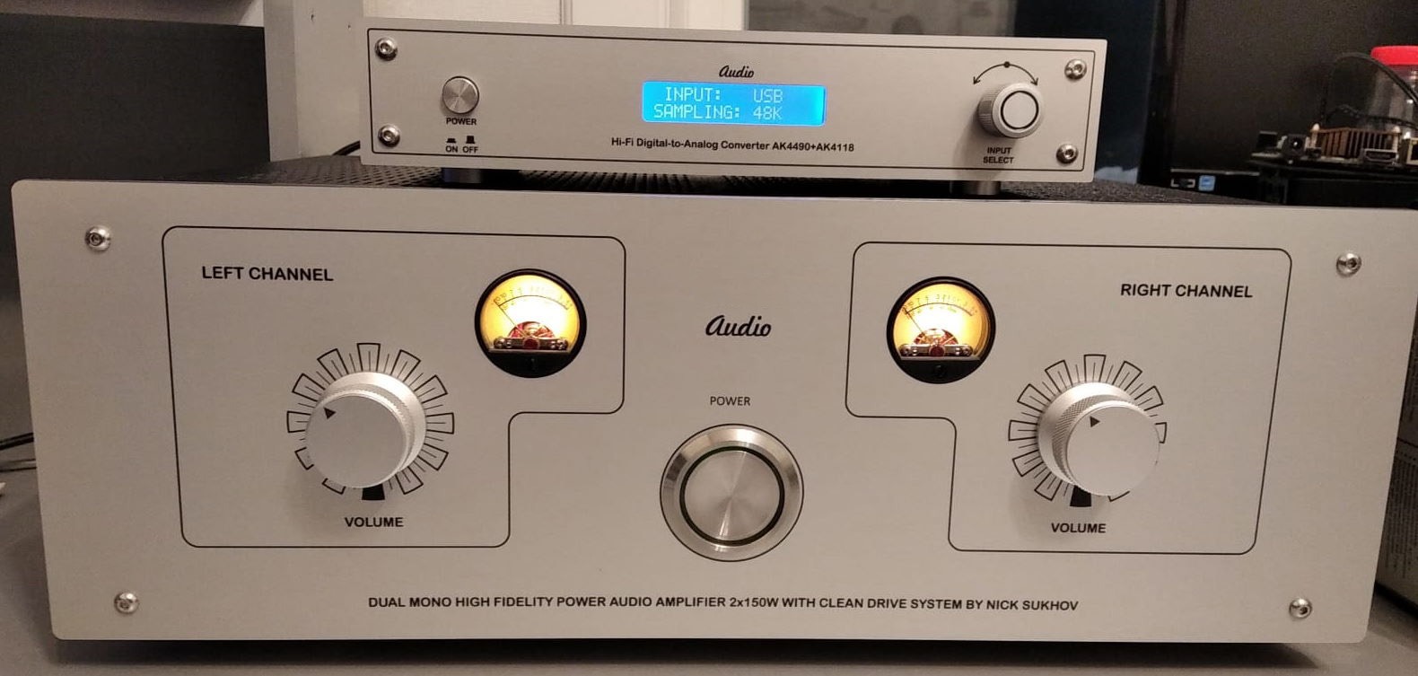

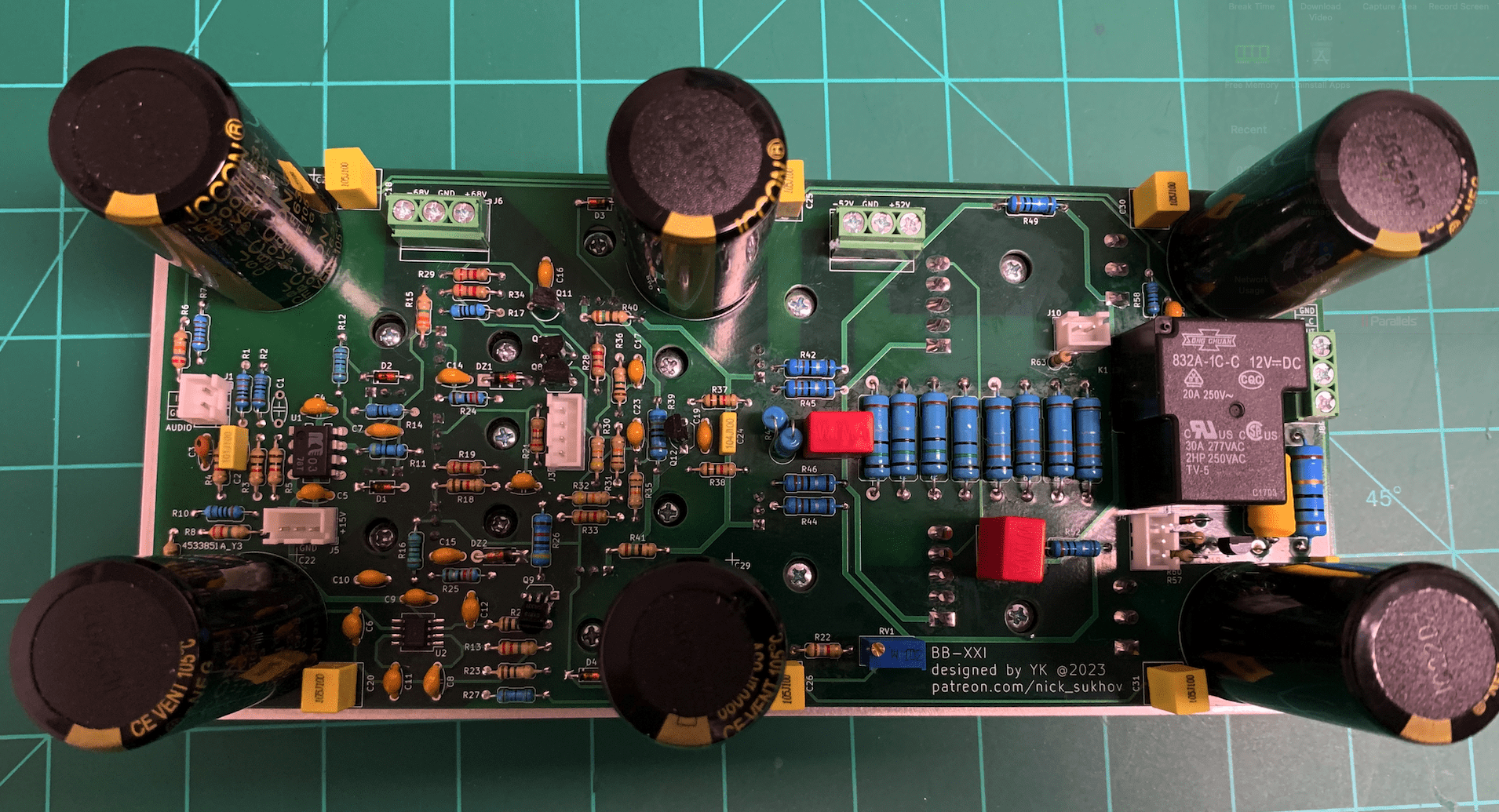

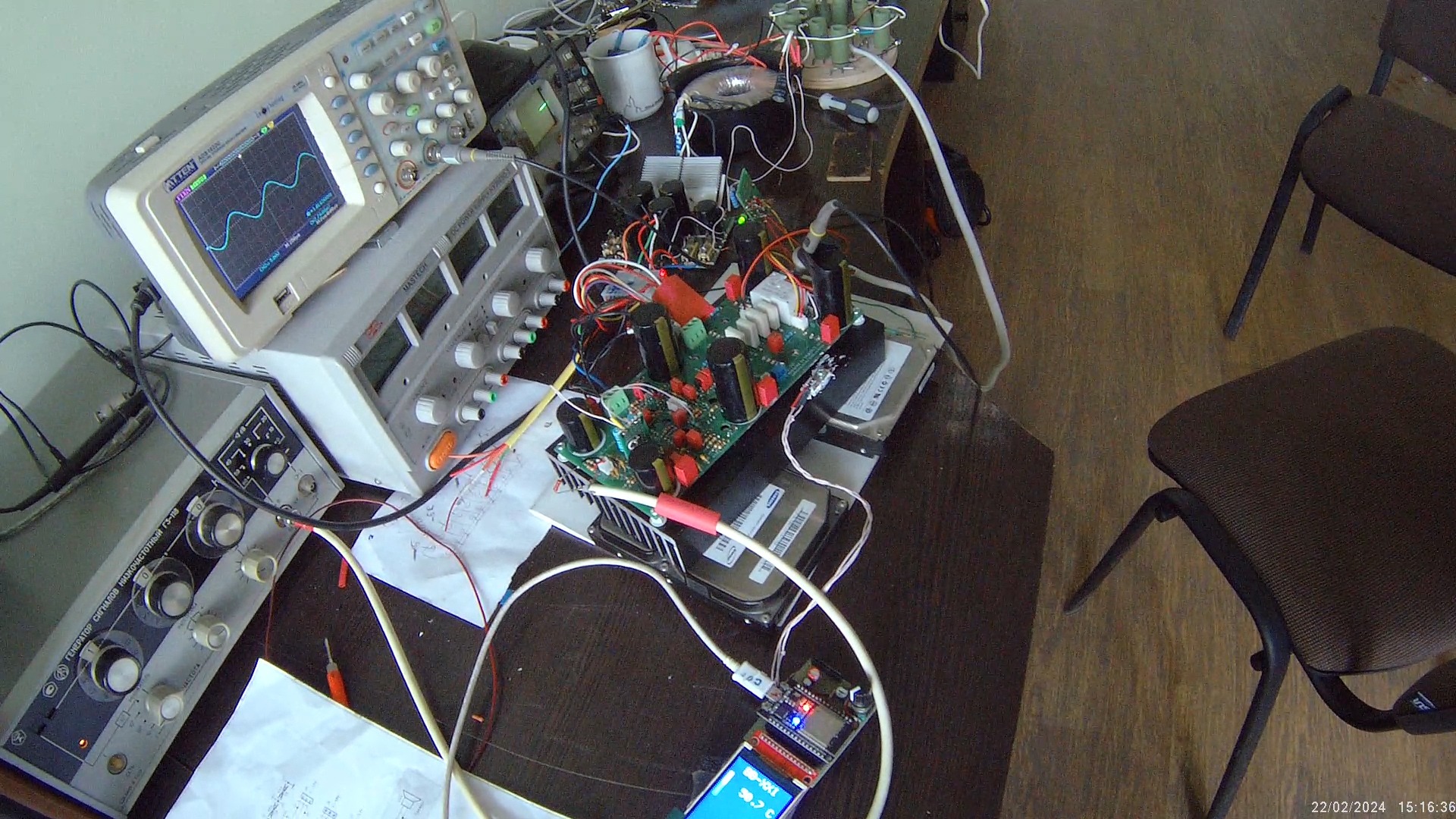

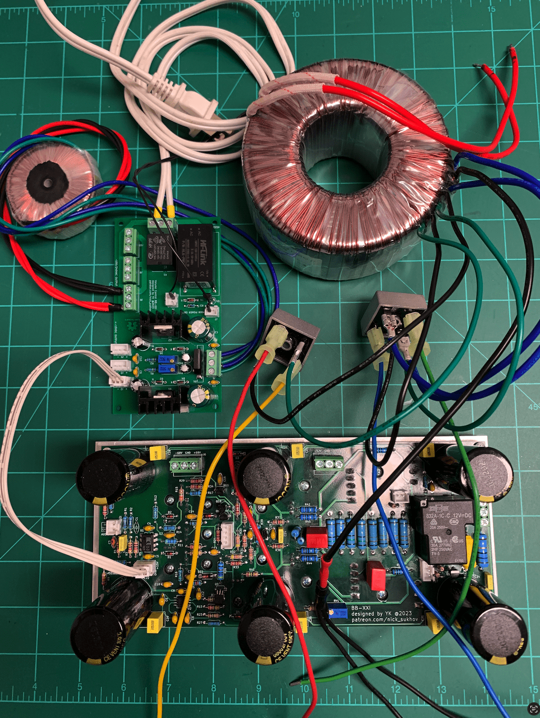

The Nick Sukhov BB-XXI amplifier with a power of 2x150 W has a patented [ https://photos.app.goo.gl/wGfoEdXYJg6ypRGQ8 ] improved output stage in the new ABBA class, which, thanks to effective Gm doubling compensation, provides nonlinear distortion 30 times less than the usual AB class. The hardware costs for these improvements are simply negligible - in my case, this is just a couple of additional low-power constant resistors. The input stage is implemented on the MUSES03 op amp, DC servo on the OPA192 e-Trim op amp provides DC zero at the output with an error of no more than +- 25 microvolts without the need for any tuning operations, and there is not a single coupling capacitor in the circuit, - all connections from the input to the output are organized on direct current. The push-pull output stage operates in the ABBA class mode on ThermalTrak transistors and provides ultra-precise and quick thermal stabilization of the initial collector current within +- 3% when heated in the temperature range from 20 to 100 Celsius. The volume control is organized on the MUSES72323 chip and the ESP32 DEVKIT V1 IoT module, which also provides control from the encoder, IR remote control and smartphone. A detailed description of the circuit, PCB gerbers, BOM and datasheets of Nick Sukhov BB-XXI amplifier are here [ https://www.patreon.com/posts/umzch-vv-xxi-v-81828557 ]. A short trailer is here [
], the lab test procedures is here [

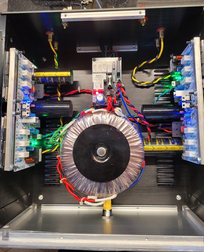

Not been funny but you would have better cooling with the transistors on the bottom side of the heatsink, in an ideal world they should be around 1/3rd from the bottom to take advantage of all that aluminium (you know heat raises to the top)Hook up wiring completed, powered up and checked the rail voltages, adjusted dc offset to 10mV and quiescent current to 65 mA... will leave it on for couple of hours and recheck the values.
Yet to gather technical specs from the designer...
(according to the designer} The design is a combination of P68 and P3A by Rod Elliott... the amp is capable of running in class A mode in low volume and automatically switches to class AB mode in high volume by self adjusting its biasing... it can run in fixed bias mode also, by soldering 2 diodes on the board to bypass the VBe multiplier section.
Trafo 40-0-40 @16amps, 0-12 @2amps for speaekr protect powering both channels.
PSU 2x15000uf/100vdc filter caps on each board...
I was given an option of output transistors to choose from: 1941/5198, 5200/1943, Njw 0281/0302
I opted for 5200/1943 (supposed to have more thermal stability due to its size)… three pairs per module.
Power output:
300Watts @ 4ohm
180watts @ 8ohm load

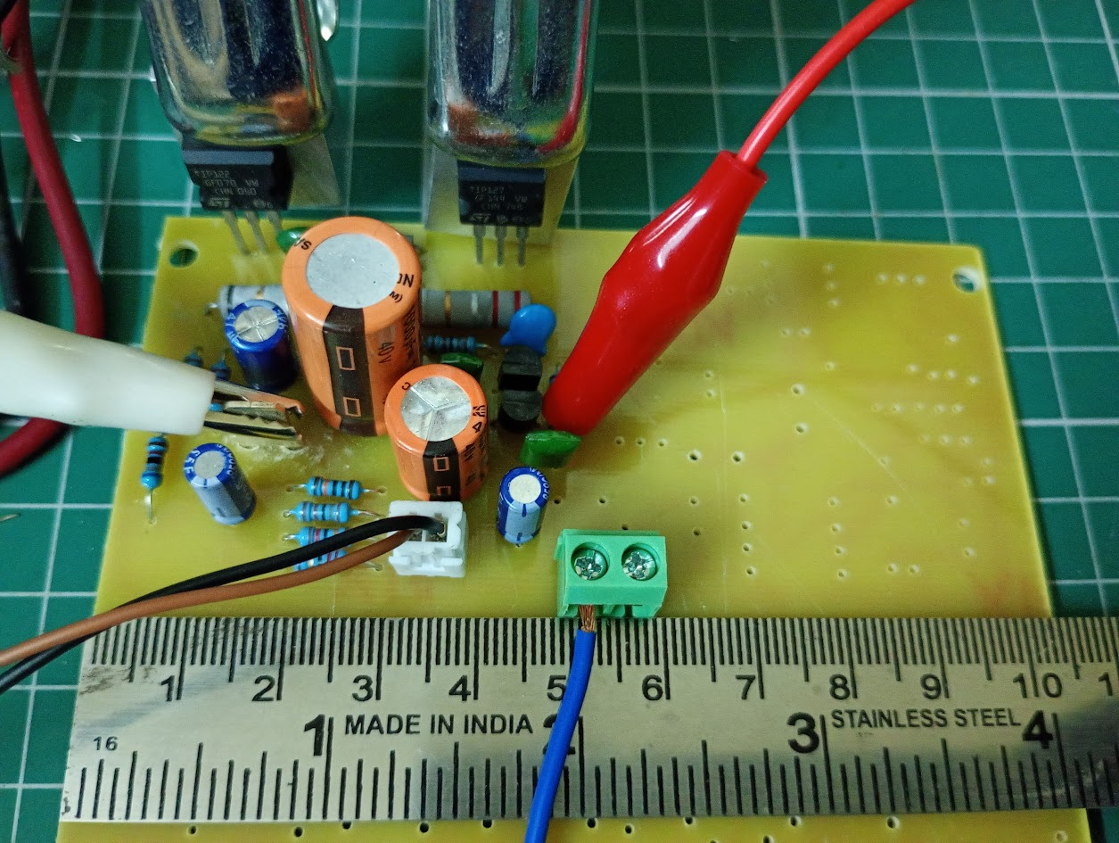

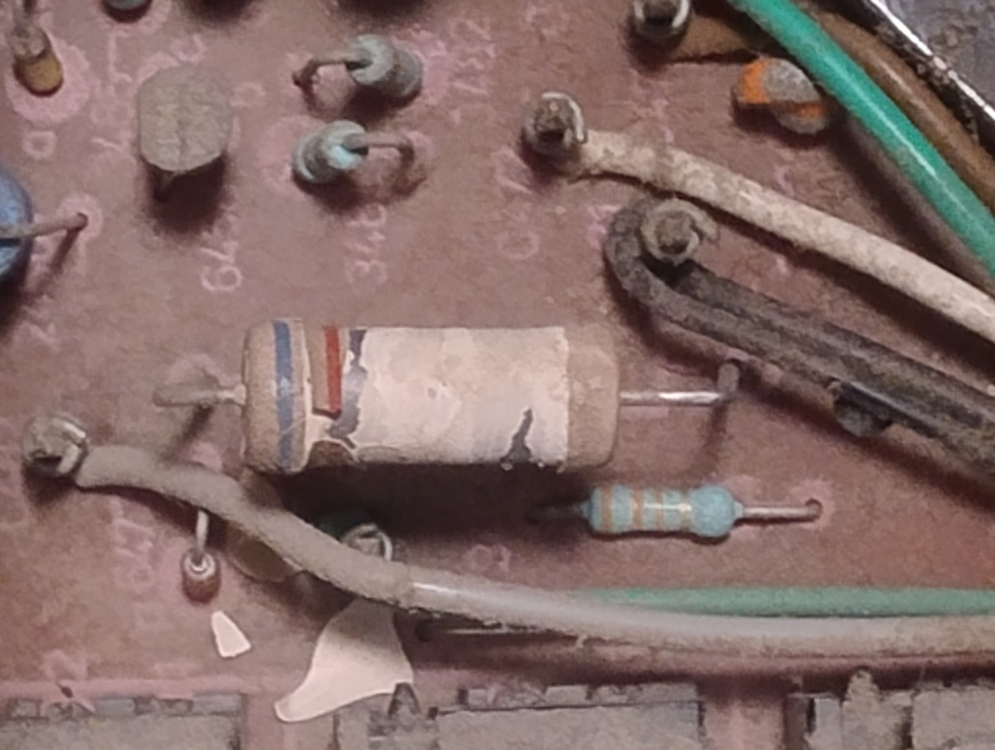

Either a bleeder for the power supply , or a stupid ,lazy , hot zener regulator resistor to save a few pennies
on the design. Booooo !
OS
OS
Nah it's for the speaker protection relay circuit. But cheap? Hell yeah Hence, also cheap to replace 💲

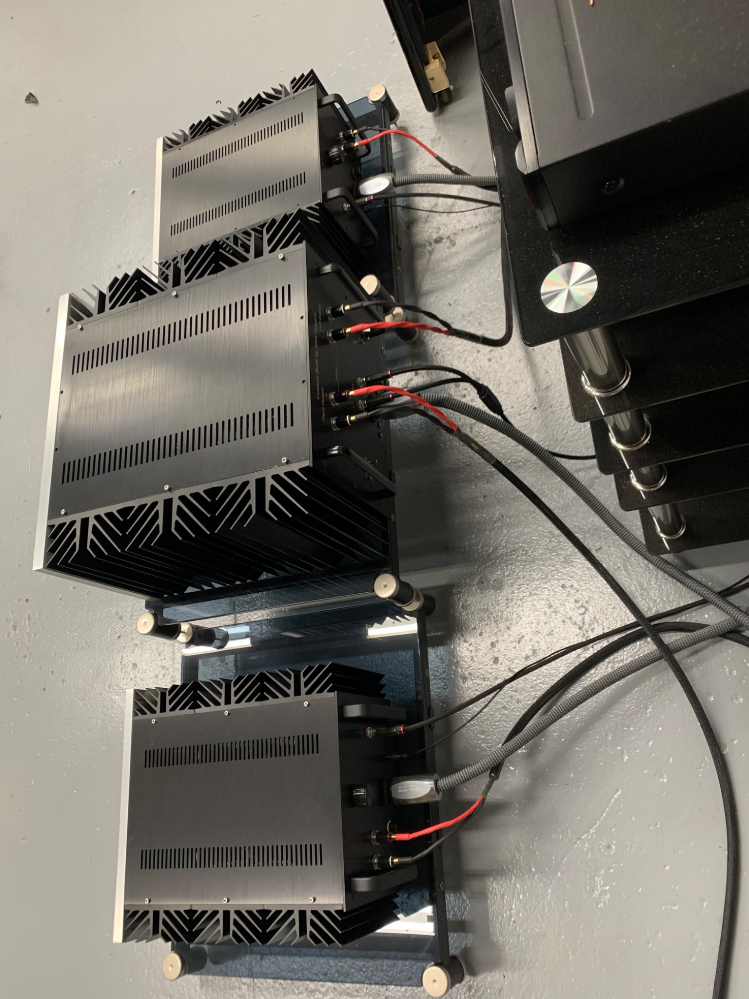

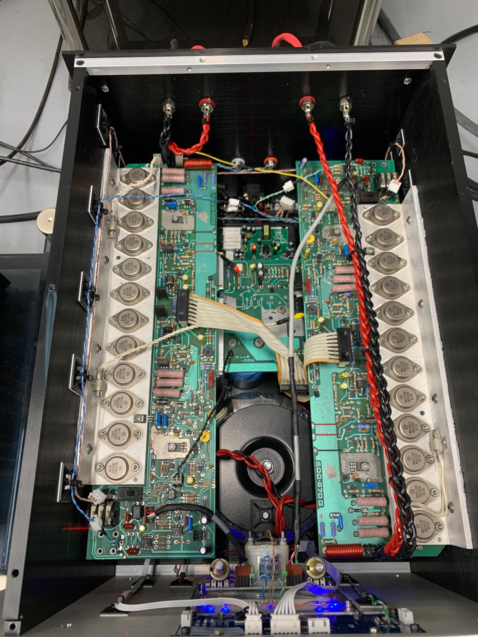

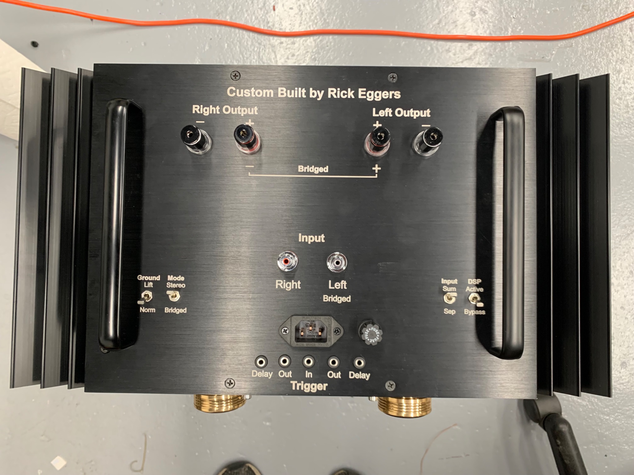

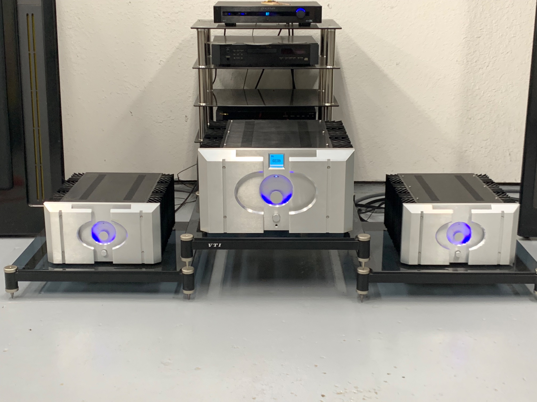

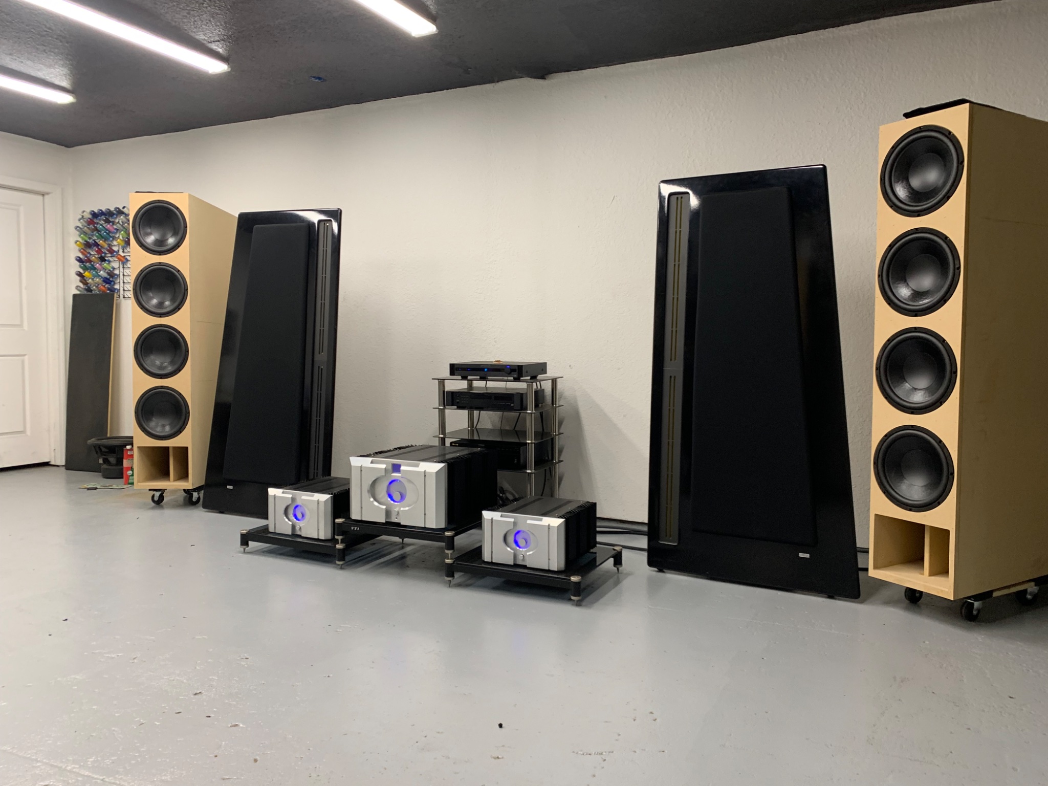

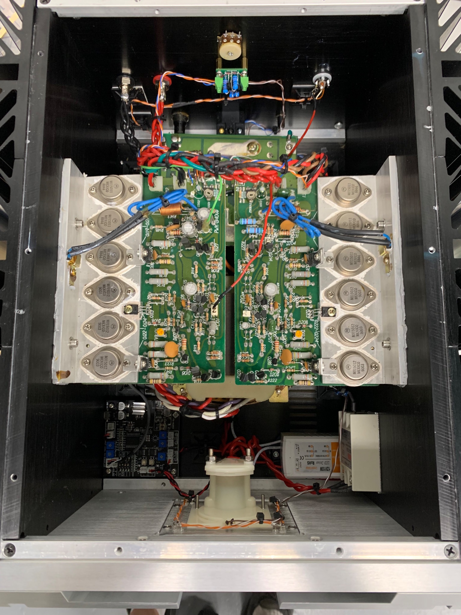

Finally finished my trio of amps. So these are not “full” diy amps, but more of a recasing with some added features. The “stock” amps are two AB International 600As and one 1100A. The two smaller (54lbs each, 1100 watts) amps are built as mono blocks to power my modified Carver Amazings. The larger (102lbs, 1100 watts X 2) power my sub towers. The larger one also incorporates a motor driven IR volume, LF Bluetooth DSP and a delayed trigger for the other two amps. I’m super happy of how they came out and they sound even better and able to drive the tricky Carvers with ease!

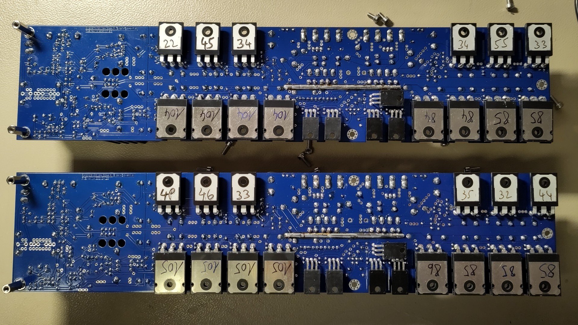

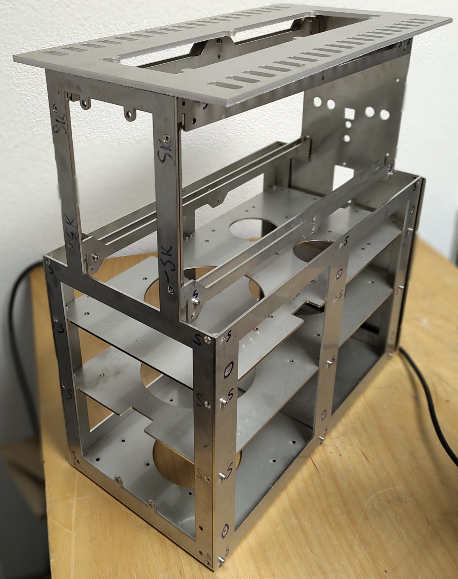

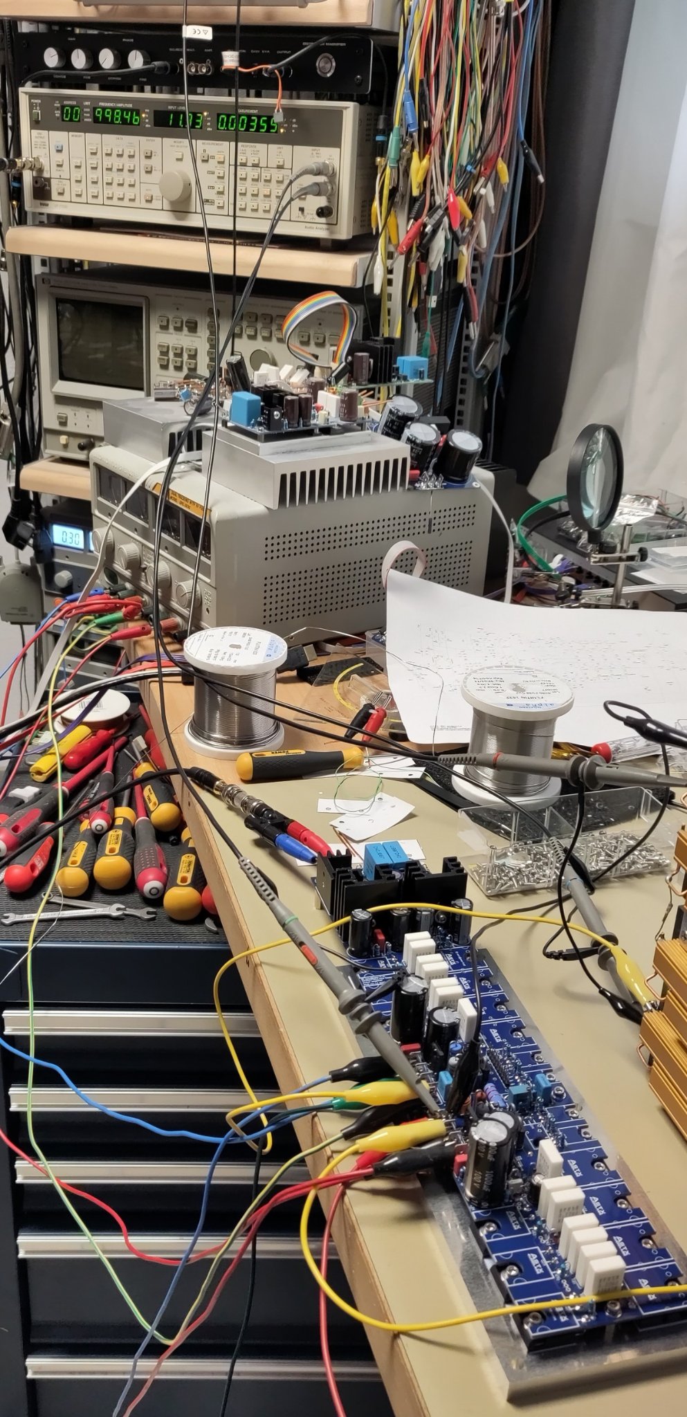

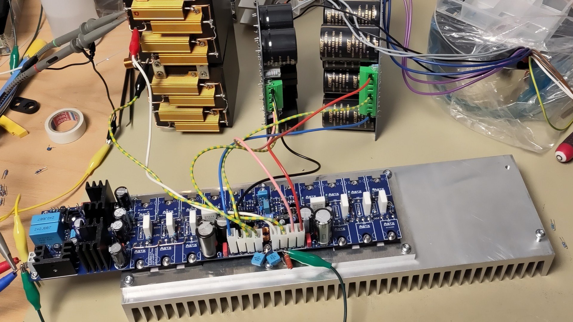

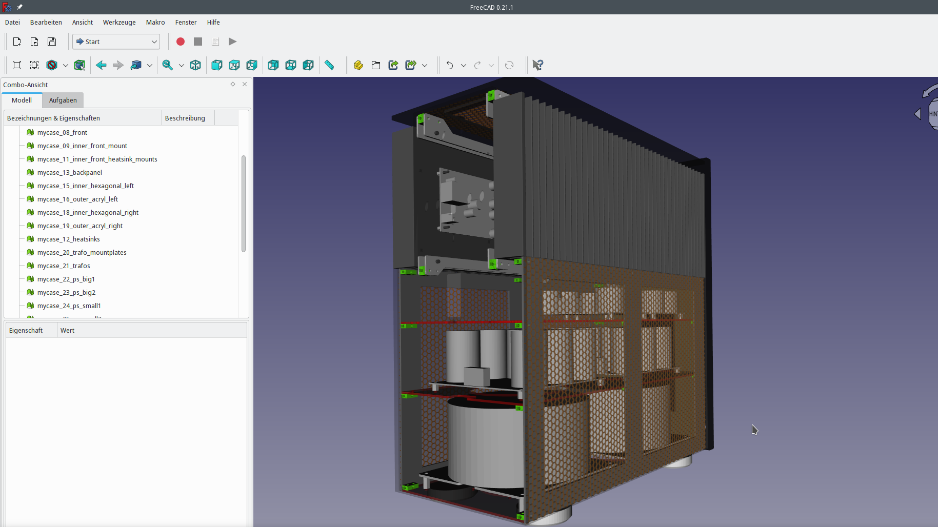

SA2021 - NCH (New Class H) dual mono tower coming soon ...
270W@8R , 540W@4R stable to 2R ...

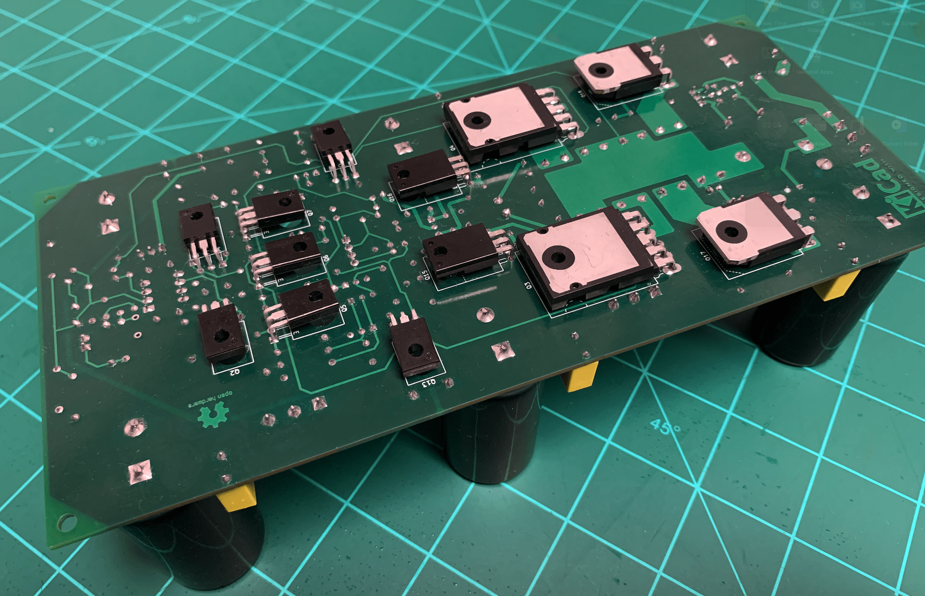

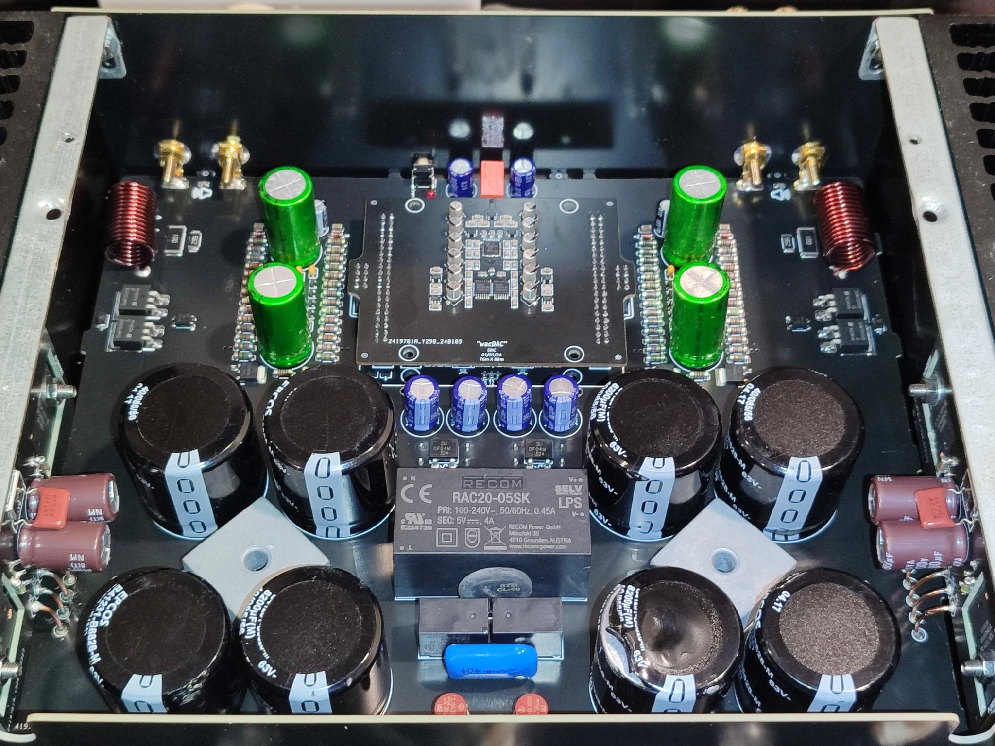

Can you share anything about the DAC you used here? I see "wacDAC" on the board; what is it?Been a while since an upload;
Lateral MOSFET amp, all-in-one, Raspberry Pi streaming Spotify, TI DAC, hardware volume, DC protection SSR.
~150w @8 and prolly around 200w @4

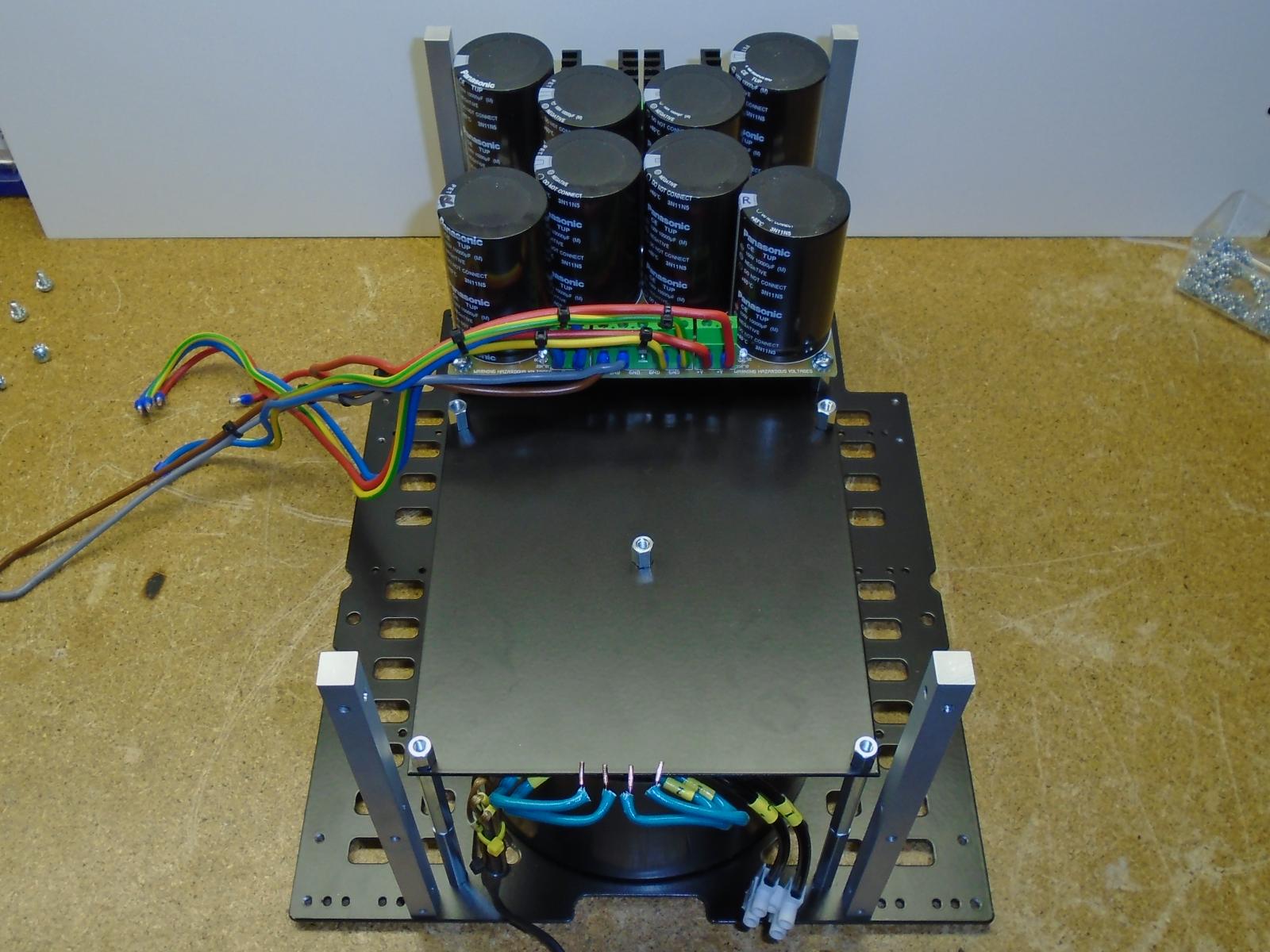

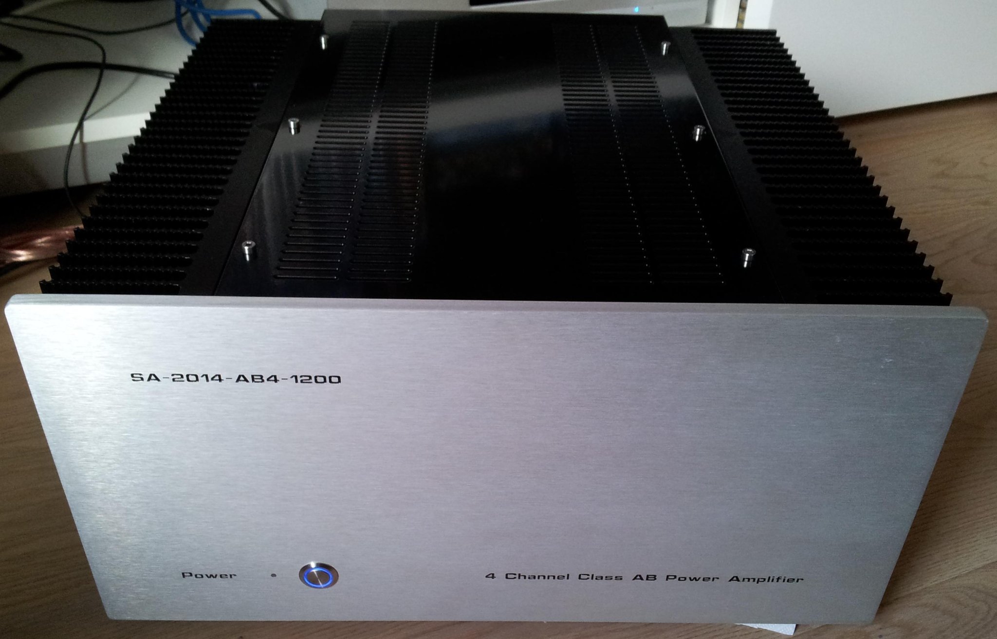

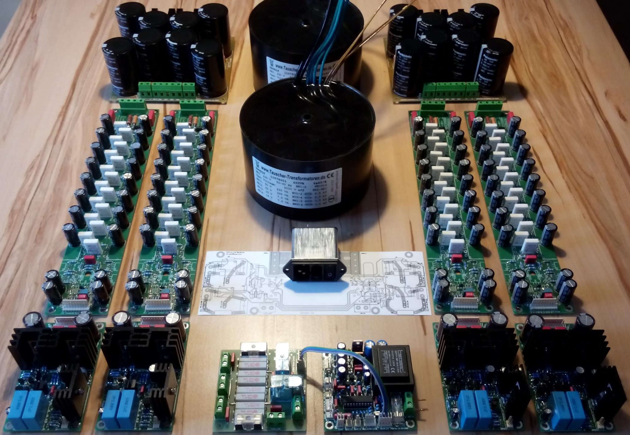

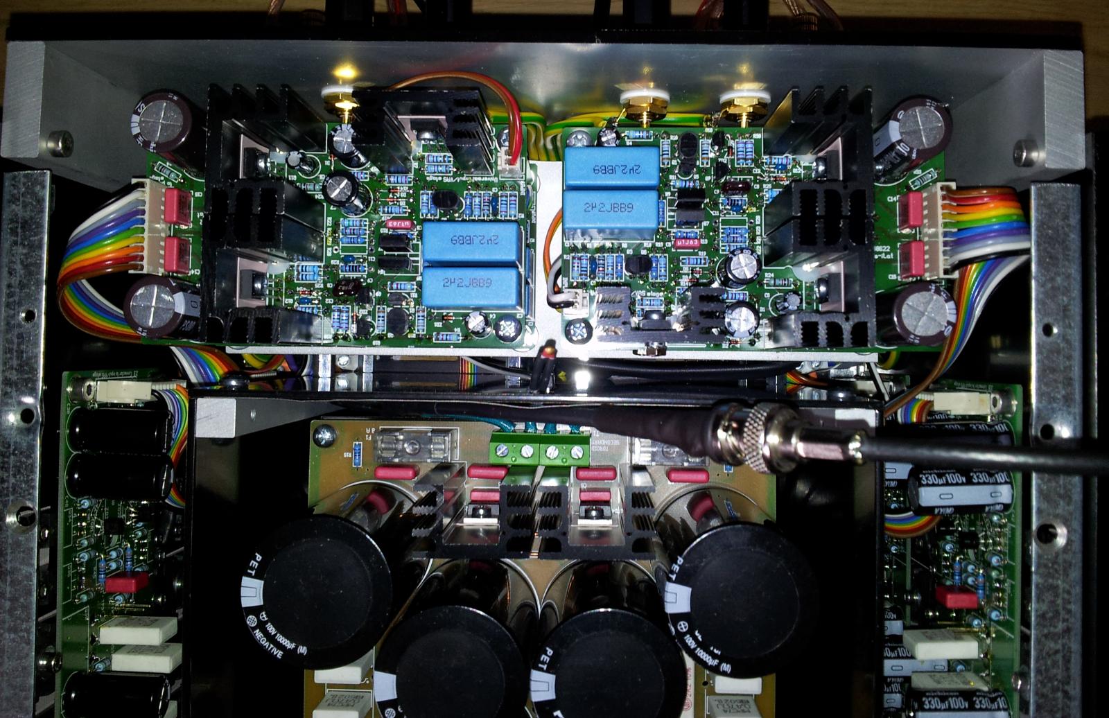

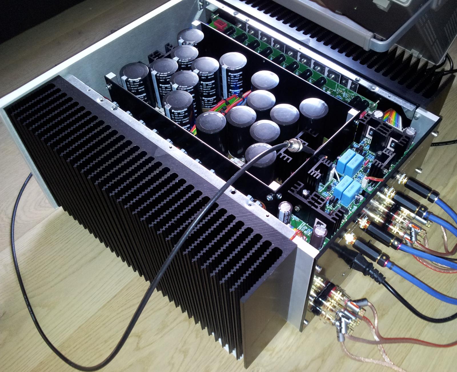

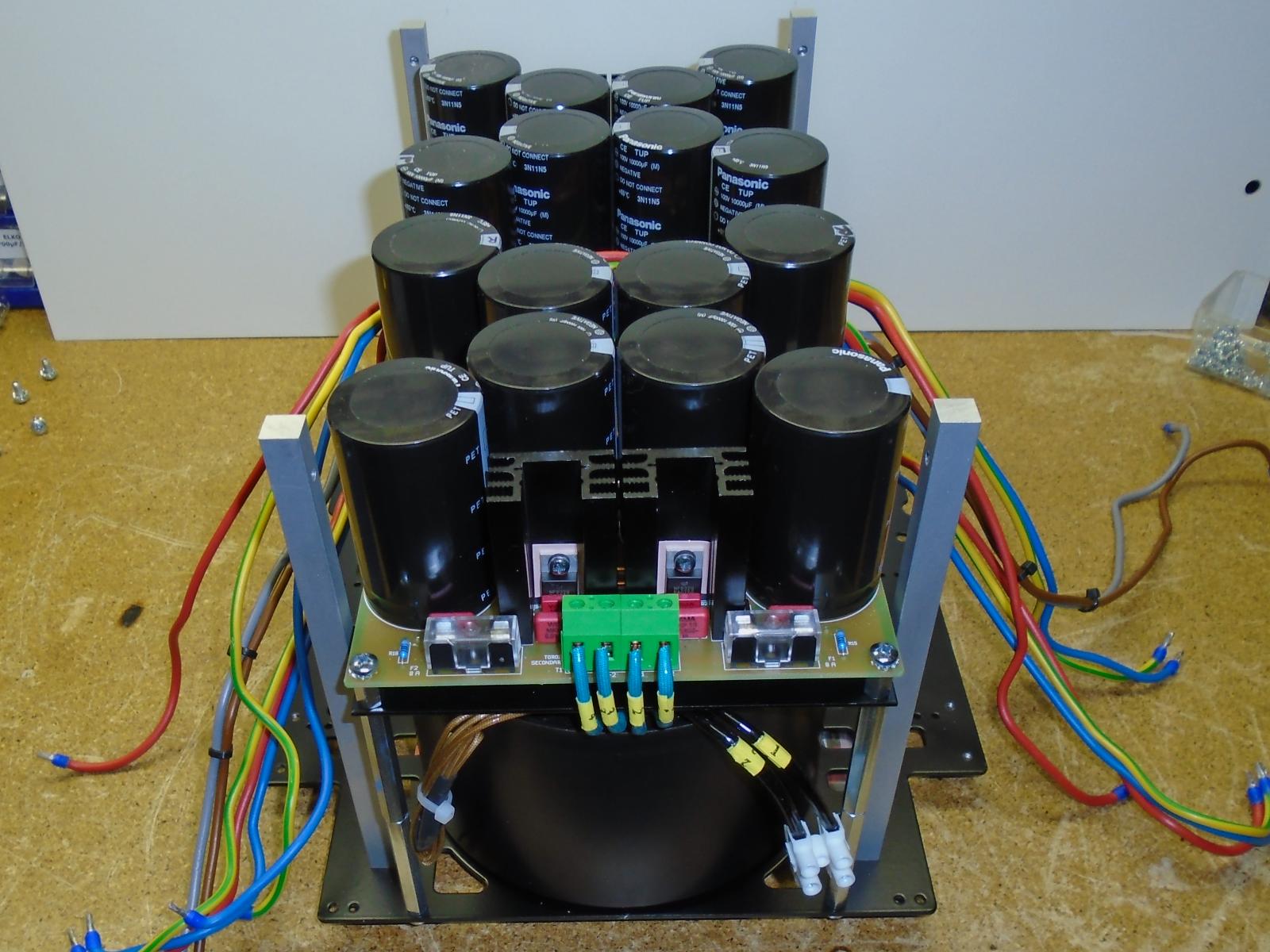

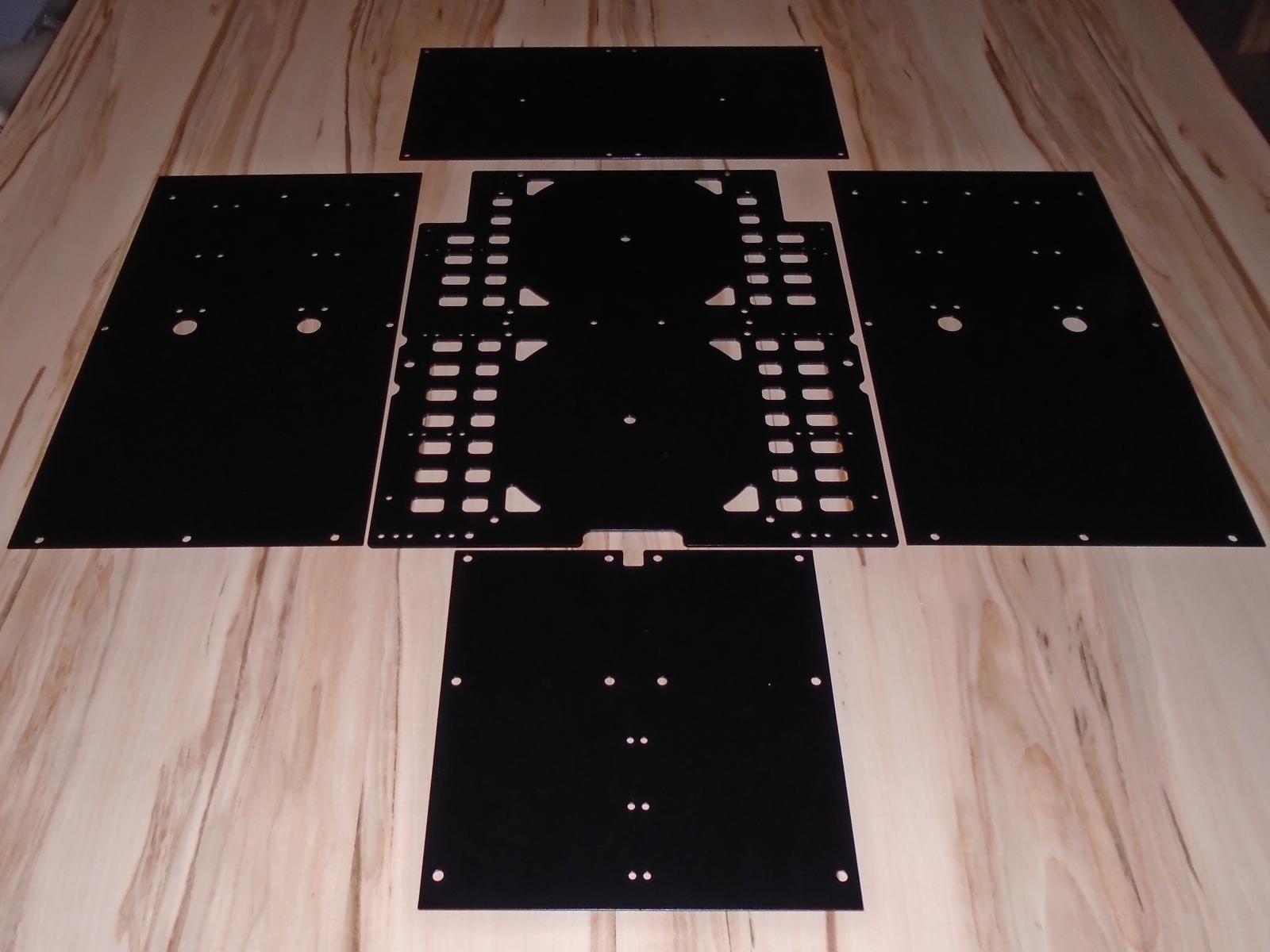

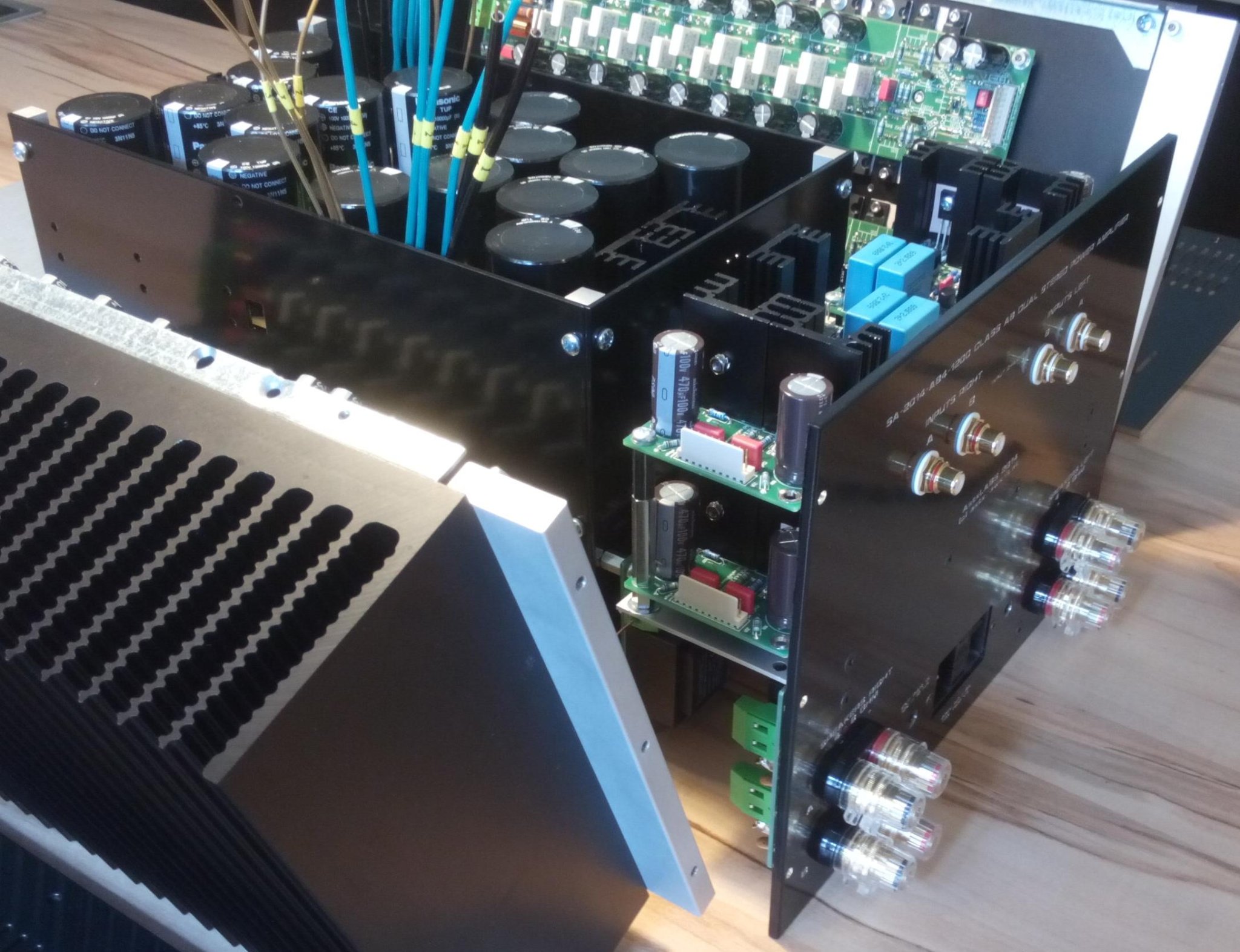

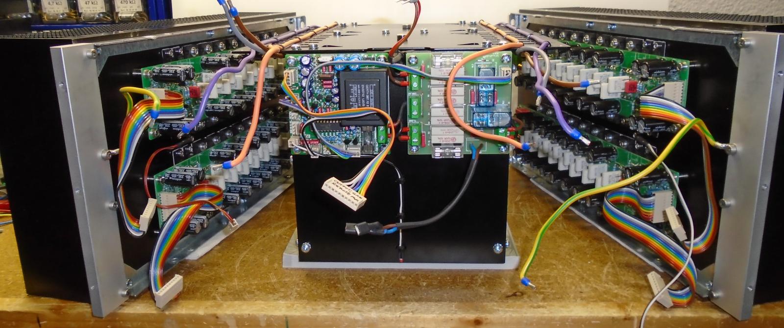

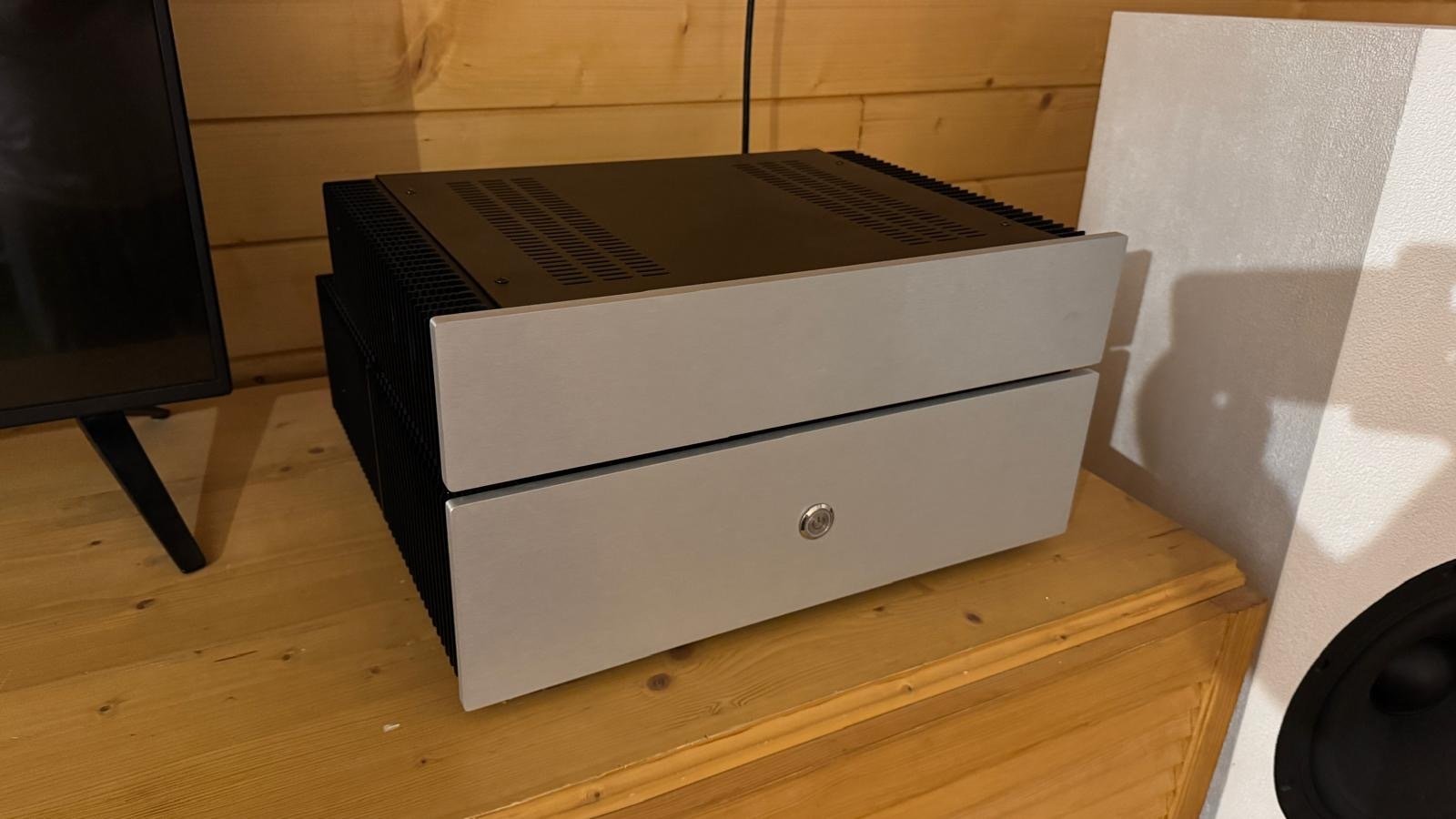

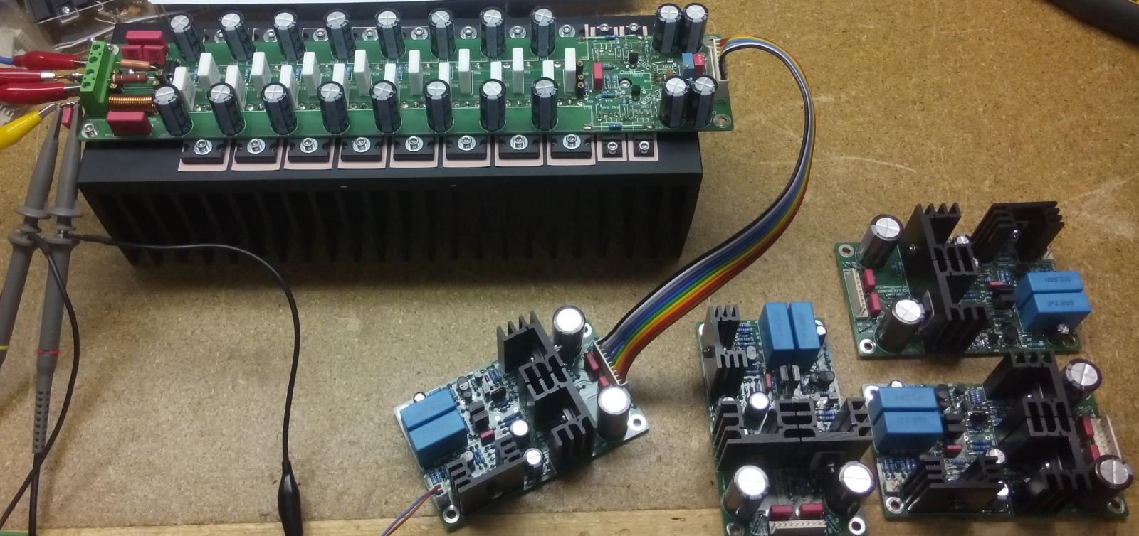

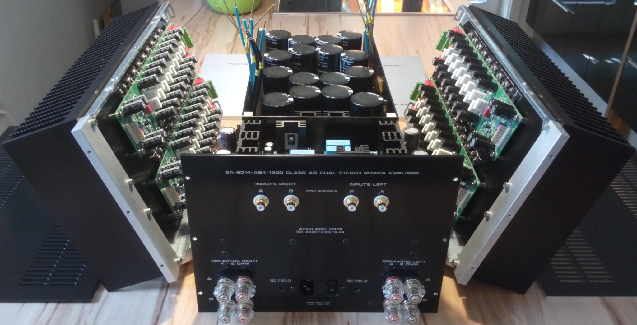

This 4 x 440W@4R (quad channel) powerhorse is hard working since 10 years every day in my home cinema
SA2014
Have fun, Toni
SA2014
Have fun, Toni
