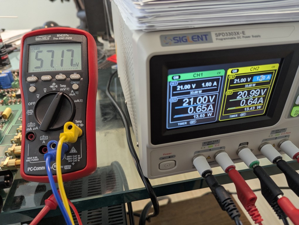

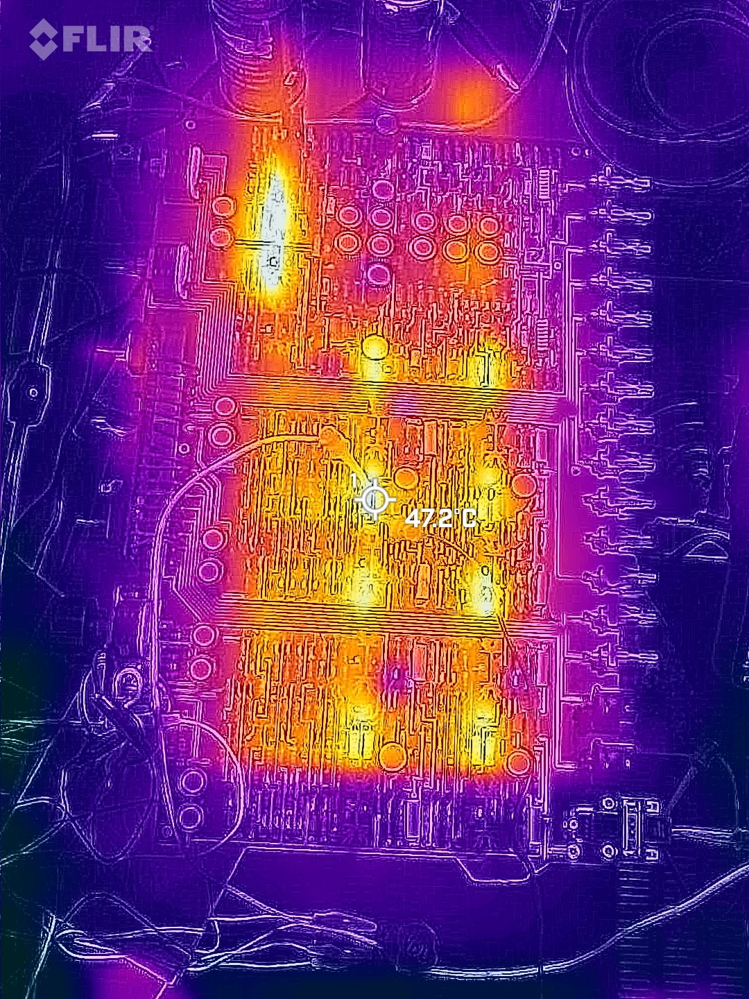

Back to the main preamp, I recorded trim pot settings as found before adjusting bias. The one trim pot associated with the overheating transistor pair kept giving me fluctuating readings, whereas the other 3 were stable. I gave it some attention until it gave me a stable reading too, and I set all 4 pots within a 510-530 ohm baseline.
Time to power up. I immediately noticed power draw was only 750 mA per channel, down from 1.55A (at startup) last time!
After a 10-15 minutes warm-up time, I recorded voltages across the 4 emitter pairs: 51, 51, 57 and 70 mV respectively, the latter being the previously overheating pair. So I think that pot was in a state that caused trouble leading to overheating, yet it looks like that one pair is still a little "hot" compared to the other three.
I scientifically picked 57 mV as my target voltage, based on (a) the inferred bias current being 86 mA which didn't seem completely out of whack for a Class A preamplifier, and (b) numbers superstition 🙂
With that, I observed power draw stabilized at 640 mA per channel (half as much as last time!)
Transistor temperatures are now between 40 and 47 C. The previously-hottest pair (113 C!) is now in the mid-range.
I did notice the bias voltages fluctuate constantly within a +/- 1 or 2 mV range.

I'm gonna guess that the fact that the preamp used to pull 45W (vs 27.5W right now) has a lot to do with the tragic condition of the power supply.

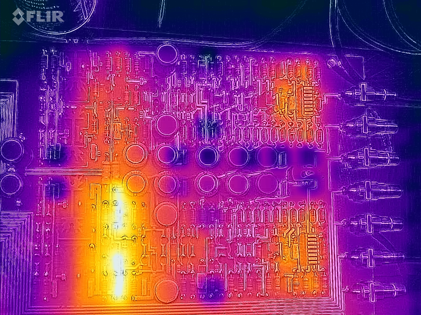

However I totally forgot about the voltage regulators in the phono stage. As noted before, half of them are running twice as hot as the others. There are four pairs, each pair on a heatsink. Two pairs are running at 57 C, the other two at 28 C. As you can see on the main board, temps in the line stages look great but those ones in the phono stage at top left are out of whack. Here is the main board:
And here is the phono stage:
Nothing appears to be drawing abnormal current elsewhere in the phono stage. I checked voltages at the 8 transistors and they are within these values:
Base to ground: +/- 17.75 to 18.59 V
Collector to ground: All 8 exactly +/- 20.91 V
Emitter to ground: +/- 17.14 to 18.05 V
That's all the troubleshooting I've done so far I'm afraid. I haven't seen any obvious cause for the huge temperature imbalance yet.

Most likely resistors and capacitors out of whack due to long term heat exposure.
Check those first, if in doubt remove from board and check.
Use a good quality meter, the graphic display types for capacitance are decent for the money.
Comparison between same points on different channels helps find defects, the same parts are rarely defective on both channels.
I would ask if all the electrolytics are due for replacement due to end of life, leaky capacitors can be a source of trouble.
