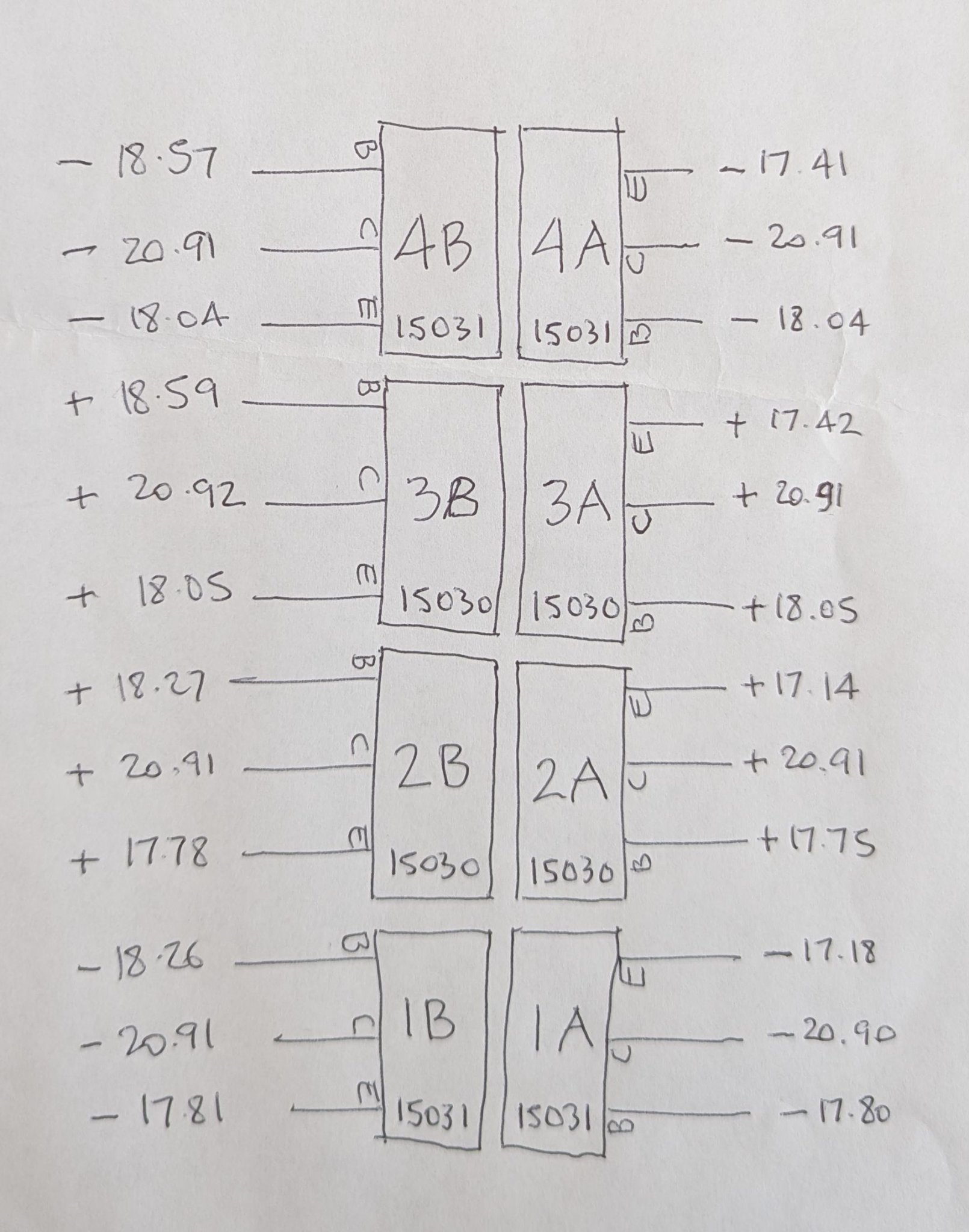

If those are pass transistors for the phono supply, then the emitter would be the phono section power I think. And if the target voltage at the emitter is 18 which some of your devices are, and if those are the cool ones, and the 17.1V's are the hot ones, then it kind of makes sense. The bad phono section is pulling down the supply a full volt, which is quite a bit. Without a schematic of the phono section itself, could be quite difficult to isolate. Maybe zoom your IR camera on the component side to the phono section and see if any of the components are hotter from one channel to the other. I expect the resolution/sensitivity isn't that good though on the camera.

The drawing below shows the 4 transistor pairs at the front of the phono section, and the voltages observed at each of the leads are noted.
The two "hot" pairs are 1 and 2, whereas 3 and 4 run cool.
However, the lower emitter voltages are not found on pairs 1 and 2 (which all run hot) but on the four transistors on the A side (only 2 of which run hot).

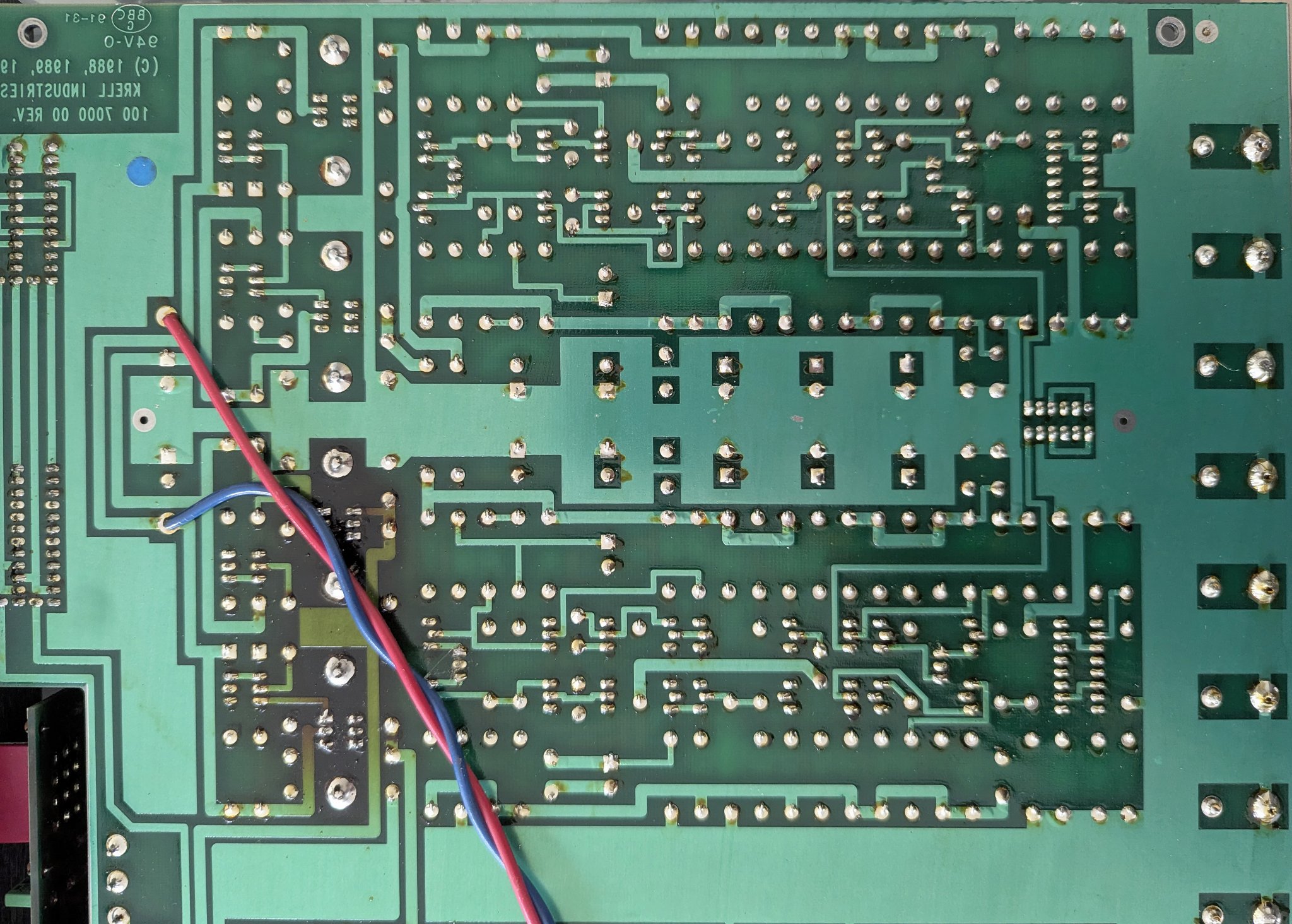

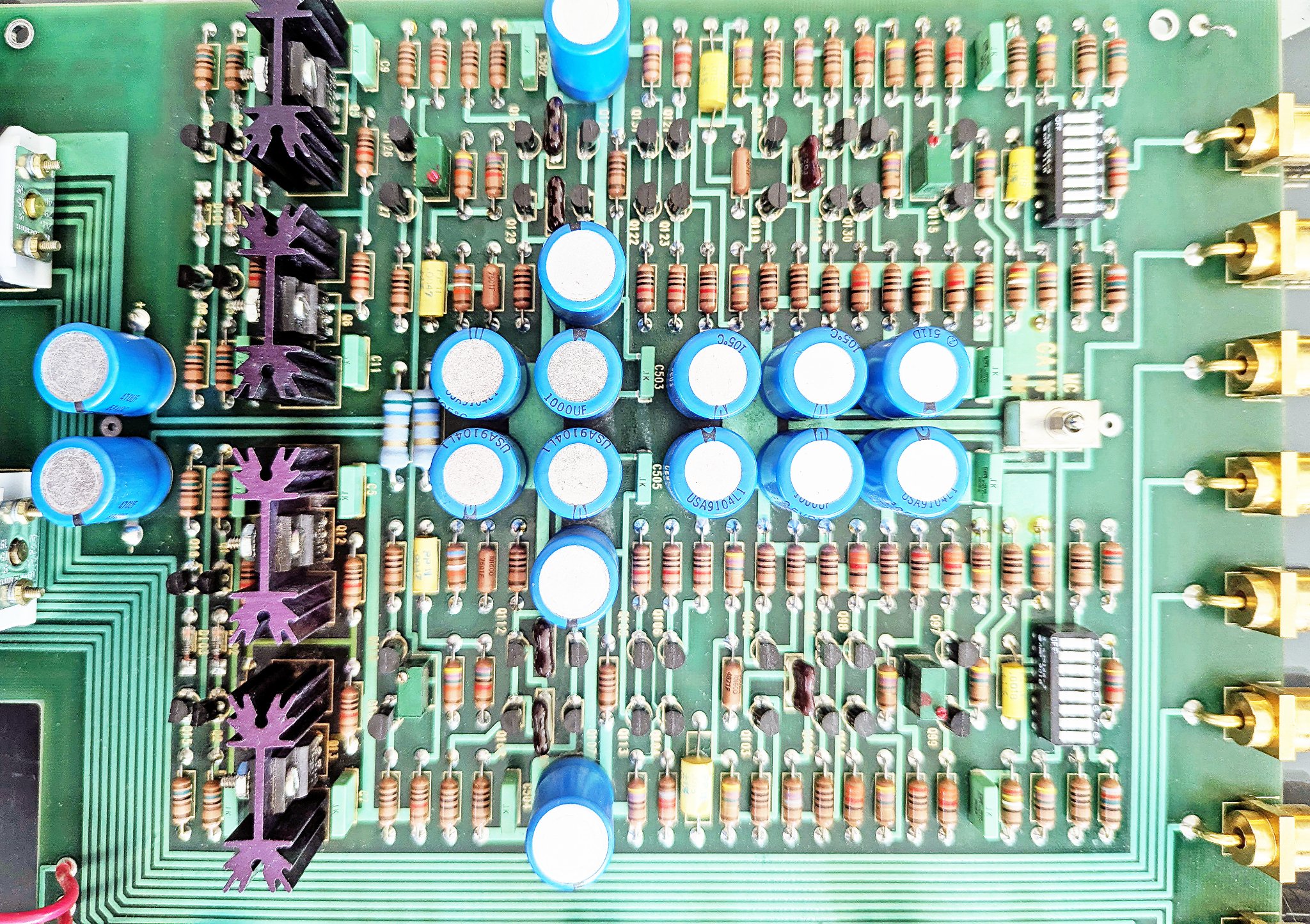

Here are detailed pics of the phono section, top and bottom (bottom is flipped).
I tested all caps for ESR and they're all fine.
There are four trim pots in the phono section. Two are close to and to the right of the heatsinks, and two are to the left of the DIP switches. I tried to adjust the trim pots next to the heatsinks but that did not cause any temperature change at the transistors, nor any change in the voltage drop across the two 5.6 ohm power resistors (375 mV if I recall).
The 2-position toggle switch (between the DIP switches) selects MC or MM cartridges. When MC is selected, impedance can be adjusted separately for each channel via the two DIP switch banks. When MM is selected, all DIP switches must be off.
Hmm, your drawing shows the lower E voltages on 1A/B and 2A/B and you noted pairs 1/2 run hot, which is consistent with what I said. Are you sure its 1/2 or A trans that run hot?
Pairs 1 and 2 are the ones running hot, but each transistor pair are mounted back to back to a single heatsink, so that the base and emitter are reversed between A and B sides in the drawing. Hopefully that makes sense, sorry! 🙂

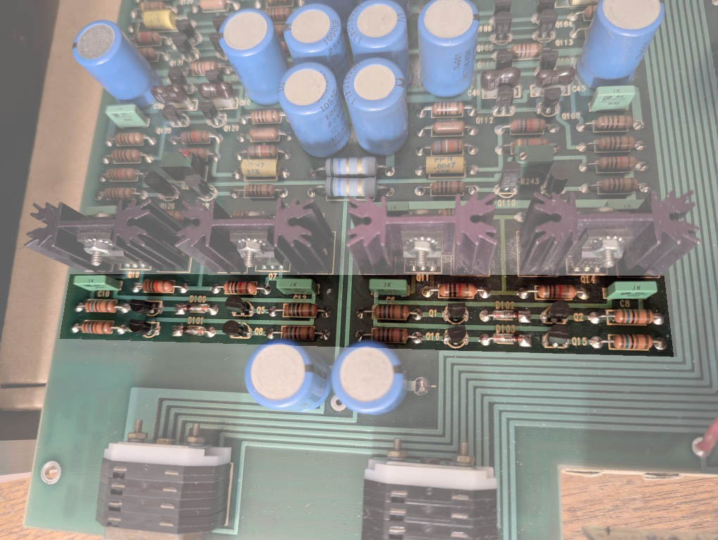

The only exception is the small section highlighted in the pic below. The right half is about 10 C hotter than the left. But I wouldn't exclude the possibility that the right side is merely being heated up by the hot transistors.

Total guess as I have not traced the board at all, but I think the highlighted section at the bottom is just some zener's that set the 18V reference for the pass trans. And agree with your guess, heat from the pass trans. It does look like the MC pre-preamp is the stuff near the RCA connectors to me based on the MM/MC switch. You could make a very cheap voltage divider of 100/1 with a 5K/50 ohm resistor pair. I think your cheap waveform gen can probably do 100mv output and then easily divided down. I think you mentioned you have a scope, so inject the signal and poke around with the probe to look for differences between channels. You'll very likely need to ac couple the probe to see the signal.
