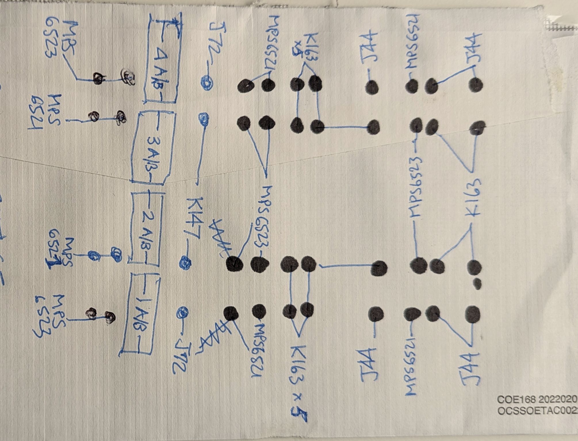

This is perfectly fine. I do have some difficulties in tracing the tracks for the MC/MM switch. It appears that there might be some gain switch involved. I do not know if you can amend my schematic. Also, the PSU regulators. I can't determine if the MJF150xx are in parallel or as darlington. Perhaps you can determine? The feedback network of the second-stage in the phonp-stage is a litlebit difficult to trace from the pictures. Can you help?
I have attached what I have at the moment.

Interesting you mention the MC/MM switch. I was testing it for continuity and it looks like it's shot. Pin pairs read open when they should be closed, and at times I observed resistance across pins located in opposite rows.
The faults seemed intermittent and kind of random, but it was 2 am therefore more testing is in order
I was testing in circuit, but that can't explain individual switches reading open when they should be closed.
The switch is a 4PDT toggle with two six-pin rows (Alcoswitch TT41).

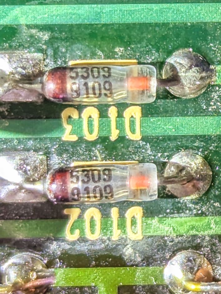

The diodes in the regulator seems to be "constant current diodes". This i a guess, but something else doesn't make sense. Can you see the type number?
Also, the PSU part with the most discoloring is the part that supplies the line stage, as far as I can determine. It somehow makes sense given what you have observed. The "upper" section supplies the phono stage.
This is D102 and D103 (on the "hot" side)
Markings on D100 and D101 (their counterparts on the "cool" side) are mostly hidden underneath but they appear identical.

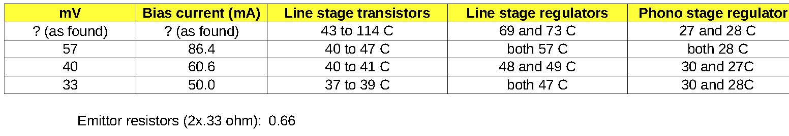

So the "lower" half of the voltage regulation section (the "hot" half) has nothing to do with the phono section, it supplies the line stages and the load on it is determined by the draw from the line stage transistors, and therefore by their bias settings. Suddenly it all makes sense! Thank you for that, I was fixated on that whole regulation section serving the phono stage.
So back to bias setting. I originally dialed 57 mV across emitters (86 mA).
Today, first I dialed it down to 40 mV (61 mA), then to 33 mV (50 mA). Here is a temperatures chart with the different biases:
I also double-checked DC offset: still .01 mV on both channels.
Next step, listen to music!
I have been listening to the Krell in my system a few hours every day. It sounds glorious! I am very pleased with the sound quality. The new TKD volume control is excellent, I recommend it.
Operating temperature and current draw are moderate and stable, and I am not hearing a difference in sound quality for having cut the bias current almost in half.

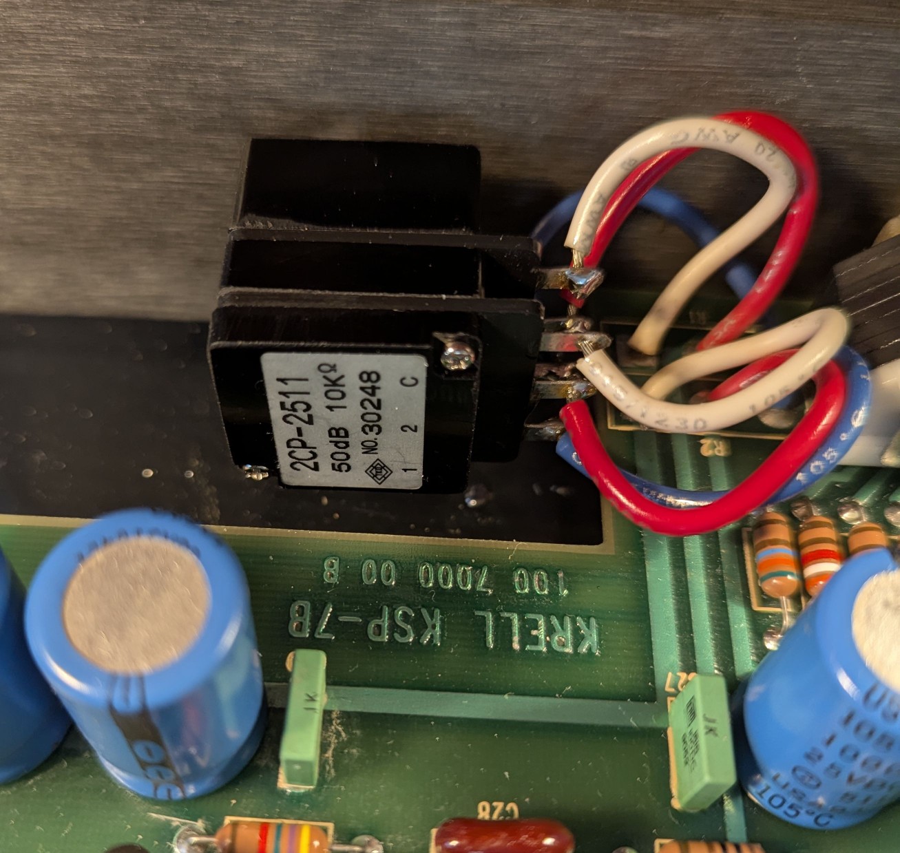

I sprayed a bunch of deoxit into the MC / MM selection switch, but that did not fix the issue where one of its four switches is correctly closed when the toggle is in one position, but is open in the other position whereas it should be closed.
It's a discontinued Alcoswitch with 2 rows of 6 pins (2x6 pattern). There are no replacements out there except for a couple NOS ones asking 50+ euro. All new 4PDT toggles on the market today are 3x4 pattern. 2x6 sliders are available, but the PCB hole patterns don't match.
I may have lucked out on ebay though. A guy is selling a bunch of NOS Alcoswitch, exact same ones as mine except they have 90 deg angled pins instead of straight pins. It's not a drop-in replacement (again the PCB hole pattern doesn't match), but I'm hoping they are internally identical so I can use parts from the angled one to repair mine. Since he's asking $3.75 each I ordered two. We will see.
