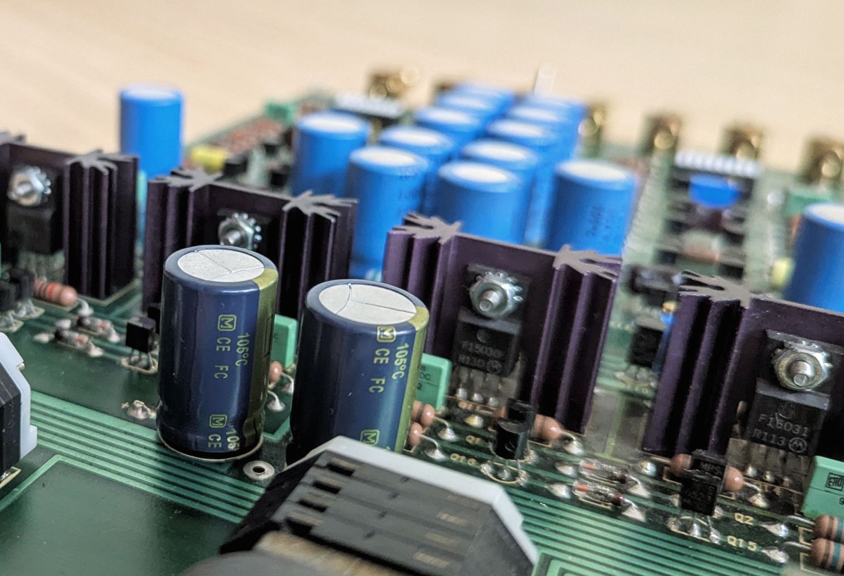

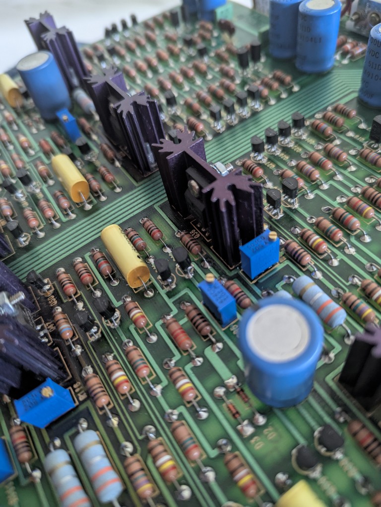

I finished fixing the known issues:
- Replaced trimmers with new Bourns (all 12 of them). The 4 bias trimmers sit right next to heatsinks; they were most likely cooked, in fact the current draw drifted from 0.50A per rail to 0.53-0.54A over the few weeks I listened to the pre several hours a day, Fast-forward months or years... That was most likely the root cause of the massive overheating of the power supply. The other 8 trimmers were probably still OK, but I figured I might as well replace the lot of them.
- Replaced the last two caps in the power supply stage. Nice Panasonic FC, 560 uF / 105 C vs the old Spragues at 470 uF / 85 C. Of course the Spragues tested just fine.

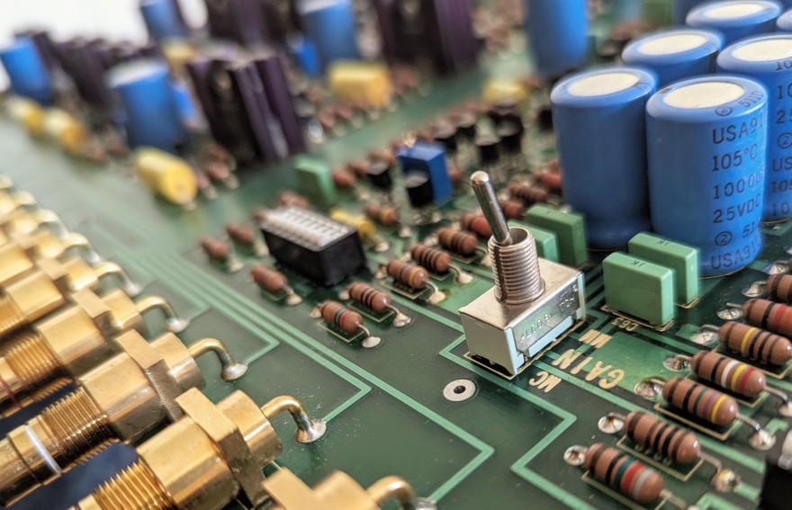

- Reinstalled the MC/MM selection toggle switch.
