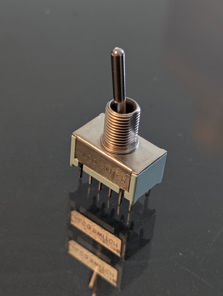

This post is about fixing a failed ALCO TT41 series toggle switch.
If you recall, during testing I found an pair of pins that were open when they were supposed to be closed. This switch is located on the main board in the phono stage of my Krell pre. It lets the user select between MC and MM cartridge input.
I measured it in-circuit, but the culprit had to be the switch itself. Which, I quickly found, is obsolete and near-unobtainium. There are a few NOS ones floating around, asking for $40 - $50.

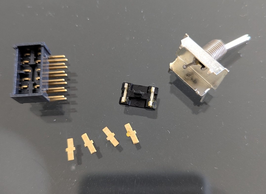

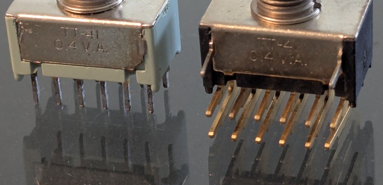

Meanwhile a guy was selling a different version of the same switch on eBay (with right angle pins) for $3.75 a piece. So I bought two to use as donors. Here is the OEM switch (left) next to the eBay one (right):
The pitch of the angled-pin rows is only half that of the straight pin rows, so I couldn't just drop in the eBay switch although there would have been enough real estate to do that. The only way was to open up the switches and swap innards. Here is what's in them:
I was expecting springs to jump in my face and get lost but there were no springs.
The four brass crossy things are teeter-totters. The source pin contacts (the center ones) are higher than the two on either side of them, so the brass crosses pivot on them. The plastic sled (center) rocks the brass crosses the opposite way as it moves from one end to the other when the lever (right) is actuated.

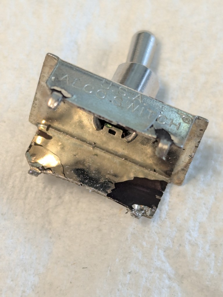

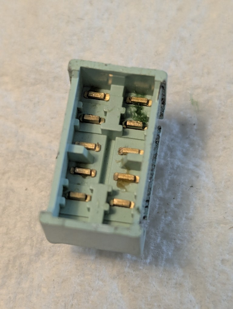

It's really super simple. How can something this simple go bad? Well, here's what the base of the OEM switch looked like on disassembly:
You can see that greenish fuzz on the top right side. The problem was pretty obvious:
The plating was peeling off the steel saddle and, presumably, reacting with the brass contacts and forming the green fuzzy residue through some sort of chemical reaction. I cleaned up the base using vast amounts of CRC contact cleaner followed by Deoxit D5, then I started with reassembly. The new switch essentially consists of all the eBay switch's parts, with only the base of the original switch being retained. Here is the finished product:

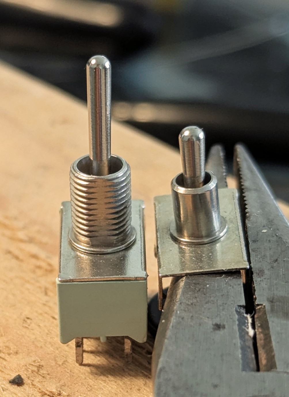

I used a bit of Caig contact grease on reassembly, and the action feels better than the factory switches'. Parallel-grip pliers are a must to re-form the steel saddle and do this job cleanly.
I was pretty happy with the outcome, until I realized my new switch was quite a bit taller than the old one:
It is actually taller than anything else on the main board, but luckily, according to my measurements there will be one whole millimeter left between the top of the switch lever and the case.

I wonder if flux got into the switch during the assembly of the amp. It was then left in there to react with the metals and the moisture in the air. Corrosion does bad things.

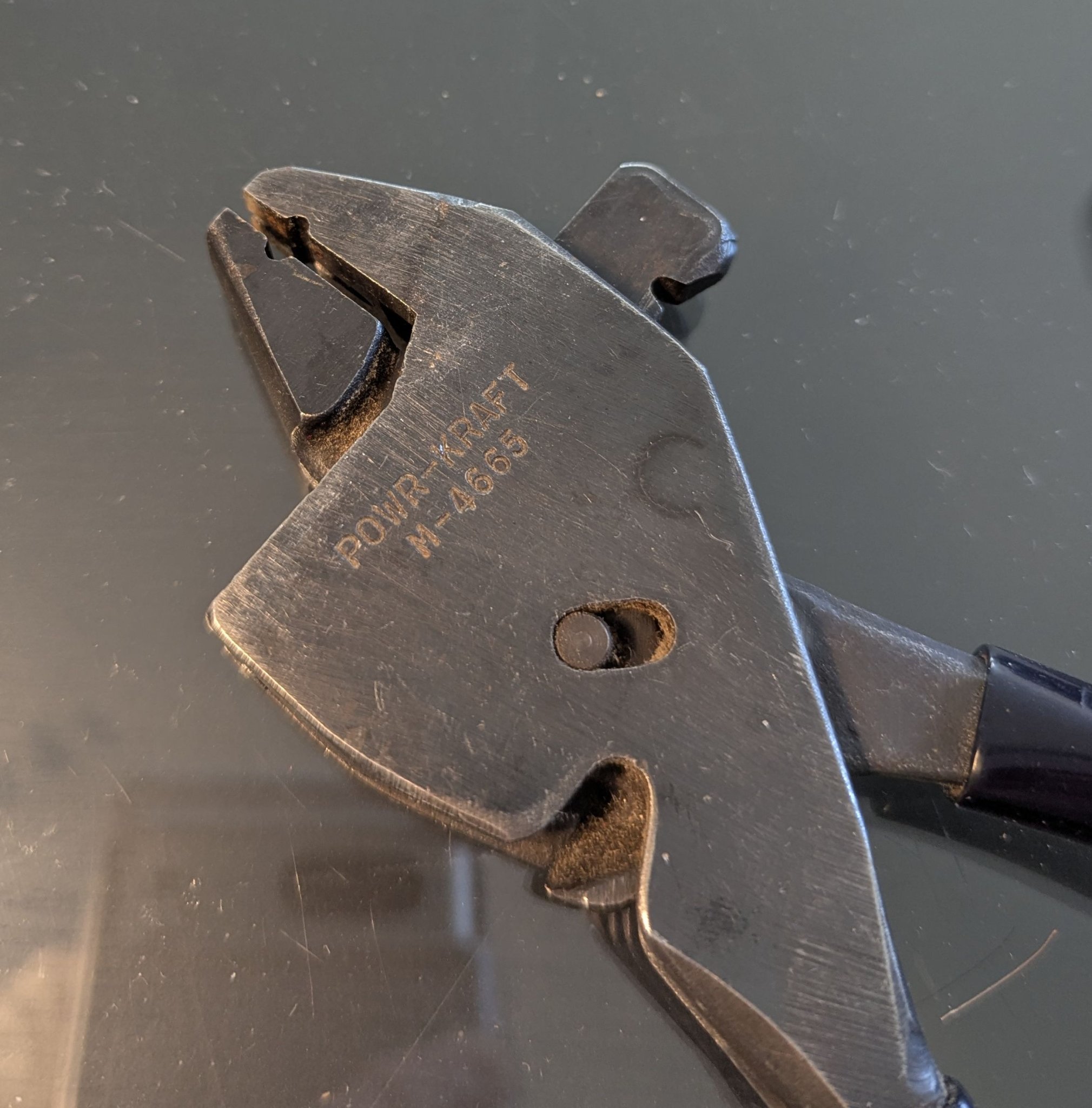

You mentioned parallel gripping pliers. I haven't seen a pair of these in years. No, I am not talking about slip joint and the many other possibilities. Parallel gripping is usually a compound levered device that is perfect for crimping the old 'Scotch Loc' connectors that we used in the phone company, but I always knew that they would have other uses within their range of jaw gap. The E9Y pliers that we used might have been just big enough to grab one of these switches.

@Ixnay here they are, the mighty powr-kraft parallel-grip pliers.
They don't look like much, but once you have them in your toolbox they have so many uses you never thought about, I honestly don't know how I could do without them at this point. Highly recommended 🙂
You can adjust the jaw gap up to about 1.25" by sliding the rack and pinion mechanism. Is that the same pliers you're thinking?

Never saw those. What can they do a grip pliers, bahco or cobra water pump pliers can not do? I guess it can do all what the others can but then combined?@Ixnay here they are, the mighty powr-kraft parallel-grip pliers.
Specifically they do not operate on a pivot system, but in this case a rack and pinion. The assures that the jaw is in full contact which is particularly important when bending metal. It is a small difference that is very necessary for particular types of work. Pump pliers and most of the rest are rarely grabbing with the whole jaw, and this affects the bending process. I am sure that there are other applications where this contact is needed.
