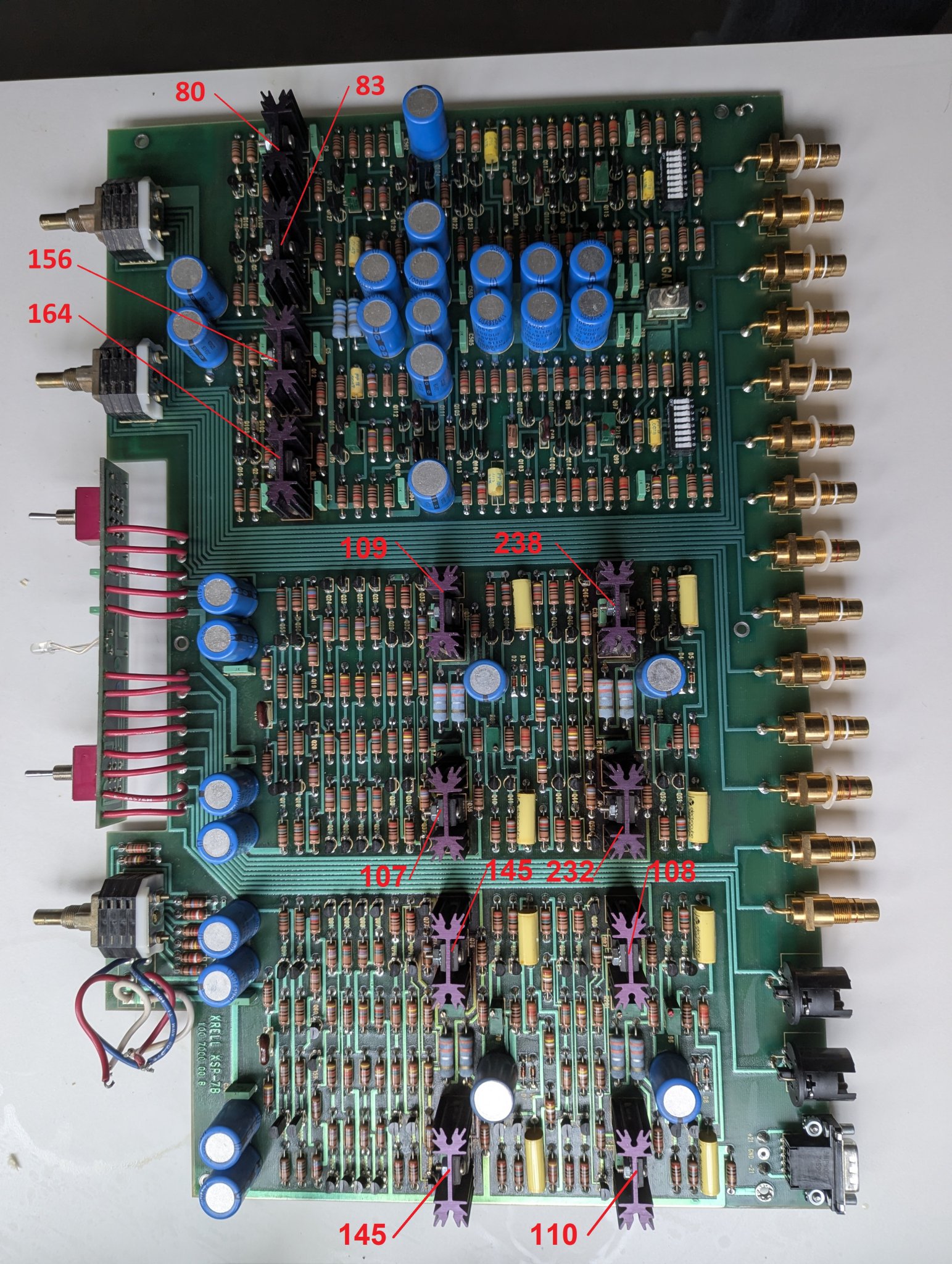

The main PCB is divided in 3 main sections; I assume the bottom two are the L and R line stages, and the top section is made up of the phono stage on the right side, and the final stage of the power supply on the left side. Does that sound right...?
I recorded transistor temperatures, shown in red in the pic below (sorry the writing is not super legible). All are Farenheit and recorded after about 20 minutes running time.
I would have expected temperatures to be somewhat coherent, in the sense that transistors in one channel would run at temperatures roughly similar to their counterparts in the other channel, but as you can see they are wildly different. For instance, the right bank of transistors in the middle section runs twice as hot (232 and 238 F) as the right bank in the bottom section (108 and 110 F).
Also, within the bank of four transistors on the left side of the top section - assuming these are in fact voltage regulators - the bottom two transistors are running roughly twice as hot (156 and 164 F) as the top two transistors (80 and 83 F).
Could this just be a matter of adjusting bias? I count 12 trim pots on this PCB - 4 in each of the 3 main sections - and the heck if I know what they're for. I looked for a service manual or schematics but I was not successful.
As noted before, all heatsink-mounted transistors are Motorola MJF15030 / MJF15031, on both the main and power supply PCBs. I found the original Motorola datasheet (attached). The stated operating temp upper limit is 150 C (302 F).
Interestingly, the Motorola datasheet states: "No Isolating Washers Required", whereas the OnSemi datasheet stays mum on the subject.
What are your thoughts? Bias adjustment? Or...?

Those numbers to me are crazy hot. Tj is be spec'ed at 150, not case temp. And that is the absolute maximum which anything above is destructive. Me, I never run over 100C case, and even that is iffy. I think expected life is halved for each 10C increase in temperature, and many devices are spec'ed to only 70C. I also ran some numbers assuming an 11C/W thermal resistance for the heat sink which is a wag at a TO220 heatsink like the one in the photo. Assuming 25C room temp, for each device, leaving out the two devices 80/83F, I get
156F DT 46C 4.2W
164F DT 46C 4.2W 8.4W
109F DT 17C 1.5W 9.9W
238F DT 89C 8W 18W
107F DT 17C 1.5W 19.5W
145F DT 37C 3.3W 22.8W
232F DT 86C 7.8W 30.6W
108F DT 17C 1.5W 32.1W
145F DT 38C 3.5W 35.6W
110F DT 18C 1.6W 37.2W
which seems reasonable as consumption is 44W leaving around 6W for the non-heat sinked circuitry. The 238 device is probably near self destruct if my numbers are in the ballpark. 238F is 114C, and with thetaJC of 3.5C/W @ 8W adds another 28C between case/junction to get a junction temp of 142C,a mere 8 degrees shy of destruct. No way Krell designed it that way. As you note, the asymmetry in the temps says something is wrong. Maybe trimpots went open on one channel, easy to check first.

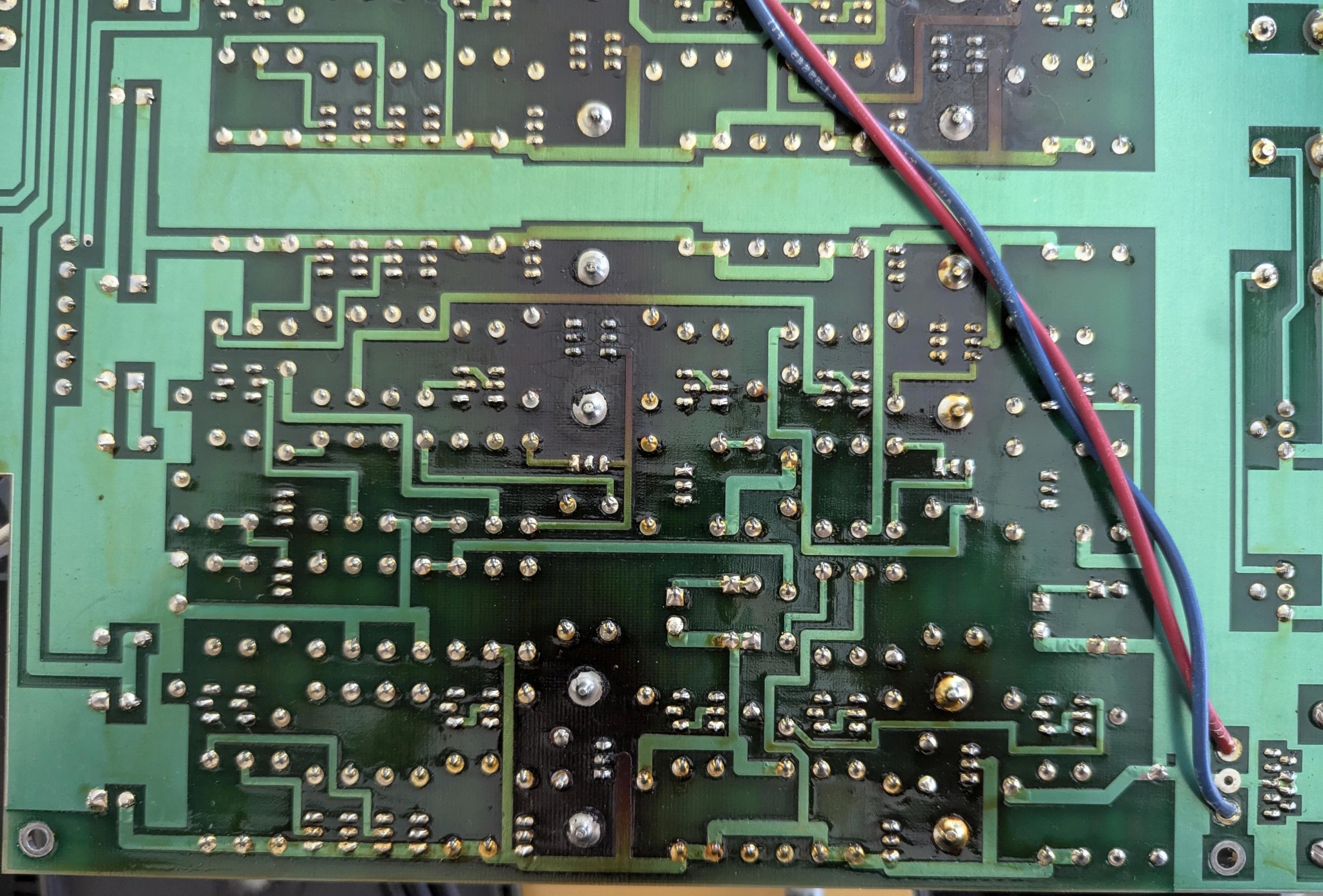

Hi folks, here are hi res pics of the top and bottom layers of one channel section (the "bottom" section on the whole-PCB pic). The pic of the bottom layer is flipped horizontally,

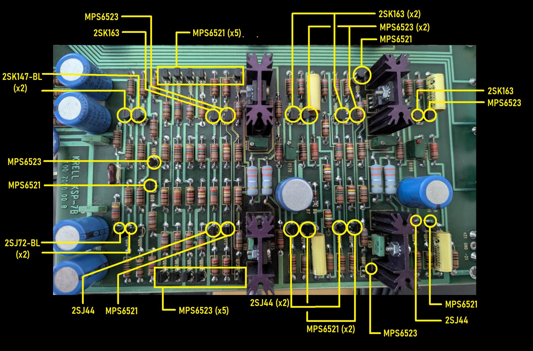

Could you please list the small-signal transistors? I earlier pre-amps Krell used 2SC2240BL/2SA970BL and jfets like 2SK163/2SJ44. But, as you state the output transistors are all bipolare, they might use something completely different. They have been known to use A42/A92. Do they use those here?

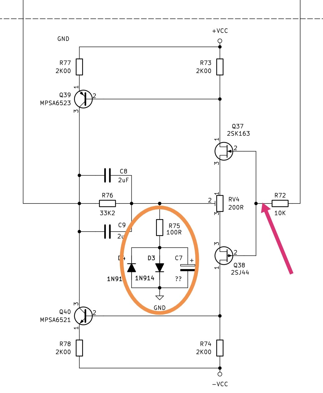

@MFRD
First draft attached. Please take with a grain of salt. Mistakes are likely. And there are some missing values and designators are not matching the actuall PCB. Not all are vissible on the PCB.
This is an old preamp so I don't know if there is any issues with copyright. If so, moderators may have to delete my post.
Now, if you could take some pictures of the phono section we might also document that 🙂
