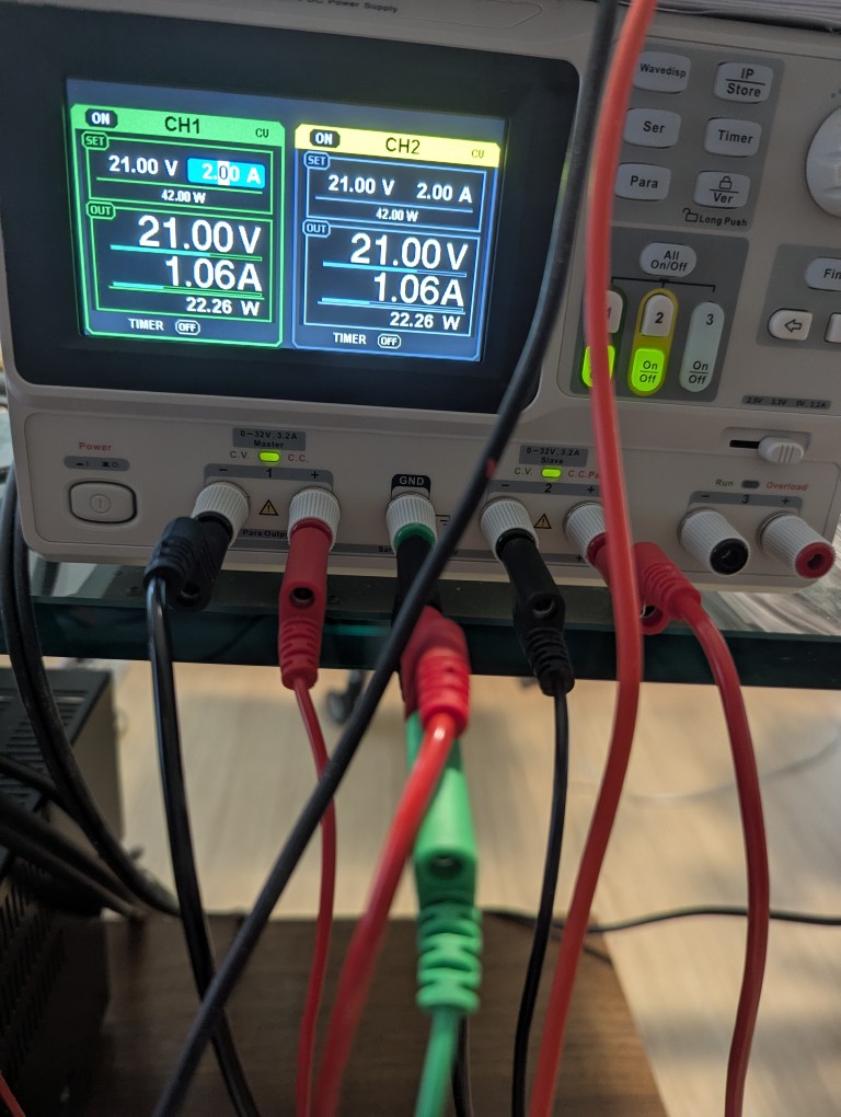

Please take full precautions, dim bulb tester and so on, assume the pre-amp main board caused the power supply to fail.
Use current limiting resistors and other methods to protect your brand new power supply.
After it tests okay, proceed with further tests to find the fault.
I would check all the output transistors and so on with a meter before supplying power.
As Naresh mentions, if your new supply has current limiting, I'd set it to a tad higher than you expect. I wouldn't worry about the supply too much. If it is decent, it should handle a dead short and just go to current limit mode. And by all means share the results, if nothing else so the next guy with a Krell pre knows how much it pulls. And finally I applaud your efforts. It is DIY. I have been working to replace the control board in my carrier AC condenser. It has been more of a curiousity than anything else. The old board works, I just don't like the way it works. So after hours and hours I've got what I want and it works with just a few more tweaks to the software that I want for power consumption reports. Sometimes its the journey, not just the destination.

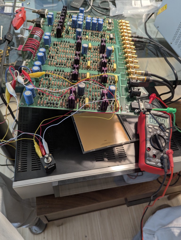

Okay folks, my new bench PS arrived! I connected power to the main preamp and (superstition trigger warning) I rigged up my new volume control with crocodile leads (because if I soldered it in, then the preamp would definitely 100% turn out to be completely ruined).
The whole rig is ready for power-on, and...
Power is on! No smoke or anything. I turned on the amp and popped a CD. Music plays!
Right after power on the pre was drawing over 1.5A per channel, but pretty soon the current tapered down to just a little over 1A per channel
Here it's pulling 1.06A per channel with music playing, although being Class A current draw doesn't budge one bit whether music plays soft, loud or not at all. I listened for about half an hour while checking and recording temperatures. The scratchy staticky crackly sonic artifacts that could be heard in the past seem to be gone now - I'm going to speculate that the old VC was responsible.
The pre is connected to a pretty low-quality system right now, just in case something went wrong, so I can't judge its sound quality. Tomorrow I think I'll connect it to my main system and we'll see.
About component temperatures... Not exactly what I expected. I observed inconsistencies that I think need to be addressed, but more on that later.

That is a relief, so you can move forward.
Put heat sink compound on the main board parts where heat sinks are attached, it dries out over time.
