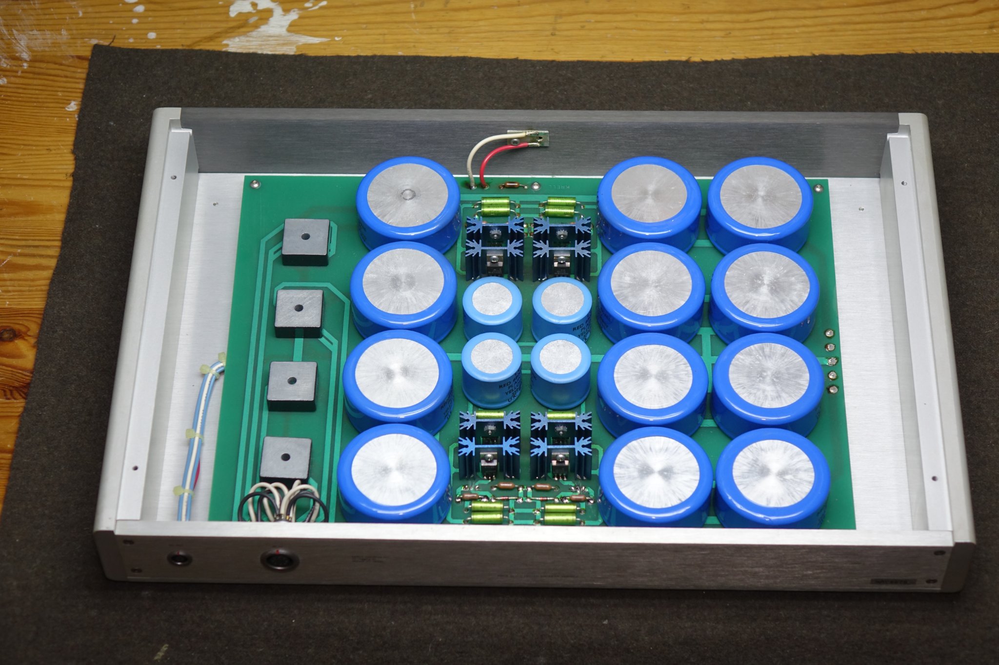

I do wonder though, seriously, at what point do we cross the line between rebuilding and redesigning? I've been reading this thread for day one and I see two trains of thought. Rebuilding will preserve the qualities of the amp.... redesigning opens up a whole can of worms.
Nothing is stopping a person from taking both roads at the same time and choosing what is best as they achieve results down the line. I prefer that approach to keep my options open.Rebuilding will preserve the qualities of the amp.... redesigning opens up a whole can of worms.
I think copying a stupid design is itself stupid.
And there are ways in software and alternate designs to build or eliminate the pre-amp section entirely.
However, there are Class A fans out there, so then convincing the owner that the new one is better will be difficult.

Discussing a " redesign" for a Class A pre power supply to be more efficient is almost comical.
Switch mode wont last more than 5 to 7 years. This one went 30 plus.
So admire the efforts to just build a new board, not to difficult design.
Just a little time.
Would say the thermal madness and runaway temp of the actual pre needs a look too.
From the pics one side looks hotter than the other. Little DC offset and runaway temps after 30 years.

25 years and very EOL. Not just EOL, it needs a new PCB no it needs a complete new PSU. We don’t know how many hours it was used in those years. Maybe this was the lone survivor and were the others already recycled to electric tooth brushes 10 years ago. Hot electronics have shorter lifetime. In some countries it is silly habit to buy so much stuff that storage space needs to be rented, maybe it spent 15 years in storage.
If it is a good idea to copy the clear imperfections and again have a very hot and mediocre performing PSU then do so. The PSU is today nothing special. Just one that gets too warm without any added benefit from energy waste. Technology then could not be made more efficient. Making a new one just as inefficient as the old one would be comical.
In any case a power on/off switch should be added. It is crazy to have this heat 24/7 unattended in a home. The lack of a PE connection while having a 3 prong IEC inlet should also be examined.

It is up to the owner but rebuilding just the PSU is easy. It is also not that expensive and makes the device ready for testing its merites. Making the PSU 100% the same is pathetic. It needs ventilation/convection which the designer forgot. Why not make it better/cooler!?

Of course make stuff better, always challenge yourself to do it better than it was done. When doing something better do it best as possible. It is really not top design but stuff with created reputation and always similar features. I know 100% for sure it can be replaced for something new way cheaper with similar performance (except phono). And: who, except turntable enthusiasts, needs a preamp with gain today!?

Today one should also consider to add CLC filtering with 2 x 4700 µF per rail for less ripple voltage and against RF/mains pollution.
Not a nighmare at all, an evening relaxed designing.

Also no transformer. It has no similarity to that of KSP-7B except that it also converts AC to DC in a (through the eyes of 2025) crude way.
