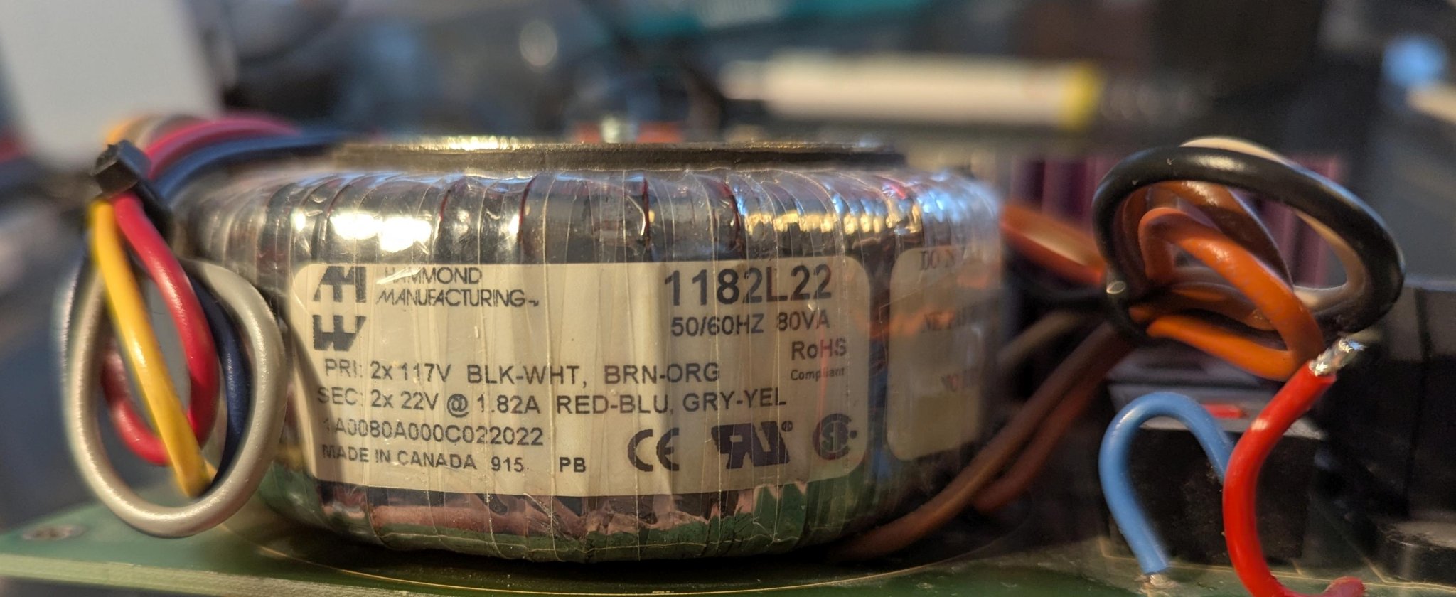

Here is the transformer rated 80VA
Leave out the toroid and the ruined PCB. That should get you ample space for a High Quality 100W dual, adjustable SMPS.
Adjust it to +/- 21volts and you´re homefree. 👍 😎

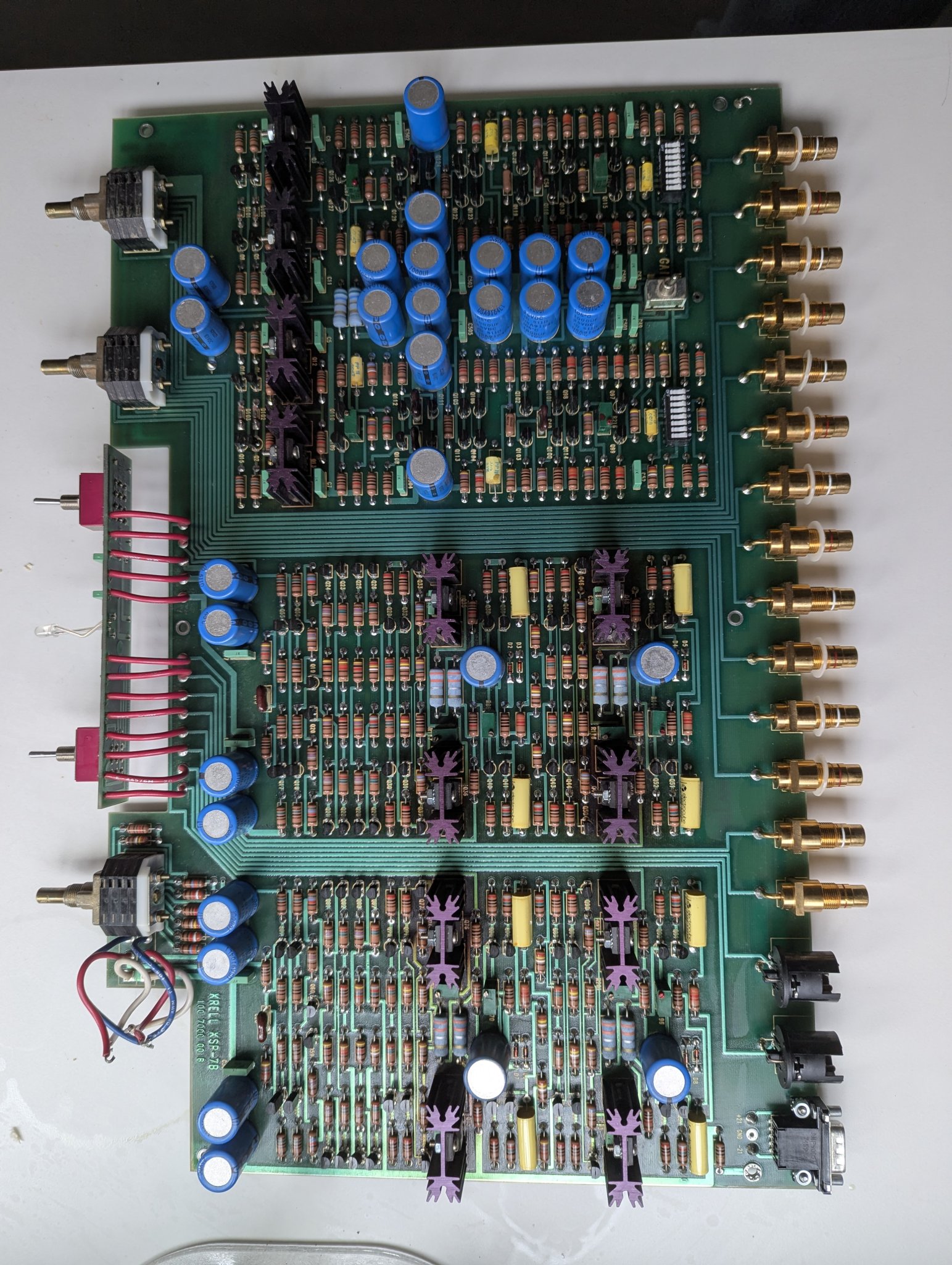

Looks like more damaged devices on the board. The main board can be saved though.
The old PCB is 196 x 146 mm. I would lean towards keeping it the same size because (a) the transformer's side of the PCB supports a few components and related circuitry, and (b) if I'm going to go the clone route I would like the new PCB looking like the original in every way possible. My only change would be for a DB-3 output connector instead of the DB-9.
According to JLCPCB's online calculator, the minimum five-board order would cost $67 plus $31 shipping (2 oz copper and 2 mm thick FR-4).
So, $100 all in all. Not bad actually.

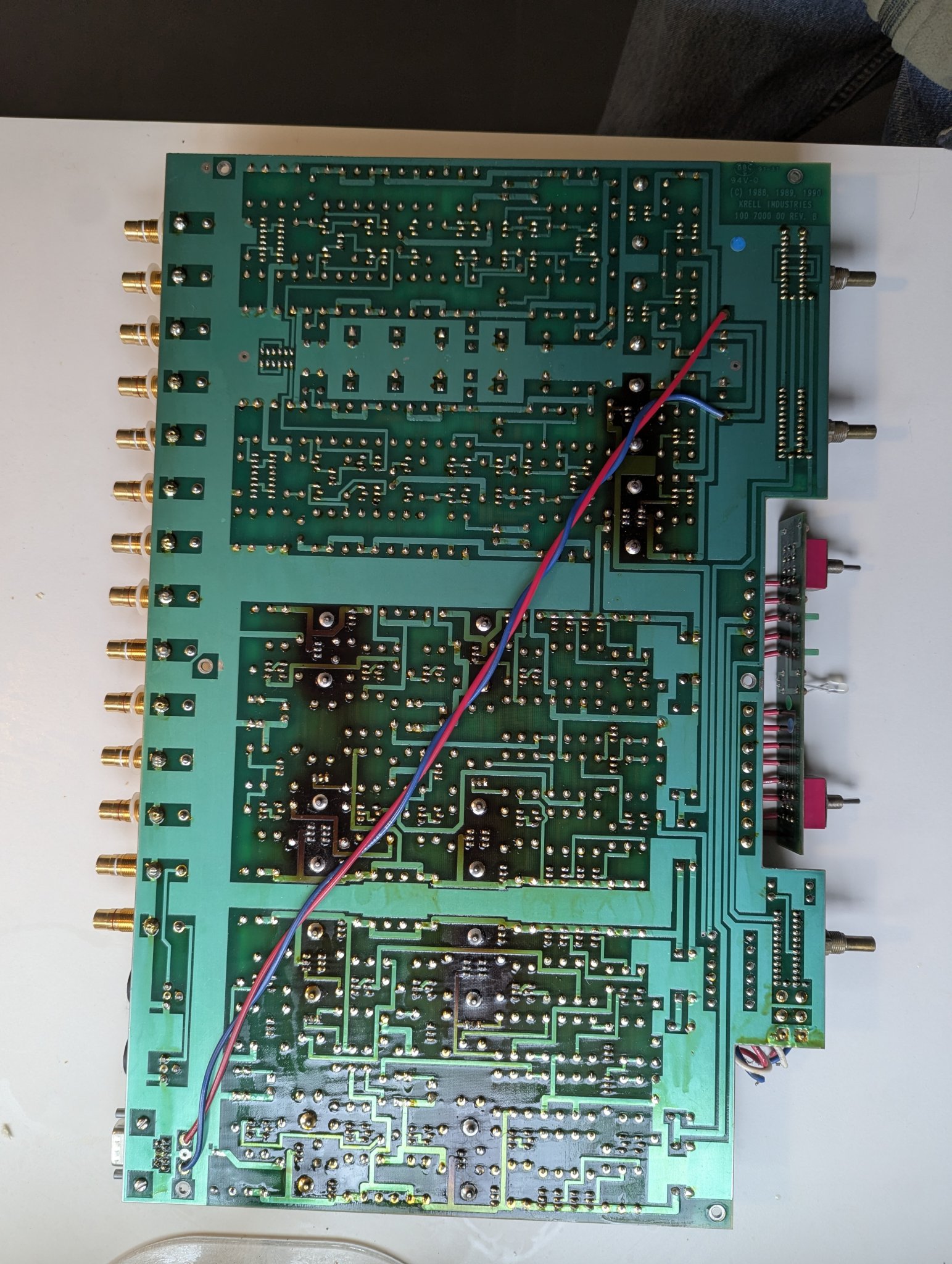

5: NO GO. As I told you earlier, the "blackened" fiberboard starts acting as a resistance thus adding to the heat.5. JB-Weld ripped traces and eyelets and stuff back on to the old PCB, repopulate it and call it good!
Given time it will turn to zero ohms. Search for similar threads in here. Not long ago, someone was in the same "boat" as you.

Try your DMM in auto-ohm settting, and poke the black part of the PCB with your probes. 20mm apart, 10mm apart, 5 mm apart.
If your DMM shows anything at all, you understand the NO GO.
Imagine putting 100K, 50K or 30Kohm between every component leg on a power supply, and guess what happens 😎
And then remember, that this is an accellerating process, with the resistance value going lower and lower over time.

The pre amp main PCB also has blackened areas, could be from the photo angle, but needs inspection.
If that is damaged, I would have to be taking a big decision about repairing the PSU, or tossing the unit.
I had done this before, but I did it again more thoroughly. No PCB conduction is present, even poking pretty hard into the worst-looking areas of the PCB, even with probes spaced 1 mm apart.poke the black part of the PCB with your probes. 20mm apart, 10mm apart, 5 mm apart.
I did the same test on the preamp board and found no PCB conductivity either.
You are correct, the preamp's main PCB does have areas of discoloration.T also has blackened areas, could be from the photo angle, but needs inspection.
These discolored areas are all located under power transistor heatsinks. They appear to be the product of prolonged heat exposure sustained over years of normal operation rather than acute electrical / component failure.
After the power supply works again, I will be monitoring component temperatures on the main preamp board and troubleshooting / repairing any issues found, something I intended to do regardless (I think I've just half-talked myself into getting a thermal imaging camera 🙂)
To put things in perspective, this unit was sold new in 1991 or thereabouts I reckon. It is, as mentioned above, a single-ended Class A device which runs full throttle the instant it's plugged into AC power. It does not have a power switch. Whether you're playing music loud, soft, or not at all, it runs at the same temperature. Conceivably, I say conceivably, this unit could have been plugged in in 1991 and running full bore nonstop for 34 years, until I recently acquired it.
I am not worried about the main preamp PCB. I do intend to monitor operating temperatures though, and act accordingly as described above.
I take it that by "damaged" you mean electrically compromised / degraded, and / or unsafe.If that is damaged, I would have to be taking a big decision about repairing the PSU, or tossing the unit.
