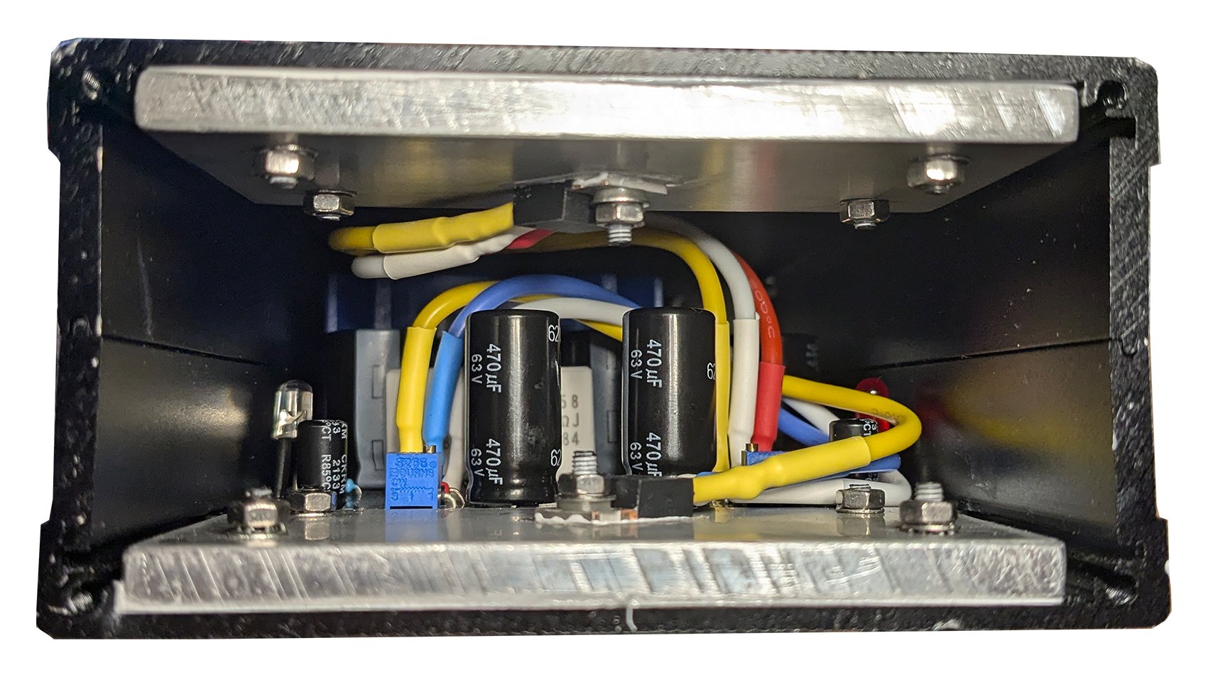

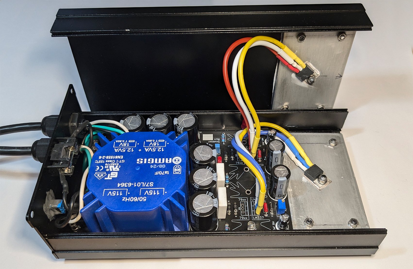

With 0.5A load current so 22W load about 10W is lost to heat. I suspect current so also power to heat losses in reality are much higher. With classic dinosaur regulators stuff will be uncomfortably hot. Someone will suggest using a fan 😉
Got the impression the Krell has separate supply voltages per channel. That would require 2 of the suggested boards. I suppose the casing is not large enough for those with the transformer added but I may be wrong.
It just screams for an intelligent lower losses design.

Diabolical nightmare? My hands are itching, this is done in an evening. I get flak regularly for having cheap Chinese non DIY stuff as I think it is silly to DIY for 10x the cost but linear PSUs are THE devices to DIY. Very rewarding too.

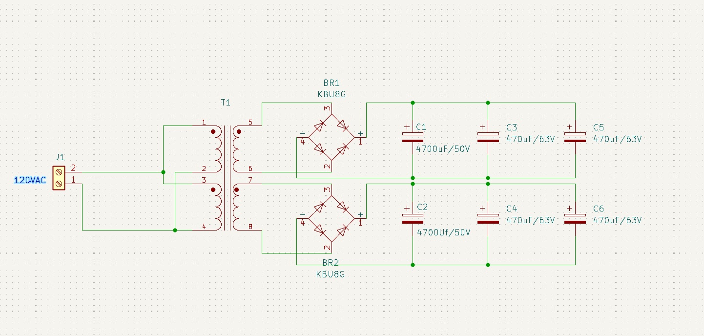

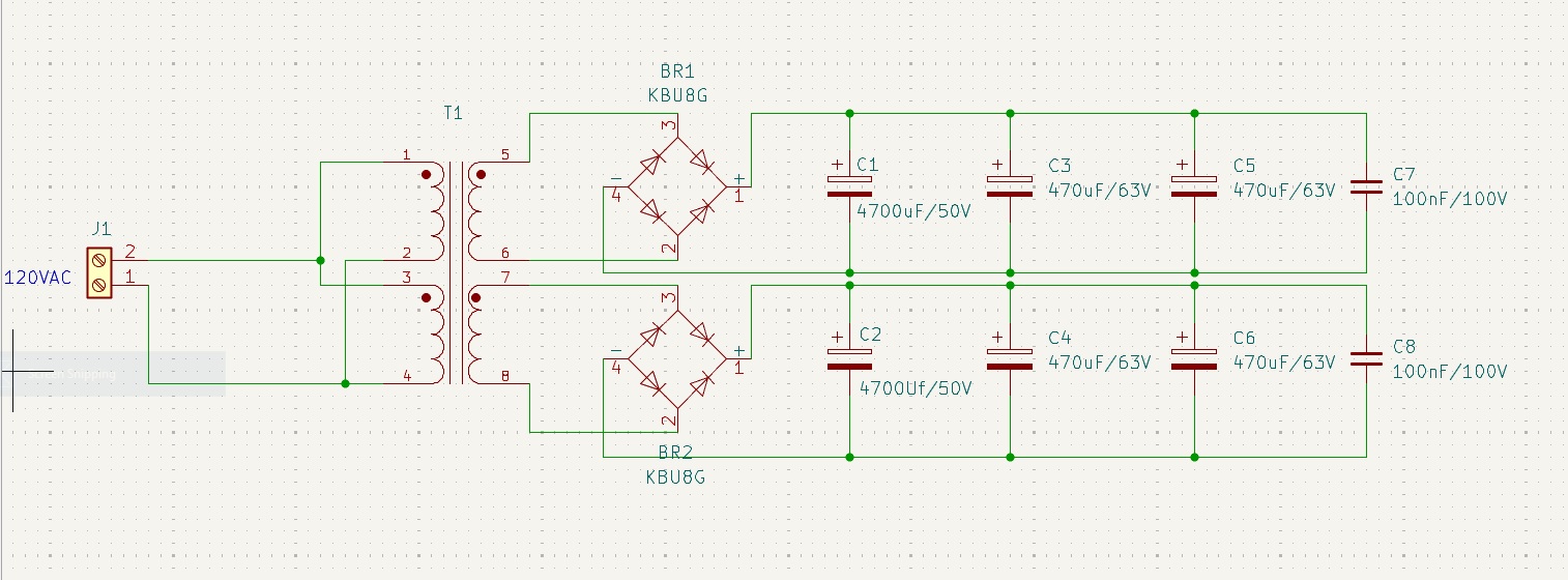

80 pound? Why? an 2 x 18V 80 VA transformer, rectifier bridges with Schotky diodes, CLC and 2 positive and 2 negative regulators. First lesson electronics but then with uLDOs like 2 x TPS7A4700 and 2 x TPS7A3301.
Challenge... make it better... creativity... you know the stuff everyone does in DIY audio. Not just doing something but by careful calculation (the main parameters are known if you read carefully) and then making something nice.
First of all (if this hasn´t been done already), make sure the pre is working properly and the see, how
much power/current, it actually draws. I doubt, the VRDN is up to the task, but that´s just a guess.
After esatblished current draw, then make a solution, that doensn´t overheat, when suppying the neccesay current.

I have a bench PS on the way. It will power the preamp for testing purposes, no need to wait for the Krell PS to be fixed.
