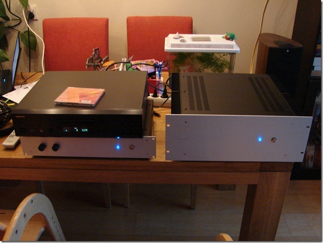

My F5 / B1 combo
This is the latest (and much better) incarnation of my F5 and B1. The preamp has a DAC included. (so yes, the philips is only allowed to send S/Pdif ). I am still searching for an appropiate phono-preamp to include. Any suggestions (preferrably an FET-design of which an PCB-design is available) ?
