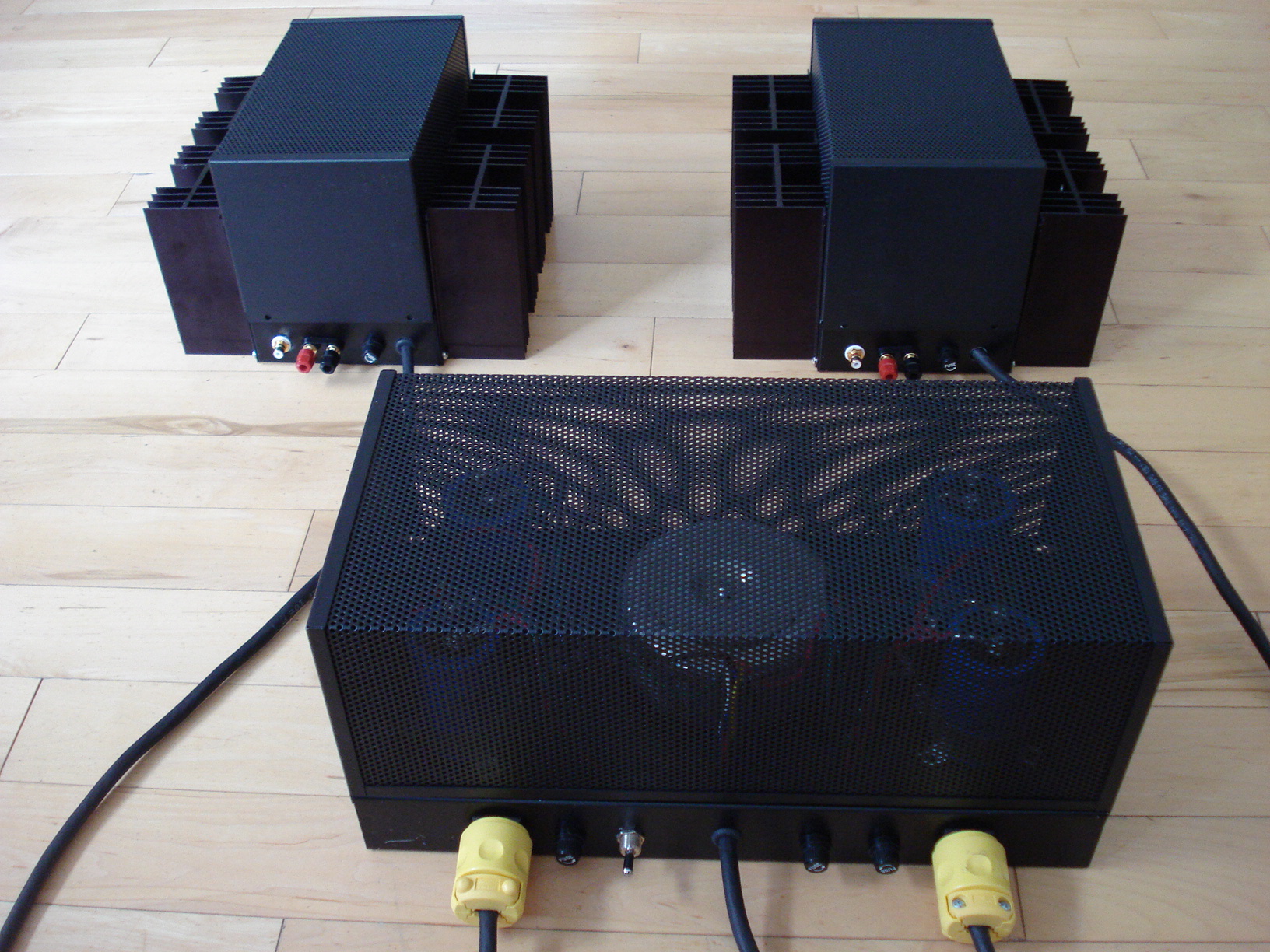

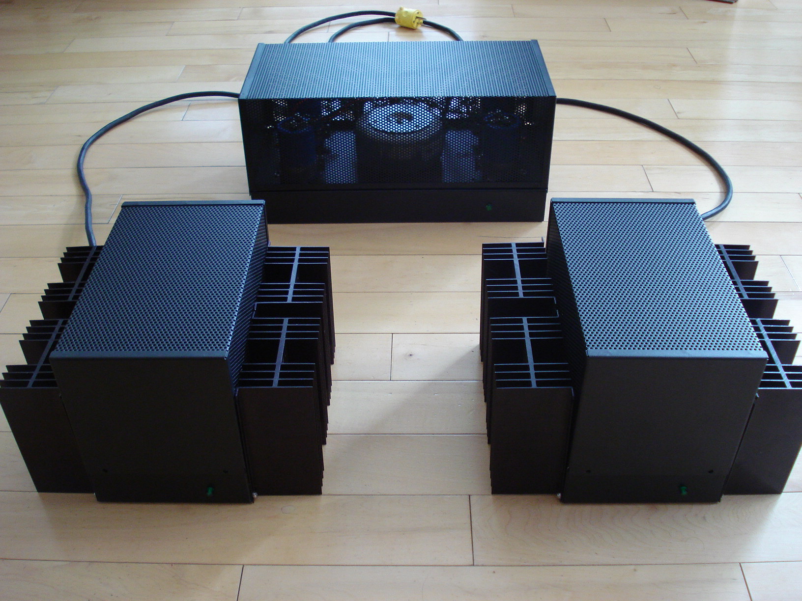

Extremely impressive, more pictures ? Great work, you build chassis or bought ?
A40
20 years ago I purchased the partial kit from Old Colony. Stuffing the boards is as far as I got. Then recently...
Thank you for a sweet sounding amplifier Mr. Pass!
Thank you for the compliment . It's a 3U/400mm pesante dissipante from modushop.biz. I don't have more (good) photos right now because my current lightning setup isn't really able to light a subject this big evenly.

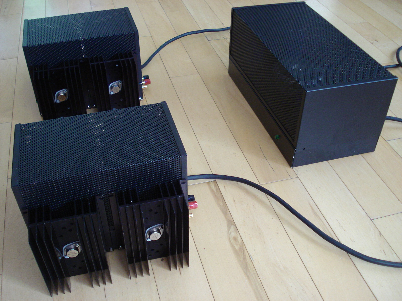

Very cool design, congratulations. I got four of these sinks, so.
What PCB did you use?
Is there any under side pics?

I used Peter Daniels pcbs. I had to under bias my amp as the horizontal rating isn't quite enough dissipation. I haven't taken any upskirt shots but could.

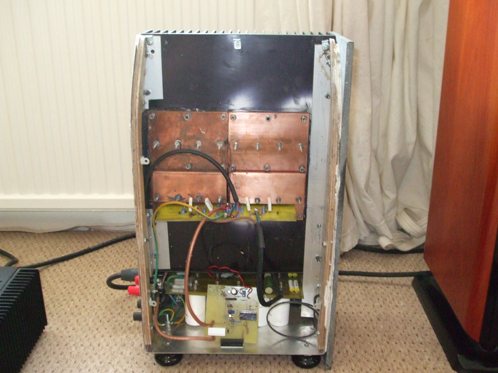

Stand her up so we can see her knickers all the time.
Here 'tis, in all it's 1/4 chrome glitter.
... mostly self & copper destructive...Bksabath, you are a very dangerous guy
Sorry, just silly a joke... (upon lazy & unseccessful work on my own F5 )

& for fun
I must have popped one of my diodes.
Just can't get the jokes.
If you don't get the one abowe just remember Marvin...
I think I said that before but just love cooper.

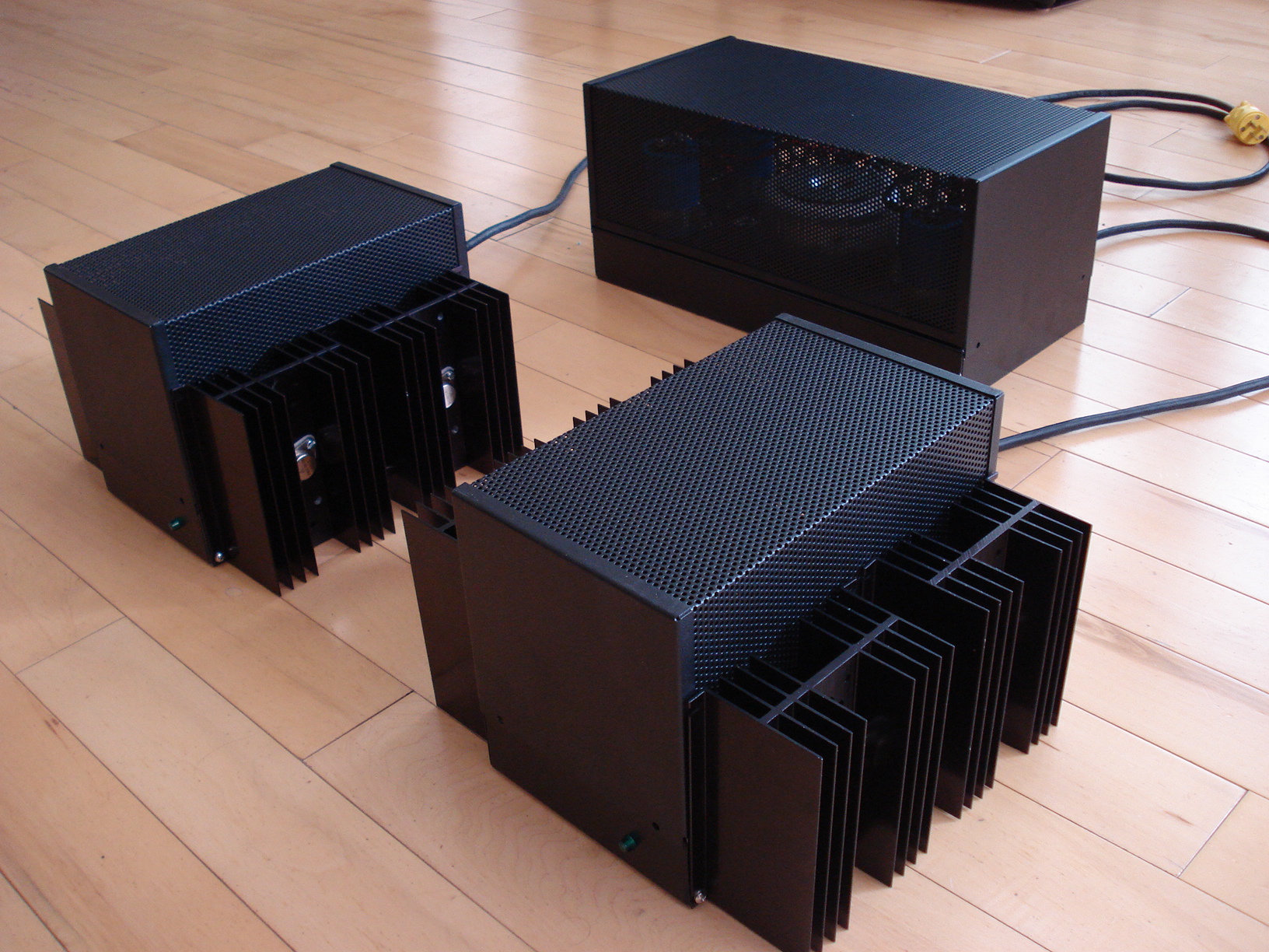

maybe one of the reasons why the top of the TO 220 is at 56 C and the top of the spreaders at 43 C as I was taking things easy only 26 V rails biased at 2.8 A for now.

150 mU rail
CRCLRC + same small ones as Papa said
100 mU in the power suply
The 2 mono blocks have their own banks 50 mU rail (total of 40 10 mU caps)
At present I may ad another 50 mU rail if I go By amp or ballanced so each board got its own
And 36mU on the mains DC filter.
