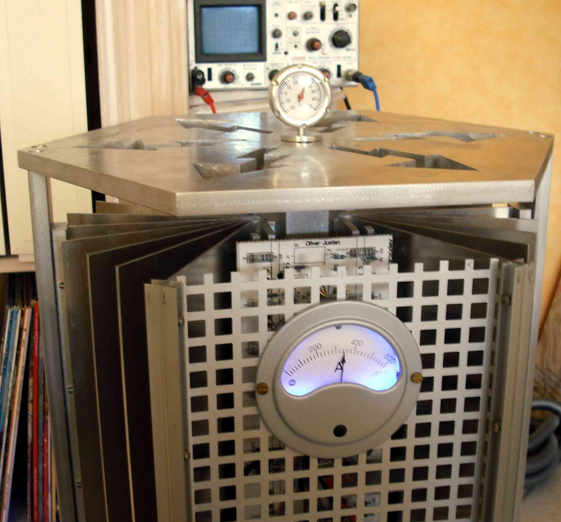

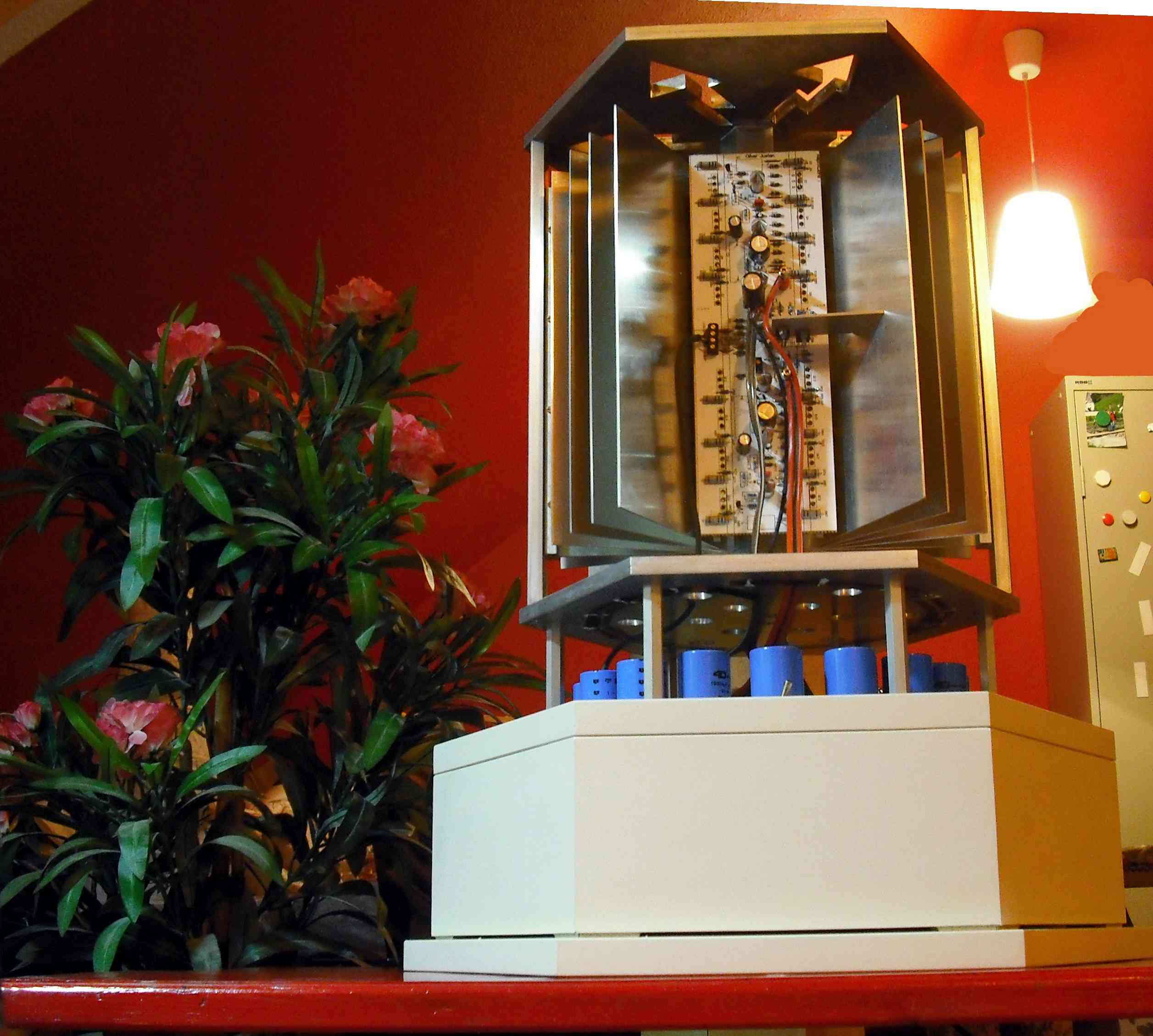

XA 50:4
XA 50:4 It works since Dec. 2010.
  • Transformer 1500W (seondary: 1x44VAC)
  • 48VDC CLC => 8x10mF ->L L->8x10mF
  • Stereo =>32x IRFP250N
  • Total idle current: 7Amp DC
  • Temp at the top: 55°C
  • Cooling: Alu plate 2.5mm Complete: 1 square meter
  • Top and down plate: 12mm

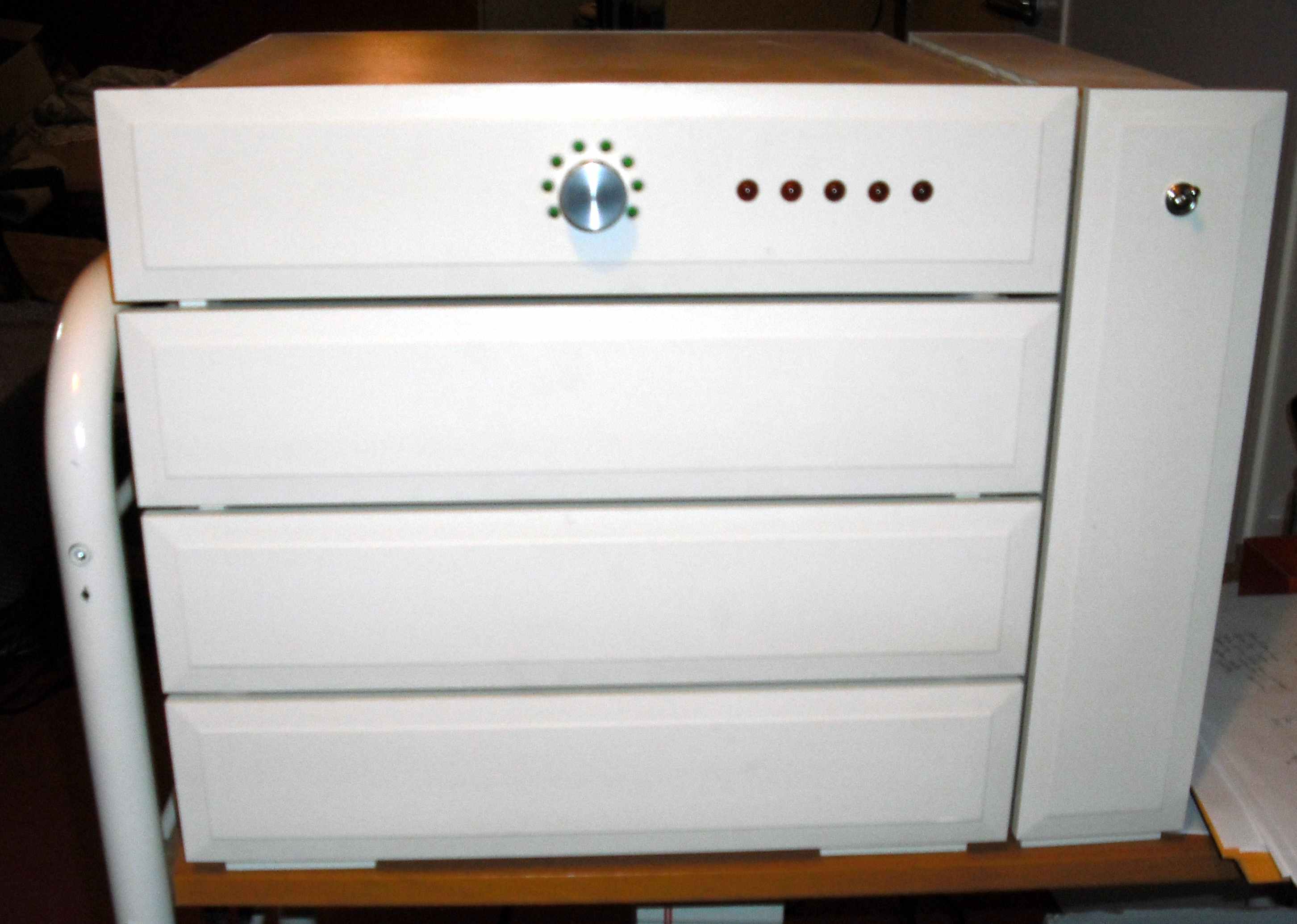

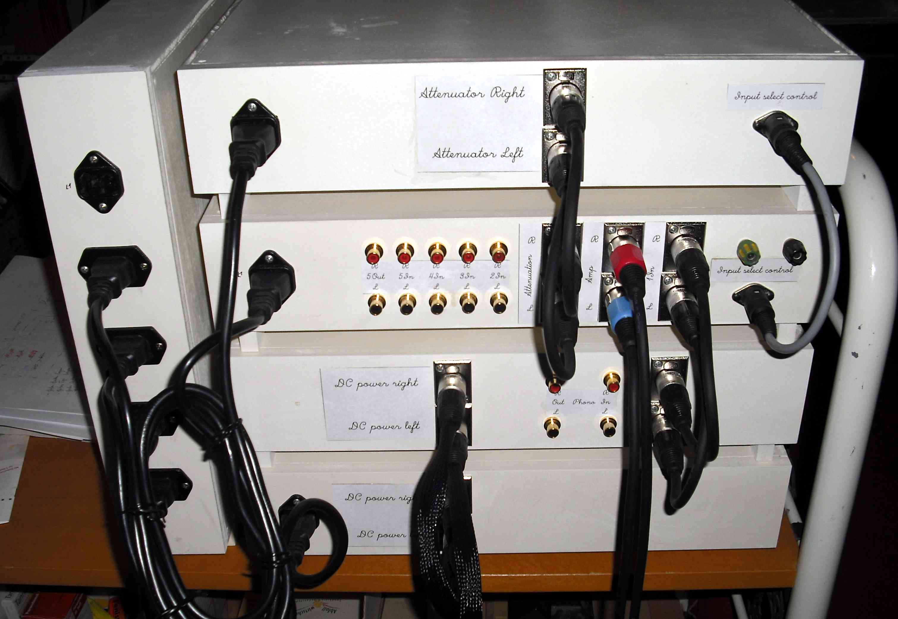

Pre amps:
  • Top: Attenuator
  • 2. Aleph P1.7 incl power supply
  • 3. Pass Xono
  • Bottom: Power supply XONO
  • On the side: AC Supply with 4 double filters

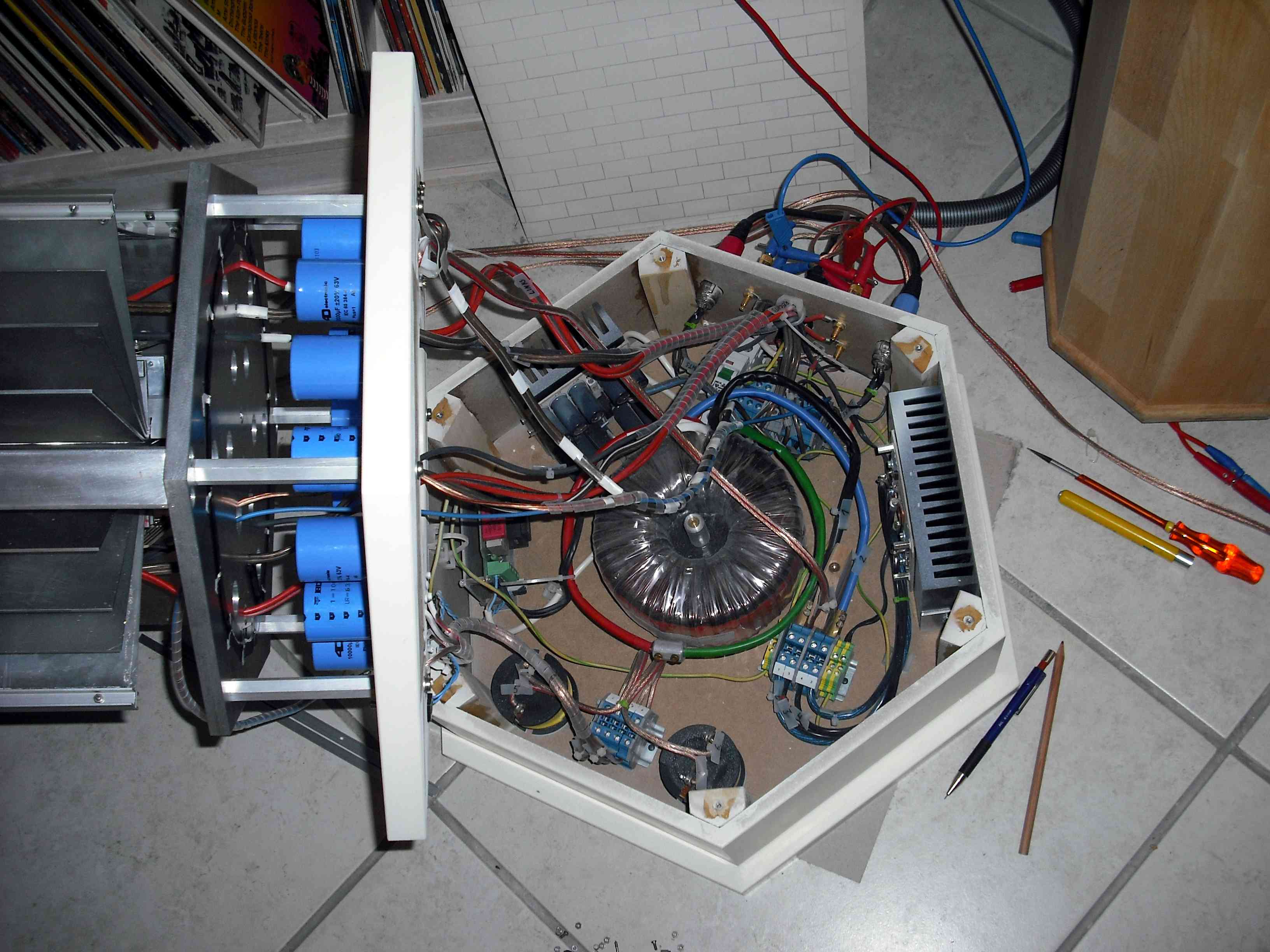

They are not purchased, my friend made them.
Looks like I'm going to have to wind my own.

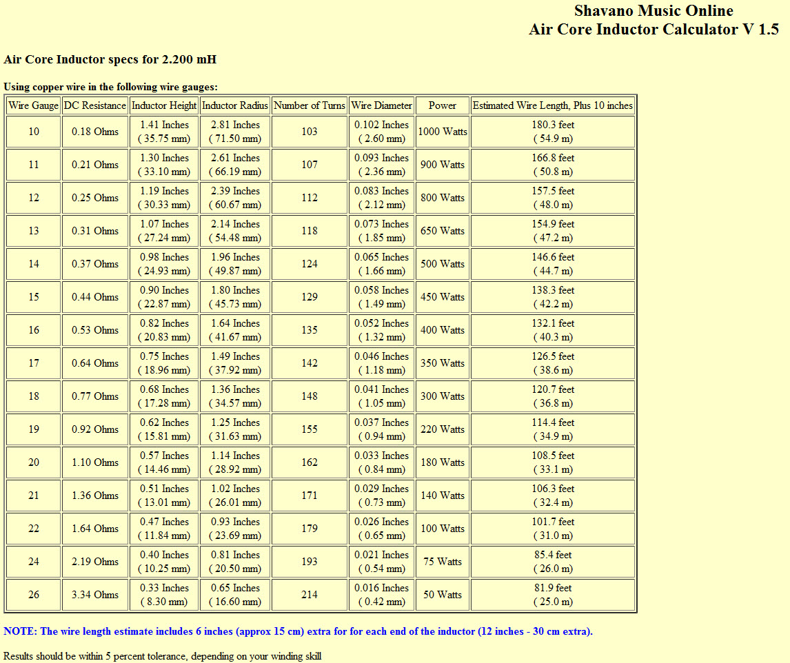

146 Feet but got loads of trubles converting that to meters
evvery time I got past a certain point I have to turn a corner and loose count.
And I am only size 7:D
Joke
right 50 meters shuld do nicely but calculator came up with 0.36 R
Had 2 on the mule cooper came by the kilo so I got 2 kilos and it was 2.5 mm square.
Not a blody clue of how meny henries and they look crap as right pain to bend and wind nicely.
PS tanks for calculator I sure it be handy.
PSS How do you mannage to find this stuff and remember where it is?

now you can go nutz ..... old recipe :
"some data for my chokes (presumably 9mH, certainly 0E2 Rdc) :
EI72 package
height of package ~30mm
entire window filled with 1,25 enameled wire
air gap ~ 0,5 mm "
