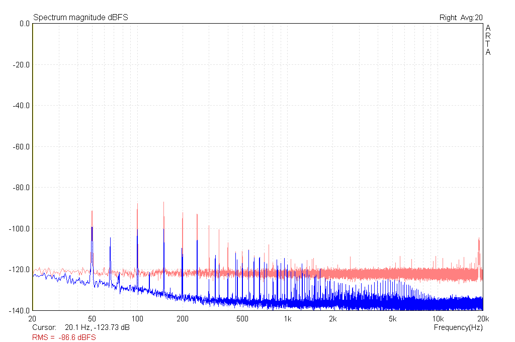

If it's interesting for anybody, here's a plot that ARTA gave me. The blue plot is from the Zen, the pale red one from a Pioneer SX-339, for comparison. The Pioneer's volume was set to equal that of the Zen, as it obviously has a bit more gain. Both amps were tested with the inputs connected to the soundcard and the output loaded with a real speaker.
As you can see, the Zen has even lower hum than a commercial Class-AB amp (well, it's not that high-endish, but still) and is a lot less noisy! I'm using Spendor S6 with 88dB efficiency, where I can hear the noise of the Pioneer with the ear directly in front of the speaker. The Zen is totally inaudible.

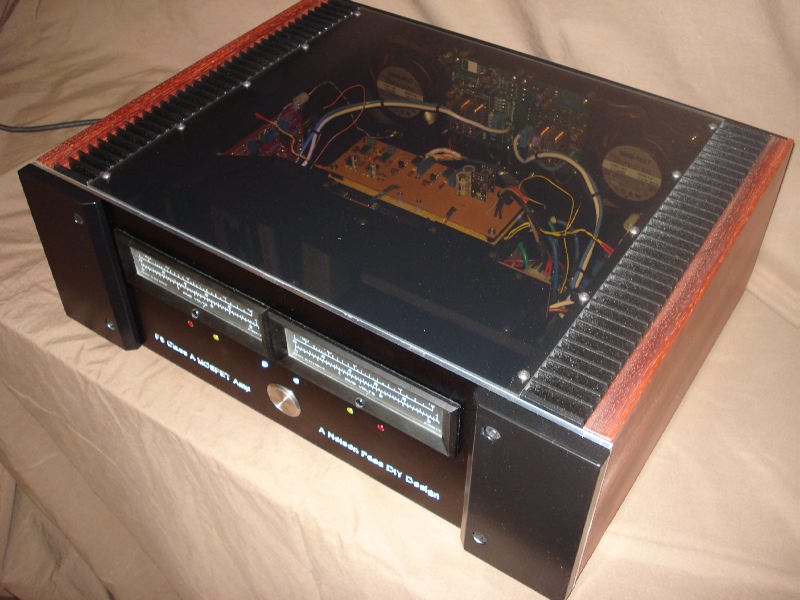

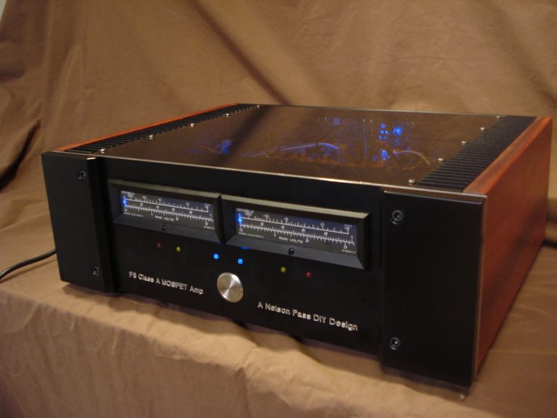

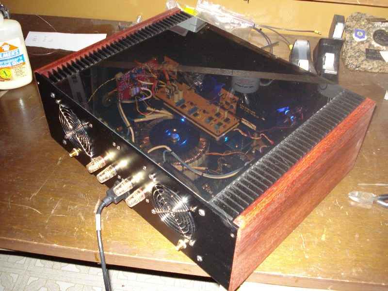

Finally got the front panel end plates powder coated, so here's the final project:
-- F5 two channel, common PSU
-- Speaker protection
-- Weston "projection" VU meters, modified for LED light sources
-- Heatsink temp sensors/alarms (currently set for 55 degrees C)
-- Clipping monitors
-- African hardwood side panels (to match my other equipment)
-- All chassis plates 3/16" aluminum; Conrad heatsinks
-- Plexiglass top cover with internal blue LED highlighting
-- Two low-speed AC muffin fans to circulate air to the heatsink fins
Construction details and more details are at this thread:
http://www.diyaudio.com/forums/pass...-build-beautiful-music-different-drummer.html
Heatsinks running cool, the fans are silent, and the amp sound great! Thank you, Papa Pass.....!!

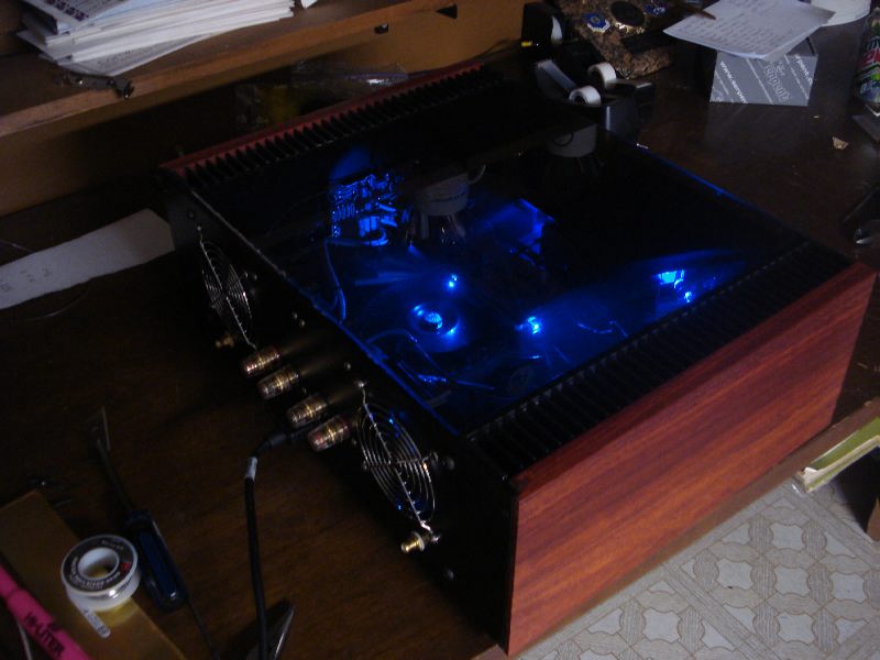

What a clever way to use the "blue" light! 🙂
I think I first got the idea from a K-Mart store--at the "Blue Light Special" counter.....!
🙂 With all the blue lights in our computer fans, one would think all of us would have figured that one out... no such luck on my part.
Haven't been to K-mart in years, do remember the blue-light-special, though. Ha!!

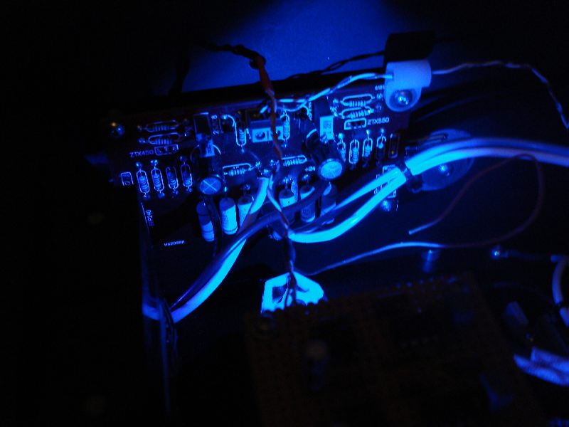

While we're on the subject of blue LEDs, these two Weston VU meters are the only ones I've found in the last 45 years; they employ a light source (originally a 5W incandescent pilot bulb, but now a .5W blue LED) to project on the VU meter face, using the internal VU meter movement to deflect the beam. As a result, the VU reading is actually a "beam of light" from the LED that moves across the meter face.

Looks dandy, neo-classic retro kinda.
The heatsink tunneling is a cool cooling idea.
(tastes always differ though, the LED Xmas tree is a tad over the top imo, that front panel deserves All-Blue minimalism)
Jacco,
Yep....the old-school "retro look" with a simple Pass Class A internal was what I was shooting for. Thanks for picking up on that.
I probably have mixed emotions, too, on the LEDs. I figure I'll tire of the internal LEDs about the same time I get tired of polishing the plexiglass. When that happens, I'll probalby swap out the plexi for a powder-coated top cover.
Same goes for the clipping (yellow) and heatsink temp (red) LEDs. If I rarely get any "alarms", I'll probably clean up the front panel (and the vectorboard) and remove them.

Very clever CAM. Really! I'll bet it's just beautiful in the dark.
Can't wait to fire it up, next to my lava lamp collection! (Kidding....just kidding!)
Just stick a simple low pass and hi pass filter and get the led to flash as the amp plays along.
You can also ang a litle triangle in front of them And play same Floyd
