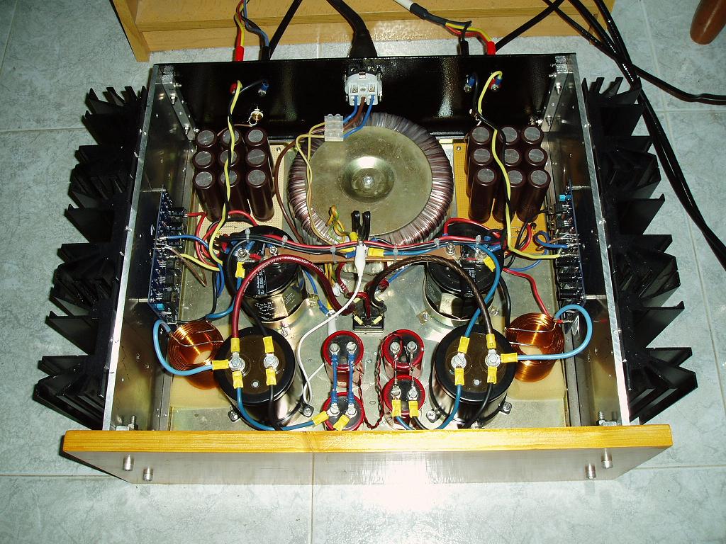

My Aleph3 of 2004

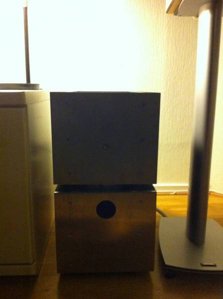

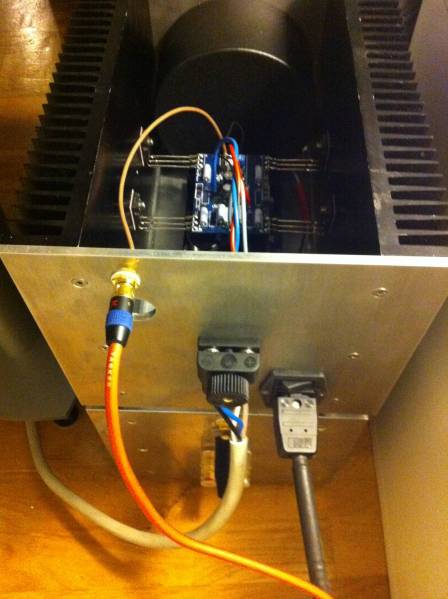

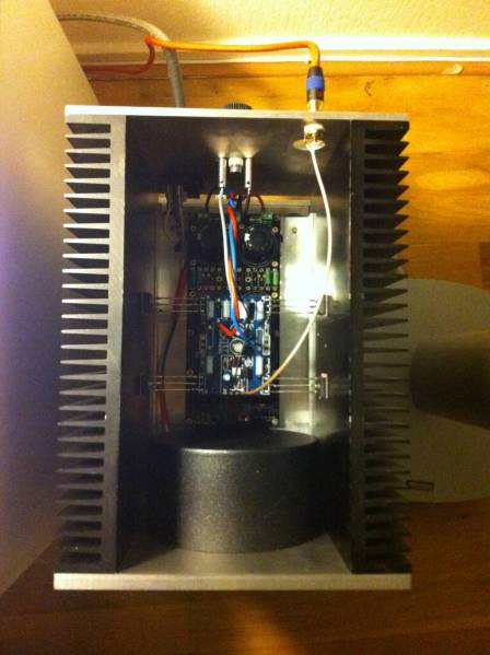

This week i finally finished my First Watt Chassis, currently equipped with a Aleph-J. Sound is great. Playing direct from a Logitech Duet.
The boards for the F5 and F4 are almost finnished and will be completed very soon offcourse! haha.
Stay tuned for Battery supplied FirstWatt. Lithium powerrrrrr
big brother under the FW is a Aleph 5

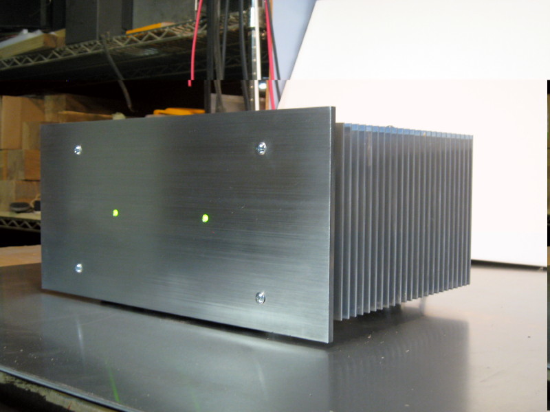

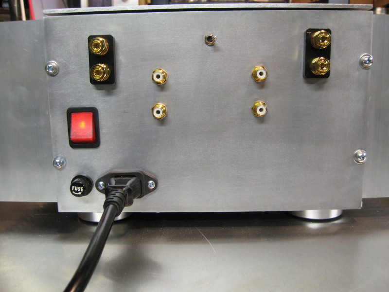

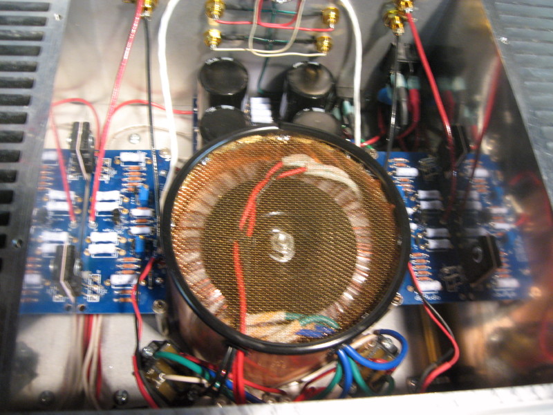

Pass F5, nicknamed "Baby Bad-***", width is 15" total, depth interior 10", height 6" (without feet and faceplate).

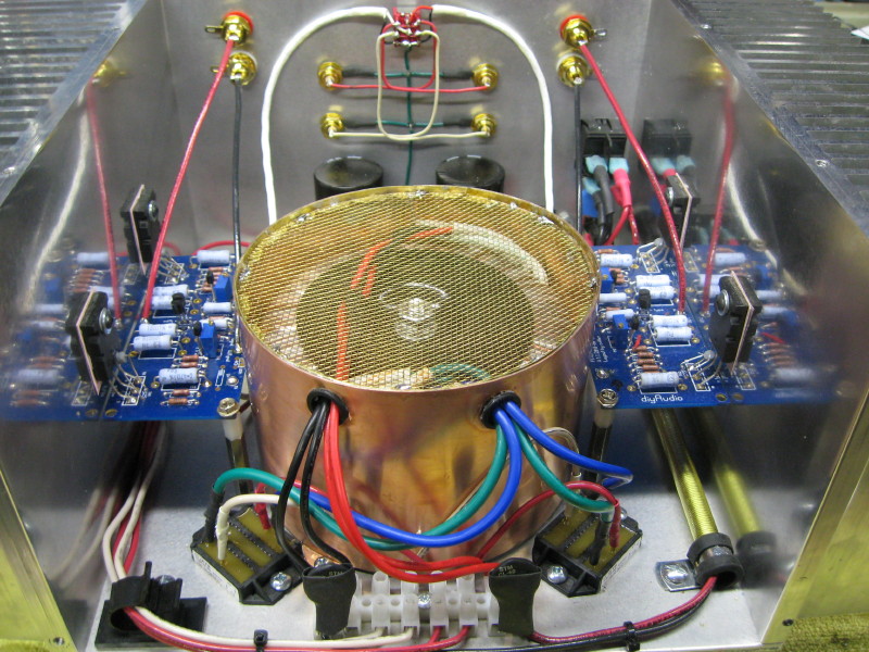

My new BA-3, set up as a preamp gain stage
Gain stage and power supply. There's absolutely no hum or noise.
Styling is derivative of my F4: actually this is just a really quick way to build enclosures (and pretty cheap). Aluminium angle from Ace Hardware, plywood and redwood cheeks from Home Despot.
The LEDs are a bit bright, but at least that's easy to fix. They stay on for a minute or so after I unplug.
Sneaking up on the gain stage. It connects to a passive front end that does switching and gain control: I may integrate them one day...
Power supply uses a transformer rated at 50VA. Capacitors are 35V which is sailing a bit close to the wind (voltage under load is about 32V).

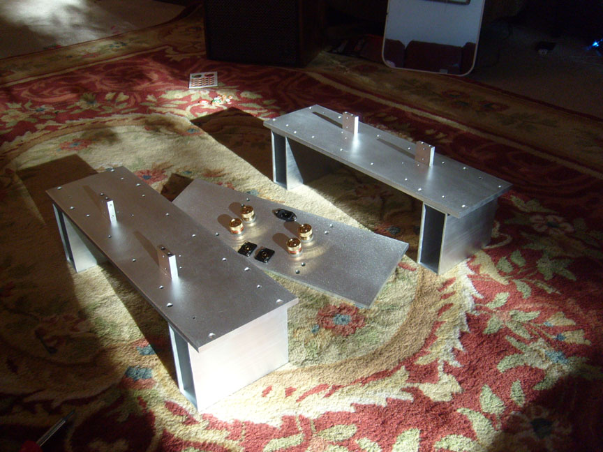

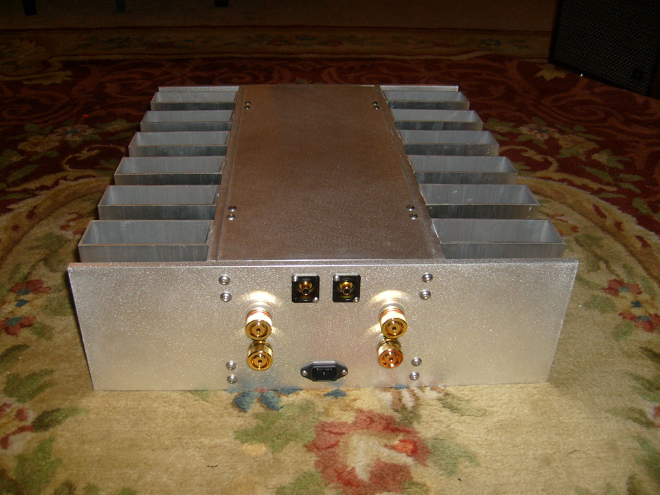

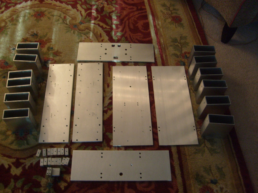

F5 in BA style chassis
Just started playing music today! This is my first amp for driving speakers, (all headphone amps prior to this) and it was a holy cow! 😱 moment when I first heard it.... Thanks Nelson!!! Also,,, many thanks to the community for all their contributions, you all have been a great help....
Sean

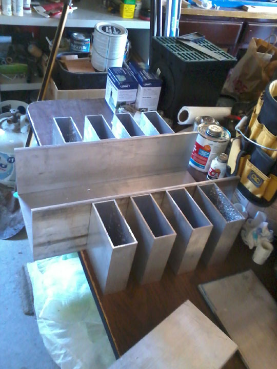

Really well done.
Can you elaborate on the case construction? Supplier, tools you used vs what you had done by a shop, and cost?
Really well done.

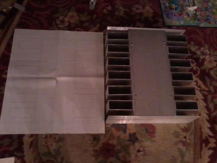

Thanks NYCOne...

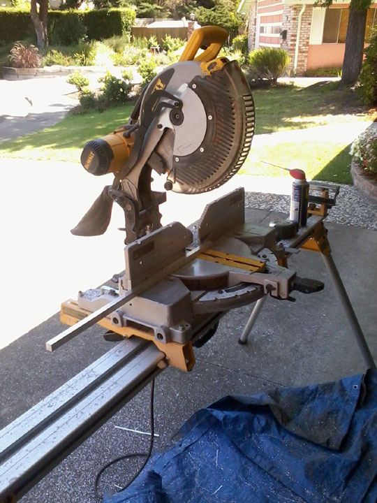

The sides, face plate and rear plt,, are 3/8 x6 flat bar, top and bottom covers 1/4 x8 flat bar,, rec tubes are 2x5x.125 thk. corner blocks (hold it all together) .625 square bar.. All 60-- series extruded alum... the 8 wide flatbar came from metal by the inch.com,,, all the rest came from online metals.. cost about 225.00 (just the metal) Screws, taps drill bits and other little bits came from the local hardware store...
All cuts were made using a dewalt chopsaw, using a fine finish blade (lotso teeth) light pressure and copious amounts of WD-40. the saw does a pretty good job but the cut edges need filing to look good.. I got pretty good at filing🙂

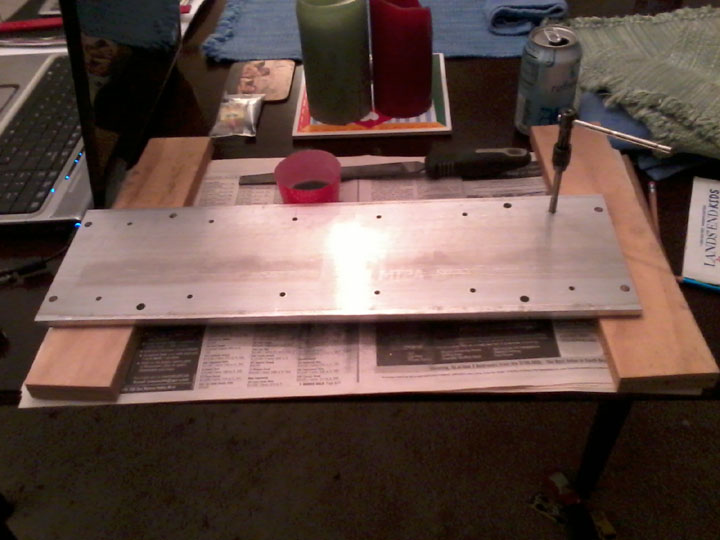

All the holes were done on a small drill press and tapped by hand.. I also got good at tapping:warped:
I did all the work myself😀
hope that helps
sean

Nice work, Dionsio! Can you comment on the heat dissipation? If your design handles the standard heat dissipation, future builders could save the cost of extruded heatsinks.
