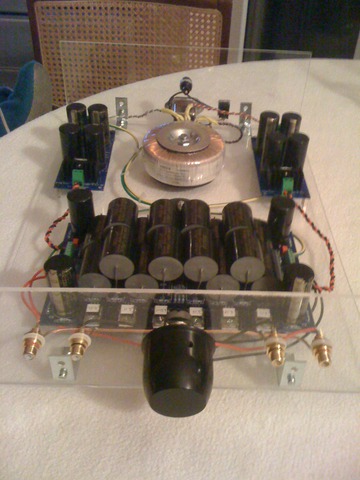

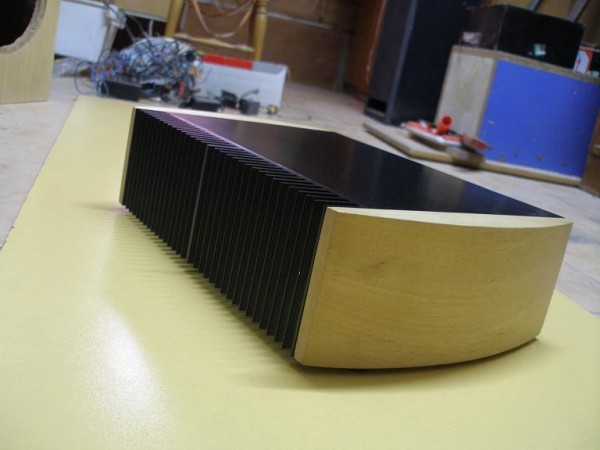

My unfinished F5
Here is my F5 not yet complete, but getting very close.
I still have to Anodized the top and front plates "clear mat", and paint black the perforated plates and two stripes on the front plate where the white LED's are going. The clear mat finish should come up nice.
And also some feet to stand on.
Can't wait to listen to it again.
Ill post the finished product soon.

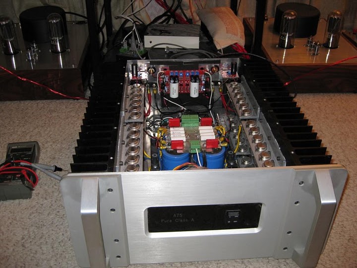

A75 to BA-3 Conversion
Here is the re-tasking of my A75 Chassis and output section to the BA-3. The sound is quite nice and the Bias and DC offset is more stable than the original A75.

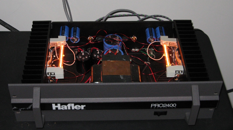

Hafler Pro2400 to Delite conversion.
Here's a picture of my Hafler Pro2400 to Delite conversion. Using an IRFP240 as a capacitance multiplier, 500W/120V halogen tube for a load resistor. Signal transistor is a IXTH6N50D2, 52V after the capacitance multiplier, 23.5V at the drain, 1.6A.
With the capacitance multiplier, barely audible hum at the listening position, no HF hash even with my head stuck into these:
Sound is pretty good so far, need to play with some bypass caps for the output electrolytic..
Roscoe

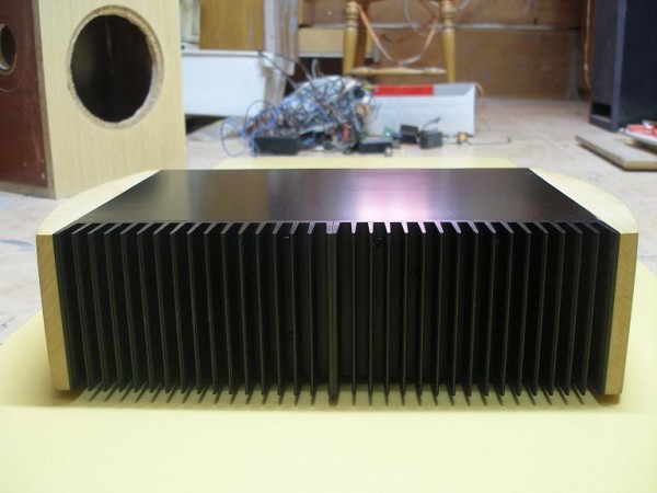

The Best - First Watt F3
Andrej,
It looks like you used the 400mm deep (two heatsinks each side) Pessante Dissipante from Modu. I have a similar chassis in my garage. How did you arrange the transistors and how many watts per device are the heatsinks dissipating? I was thinking of using the same heatsinks for the BA-2 (three pairs of mosfets for each channel). Do you think it is up to the job?
Chris
