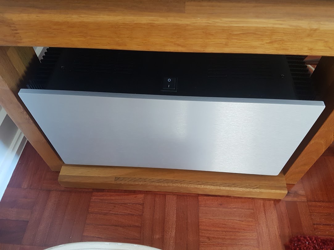

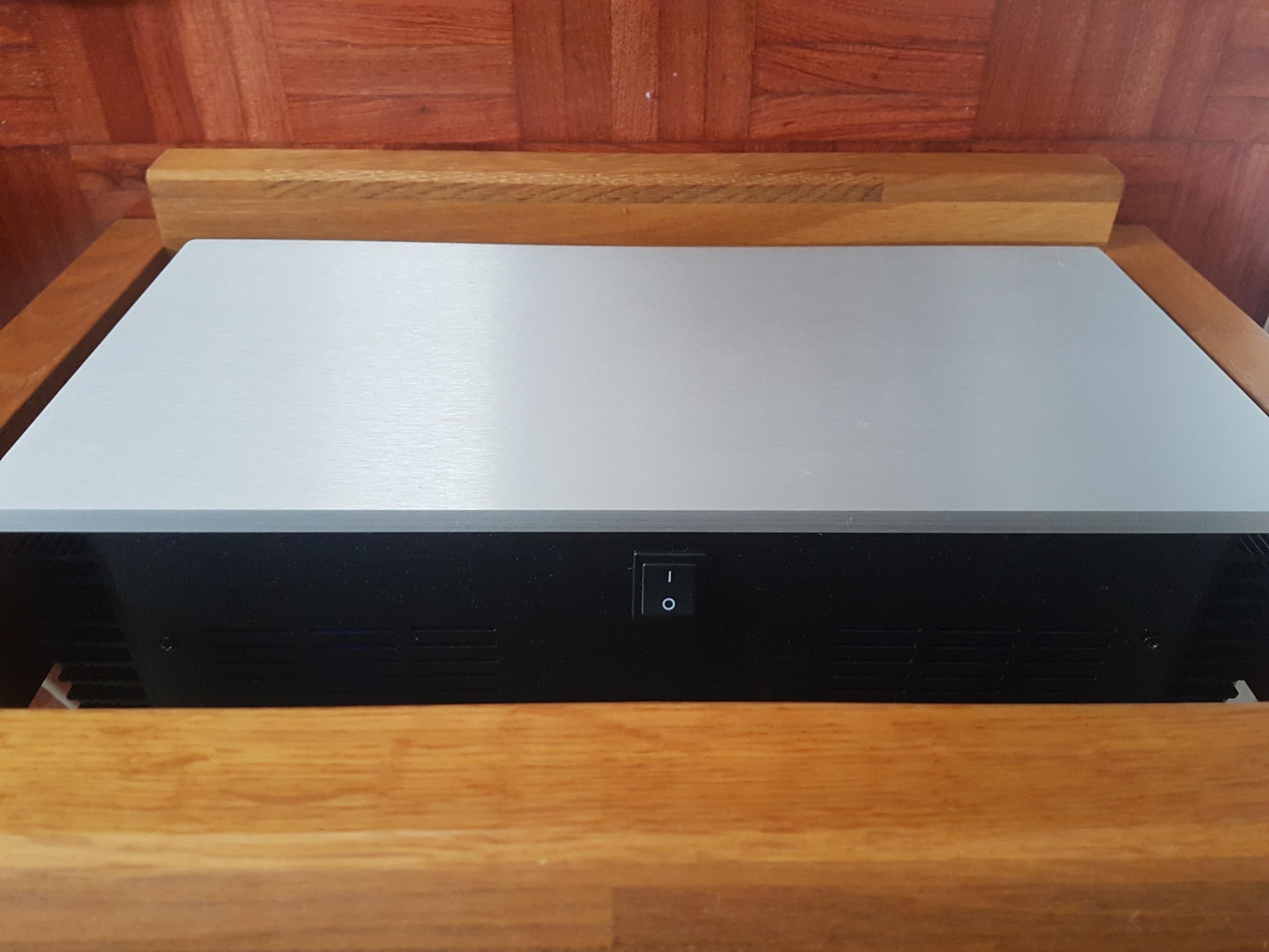

Here is the pic! Upside down but you get the idea!
ZM, i wanted to put the switch on the bottom but the toroidal is up front and in the way. I would also have to drill through the metal internal base so alot of extra work.

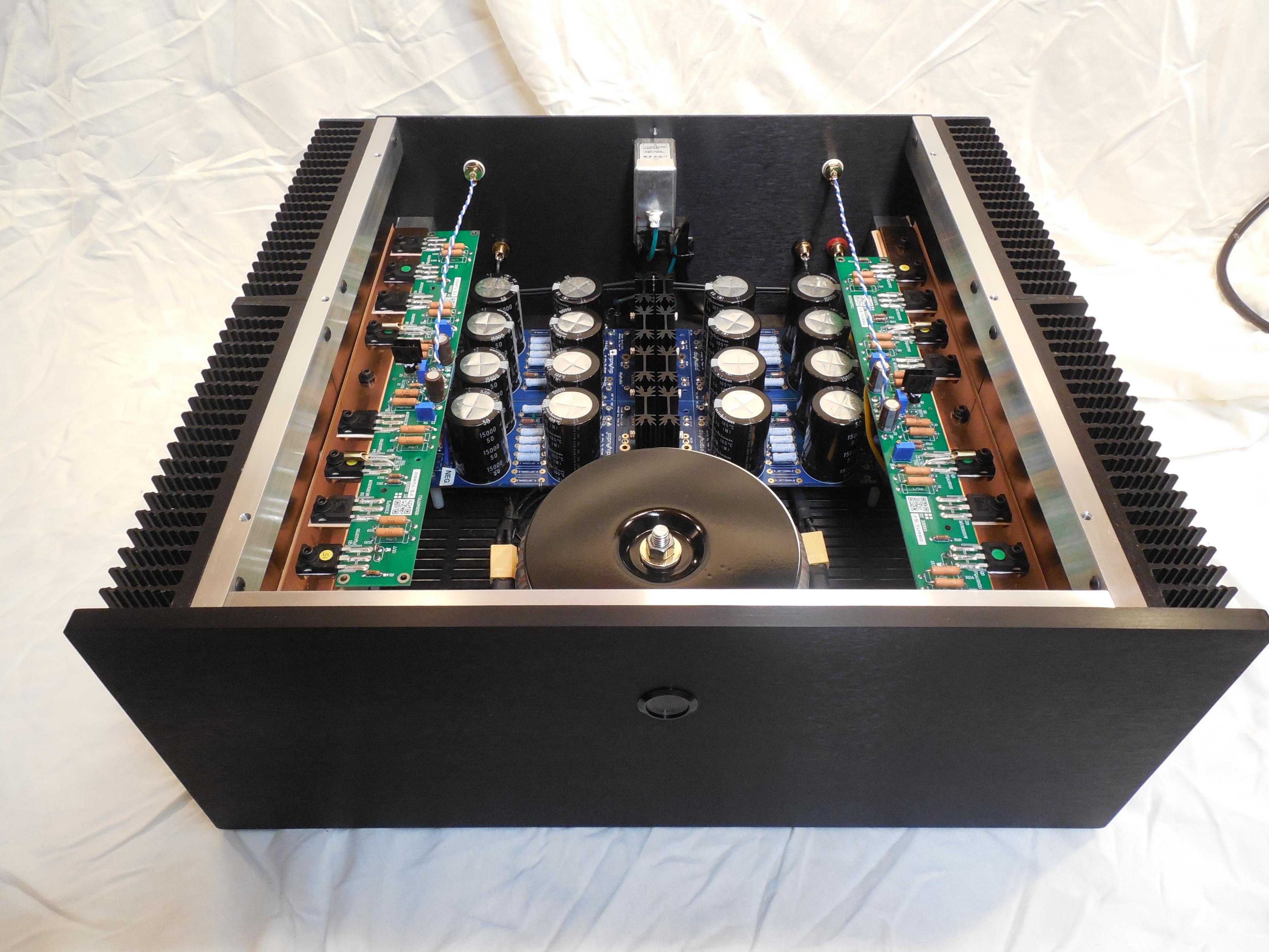

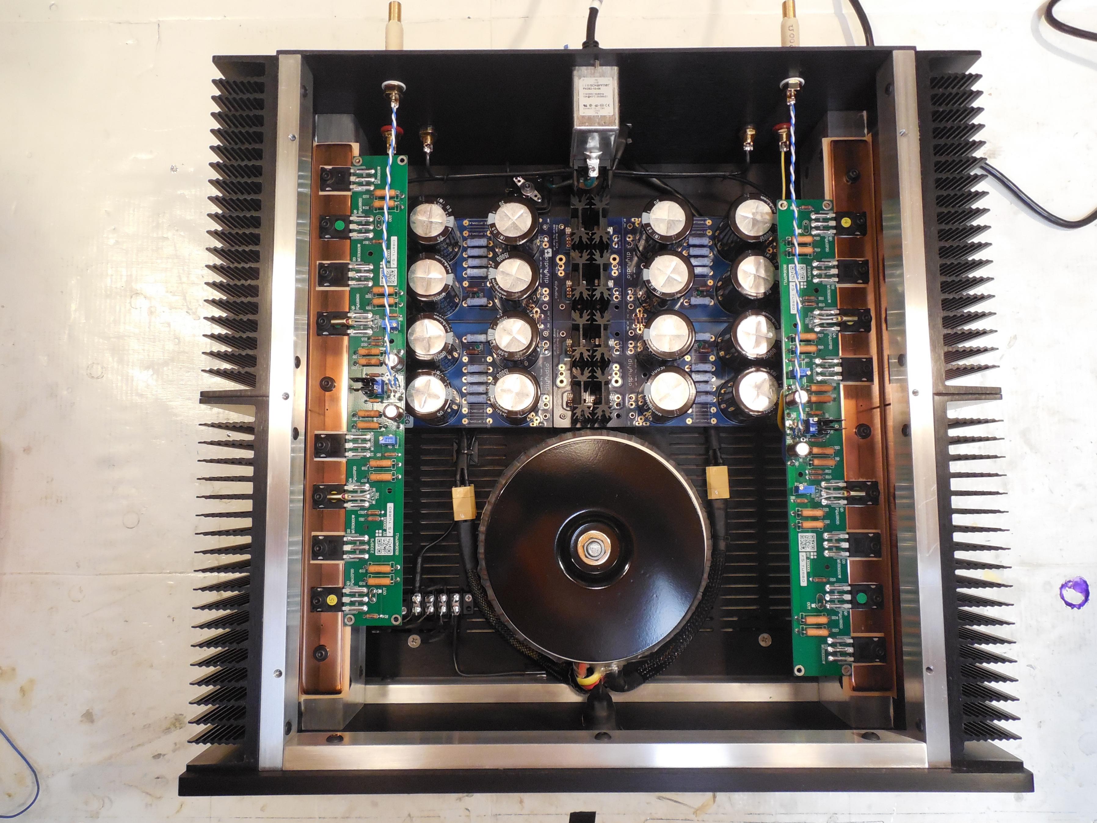

In the ground next to the toroidal transformer you can see an Arduino Nano, where the two 1-Wire temperature sensors (18ds20) and the Display go. The temperature sensors can be seen on the second picture from above.
The Display has an RGB backlight - when the amplifier is cold, the display is blue, when it is at the right temperature, the display is red.
The trigger input is handled by the Arduino as well I guess ?
