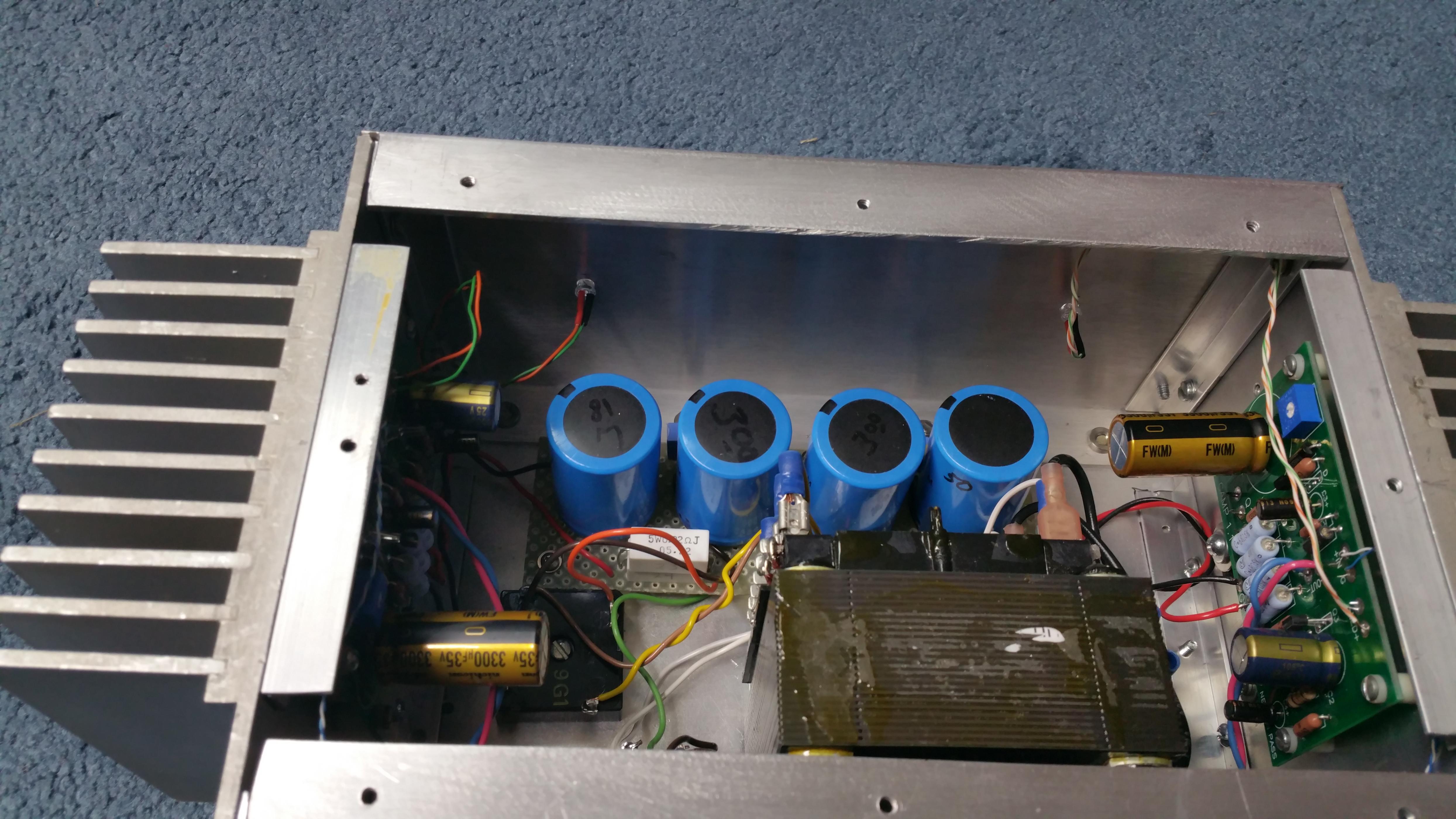

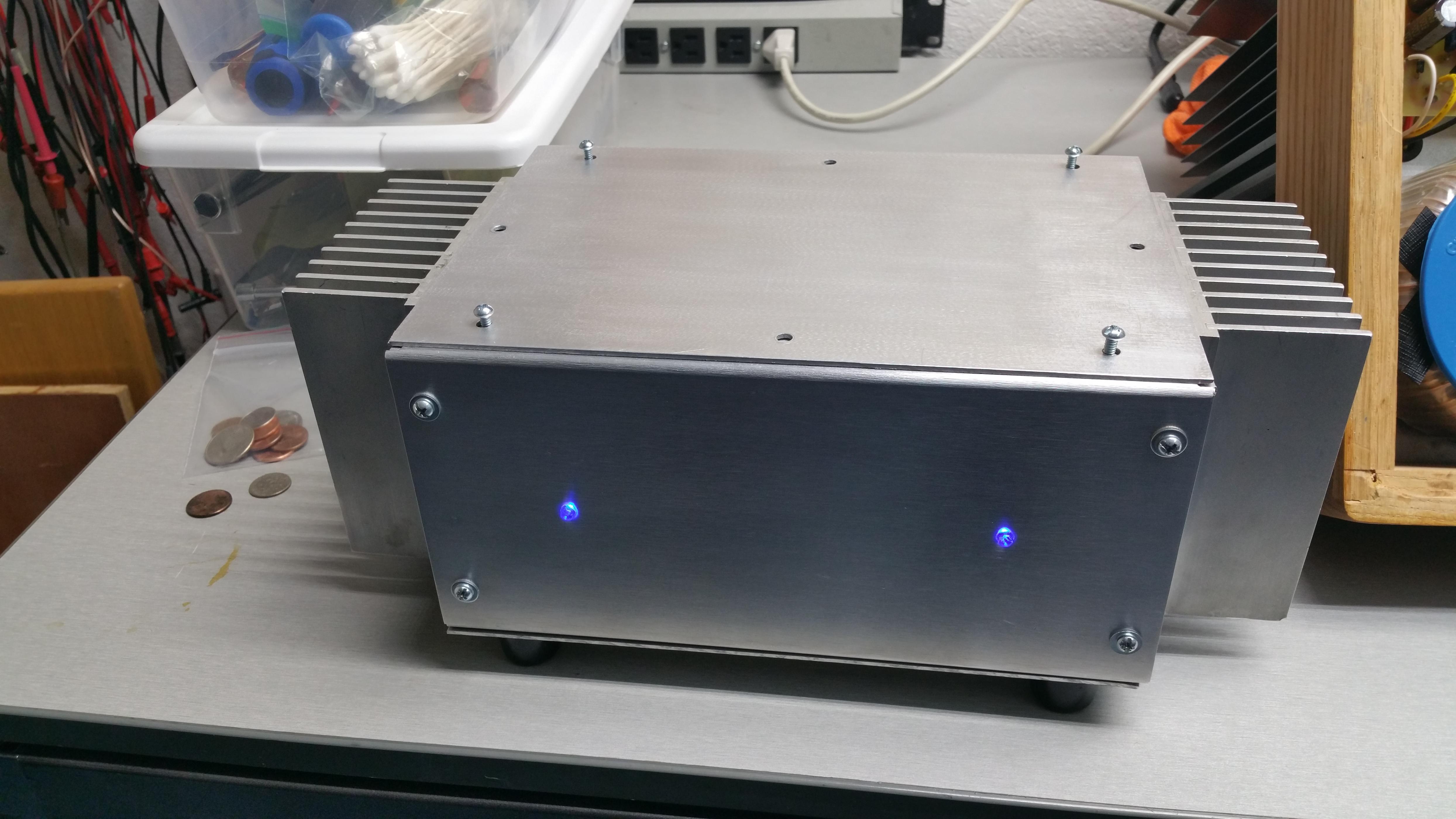

Beer holder . Very good, I will use that. The heatsinks are running comfortably warm. I am running 20 volts on the rails so heat dissipation is not an issue yet. I do plan on replacing the power transformer with an Antek AN-5218 500VA dual 18 volt. I might need to improved flow. The amp sounds really good, I might just leave it alone. You will see I went external on the speaker relays. I could not bring my self to running the speaker wire from the right amp board to the left side and back again to the right speaker binding posts. I also put the speaker hot lead on the common lead of the relay and the N.C. lead to ground, along with the N.O. going to the Red speaker post. In the event of a failure the relay should take the hit not the speaker. The speaker protector board makes the Alph J totally thump-less.

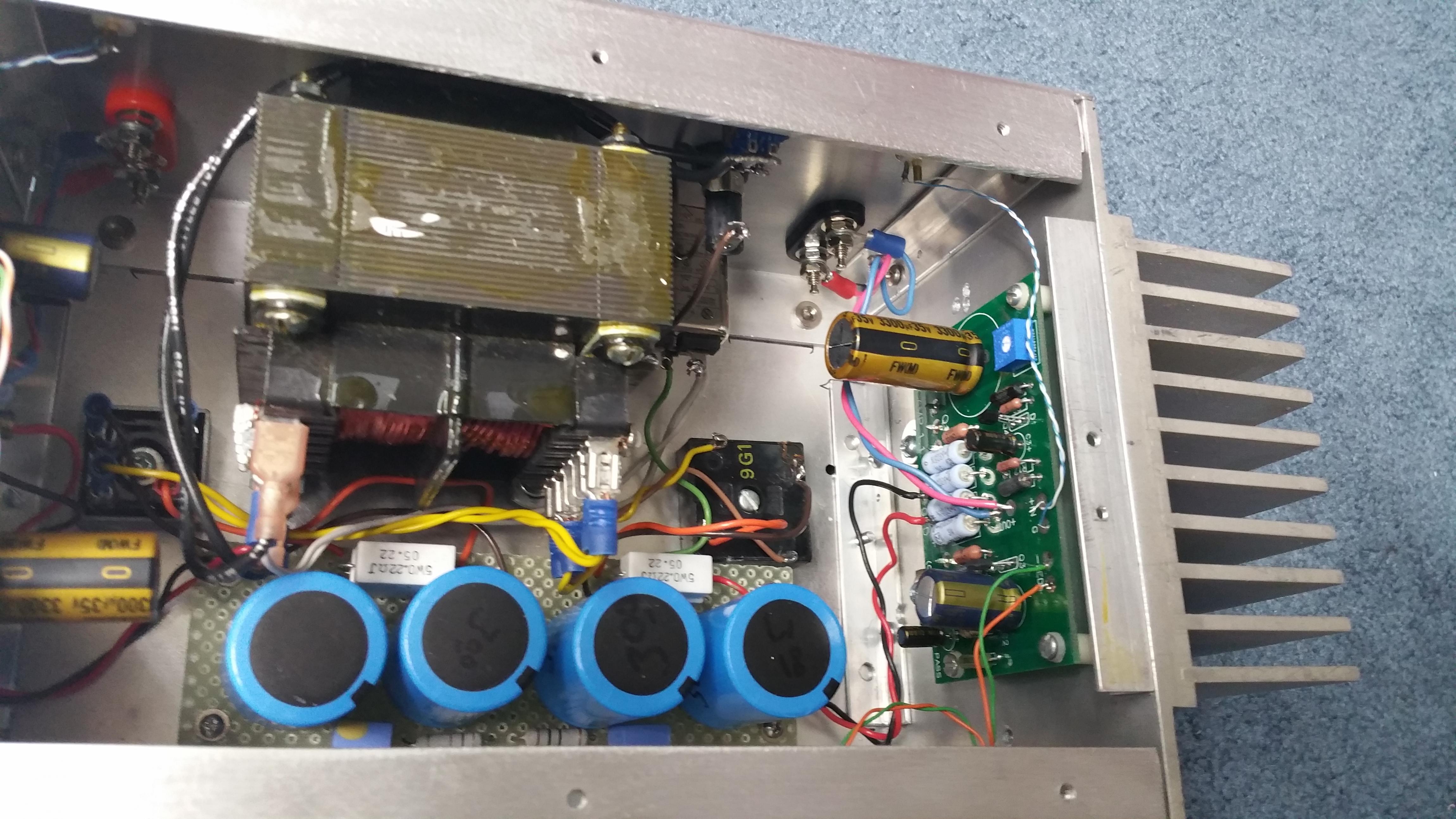

F5 Mono Block, a bit over the top. My power transformer is a dual 20 volt , so I used a capactince multiplier to drop the excess voltage. . Stone dead quiet.
