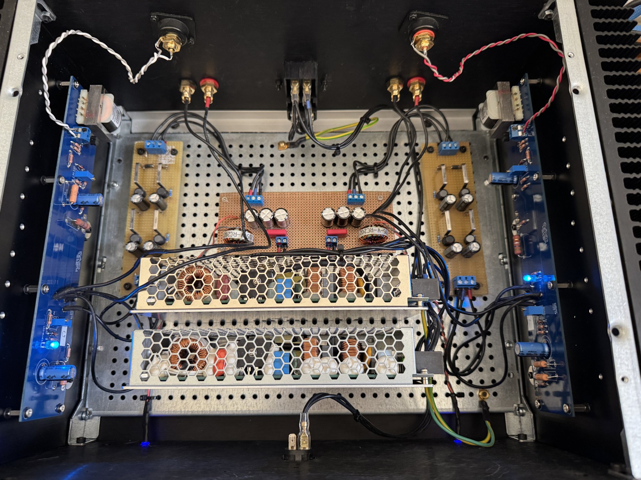

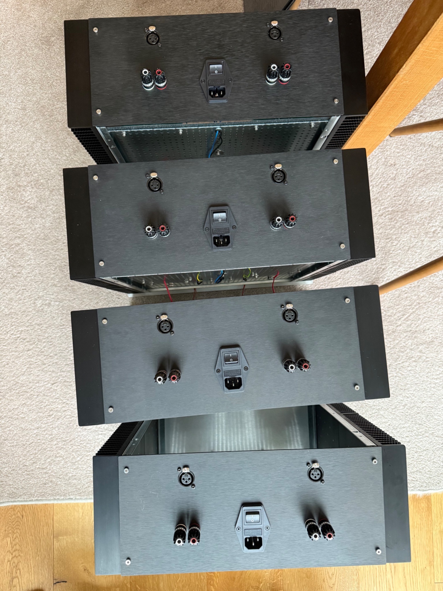

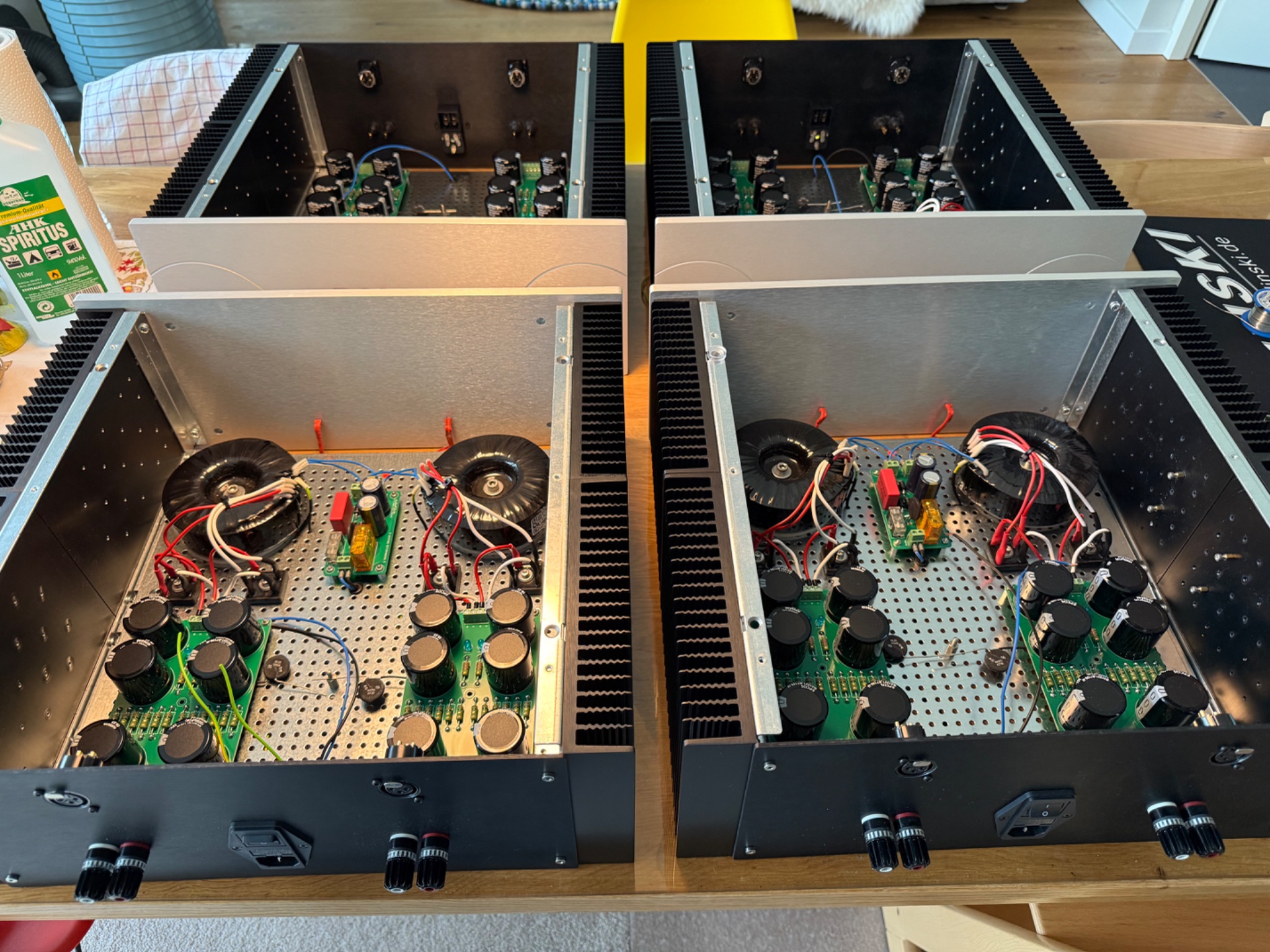

New build, repurposed case.
Finished my F6. Still some tidying to be done.
Many thanks to Nelson Pass and 6L6 and all the other forum members posting here.
PSU is:
  • 2 Meanwells, 24V, each 201 Watts, switching at 70kHz
  • 1 CLC Filter, dual rail, matching the 70 kHz (49 kHz)
  • 4 PO89Z arranged for dual rail
Sounds very good without any hum.
Not sure whether it is better than the F5 (v3) I have built before in the same case.

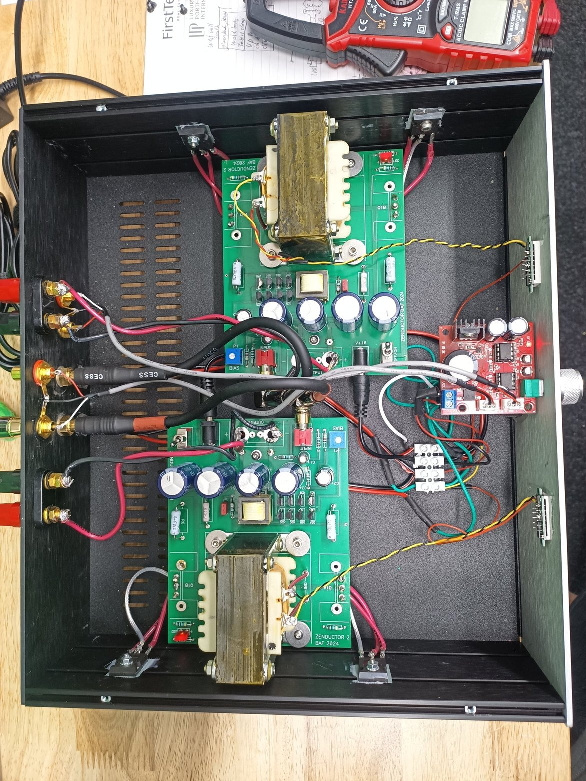

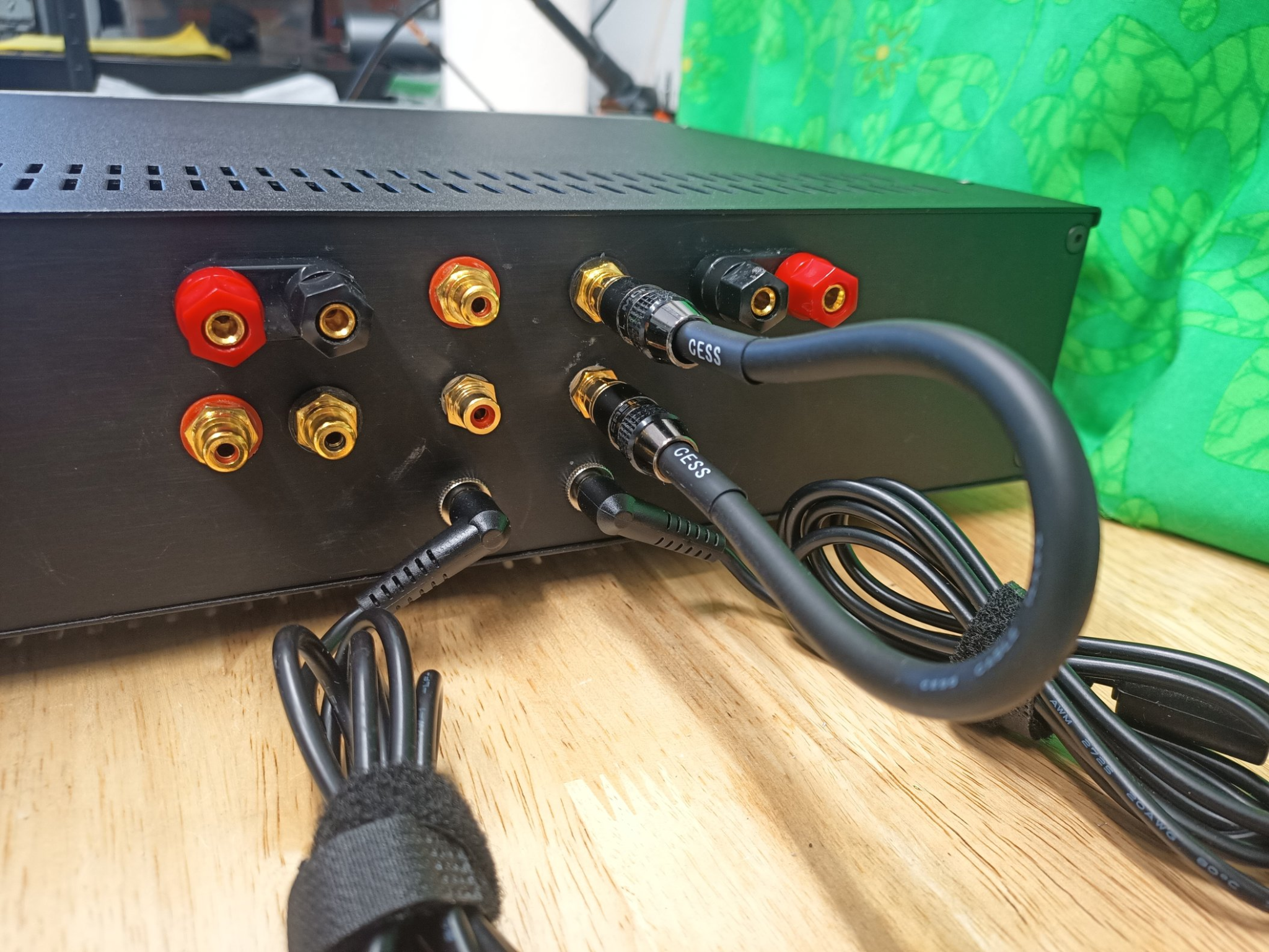

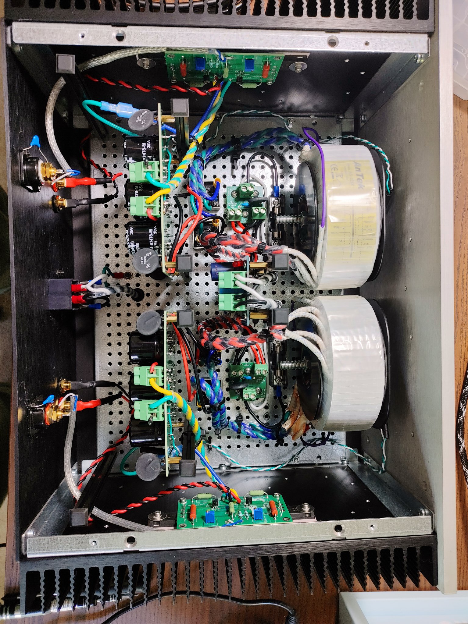

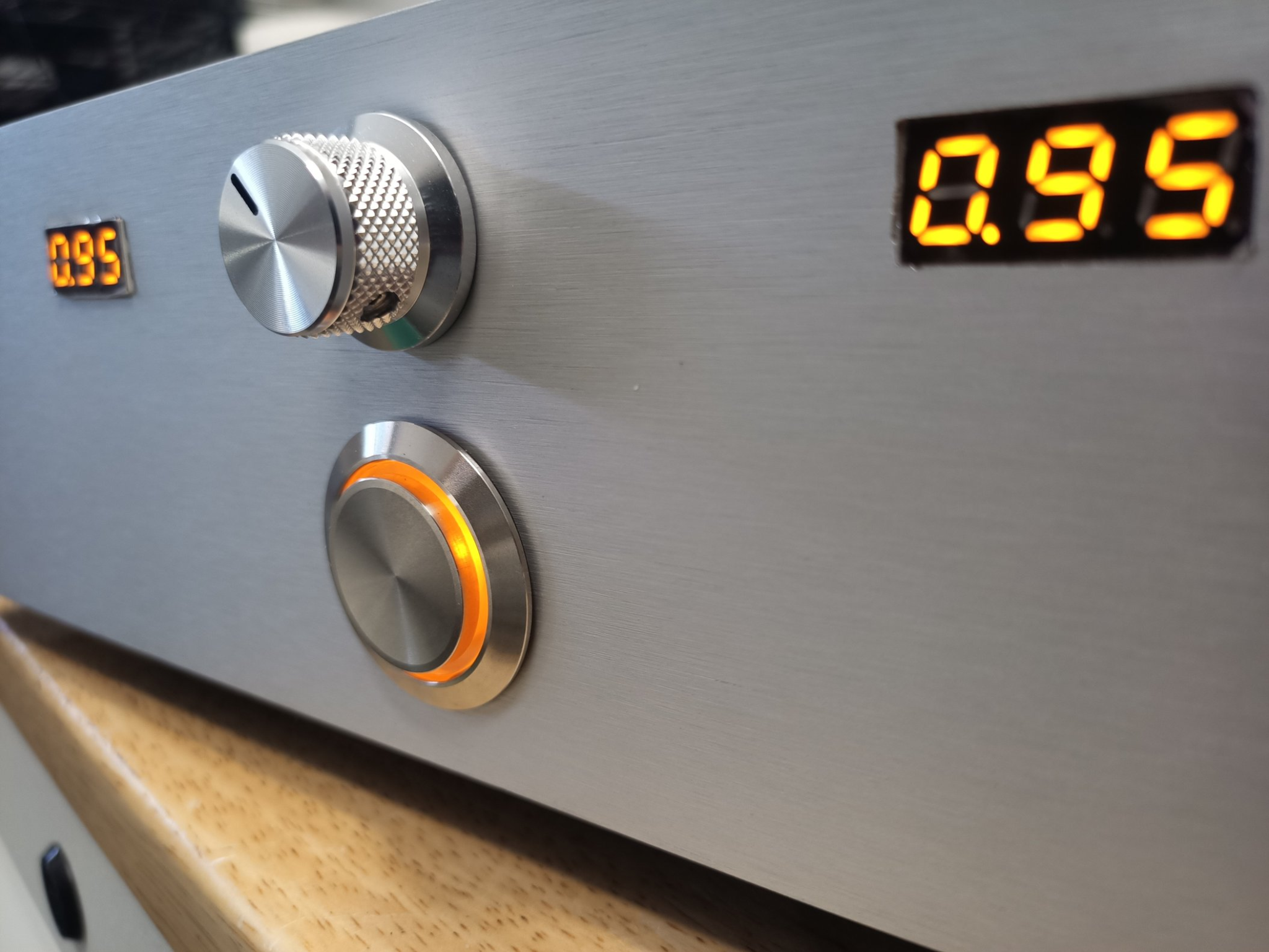

I don't think I've posted this here yet: I cleaned up the DC wiring a bit on my Zenductor 2 (Burning Amp 2024) in a Modushop Galaxy 2U chassis. I divided up the auxiliary loads: the bias DVMs are now properly powered from their respective amplifier DC supply, and the preamp and the push-button LED (few 10 mA each) are now also split up. All hooked up via an original Lüsterklemme from the old country (or maybe IKEA also uses them here?).

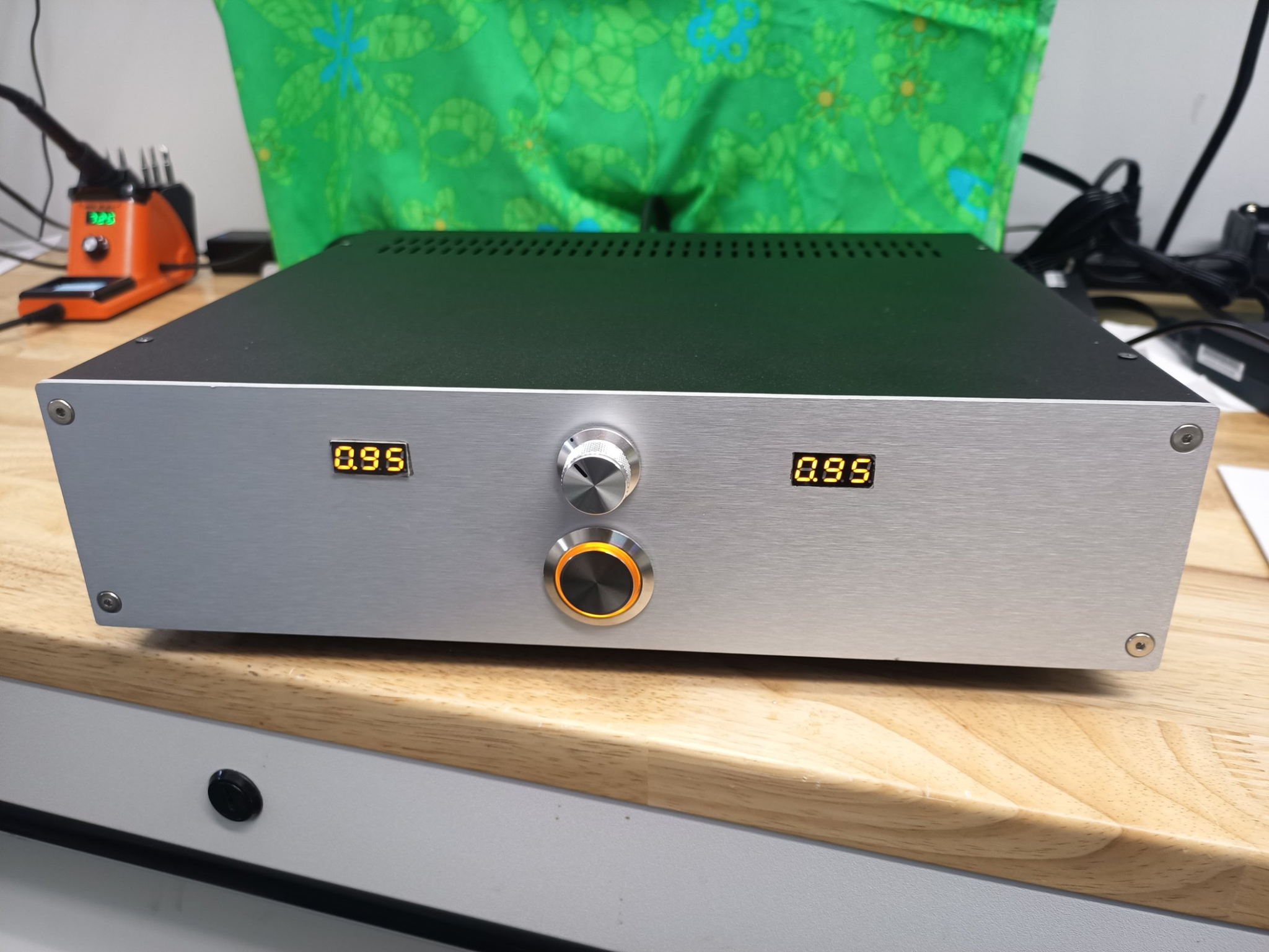

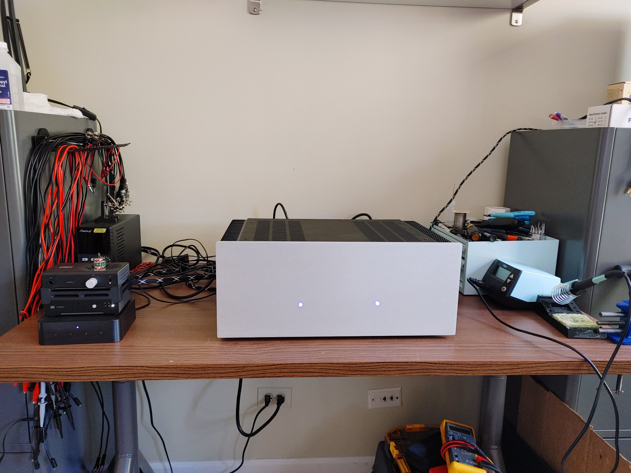

I just buttoned up my first build and thought I would share some pics. I built an Elekit tube amp about two months ago and that went fairly well (it sounds great, just FYI) but it was kind of like doing a paint-by-numbers project. I decided to try something a little bit more free-form for my second build. I have always wanted a good class A solid state amp and the F5M looked like a good one to try. I ended up building it in a 4U/300mm case that I got from Modushop and decided to make a dual-mono power supply for it, which is probably overkill but was fun to figure out. It all works fine and I've been burning it in all week and keeping an eye on things. I ended up with a bit over 1.2 amps of bias current and about 2mv of DC on each speaker output. I also put in the DIY store soft start board (again, probably overkill) and to fit everything in I had to go vertical and mount the PSU boards and the soft start board using maker beam for supports, which works great btw. I would like to thank everyone who has posted on these forums - I picked up a lot of info on how to do this by reading your posts. I haven't really built any circuity like this since the 90's but my wife said that before I can retire I need to find a hobby so I guess this is it! The end result sounds fantastic in my opinion so a big thanks to Mr. Pass for the design and his generosity and a big thanks to all of you for your excellent community.

Thanks guys! @Gruesome the input wiring is a twisted pair of 24awg solid core wire inside of some wire mesh that is inside of some clear 4:1 heat shrink tubing. I didn't have any suitable shielded two-conductor cabling on hand so I just made some using stuff that I did have on hand. I make my own speaker cables, interconnects, power cords, etc. so I have lots of extra stuff to make cables lying around. The clear 4:1 heat shrink idea I got from @birdbox and it works great for keeping twisted pairs actually twisted. The wire mesh is this stuff: https://www.amazon.com/dp/B01BIBQESG?ref=ppx_yo2ov_dt_b_fed_asin_title&th=1.
As far as the maker beam stuff goes @Jacruzer787 yeah, it worked out pretty well here - I will no doubt be using in in future builds 🙂
Reactions: Gruesome
Thanks! Wholly homemade cable, that's interesting! I have used tinned copper mesh sleeve material before (as heavy duty ground connection between racks in a lab), but I didn't know it came in 1/4" diameter. (The label/title says 1/4", but the description says 0.16"; is 0.25" the maximum diameter when you push it all the way together to minimum length?) Ditto for the clear heat shrink tubing. I assume you use it unshrunk for this application? Very neat.

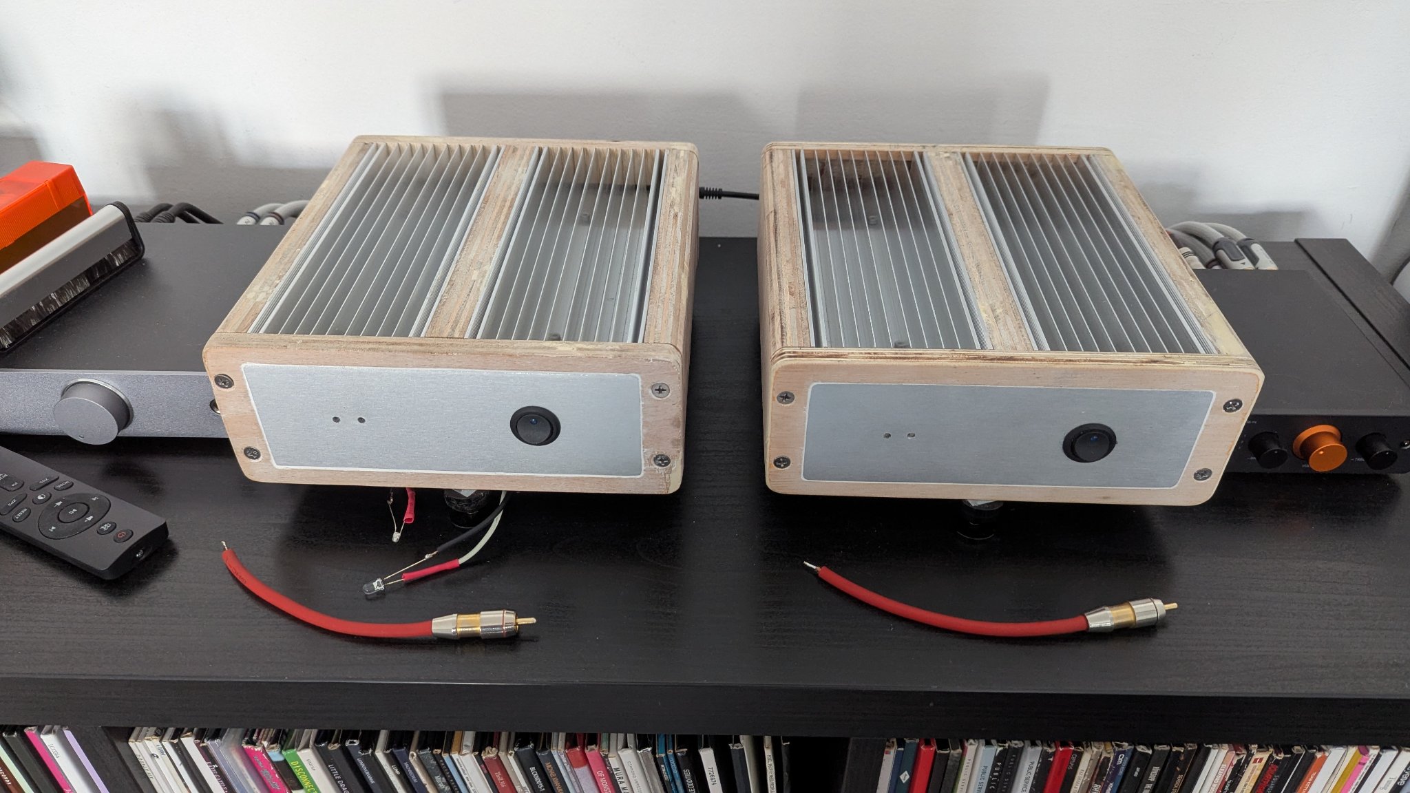

Some lovely looking boxes on here.

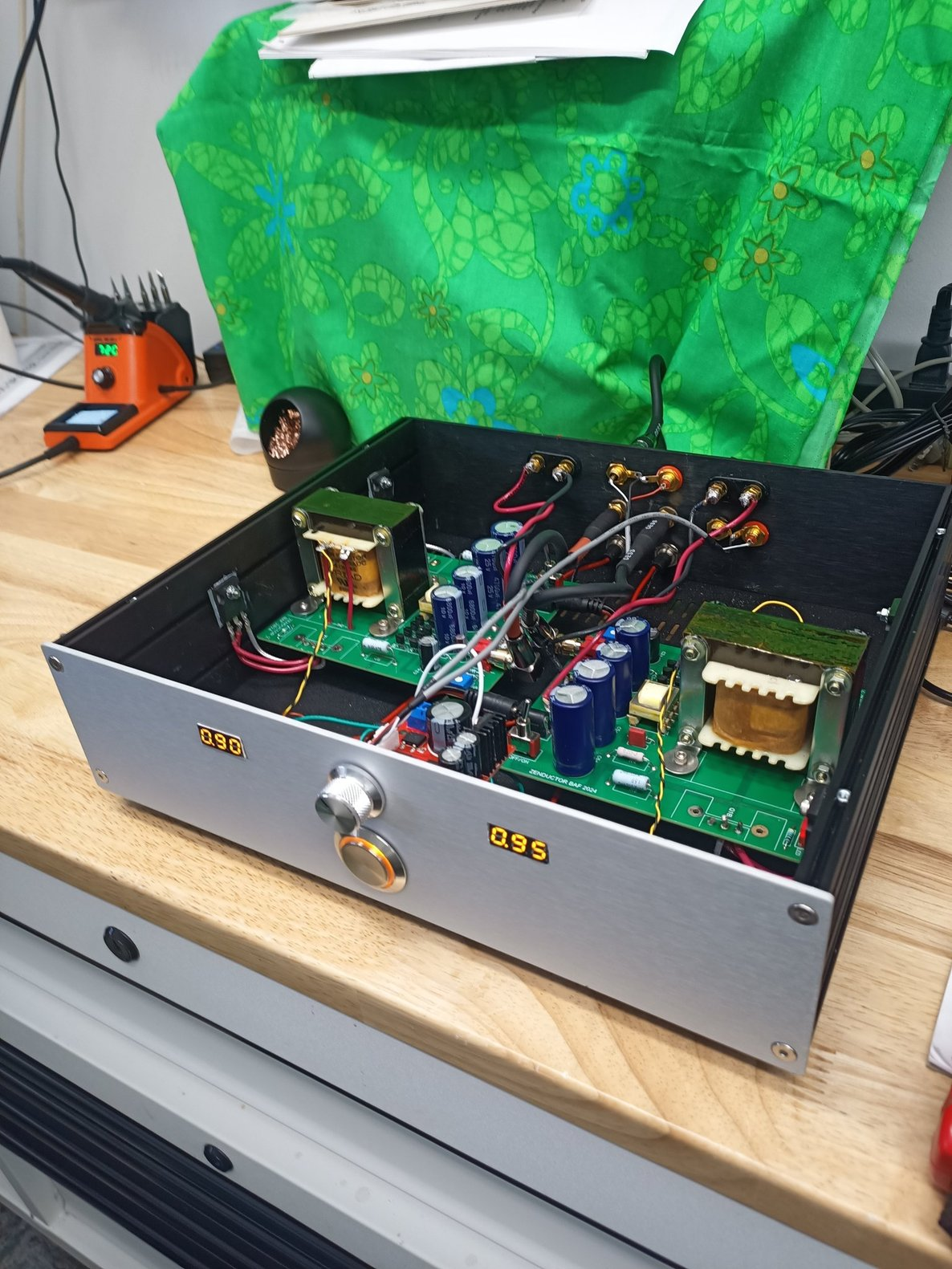

Mine are more "rustic" than some, but they do the job. I may have another go and make them slightly bigger as I think mine are too small. I'm going to add fans to the bottom panel to draw cool air in as they get very hot. I know they do run hot, but even so..
Please excuse the leds hanging out the one, I'm waiting for the postie to deliver a batch of new blue ones.
