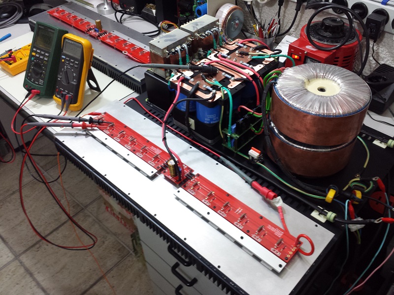

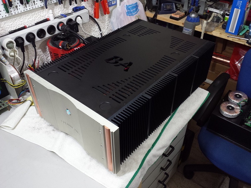

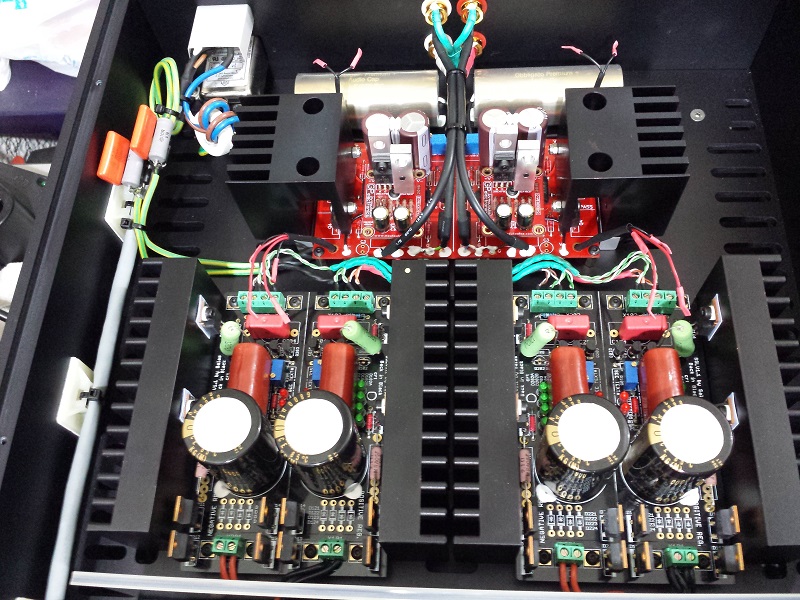

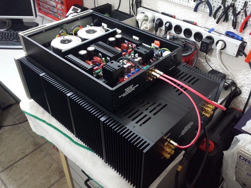

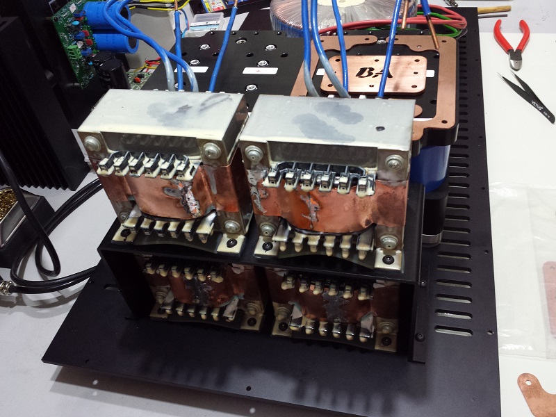

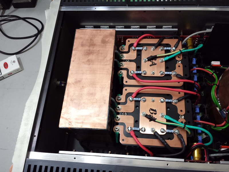

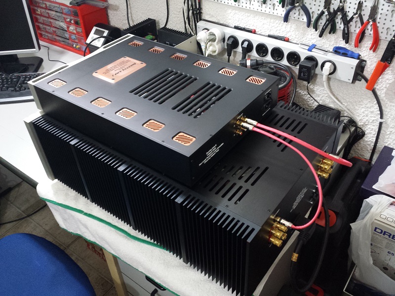

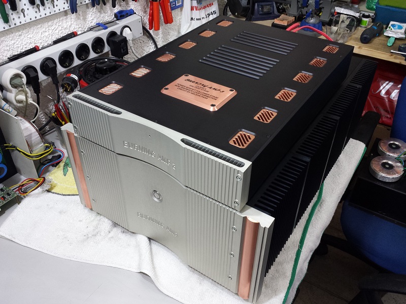

Yet another BA-3.
Nelson thanks !!!!!! for giving this excellent Amp to the DIY community.
Specs:
Dual mono implementation.
Two cases one for the front End (BA-3 gain stage) and one for the complimentary final stage.
Front End
BA-3 in cascode mode powered by Salas Shunt Regs at 55 V.
Final Stage
CLC Power supply.
Transformer 1500 VA - 328,000μf - per channel at 55 Volts.
12 Mosfets per channel.
Bias 300mA per Mosfet.
Amp weight 78 kg.
Dims: 430 x 200 x 700 mm.
Specs:
Front End
Final Stage
CLC Power supply.
Amp weight 78 kg.

What must I say, this is unbeatable, Mega, Giga beautiful 😱😱😱
Well done!
78kg sick.....
Walter
Well done!
78kg sick.....
Walter
WOW!!! That's one BIIIGG amp!! No need for room heaters in the winter!!
How did you implement the cascode on the front end?
What is the estimated power output? (too lazy to do the math 😀 )
What speakers will you use it with?
