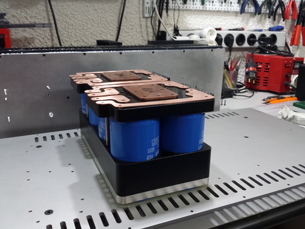

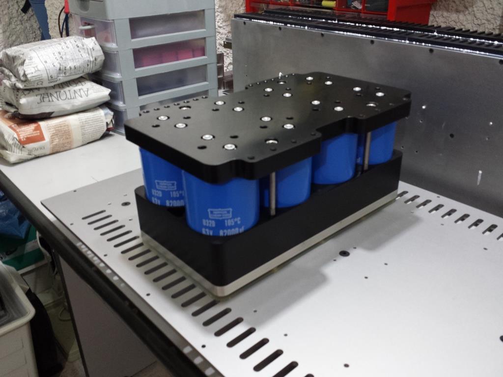

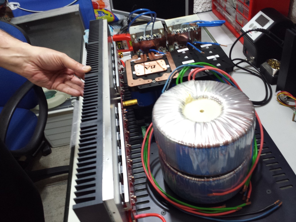

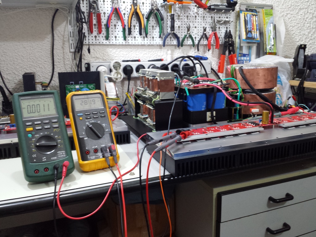

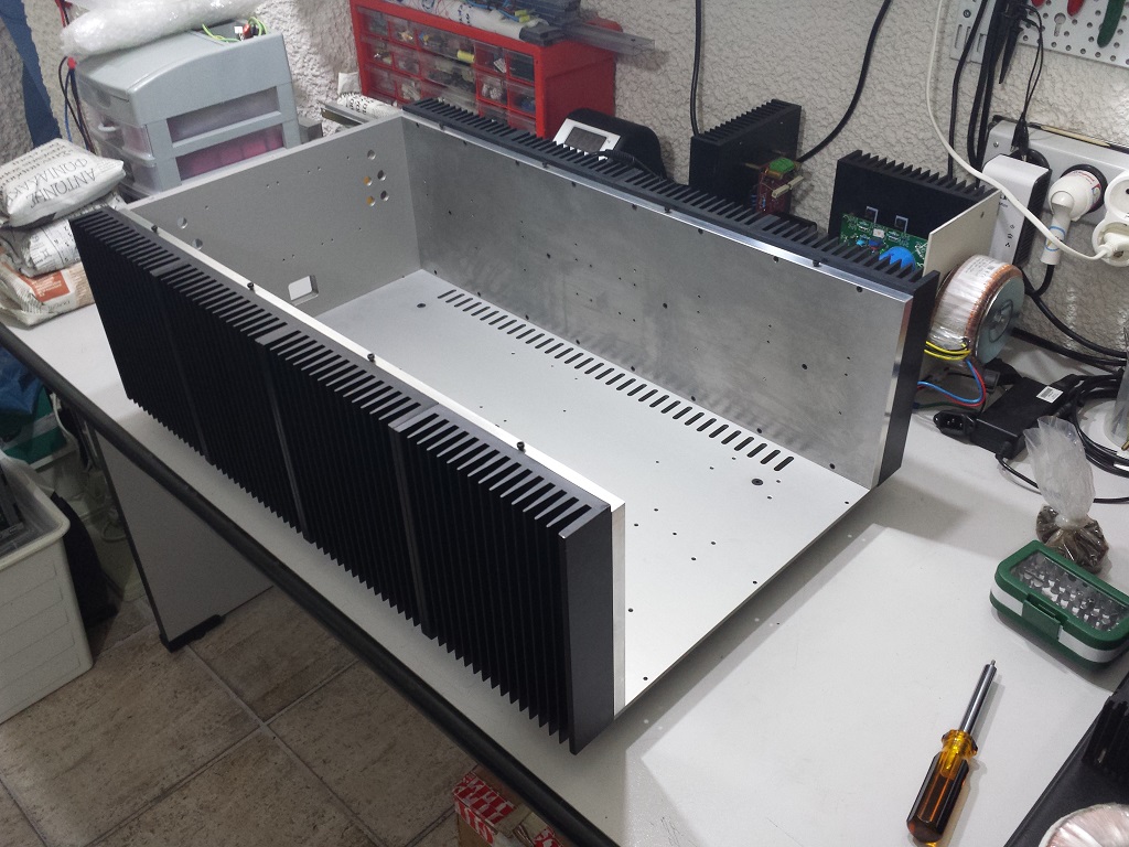

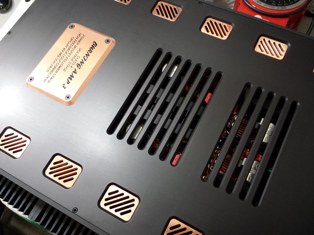

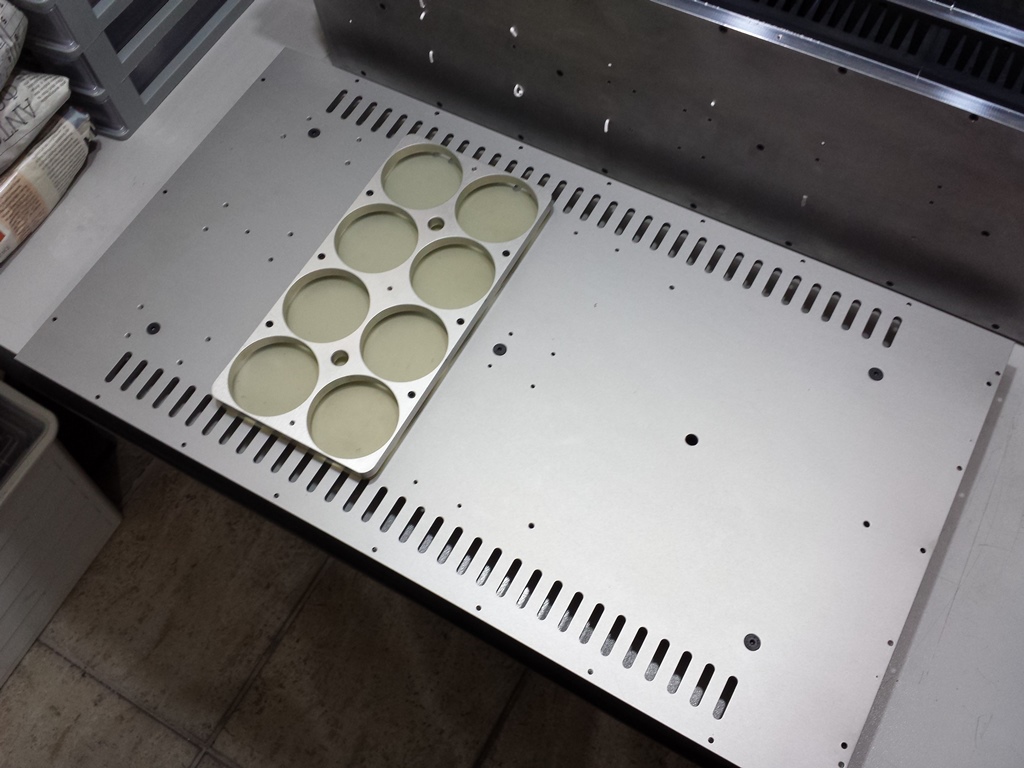

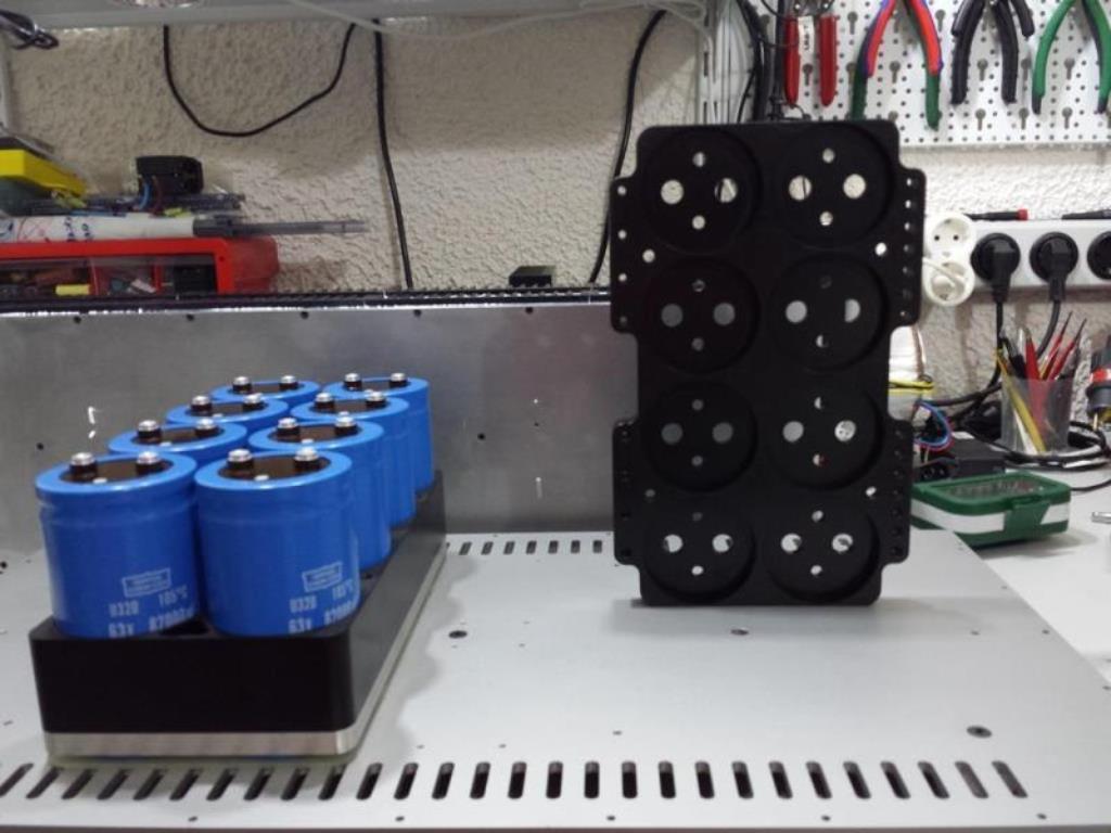

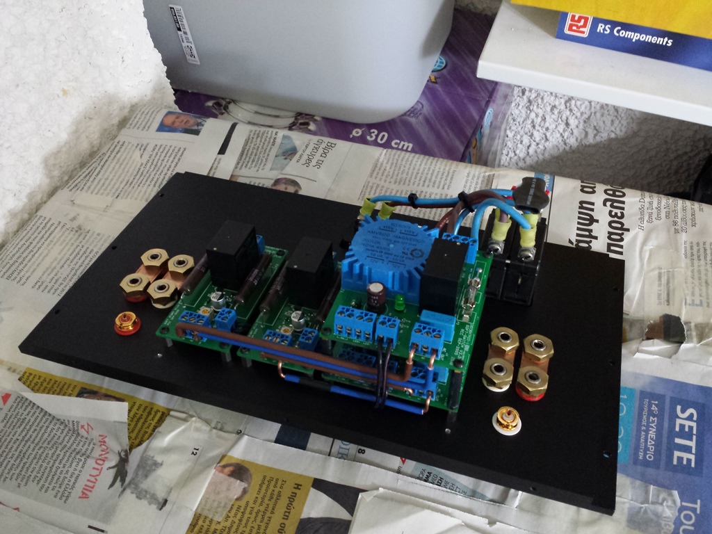

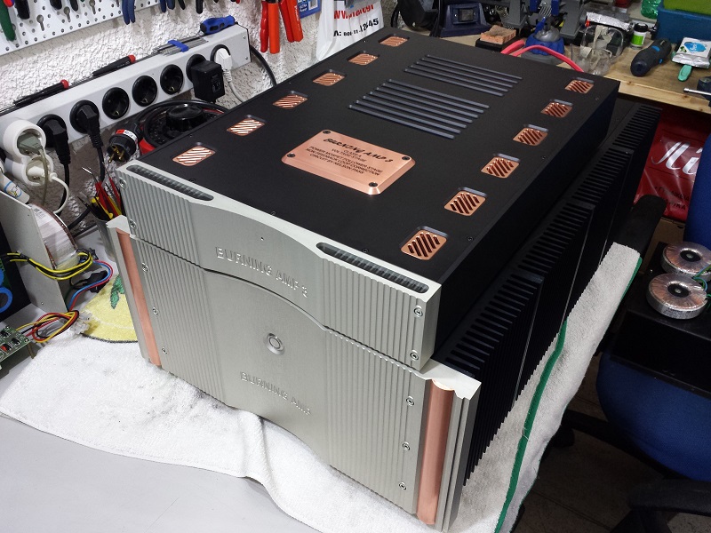

Nelson thanks !!!!!! for giving this excellent Amp to the DIY community.
Specs:
Dual mono implementation.
Two cases one for the front End (BA-3 gain stage) and one for the complimentary final stage.
Front End
BA-3 in cascode mode powered by Salas Shunt Regs at 55 V.
Final Stage
CLC Power supply.
Transformer 1500 VA - 328,000μf - per channel at 55 Volts.
12 Mosfets per channel.
Bias 300mA per Mosfet.
Amp weight 78 kg.
Dims: 430 x 200 x 700 mm.

That is insane. Where is the output cap on the ba3 front end? Is that a servo replacing the cap?
That is a magnificent amplifier build. That front panel treatment carried over to the smaller front end case really makes it come together. I hope you enjoy listening to this build.
The two silver cylinders on the back of the ba3 board are the output capacitors. Obligato Gold if I can read correctly.
That is Correct
WOW!!! That's one BIIIGG amp!! No need for room heaters in the winter!!
How did you implement the cascode on the front end?
Copy paste from F5T.
What is the estimated power output? (too lazy to do the math 😀 )
A little over 100W.
What speakers will you use it with?
Local Brand (Audio Spectrum Hermes).
Do you have your own CNC machine?
You can say that i have unlimited access to one.
I see them now. The small boards above the front end boards where the caps usually are must be the bias boards. I was hoping for servo. But only because I am interested in servo...it's awesome though.
In this kind of builds you don't ask how much it costs, etc... it simply doesn't matter.
