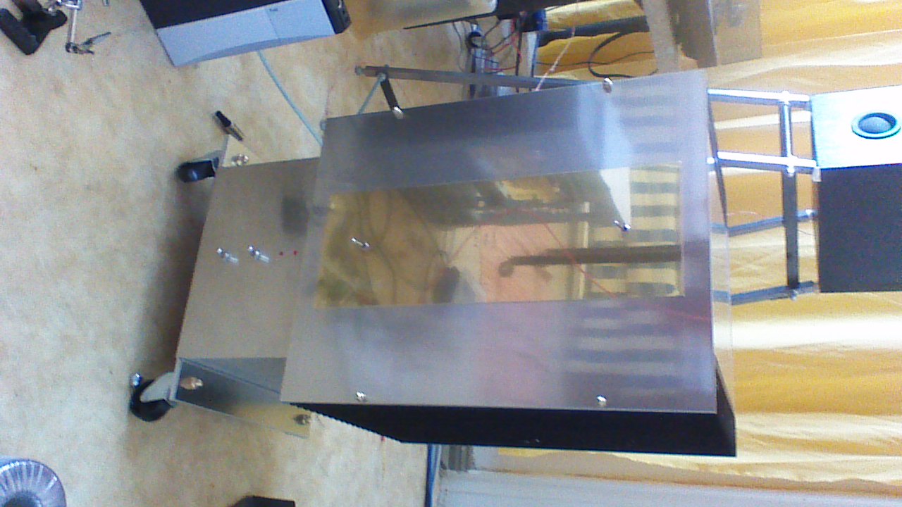

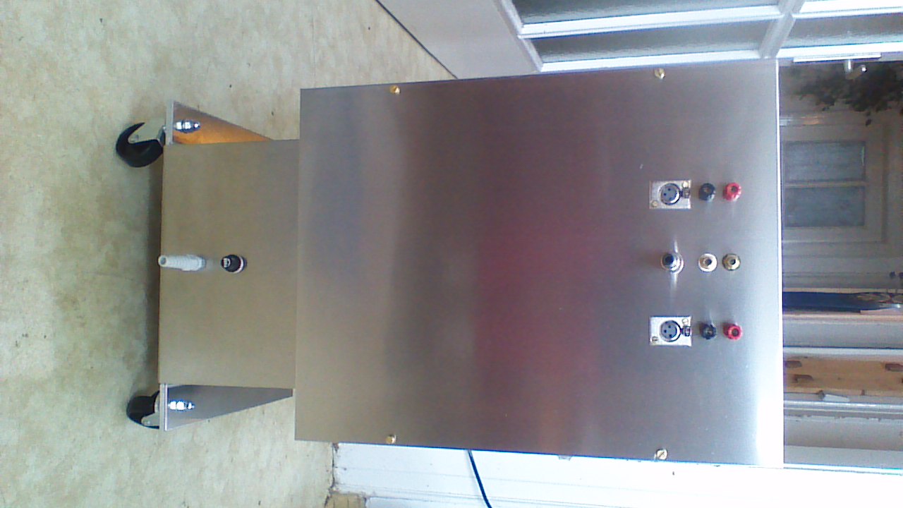

A simple se, stereo, one stage, 4 parallel mosfets (circuit-regarded), active dc-current, switchable active ac-current. 2 x 200 va dissipation. Psu: c - l,r/r - c - l,r/r - c (stage 1 resistance-regarded, stage 2 and 3 circuit-regarded; l,r/r-switchable). 66 x 35 x 45 cm. The most would call zen + ccs, switchable aleph or so.
BUT: sounds not as clean as the same with not-paralleled mosfets - sounds more like a brown bear than a black panther,-) Not as fast, not as clean, but great, "power", drive, a repleted oil-painting.-)

have you input/driving buffer?
when paralleled , mosfets can be nasty , regarding driving demand

Recycled Heat Sinks From Industrial inverters?
Size ?
Bias Current?
The most do confound "driving demand", by sep. buffer ex., and "sound" or "good" "performance". Most they do need "better", much "better", cleaner! speakers and sources and more ... What does he talking about;-?
Recycled.
For a friend.
45 x 30 x 5 cm, 21 rips.
64 V; 4 x 0,75 A per ch.
Recycled.
For a friend.

A se-mosfet-amp, one stage, with an "open" input - the psu is very good - does not need a further buffer, driver or more (the four paralleled mosfets, their minimal different characters, together, smear a little bit). The most DACs drive mosfets. To regard capacities and more is not necessary. Most important is the less of noisy, distorting (not the common looking-measured) components. If anybody uses buffers - in my mind - he has not much experiences in speakers, sources and arrangements or has unclean ears or "do want a chic pre-amp" or is not listening, not a listener,-) In my mind. If you listen records, build any 1-, 2-step RIAA. It will drive. Result is a 2- or 3-step-amplification - If that does not sound very very good, clean! replace the speakers - do not use any/a multiway, no chance,-!

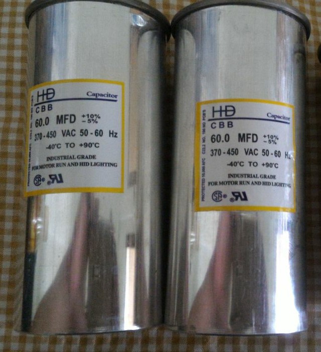

I have been searching appropriate motor run cap on net, but the price difference is so diverse, from $5 to $50, and the brand names are all unfamiliar to me (except Dayton, but I'm afraid Dayton may sell $5 cap for $30 just putting Dayton name on it).
How you guys find the right one?

I'd try ASC cap. Supposed to be pretty good. Only about $15.
Saw used ones from various appliances in two, and reach for the magnifiying glass (kitchen scale, calipers).

Still waiting my package for motor run cap 60uF, only paid around $2.5 each 😱
