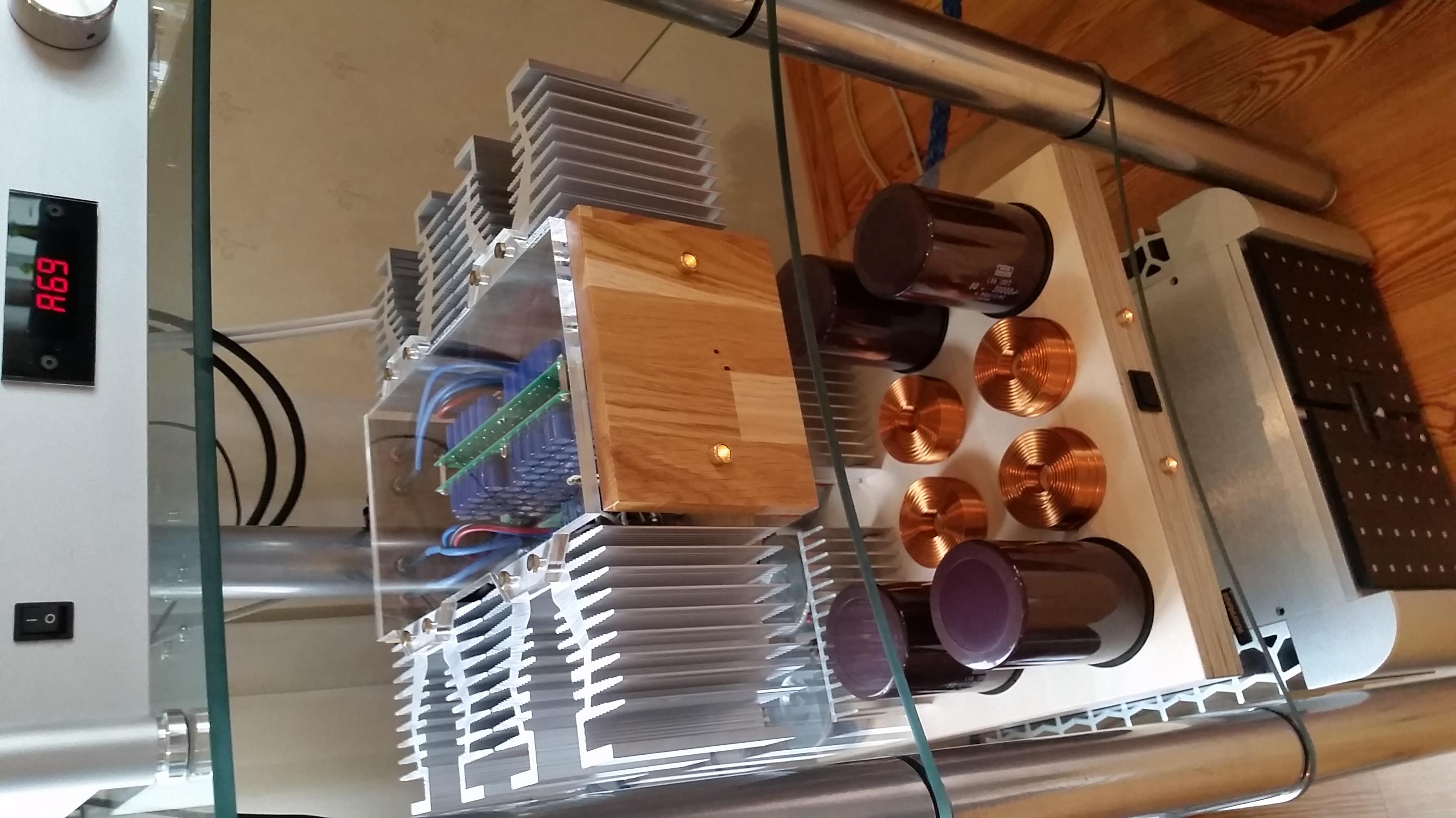

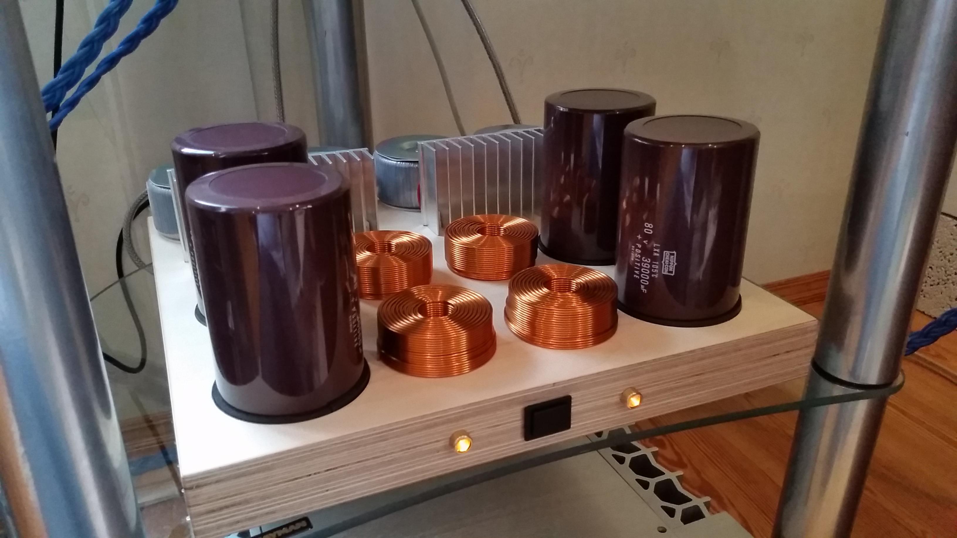

Thought I would share my latest build with you.
It was completed yesterday even if I started already last year 🙂
I sent an E-mail to Elna in Japan telling them that our daughter is named after them and I also mentioned I would be very happy about some samples, as we do not have a Elna distributor in Finland.
They did not even reply, but their competitor felt they could contribute to my build (for other reasons though, it is good we did not name our daughter Nathalie Nippon Chemicon).
Both the amp and Nathalie Elna are very happy with the NCC LXA caps.
They have excellent ESR and supposedly long life at 105deg.C.
I heard the price too and they were not overpriced.
As you may see their voltage rating is a bit higher than necessary 🙂
Amp is an "Aleph Monster" with big IXYS FETs and 3.1A bias, voltage is a bit above 30V.
Sound is good. It is close to Zen and other great amps, but can drive speakers the Zen cannot. Will do some measurements when my workbench has enough space 😉

amp deserves separate thread , with plenty of pics
Take care about safety hope your child don't play with metalic objects
or his small fingers around visible transformers , diodes bridges and choke wires !!
