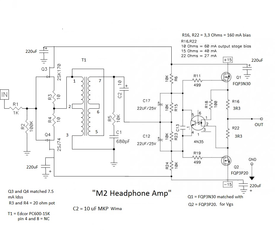

Why would you need C2 ?
The Tx output shouldn't have any DC ?
Patrick
You are right, working for months on it and it never appeared in my mind, funny... will try it later without C2.
First I want to experiment more with the crossfeed values. The 18k and 27 K Ohm resistors. I find the crossfeed a bit to subtle, so I think I want to lower the 27k resistors resistors to have more impact.

One more point if I may.
Your Tx is designed for 15k load (AC) if I am not wrong, but you are using it to drive the 5k input impedance of your follower.
Maybe you should consider changing R6, 24 to 30k.
And then R15,23 wants to be >18k for those Fairchild FETs.
You might also want a trimmer across R15,23 for DC offset adjust, depending on how perfect your Vgs matching is at temperature.
Patrick

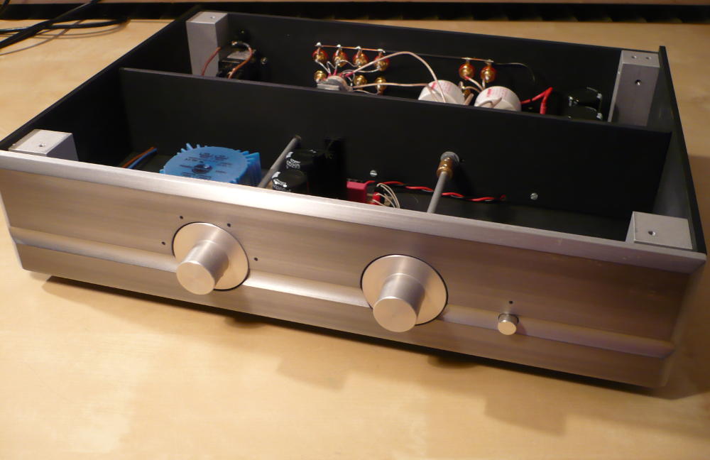

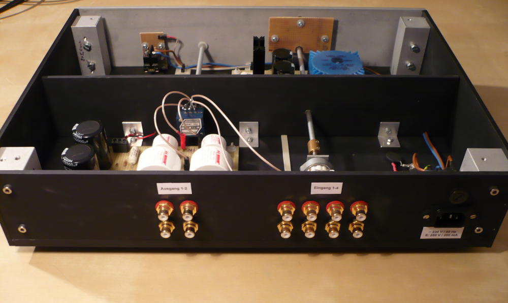

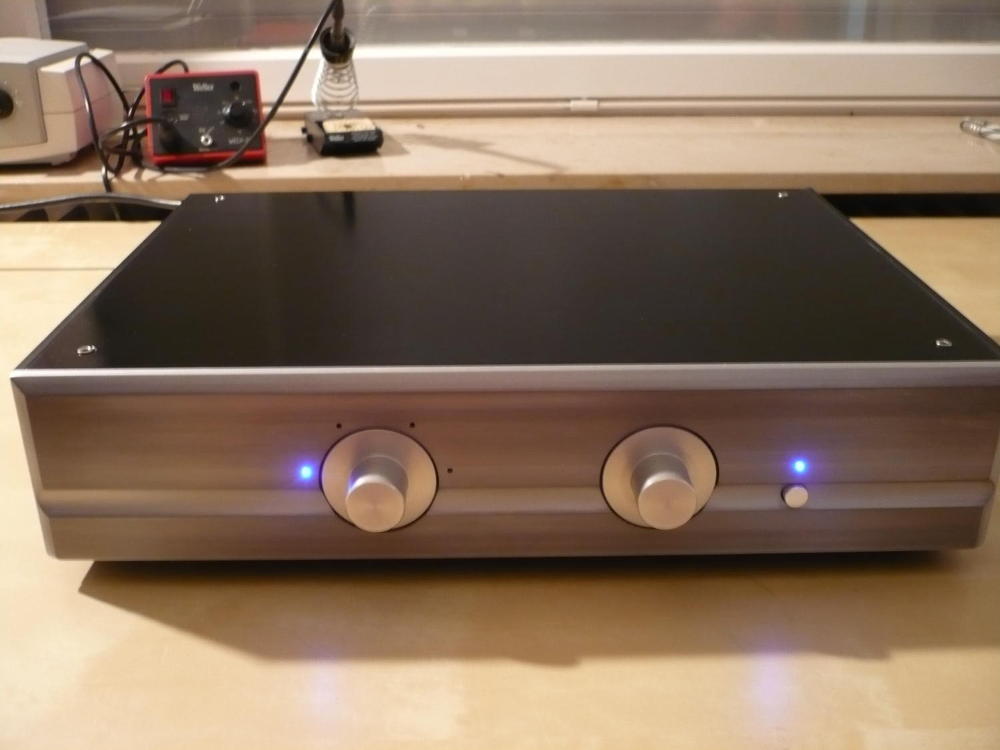

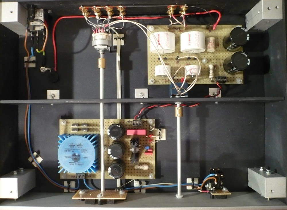

Hello,
I would like to show you my first diy project that i started three years ago. After some work it now works fine and i like the sound very much. The pcbs are point to point wired, the chassis is completely selfmade, but not selfdesigned... I would never do this metal-work again (too expencive and takes too much time). As soon as my aleph-x and my pumpkin are working properly, i will post a few more pictures.
Greetings, Michael

The schematics in #3611 suggested different values for the MOSFET source resistors for different bias currents.
A quick hand calculation shows that :
at 3.3R 160mA bias, output impedance ~ 2.8R
at 10R 60mA bias, output impedance ~ 8R
at 15R 40mA bias, output impedance ~ 13R
at 22R 27mA bias, output impedance ~ 19R
And of course the output impedance is not totally linear.
Since this is a ZGF amp, there is no NFB to reduce the intrinsic output impedance further.
If you have a low impedance headphone (e.g. 50R), you might well wish to stick to 160mA bias at least.
Patrick
Patrick
You certainly may, much appreciated.
I understand what you mean, I'm loading the Edcor trafo too much with the 5K impedance of the output stage. And it might fall off too quickly at high frequencies that way.
I looked at the official M2 schematics and Nelson uses 47k on that position.
Hate to unplug the output boards from the chassis, but maybe if I cut one side of the 10K resistor, I can solder an additional 22K in the circuit resulting in 32Kohm.
In this latest version I use best matched 2SK2013/2Sj313 Toshibas from NicMac.
The FQP's are in the prototype in the first picture, they do indeed have much higher Vgs needed, around 5.7 V instead of around 2.5 - 3 volts for the Toshibas.
So I hope I'm good with the R15, R23 at 10K.
Thanks, Walter
Hello,
Greetings, Michael
Michael love your metal-work! So keep on doing it 🙂
I agree building a chassis is expensive, I did my Aleph J myself, but it would have been cheaper to buy one at Ebay or a Modushop 5U.
How did you do your frontplate?
Nice to hear that, walter! Well, a friend of mine has access to an cnc machine. The chassis is made of 5 and 10mm alu and quite heavy (in relation to the interior...). Most of the work was the construction and finding out the dimensioning from pictures. For my pumpkin preamp i bought an modushop case and now try to modify it. I ll post pictures, when the front plate arrives!

That is a hifi2000 galaxy 2U chassis with customized front and back panels.
Indeed!
A CNC is a must for quality work.......look at the pictures of the B1 here.
CNC from scratch.
Almost reminds me of Tiroler's work....almost, finish is not as good ...but close.
The finish was quite frustrating and not what i expected. I received the plain/shiny aluminium, went to an sandjet cabine and after that to an expencive anodisation. The result was looking great - for about 5 minutes. After putting the parts together there were fingerprints on it, tried to clean, impossible. The surface was as hard as sandpaper and impossible to be cleaned. So i airbrushed it black. Also not so easy for an hobbyist without a dustfree room. But it was my first try and the result is okay for me. Maybe i will put the labeling on if find the time. The b1 from tiroler looks really great!!
