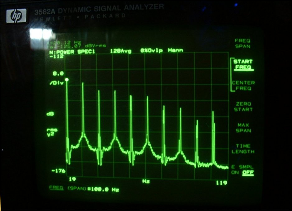

Odd 60 Hz harmonics
A quote from our site:
The spikes around the 1KHz peak are 60Hz mains frequency odd harmonics (120Hz spaced) of unknown origin. They extend into the KHz range. The origin of these mains harmonics needs further investigations. At this point, we suspect a DC imbalance in the transformer core, or a magnetic field (radiated from the toroidal mains transformer) induction effect in the amp wiring.
We did two experiments. First, we build a current loop (which is actually a bobbin of thin magnet wire), fed the signal in an AD797 opamp set for gain of 100 and connected the opamp output to the spectrum analyzer channel. We snooped around with the power amp on, at various output power levels. We were unable to detect any significant 60Hz harmonics other than the 2nd and the 3rd.
Which left the other hypothesis to be verified. We replaced the 650W toroid with two 245W (nominal) toroids having split secondaries (one for each channel, the old 650W toroid had a tap secondary) and slightly higher voltage (2x43Veff). Each amp channel is now fed through two 35A bridge rectifiers and two 50,000uF @60V Sprague electrolytics. The new toroids easily delivered 350W of power, without any significant heating due to copper or core losses), so a clean 200W into 4ohm was obtained.
This kind of setup with separate toroids and rectifying/filtering units is certainly helping in maximizing the crosstalk performance. We did not do so far any crosstalk measurements on the stereo amp but we do know from simulations that our amp could be sensitive to such, due to a relatively poor PSRR of the power ground.
The good news is that the new toroids (made in Plitron) and the new power supply setup made the strange 60Hz odd harmonics almost vanish in the noise floor, at -140dB. Therefore, I think the problem with the tapped toroid was indeed an DC imbalance in the core, perhaps due to slightly asymetrical windings. The core non-linearities helped generating the harmonics, while these harmonics (attenuated by the PSRR) entered the amp, most likely through the power ground connection.
The odd harmonics were originally at around -120dB, so that was not really a tough performance issue. However, we think this is a mechanism that should be taken into account when building amps under 1ppm THD. The quality of the power transformer may impact the performance is unexpected ways. Coincidentally, this would also address Bob's concerns posted here: http://www.diyaudio.com/forums/showthread.php?postid=1330879#post1330879
We will update our web site ASAP.

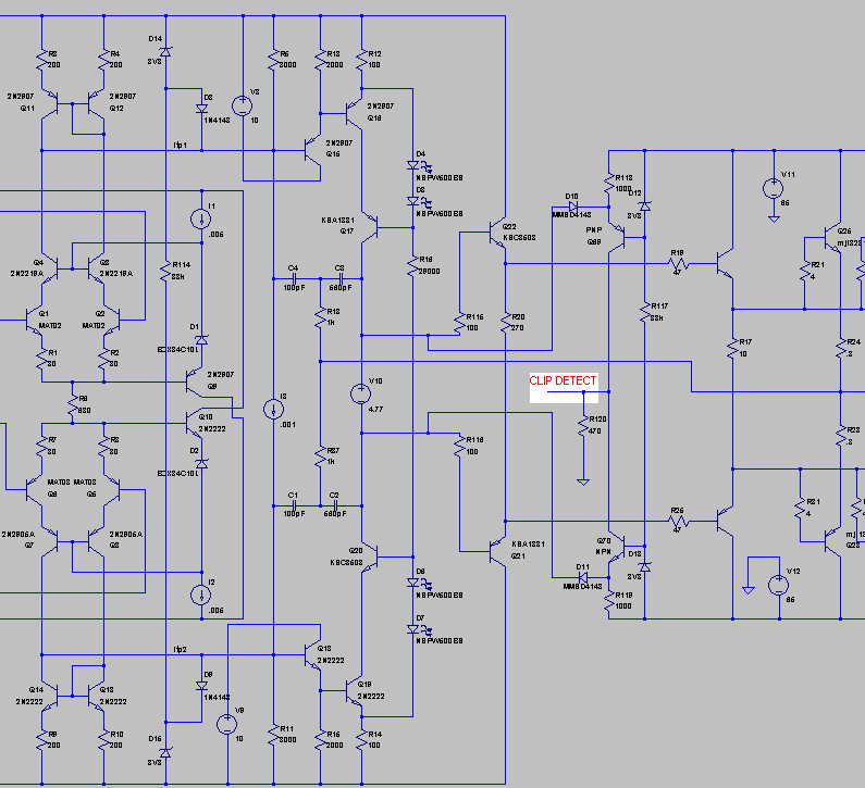

Sorry, didn't get around to it last night.
Here is a higher res jpeg. Voltage clamping on the VAS base and collector. Excess vas current is diverted to ground via a 470 ohm resistor, giving a clipping detection output which will trigger a monostable to flash a front panel LED.
Glen

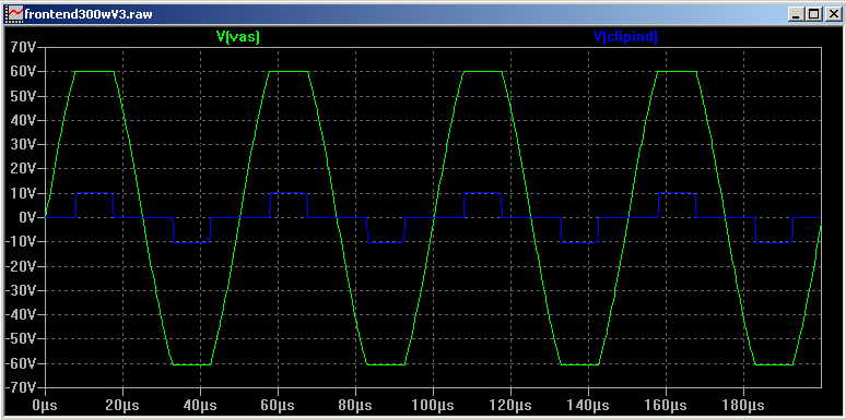

Glen
Hi Glen,
I see, you have adopted the idea a clipping detection output. Cool.

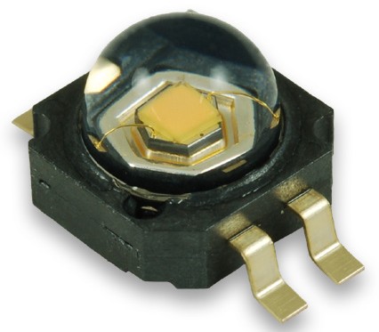

Knowing you like lots of power, what about this LED (see pic) 🙂
BTW, pleeeeeease adjust the drawing options of LTSpice: white background (in stead of gloomy gray) and a larger font.
Cheers, Edmond.
