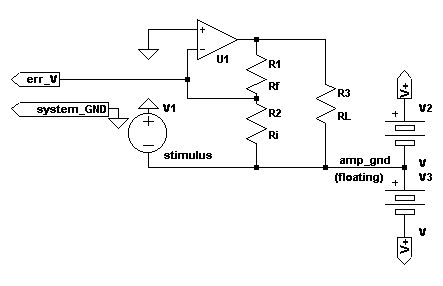

Sure (especially in a combo amp ;-)... I just wanted to point out that the effect exists...jcx said:one could comment on the irony of being concerned about cap microphonics in tube amps...
Something like this (see attachment)?[Distortion measurement resolution was extended by using Graeme's method of grounding the positive amp input and driving the xfmr isolated pwr amp's gnd with the signal source.
The negative amp input/feedback node was amplified by 30x with a opa228 "gnded" to the positive pwr amp input/measurement ground.
This gives a single ended amplified version of the error V at the pwr amp's input [...]
- Klaus
looks right, "removes" the test signal components - actually they still appear in the input error V but are reduced by the amp loop gain at the test frequencies so you are mostly looking at the distortion residual when used with high loop gain amps
the test signal reduction means amplification can be used between the error V and the the soundcard input to extend effective dynamic range
I found that my standard EI power xmfer had <20pF pri-sec Cap, you could add a external isolaton xfmr in the AC line input if a built in toriodal xmfr has too much C
