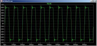

Okaaayyyyyyyyy..... I just downloaded the complete *.cir spice models for the MATXX devices from Analog Devices.
There is a series pair of back-to-back collector diodes connected as follows: C1-substrate-C2
The models provided for these diodes are:
.MODEL DMAT02 D(IS=1E-14 VJ=0.6 CJO=40E-12)
.MODEL DMAT03 D(IS=1E-14 VJ=0.6 CJO=68E-12)
I have incorporated these diodes in a revised Ltspice design file, which I have attached below (as before, it is an *.asc file renamed with the *.txt extension to allow it to posted as an attachment).
I have also put appropriate drivers (MJE1503X) into the circuit this time and updated the LTP cascode BJT’s to more suitable devices.
The circuit simulates as follows:
THD-20, 150W, 8 ohm = 0.000717%
THD-20, 300W, 4 ohm = 0.000963%
The Class AB bias current is 340mA. 20kHz loop gain is ~34dB.

The pulse response is pretty good, Glen. I wonder what the pulse response would look like if you used the same conditions as shown on the PGP website using the same output zoble/filter/load and input as the PGP: 20kHz squarewave, 20Vp-p into 4 ohms || 1uF?
I simulated those back-to-back MAT02 diodes and found them to have 20pF capacitance with zero bias (not strictly necessary I know). This is interesting because AD's datasheet says Ccc is 35pF typical. The MAT03 datasheet doesn't appear to mention Ccc at all.
traderbam said:The pulse response is pretty good, Glen. I wonder what the pulse response would look like if you used the same conditions as shown on the PGP website using the same output zoble/filter/load and input as the PGP: 20kHz squarewave, 20Vp-p into 4 ohms || 1uF?

Bob Cordell said:Hi Edmond,
Could you please post that simulation?
Thanks,
Bob
Hi Glen,
Which amp, of Bob or D.Self? And in which format? As you know, I'm using Micro-Cap, not LTSpice. Or are you only interested in the TDH figures?
Cheers, Edmond.
