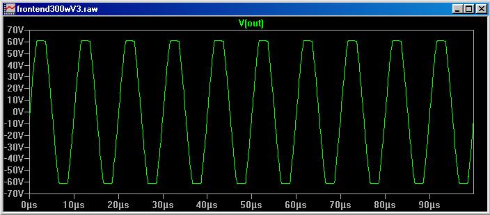

Me again 🙄
Clipping at 100kHz driving a 4 ohm load :yummy: Edmond, if you want to see the schematic I can send you another *.asc file.
Glen

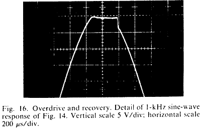

As for clamping, I'm sure your setup is okay. In our design however, we had to walk a different path, as a simple clamp couldn't cope with the high drive currents of the NDFL stage. As Ovidiu already said "we sweated blood over the clipping circuitry in our amp". Indeed, it was a "tour de force". We finally ended with a "nested clamp". that acts not only on the VAS input, but also on the inverting input of the IPS (see D13,Q27a,D5,R25). Please, compare our clamping behavior with the original one of E.M. Cherry.

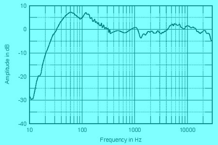

Ill designed speakers
Hi Ovidiu,
In the mean time I had a closer at this allegedly high-end loud speaker. It peaks at around 60...120Hz by at least 6dB. No wonder that the impedance drops by an equal amount at these frequencies. No further comments (of course).
Cheers, Edmond.
