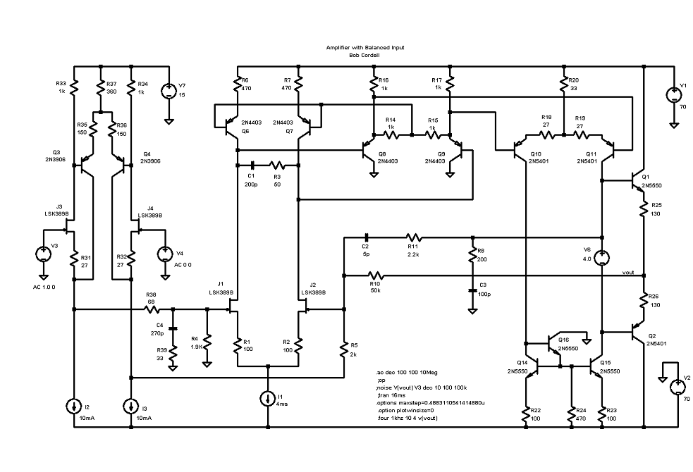

Whadda ya think of my CPF Jfet input buffer? for symetrical BJT LTP inputs? 🙂
Consider the merits:
1) Very Low THD
2) Low noise
3) No input resistor bootstrapping required for high input impedance, so no funny LF behaviour.
4) No capacitors (inc big electrolytics) required.
5) No servo required.
6) High Zin
Cheers, Glen
Hi Glen,
Whether you have potential fighting VAS problem I cant say right now, probably not if your are using 0.1% resistors and 1% Miller caps, although I would check it by means of simulation under worst case conditions. Also, don't underestimate the output impedance of the VASes, our amp does 30 Ohm at 20kHz. Several kOhm in your design seems to be a too high estimate. Did you spiced It?
What do I think of your design? Well, generally, it looks sound and clean, although the number of output trannies (40) is rather extreme, but who cares. I've no 'issues' with large numbers as long as they contribute to the performance.
As for 1) Bravo! Maybe you can get an even lower distortion by connecting the right side of TMC caps to the emitter of the pre-driver instead of directly tho the VAS output. This mod unloads the VASes. Spice it and/or make provisions on the PCB for both variants.
One thing I like the most about your design is the fact that low distortion is also possible without EC.
As for 2) It depends whether you can get the right j-fets. Do you have them already? Not to be picky, but I have a serious optical and aesthetic, though inaudible problem with this setup, as the input isn't truly fully complementary 🙂. But don't worry, using D. Self words regarding this topic, "you cannot balance a stage that is already balanced".
As for 3) Initially the LF behavior of our amp wasn't 'funny' at all (i.e. flat), as we planned 20uF in stead of 10uF for the input cap. Regrettable, small pp-caps are no longer available or hard to get.
As for 4) I'm not afraid of good electrolytics and the distortion at LF of our amp is not compromised by this arrangement. Admittedly, it is not the ultimate solution.
As for 5) Indeed, a servo isn't elegant either.
As for 6) I can't deny, that's a nice feature.
Good luck with this beast!
Cheers, Edmond.

I just did a quick sim of a VAS to confirm Zout. With an arbitrarily selected 100pF miller cap Zout is about 2k at 20kHz (output droped 6dB with a 2k load).
Glen
Edmond Stuart said:What do I think of your design? Well, generally, it looks sound and clean, although the number of output trannies (40) is rather extreme, but who cares. I've no 'issues' with large numbers as long as they contribute to the performance.
It probably is a little OTT, but they are all needed to get rid of the class A heat - 20W per trannie.
Just out of curiosity I ran a 1kHz 300W 4ohm sim - 0.5ppm THD.
Being class A, at lower powers even the THD-20 vanishes well below LTspice's resoultion.
The front end is about as linear as I think I'll bother to make it; the output stage is still the dominant source of distortion. So, adding EC to the OPS should make a significant improvement to the simmed 5ppm THD-20.
I'm currently procrastinating over wheather or not I should bother building it with EC.
Do you forsee any stability quirks with having an EC OPS enclosed in the transitional miller loop?
Glen

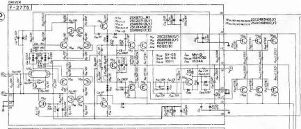

dimitri said:
Sansui AU-X1
Yes, I got the idea for biasing the tail currents of the mirrored LTP's from Sansui's "Diamond Differential Circuit", as used in the AU-X1.
But my complete design is hardly similar to the Sansui circuit, which I attach below:

Hi Glen,
I just simmed Zo too and indeed your Zo is ~2k. Admittedly, I didn't expect such high value. The good news is that you don't to have worry much about fighting VASes. Perhaps the bad news is that the potential current gain of VAS is considerable reduced by the 3k input resistor, thus explaining a much higher Zo than in our amp. If the reduced gain of the VAS is really an issue depends of course on many other factors. The only thing that counts is the performance of the amp as a whole.
Cheers, Edmond.

Hi guys.
I’ve just run a few sims which have convinced me that unless you go to an extreme symmetrical design like Edmond’s which achieves critically low VAS output impedance in the audio spectrum, that “VAS fighting” is a practical non-issue for fully differential designs.
First, I ran a full power ‘perfect’ sim for a reference distortion figure:
THD-20 = 0.000538%
Second, I doubled the value of the emitter degeneration resistors of the lower LTP from 30R to 60R to halve the voltage gain of the lower part of the circuit.
THD20 = 0.001%
Thirdly, I doubled the value of the emitter degeneration resistor of the lower VAS transistor from 100R to 200R, not only dividing by two the voltage gain of the lower half of the circuit again, but also incurring a huge DC biasing error which will be steered by the NFB, causing all the gain stages of the amplifier to run out of balance.
THD-20 = 0.003275%
Fourthly, I increased the miller compensation capacitance of the lower VAS only by 10%.
THD-20 = 0.004553%
That’s almost an order of magnitude worsening in THD performance, but these are obviously quite extreme errors that will never exist in a real implementation of the circuit (unless you had Steevie Wonder load the PCB’s) Real life errors will only incur an extremely small THD increase from optimal.
Edmond, have you still got the simulation files of my 12W amp?
You might want to recreate my experiment.
This is as far as I will look into this tonight. It’s past 11pm and I’m going to bed now.
Glen

Hi Brian,
I like it. It is much the same as the balanced input circuit I have been using for some time that I described over in the Unipolar vs Complementary input stage thread (page 8, post 199).
In that circuit, I used it outside the loop as a differential buffer to provide a nice hi-impedance balanced input for an amplifier. You are using a similar circuit inside the loop to drive the bipolar input stages.
My circuit uses a differential pair to form a differential CFP function. I call the whole thing a Differential Complementary Feedback Quad (DCFQ).
The circuit as shown in the original post along with a VAS to make a balanced input amplifier is shown below.
Being in the open loop, and connected as shown, its THD is less than 0.002% under all input driving conditions.
Bob
