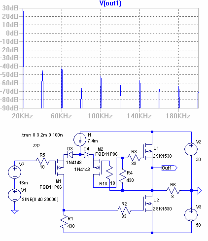

Hi Bob,
in simulation (using andi_c 2SK1530 models for the output) I am getting about 0.03% at 20kHz from 5 to 100W into 8 Ohm on 50V rails with 150mA idle current without EC on a single pair of devices. Now I need to try it for real.
Cheers
Alex
Re: Re: Re: Re: Re: Re: PGP
x-pro said:
Hi Bob,
Cheers
Alex
Hi Alex,
Which models exactly did you use? The originals form Andy (2SK1539 & SJS201) or the modified one from me for the 2SJ201?
Cheers, Edmond.
Re: Re: Re: Re: Re: Re: Re: PGP
Edmond Stuart said:
Hi Alex,
Cheers, Edmond.
Hi Edmond - I am using the model from here:
http://www.diyaudio.com/forums/showthread.php?postid=1316183#post1316183
in my O/P stage only N-ch devices used. It was quite interesting to see a close level of performance to an EC circuit - after Bob mentioned it.
Cheers
Alex
P.S. - is there a large difefrence with a later model? I also got close performance results using HUF76639 models from Fairchild Semi.

Re: Re: Re: Re: Re: Re: Re: Re: PGP
Cheers, Alex
P.S. - is there a large difference with a later model? I also got close performance results using HUF76639 models from Fairchild Semi.
Hi Alex,
If you are using only the n-channel model, no problem at all. Using the p-channel model is another story. I twas very difficult for Andy to "connect" the data from the (real) measurements of the weak inversion to the higher drain current characteristics obtained from the data sheet. Therefor I dropped a modified version, see also:
http://www.diyaudio.com/forums/showthread.php?postid=1322569#post1322569
and:
http://www.diyaudio.com/forums/showthread.php?postid=1323417#post1323417
Yes, in regard of crossover distortion, it does.
Cheers, Edmond.
Bob Cordell said:
Hmmmm,
I'm confused. Is that open-loop with no NFB?
Thanks,
Bob
Yes (only local NFB)
I attach the simulated FFT graph and circuit I've used:
potentially used P-channel models (from LTspice) may give somewhat inflated figures. That is why I would like to try it live 🙂 .
Cheers
Alex
P.S. Conditions as I've described (idle current 150mA, output voltage 80V p-p, on the graph 20kHz is at +29dB)
