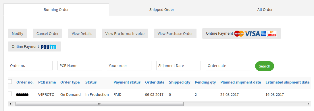

Hello people!
A new amplifier has been cooking for some months and a few days ago was finalized. By design it is a detour from our beloved "PeeCeeBee" design. A perfboard version is playing music and tones right now and all I can say is that electrically and sonically it is the step forward for the simple design that has been rocking for the last four years.
The new design is "marginally" complex, uses basic LED biased active CCS, all small signal transistors the easy to access BC556B/546B, emitter-follower VAS with current limit and diode-clamped soft-ish clipping with much less HF distortion than usual, uses input inclusive compensation in addition to usual Miller compensation, produces ~100V/us slew rate, lower overall THD, MUCH less low frequency distortion and MUCH higher damping factor at LF.
I have ordered a couple prototypes of the initial layout. The board would look kind of like the picture (with what Kicad calls "black" mask 😀 ). The PCB is 2 layer PTH. The full test results, schematic and layout will be uploaded in the new thread.
