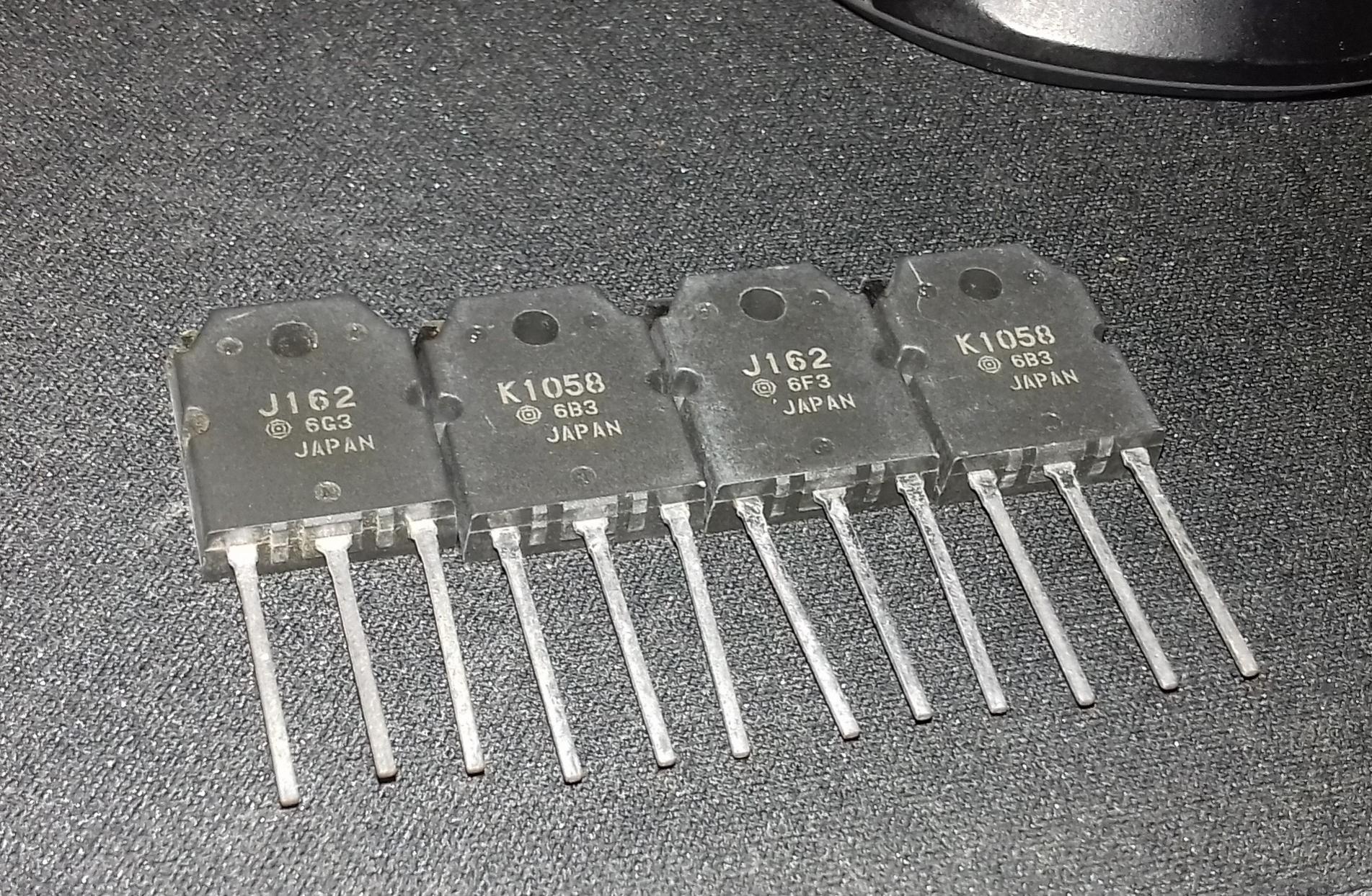

I have a pair of Hitachi's 2SK1058 and 2SJ162. seller says it's new old stock, but I doubt if it's fake. Can anyone tell me if my mosfets are fake or not
Thanks, sorry for my bad english
H Rams
I saw your review with this photo in one of tokopedia seller. i personally asked the seller whether those has GDS or GSD pin out and the seller said those are GDS.
hope this help.
Regards.
Hi Rams,
It look original for me but it must be measure for sure.
(Diukur dahulu pakai tester/transistor tester)
If GDS is 100% fake
If you buy from tokopedia or bukalapak, I personally rekomended from kusala electro. It is for sure 100% original & the photo is real product. To bad in our country there are so much fake photo from the seller & different from the original/real product.

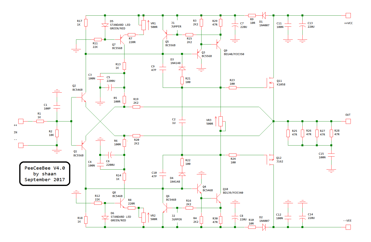

Hello, have a nice day. Could you please mark in this diagram where and what values I should measure when setting all the trimmers and what those values should be? Somehow I couldn't find any instructions. I would like to try building this amp, thank you very much. 🙂 🙂
You should check out the PeeCeeBee GB thread in the Group Buy section of Marketplace on DIYA. Bottom of first post, Shaan provides a link to the populating and start-up process and gives you exactly what you are asking for.Hello, have a nice day. Could you please mark in this diagram where and what values I should measure when setting all the trimmers and what those values should be? Somehow I couldn't find any instructions. I would like to try building this amp, thank you very much. 🙂 🙂
https://www.diyaudio.com/community/threads/peeceebee-v4-gb.307077/
