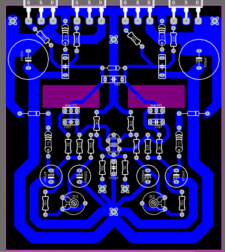

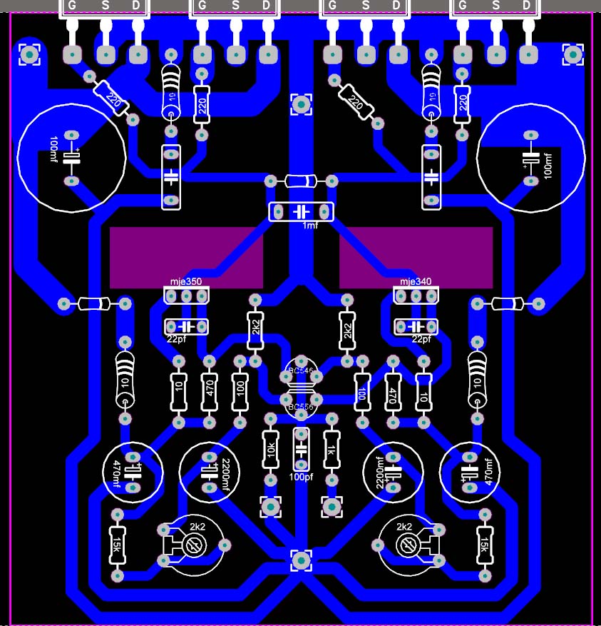

Hi Shaan, i've made some changes,i hope this is the final design.
Please tell me what type and value of fuse for V2 with 35+35volts.
Thanks.
