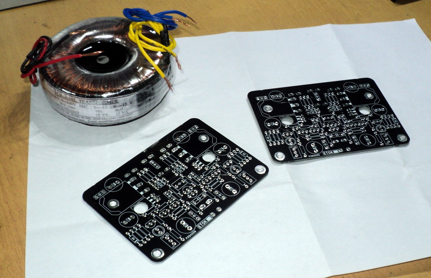

Looking interesting.. what is the schematic?
These are the prototypes of the new PeeCeeBee V4.0 for final testing. This is its last experimental phase so schematic is almost finalized. All will be published in a new thread when ready. There may even be a group buy for PCBs (if interest arises). 🙂
