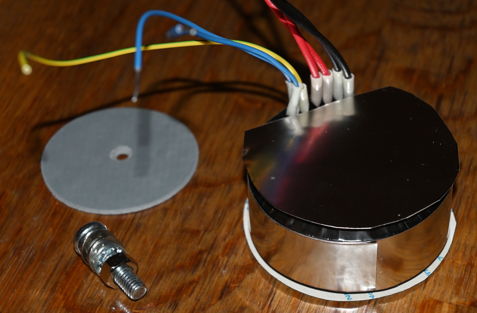

While waiting for Santa Claus I decided to cut some mu-metal foil to add some extra magnetic shielding for the small 20 VA P3 PSU transformer.
It is a Toridy and has already a magnetic shield. But I thought it could not "hurt" (unless you cut your fingers on foil.....but did not so far).
Then I also found a bolt (+shims) with correct diameter and length for the build. Just such a small task can take some time 🙂

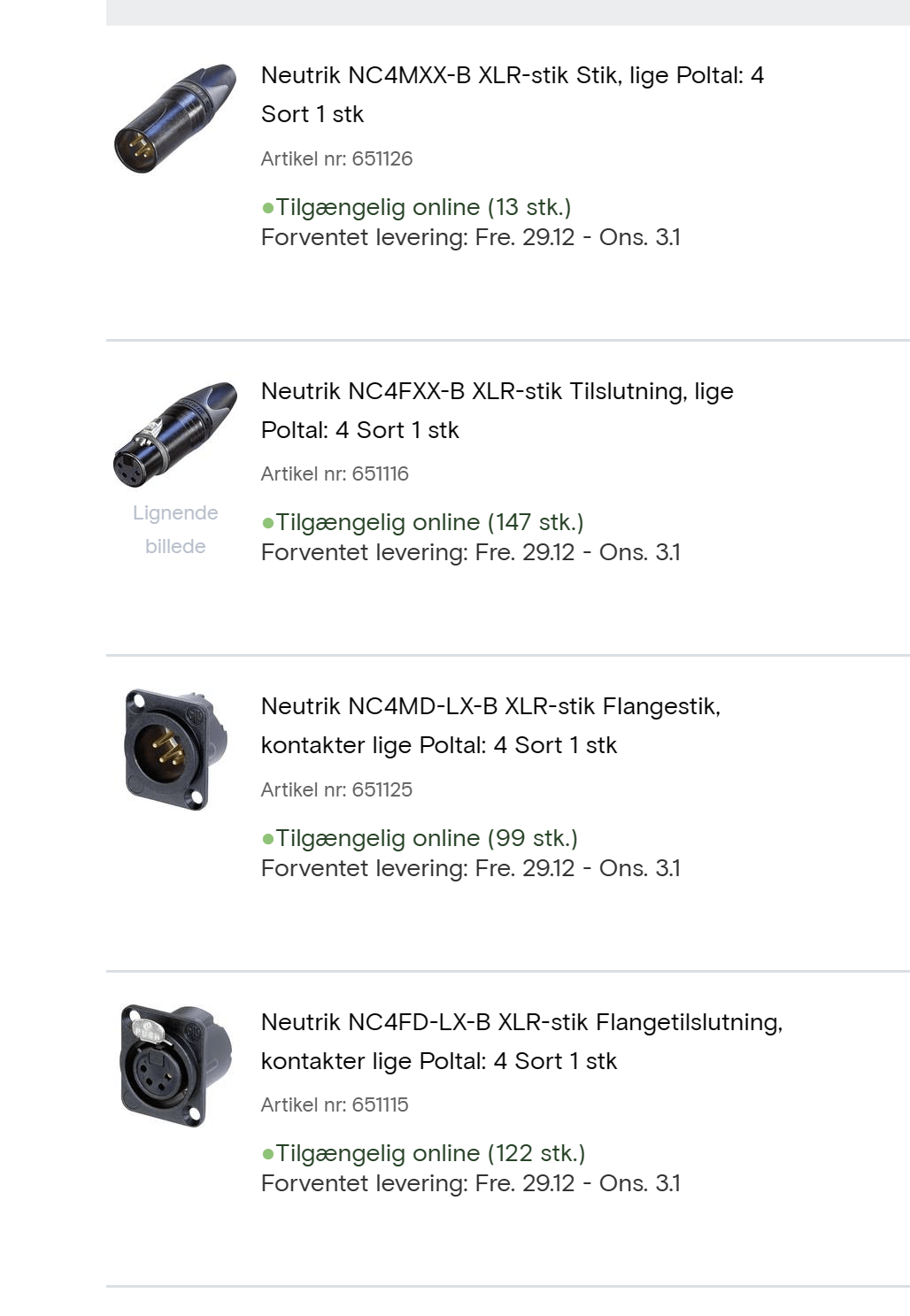

I have prepared the connectors for the power cable between the two P3 chassis (PSU / Riaa).
I want to transfer V+, V-, Gnd, SE (green / yellow). Then female chassis connector in PSU end and male chassis connector in Riaa end.
So 4-pole Neutrik XLR "hardware". I have just put them into the basket but not ordered it yet. Then the two connectors for the cable.
Use a captive cable on the one of the chassis. The guide shows it as captive on the PSU, but either way works.
That way you can't ever get confused or plug the wrong thing together.
