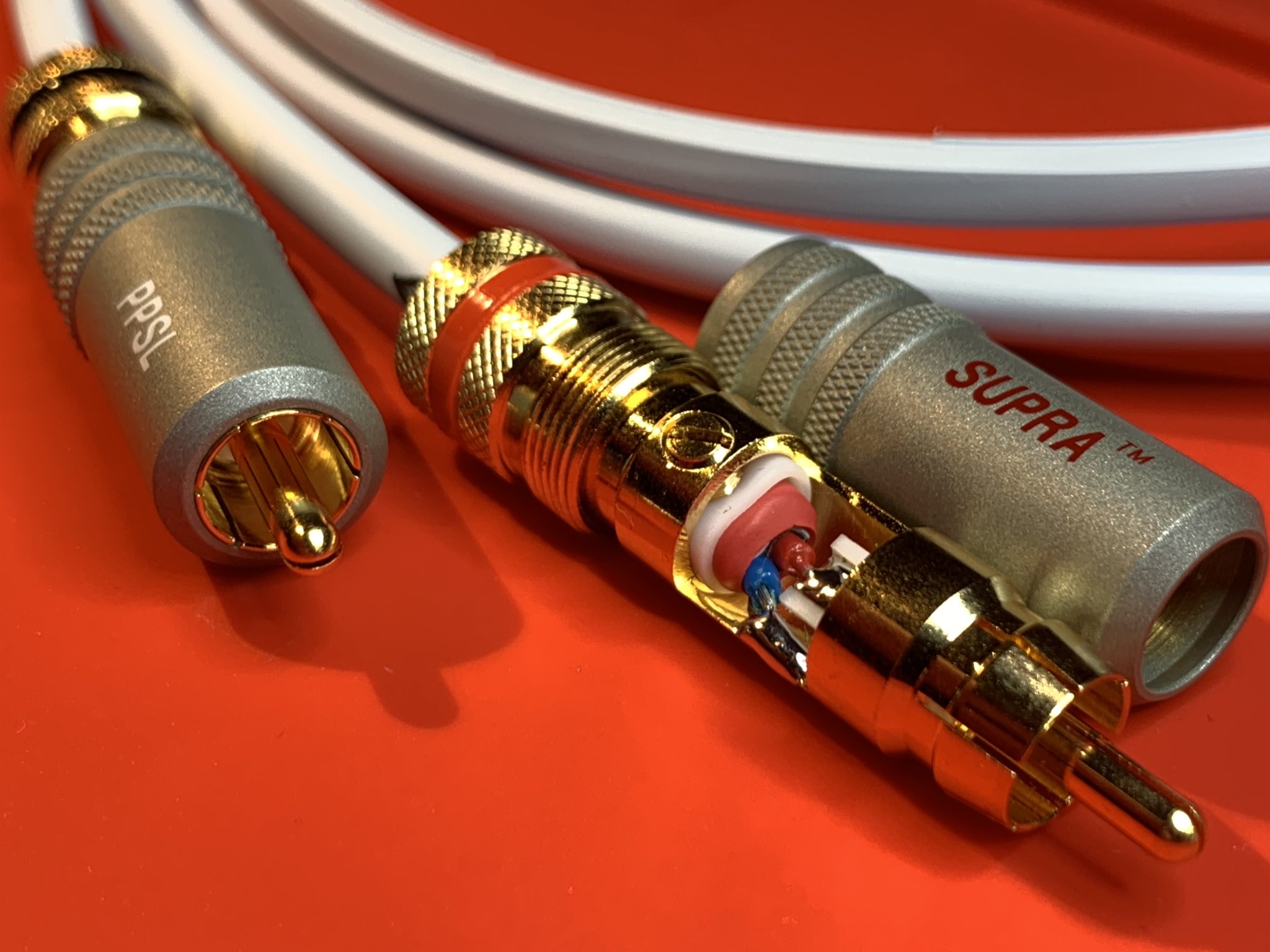

Orange and light blue wires... that's your problem... you have a color mismatch between the wire dielectric and the color of the RCA plugs.
What's the color of the mat?
Color mismatches affect the chromatic presentation of symphonic pieces.... I suggest you play the turntable with the lights off so the music flow is unaware of the color changes.

I think JeyDee has got fake cables or he need to color calibrate his camera / images.
The color is red and blue (blue difficult to see on image). It is very audible that the "red" is not "orange" in my original Supra cables!
The mat is dark gray on top with a white circle in the center and black against the platter. I just tested that the carbon side on top is conducting.

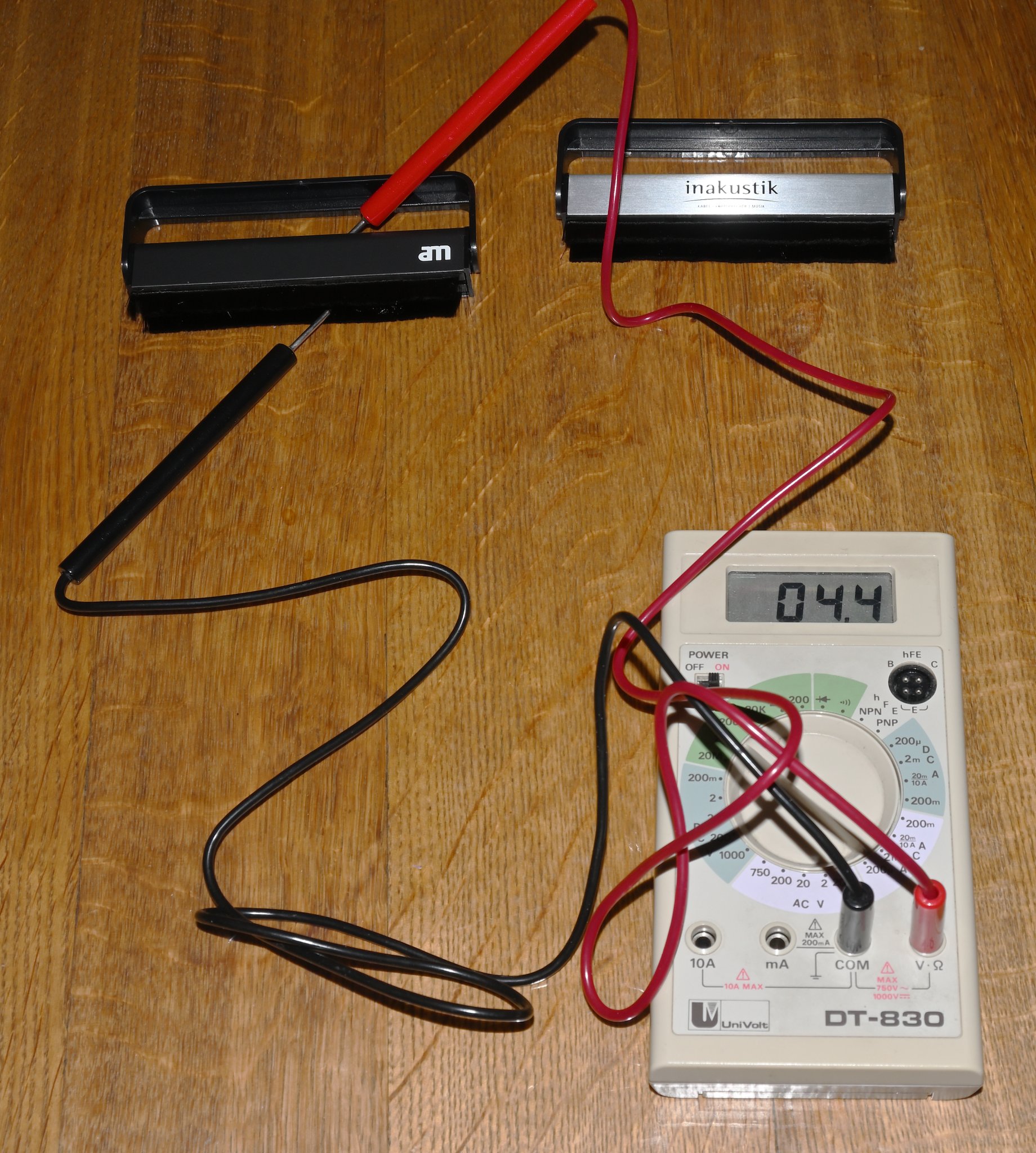

I got an original AM record brush (anti static).
It is advertised that the surface is conducting. The test shows that this is correct.
The different between the AM and the Inakustik brush is that while both are conducting the probe-tip has to be push into the aluminium surface to be conducting (previous image shows that). The AM brush you just have to touch. This means that in practice the Inakustik brush does not work as intended (as I see it) but the AM brush does. It will discharge the static load on record through the body when using the brush.
Will see when I get more practical experience with the brush.

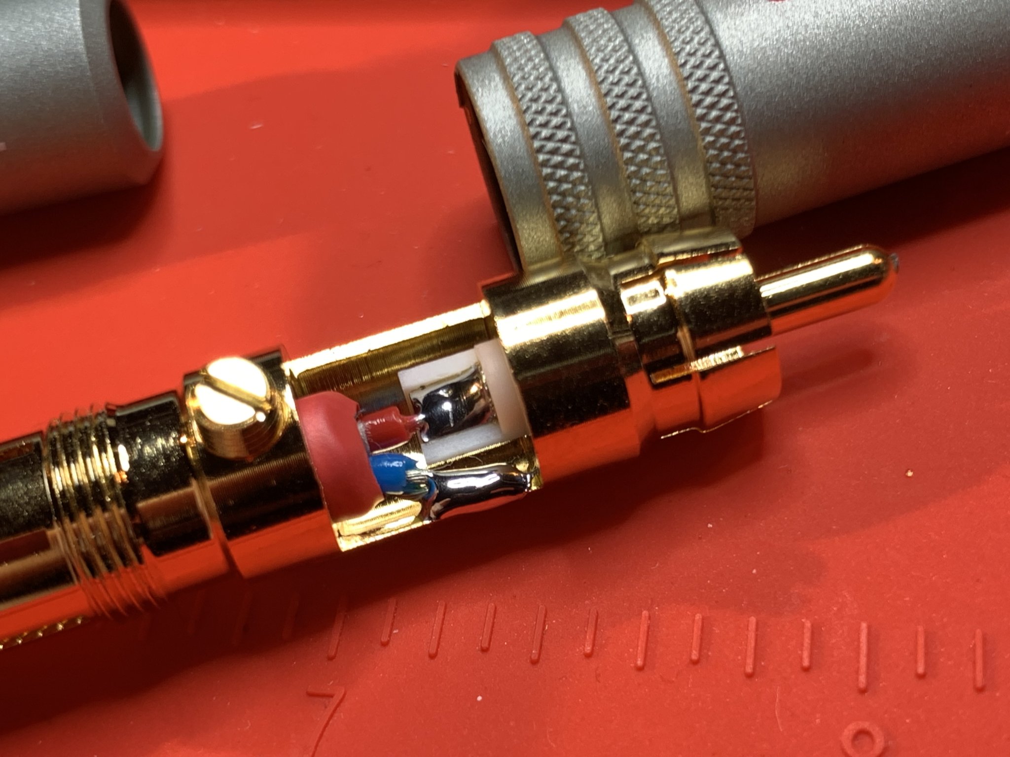

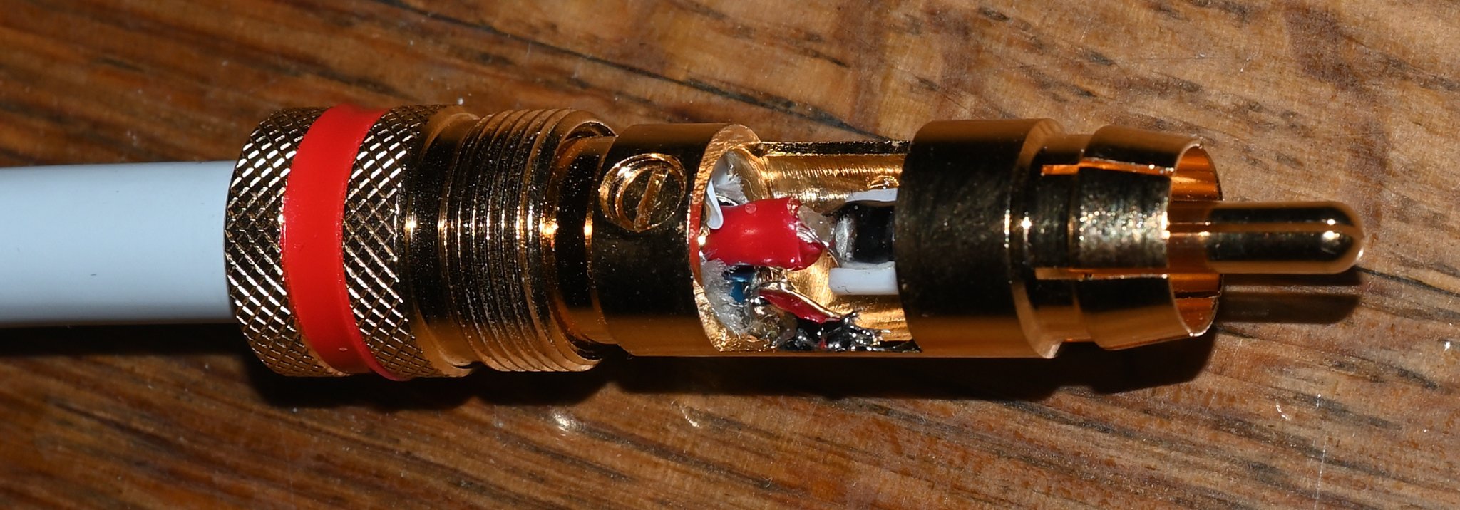

Red flex has been applied. Then the cable secure screw has a bit more to push on.
To solder the blue wire requires a bit of heat and solder has to stay inside. Else the screw-cap can be difficult to mount.
Looks nice!
Looks nice!
Yea, and this is how it looks with the locking screw snugged down against the white protective sleeve around the cable.
So, Now Time for some good 🎺🙂🎸

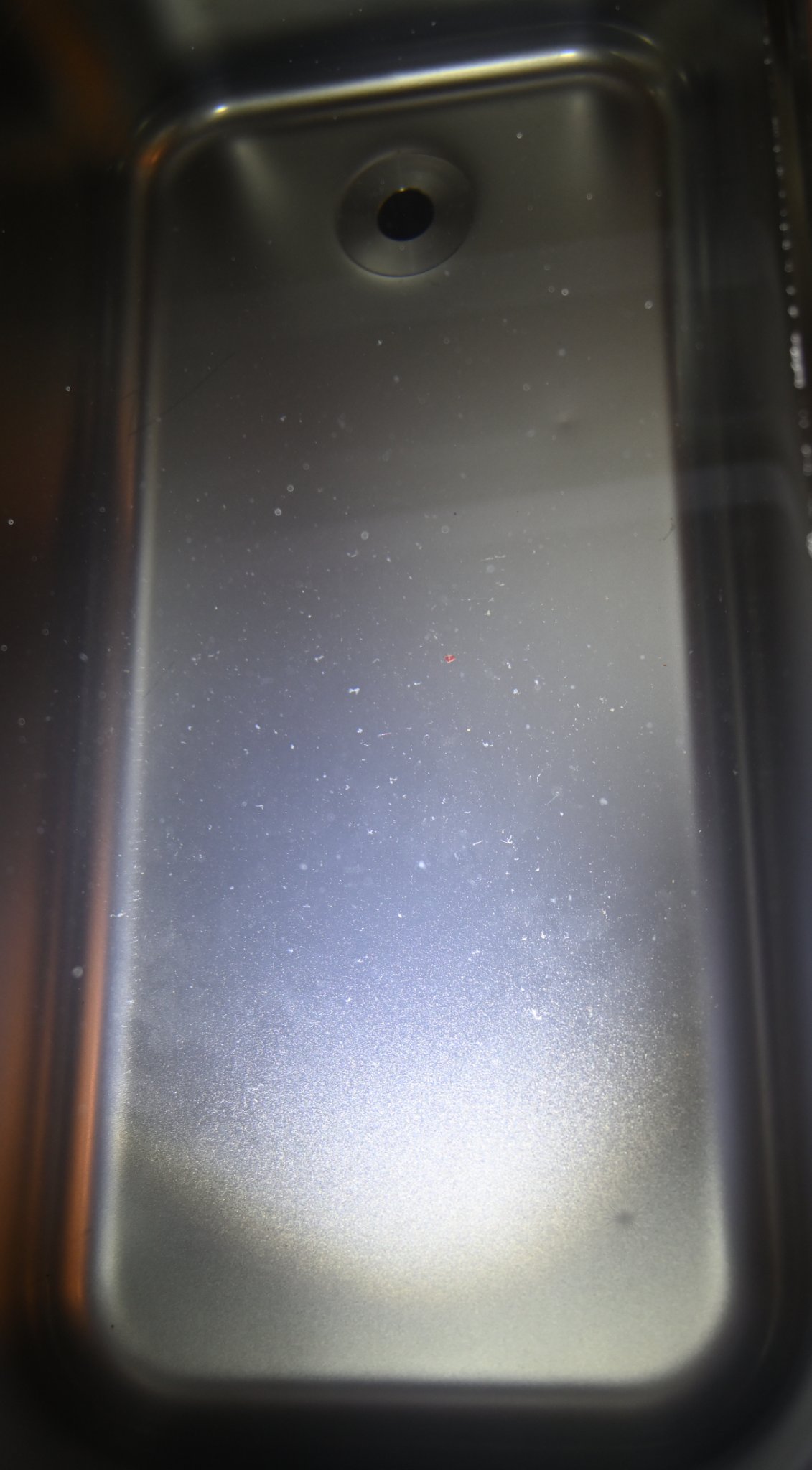

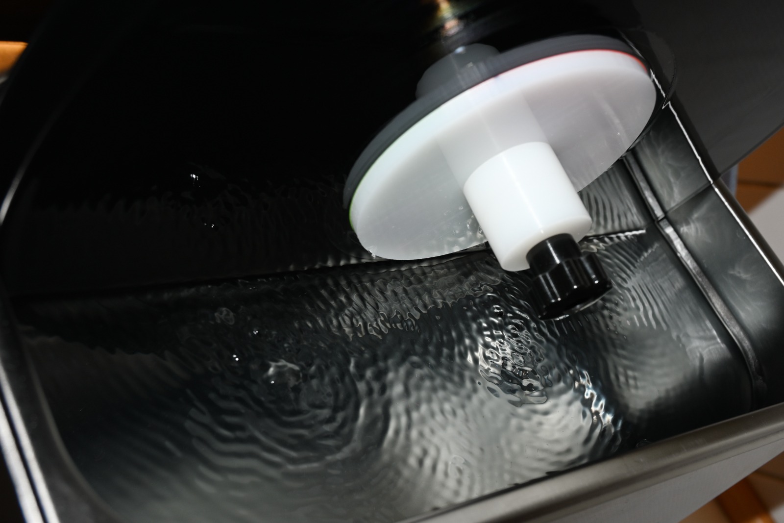

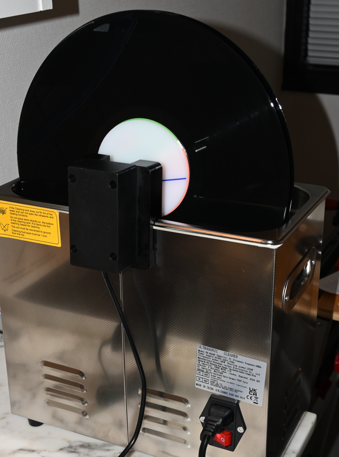

I tried out for the first time my ultrasonic cleaner. Mounted two records (Led Zeppelin I and II) and let them run for 30 min.
They looked very clean from the beginning but some dirt has been collected in the water (last image).
Will see next time I play them if I can hear less "pops".

The records cleaning was 30 min. in 35 C demineralized water (+f ew drops dishwasher soap + few drops of.....that makes water run off easy + just very small amount of alcohol).
