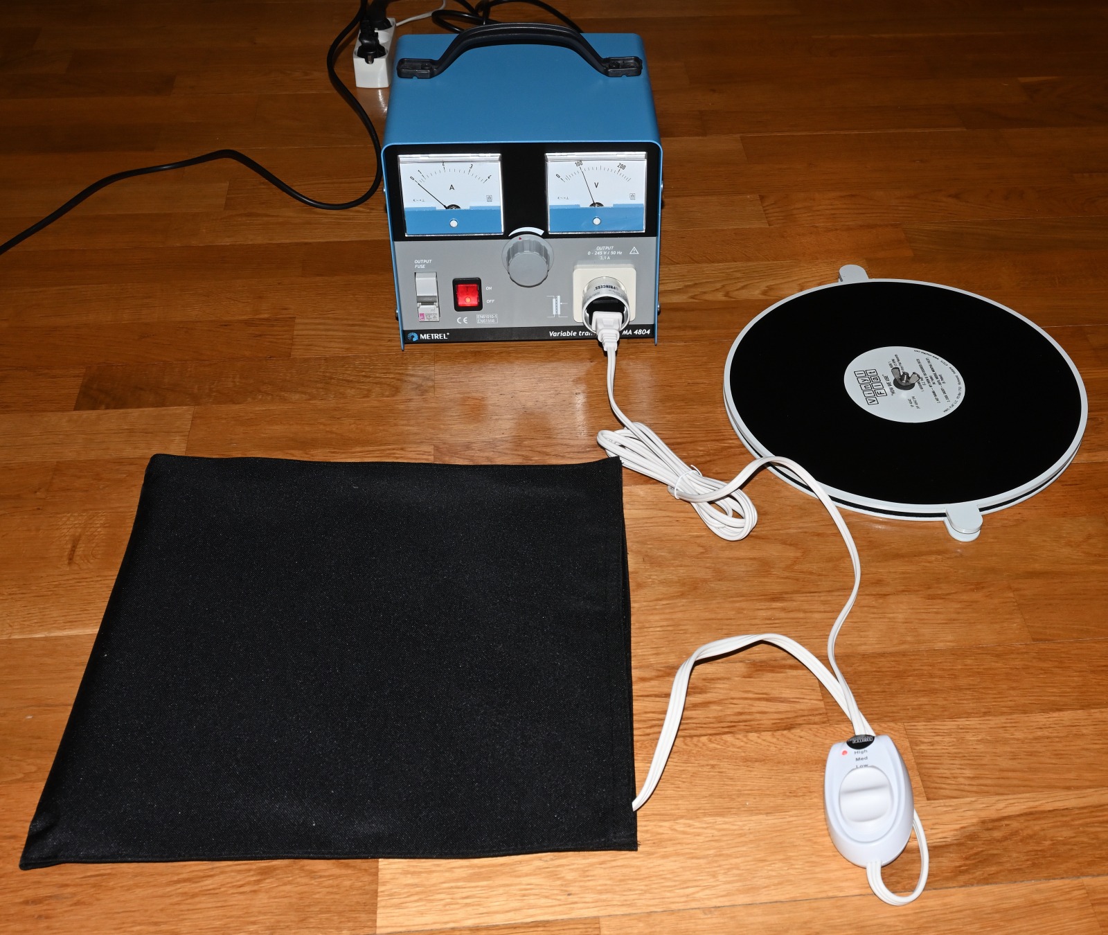

I received the vinyl flattener today and I have started "playing" with it.

I am preparing the first flattening. First I have to be sure of the temperatur in the "pouch" <-- they call it that.
It is 110 VAC device (just received from US). I use my vario to reduce the voltage (also found some usable adapters for the funny US-connector).
I need 54C to start with which should be safe for the vinyl. The "pouch" has 3 settings. At the lowest 110V in gave 57C. The vario is good so I have finetune the temp. Then starttime will be 2 hours. If nothing happens then time must go up by 1/2 hour etc. If it has flatten a bit but not total time has to go up with 10 min. That is the described procedure (in short form).

First 2 hours when I have reached 54 C.
Most safe is no heat. But then I takes weeks / months to flatten. Then 49 C should be very safe but will also take very long time. 54 C seems to be the recommended temp to use. Very little chance for damage if the described steps are followed.
The record to flatten has also just been ultrasonic cleaned. It is recommended so dirt is not "glued" into the grooves.
