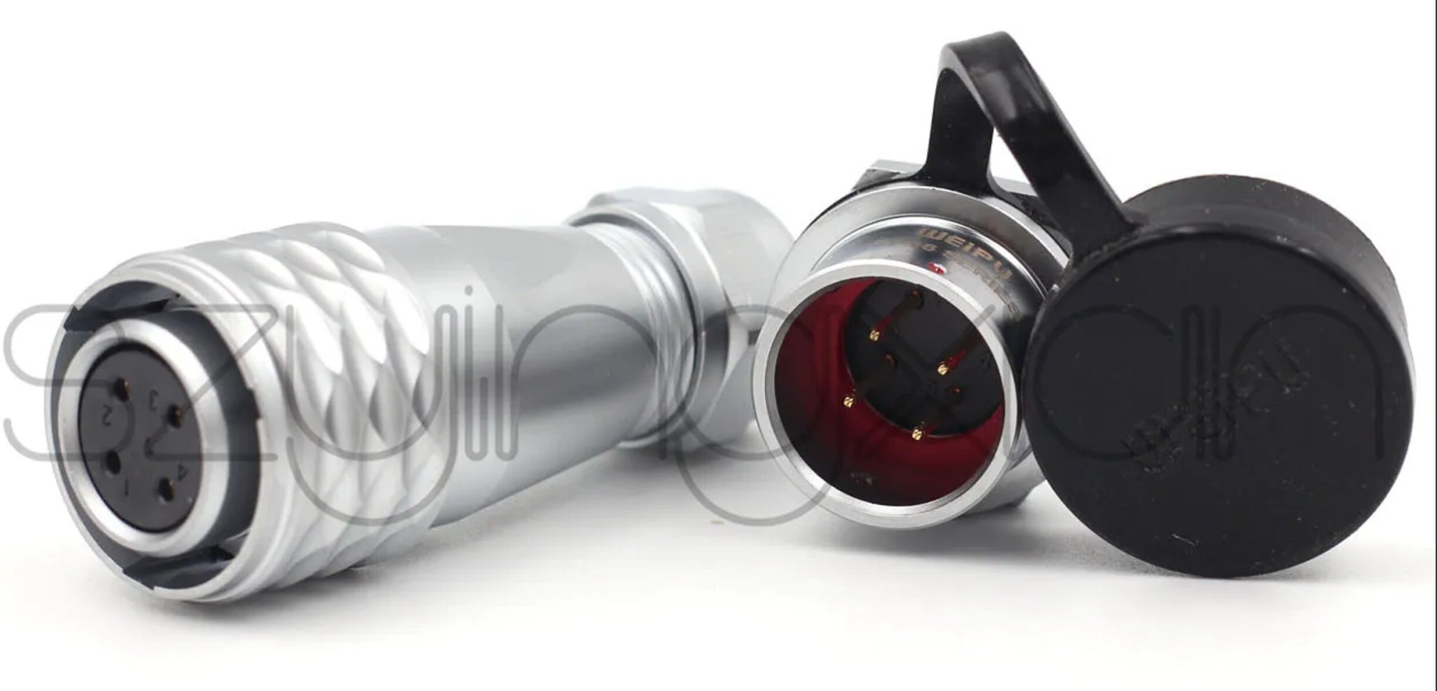

I suggest you use a female jack on the PSU if you go with the captive cable on the RIAA box - no exposed pins with voltage on them. If you put the cable on the PSU, use a cable with a female plug and male jack on the RIAA box. You can buy assembled 4-pin XLR cables, but check the wire size first.
I went overboard (I like the finish and the smooth engagement of the plug and jack) and went with these:
I go with captive cable at PSU end. So Male chassis connector at Riaa chassis.
The "Cable gland" must be the one I need instead of the chassis connector at PSU end. Many strange names......

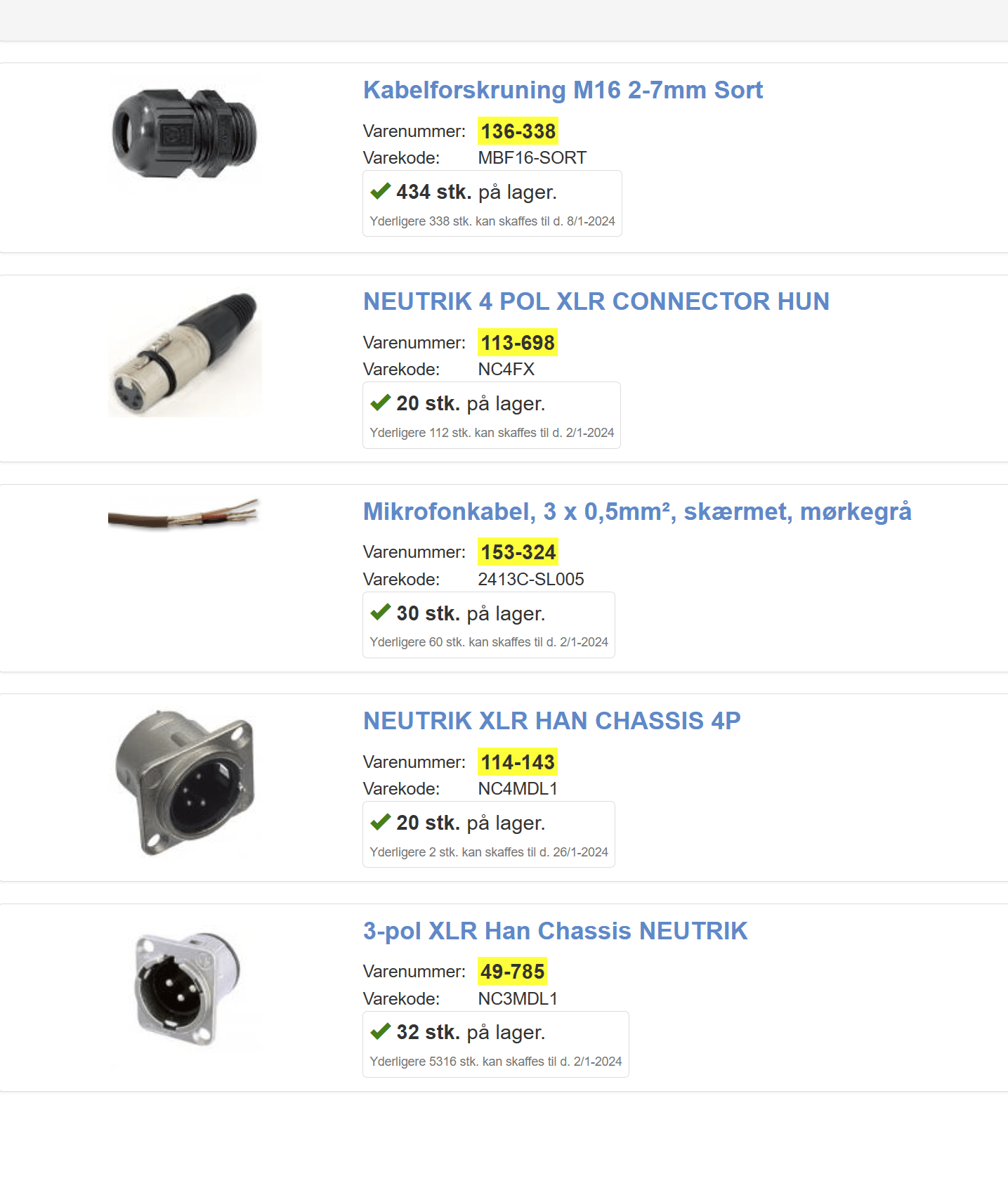

Now I found a small local place to source "things". Ok for me to support the small shops. Even when they only have the XLRs in chrome (and not black) 😎

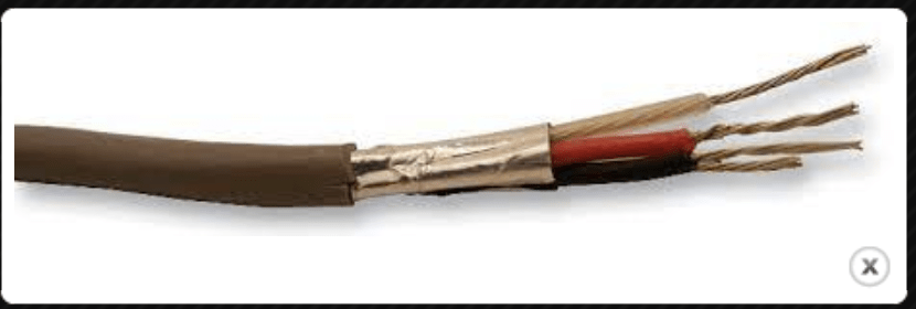

I also found a microphone cable (3 x 0.5mm2 + screen). 0.5mm2 should be more than enough for up to 1A current. Cable is 5mm in diameter.
Also the "cable gland" is different but M16 (so should fit into the hole) but only takes cables up to 7mm (from 2 to 7 mm). It should work with the cable I found. The screen is described as "AI-PET foil". It is then nice they have made a wire so it is easy to solder to connector. I assume that the standalone bare wire for the screen has electrical contact with the PET foil screen......and that is the way it is supposed to work.
The cable manufacture is described as "ALPHA WIRE". Cable is dark gray color in description and not brown as in picture.
"Cable gland" very fine.......swiss made 🙂 .....something called Bopla.......Boplaflex. This part must be Swiss made for P3 PSU!

By the way......will use screen wire for Earth and connect it to chassis in Riaa chassis (which is also connected to chassis in PSU).
Don't think I will connect Gnd to chassis in PSU chassis but will in Riaa chassis connect Gnd to chassis via a small NTC.
Then black wire for Gnd, Red for V+ and the transparent for V-.......that is the plan so far.

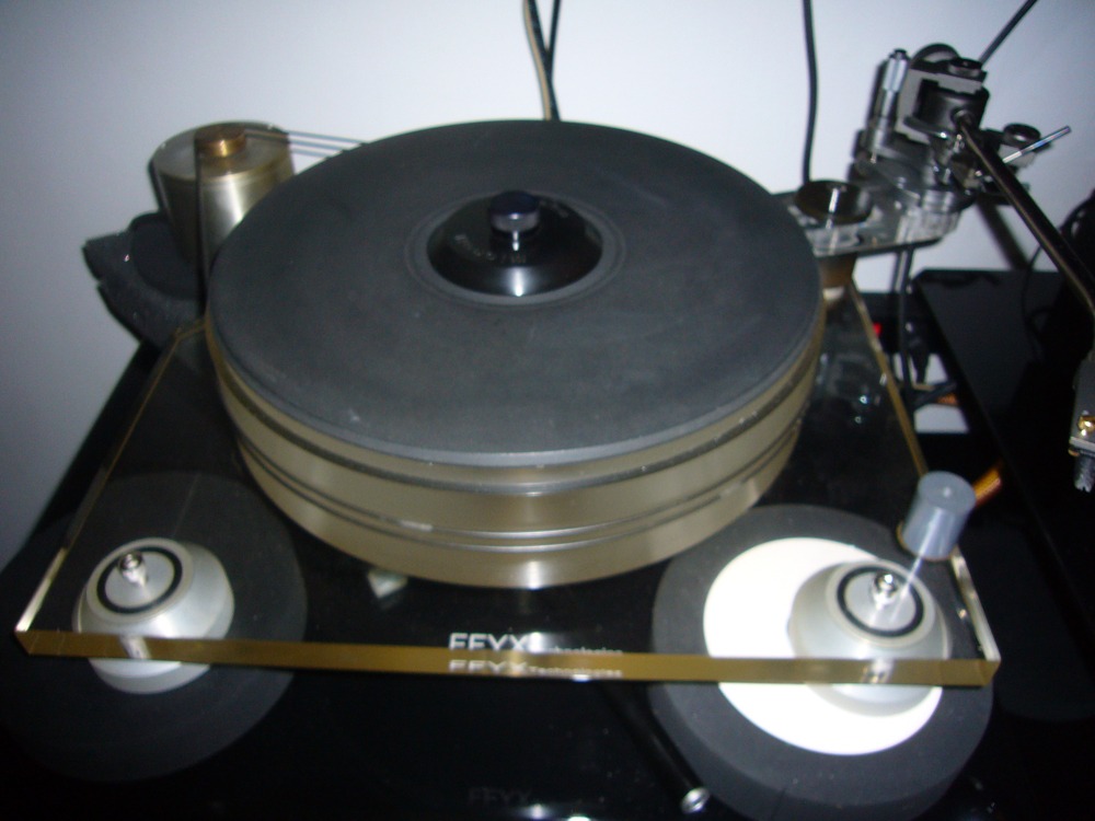

Here´s my vinyl rigs.... not giantly heavy Melco´s or similar, but after some careful mod´s pretty good:
They are playing through my DIY Pass X-Ono clone:

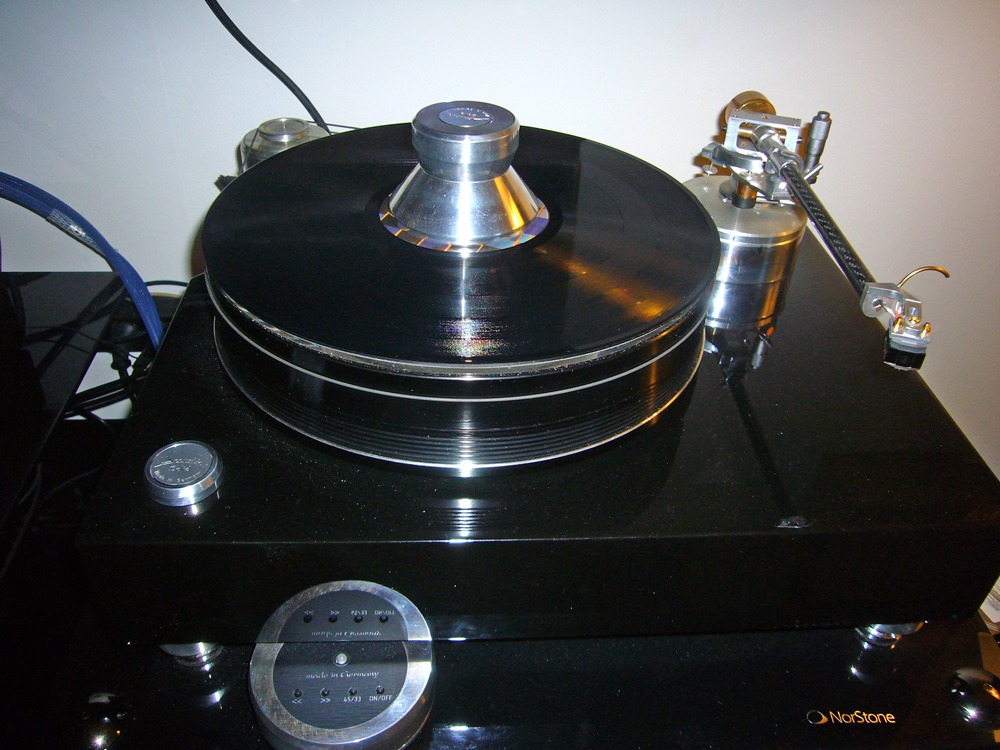

Fancy setup and you have really many records 🙂
Can see you also use Norstone rack with glass shelves. I like my. Seems to be very stable and rack was reasonable priced. HiFi furniture's can be extremely expensive.
Maybe I will get the additional TT glass shelve for the Norstone rack and then place the riaa part below and then the psu part on the shelve below.

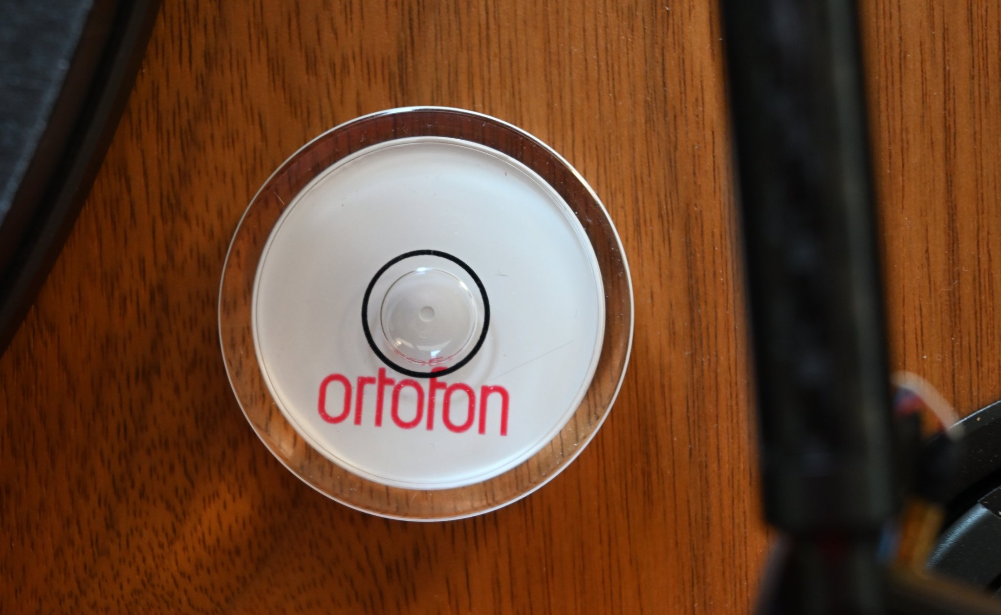

Could be nice with a shelf (non wall mounted) where you can fine tune the level. That would probably require a 3-feet solution.
Thought I would share a little trick for ttbls that sit on a rack, if you have foot fall problems, and the rack is freestanding. Take something, like a piece of wood, that is slightly longer than the distance between shelf and the wall. Lean the cabinet away from the wall and wedge the wood between the rack and wall, higher is better.

Regarding level adjustment of my TT. It could be finetuned a little bit.
I know that some TT's have such a feature but not my model. It is probably not expensive enough......
