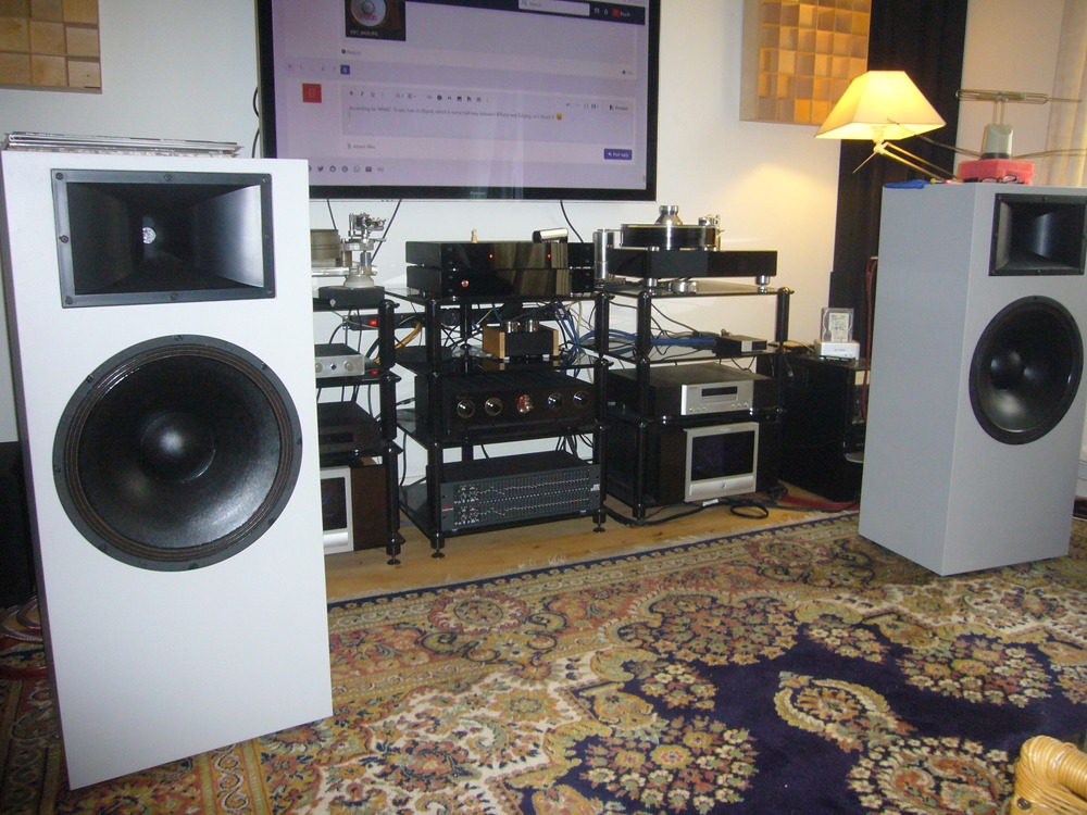

Very nice speakers!
They can play loud enough I guess.

That´s OK...... I know where that is. Here we call it "Finnebyen"........ I´ll check it out.
And yeah... The Asathor´s are insanely sensitive.... at least compared to my Magnepan´s.
My monoblocks put out 600watt in 4 ohm, and where I sometimes had the VU-meters reach the top on the Maggies,
the SPL is more than enough when they reach somewhere between 6 & 10watts on the Asathor´s.
Incredible nice speakers.
Best of all...... the total amount for paying the carpenter/woodworker for the boxes, the drivers, the horns, all the crossover components,
the terminals, the paint and everything included came to around 1000 Euros +- 20 Euros. This is extremely good value for the money 😍 👍
