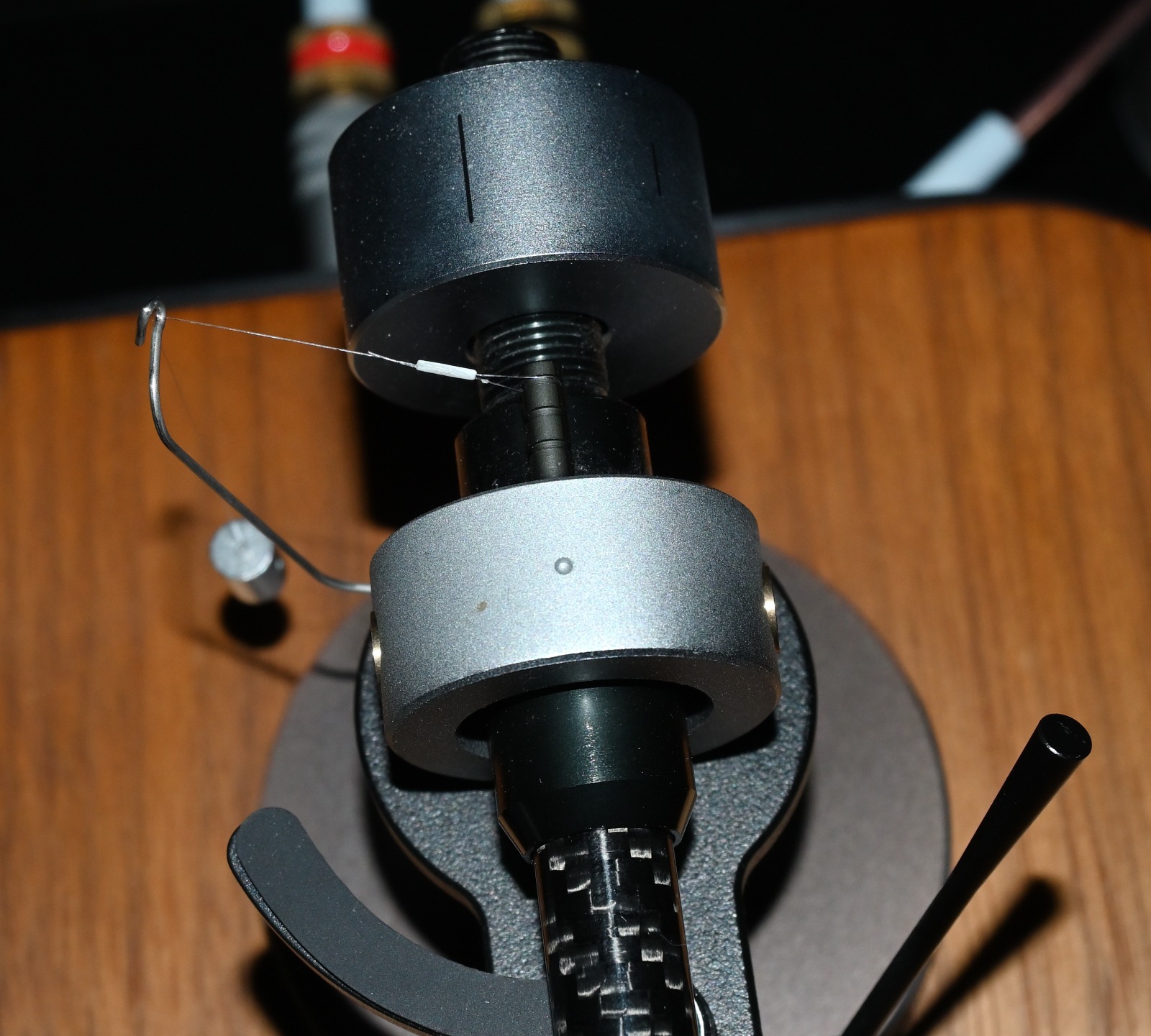

I started playing the test-record I got recently. Everything about phase, channel balance, cross talk were ok.
Then I continued with tracking capability. 40, 50, 60 um were fine. But 70 um there was a little bit of distortion in right channel. Then I raised the antiskating one step end then 70 um was fine. Also 80 um. Maybe just a very faint distorsion. 90 um was distorted. But now I can't raise AS anymore as I am in the last groove. I could add some weight to the "weight". Is there a recommended method to do this (that also looks good )?
I took if off to put it on a precision scale. It says 1.85g incl. the thin nylon thread. I could also just get a 2g or 2.6g.....or both.
I have a digital scale on the way to measure the cartridge VTF. So before experimenting a lot I will be sure the VTF is correct.
I don't think the arm / cartridge will be able to track at 100 um......but maybe 90 um with a bit of luck.

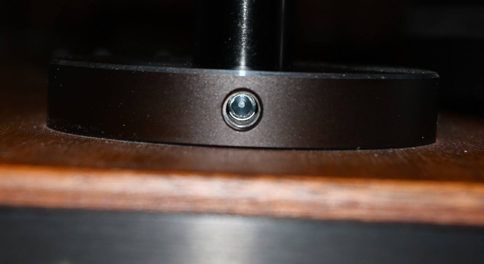

I was about to try to level the tonearm on my Miracord TT.
It seems it is done by loosening the screw at the back of the tonearm base as picture shows.
First......is it 100% sure that it is the way to do it?
It is an M6 screw and a 3mm hex key fits. I have a 3mm hex key with a handle so I can apply a lot of torque.
The problem is that I don't want to apply more torque than I did. It sits really tight.
I have a feeling that they could have used thread lock (like e.g. Loctite). The arm is factory adjusted to a specific cartridge. So it could be the case?
It is a steel screw in aluminium so it could also just be "stuck" by some oxidation.
What do you think?
If thread lock then acetone could dilute it. If oxidation then thin oil could help?
What to try first?
I think it would be quite stupid if the factory has used thread lock......
It is strange that no google search hits "something" about the topic......
I have sent a mail to Elac but it can take days before they respond......if they ever do.
I have sent a couple of mails to them before and never got a response.
It is a nice TT but their costumer service is "non existing".....so far......

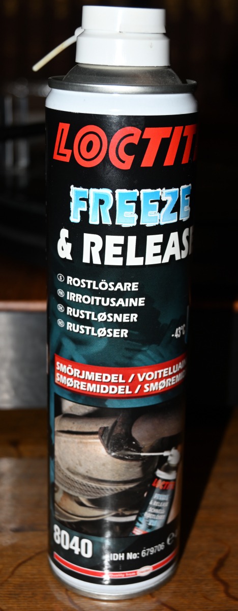

What do you think?
What to try first?

Now I got response back from Elac in Germany regarding the tight screw:
Here is the response:
"The grub screw is designed in such a way that it cuts into the tube of the tonearm mounting in order to create a perfect ground connection at this point. This requires a little more torque to “safely” break through the anodized material.
- A long (15-20cm) Allen key with a T-handle is best suited for this. This is the best way to put pressure on the screw (to prevent it from slipping) and turn it at the same time. The large length of the tool helps to transfer the force to the screw for loosening.
- An angled Allen key also works. To do this, insert the short side into the screw head and use the long side (15-20cm) as a lever to loosen it. However, it is important to ensure that the tool does not work its way out of the screw head due to the high leverage. When “leveraging”, sufficient pressure must be exerted on the screw head at the same time.
The screws are very tight! We know that, and it cannot be avoided at this point."
