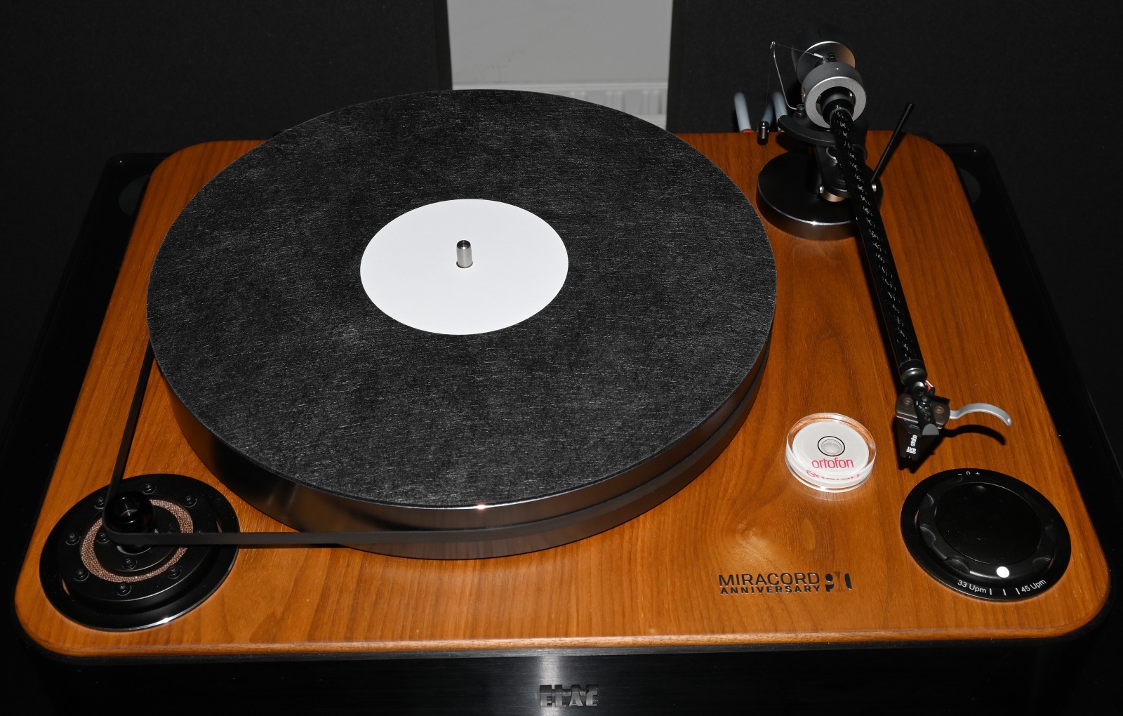

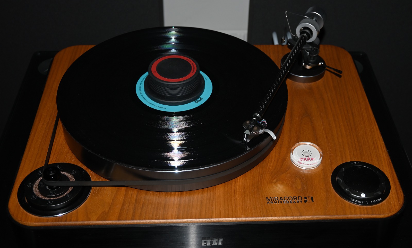

For the first time I had the new TT playing.
I used a small NAD riaa from a friend. Not without problems. To begin with there was sound only in the left channel.
I traced it down to the riaa and found out it had a bad connection in the MC / MM switch. The slider contact had to be "worked" a bit. After this sound in both channels. After this I did a quick test and sound it ok. Played Led Zeppelin. Have to listen more but ok 3D and depth. I hear small "pops" now and then in the silent passages. I will do a record cleaning soon.
The platter has a thin felt mat. What do you use? felt, cork, rubber, leather, vinyl (seems Clearaudio makes one that is made of vinyl).

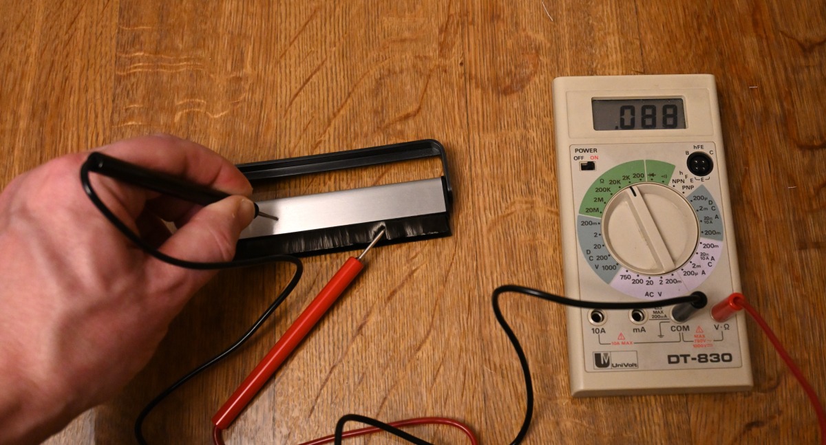

Then I looked at the AM vinyl brush:
https://www.amcleansound.com/products/vinyl-brush
It has conductive carbon hairs which has electrical contact to the metal shell (look at picture no. 5 from link above). The internal construction is shown.
Then I looked at my own new record brush which looks like a copy (Inakustik brand). At their homepage the show that their brush is also conducting in order to remove static charges from record. On attached picture it shows that it is conducting. But I have to push the probe tip really hard into the aluminium to have it conducting. I am sure with just my fingers the oxidation of the aluminium surface will cause that it is not conducting though my hand / body.
The original AM brush has a black conducting surface (according to the specification at picture no. 5). This could make a difference!

I found out that I have probably installed the AM mat with wrong surface up.
Mat has a felt surface and a harder carbon surface. According to specification the harder carbon surface should be upwards.

It made quite a difference to install the AM-mat with the carbon side up.
Don't hear "pop's" any more when dusting off the record using the brush.
Also when taking off the record it has no static charges.
So far I keep this AM-mat on the TT.

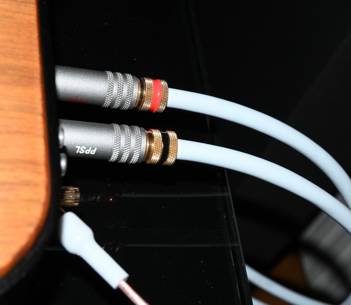

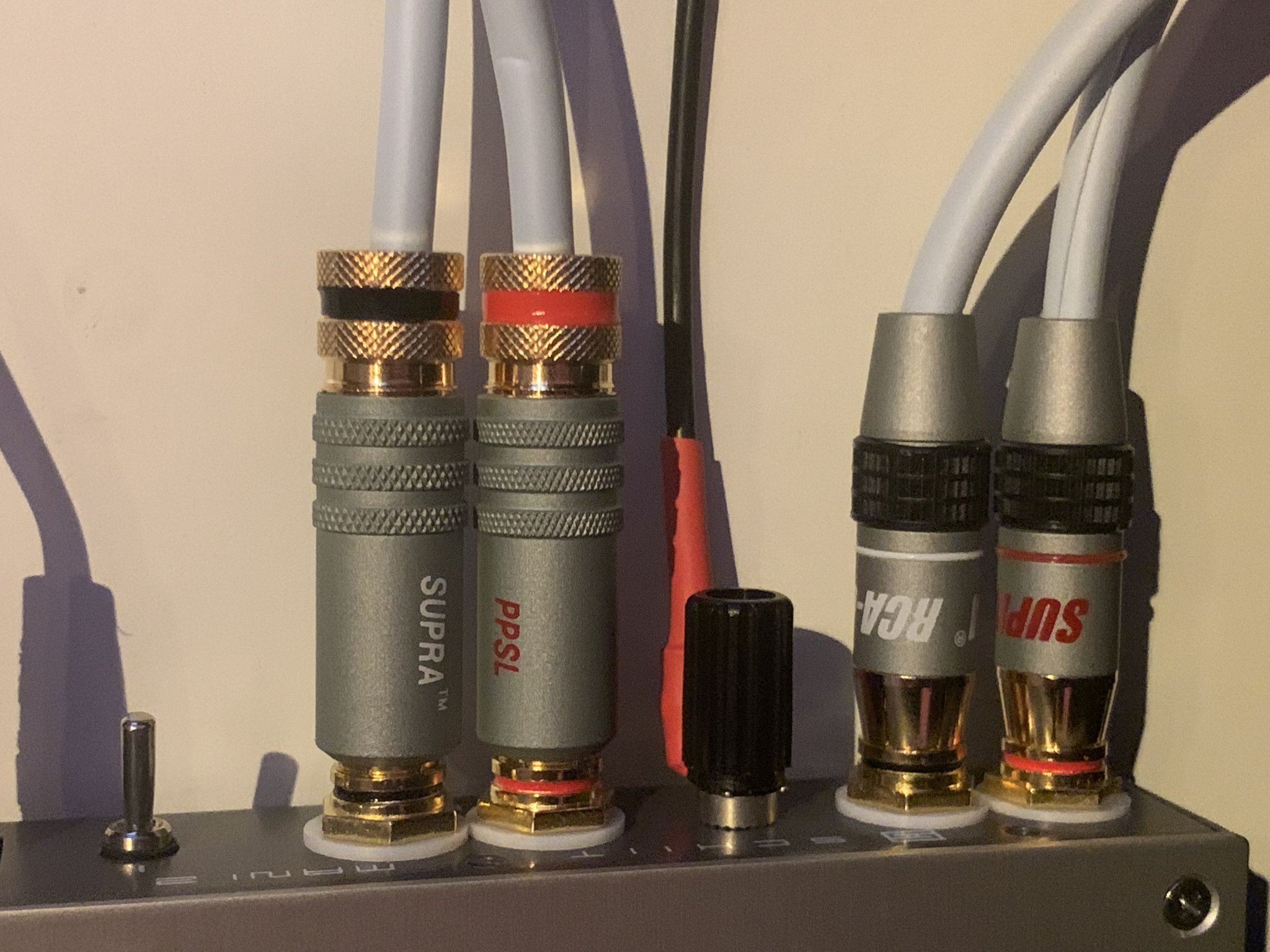

About direction of the cables from TT to riaa they are installed correct. They have a direction indicator. In case with these Supra cables it is not "voodoo" as cables are made as a screened twisted pair and screen is only connected at one end. Screen is some kind of plastic that has a conducting surface. I think the screen is connecting at TT-end when following the direction indicators.
The gnd-wire has no direction indicator!
This would have been the case if this cable was from Audioquest. They indicate the direction of the crystalline structure in the copper from when the copper was "rolled out" <-- don't know the correct name for this <-- think this is pure "voodoo".

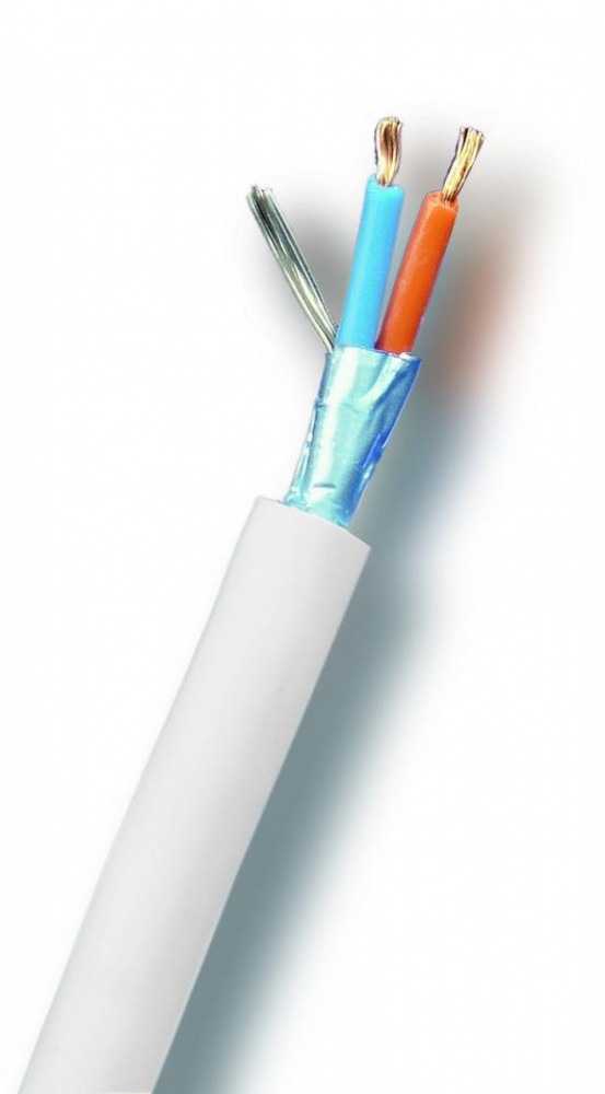

About the screen in my RCA interconnects. Screen is aluminium (not "conducting plastic").
